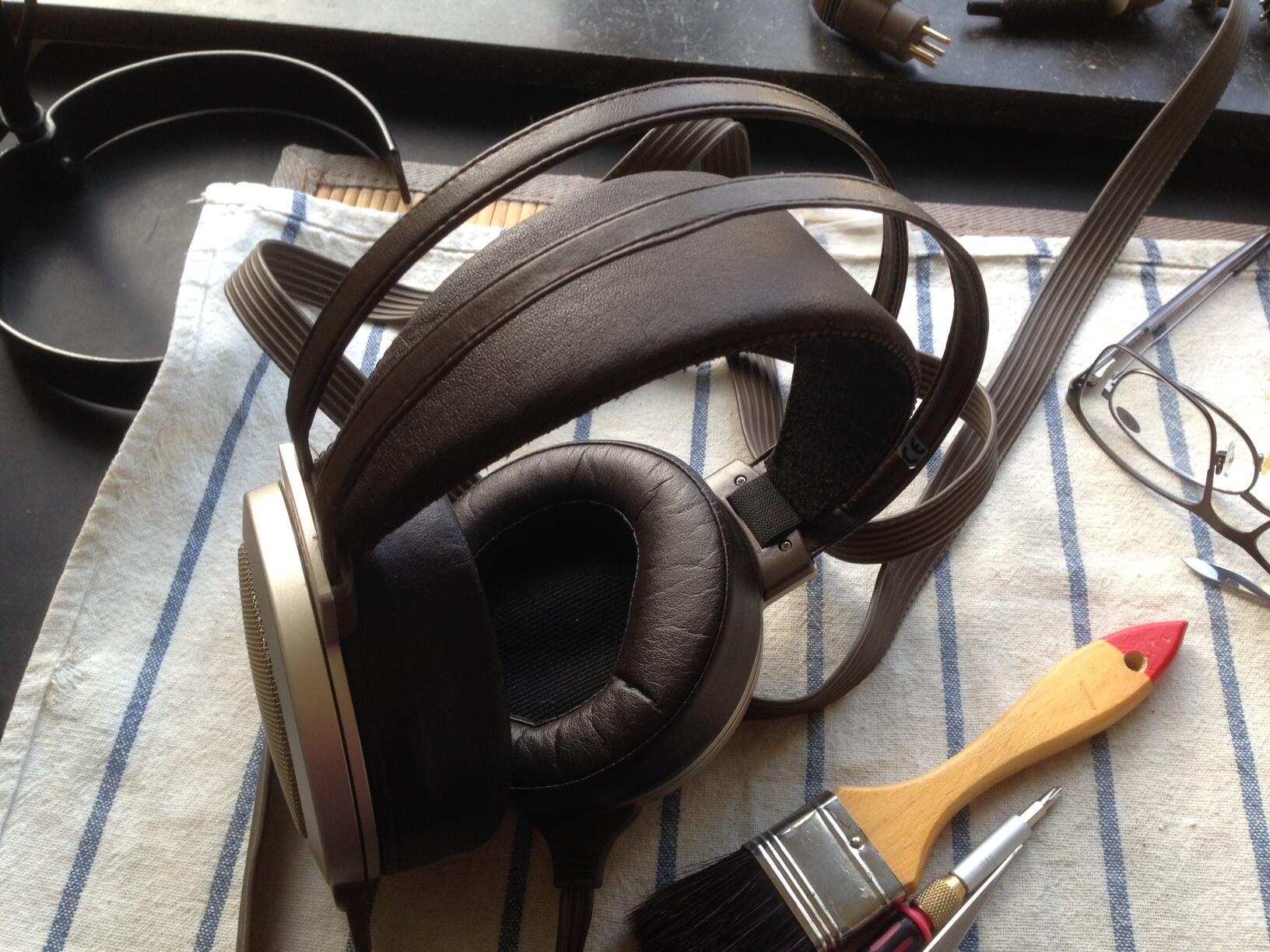

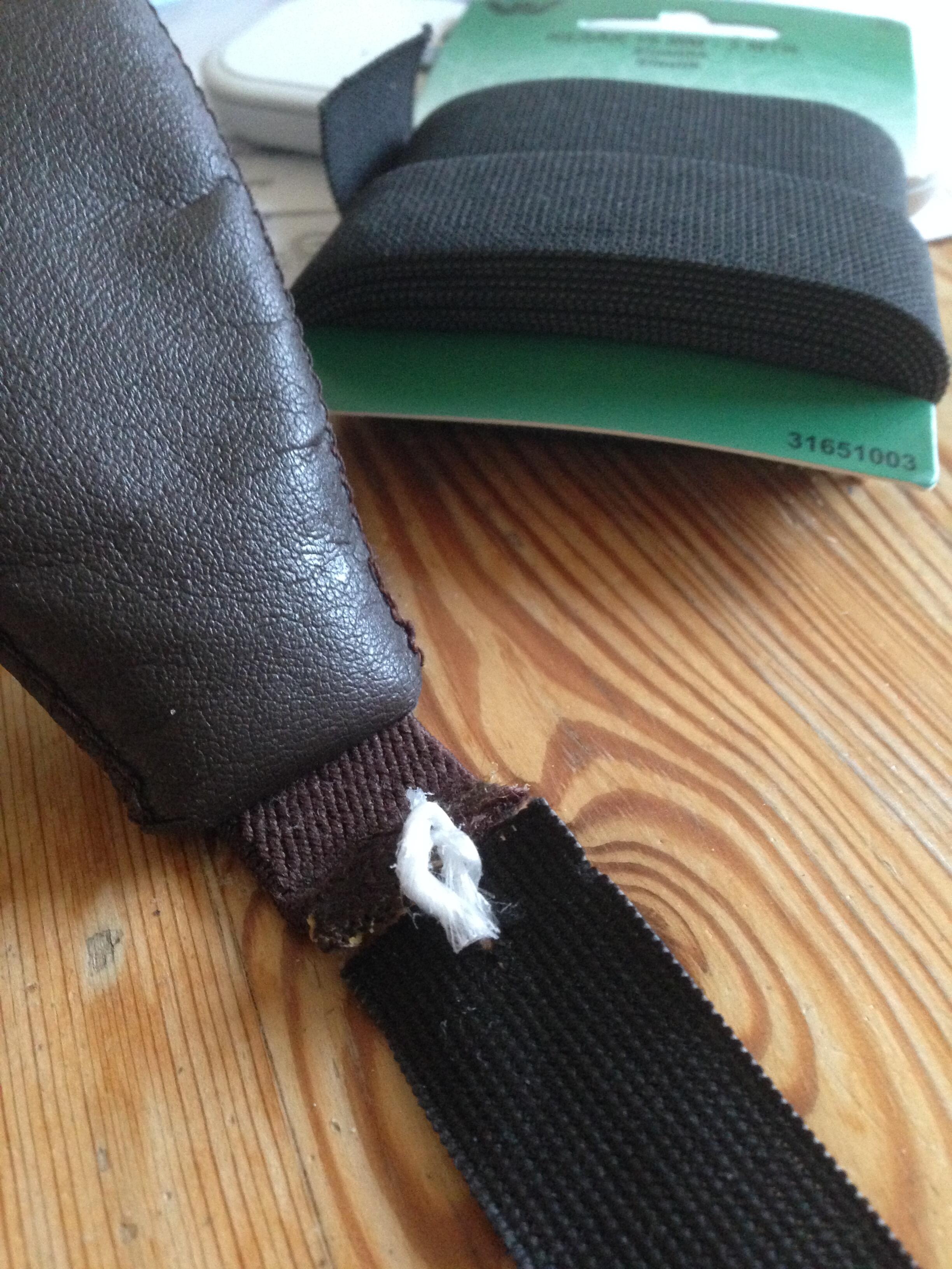

  9. It's my favourite amp for dynamic headphones, double mono like yours with psu in a separate box. Sounds so good I haven't even bothered to replace the THAT340 with JFETs.

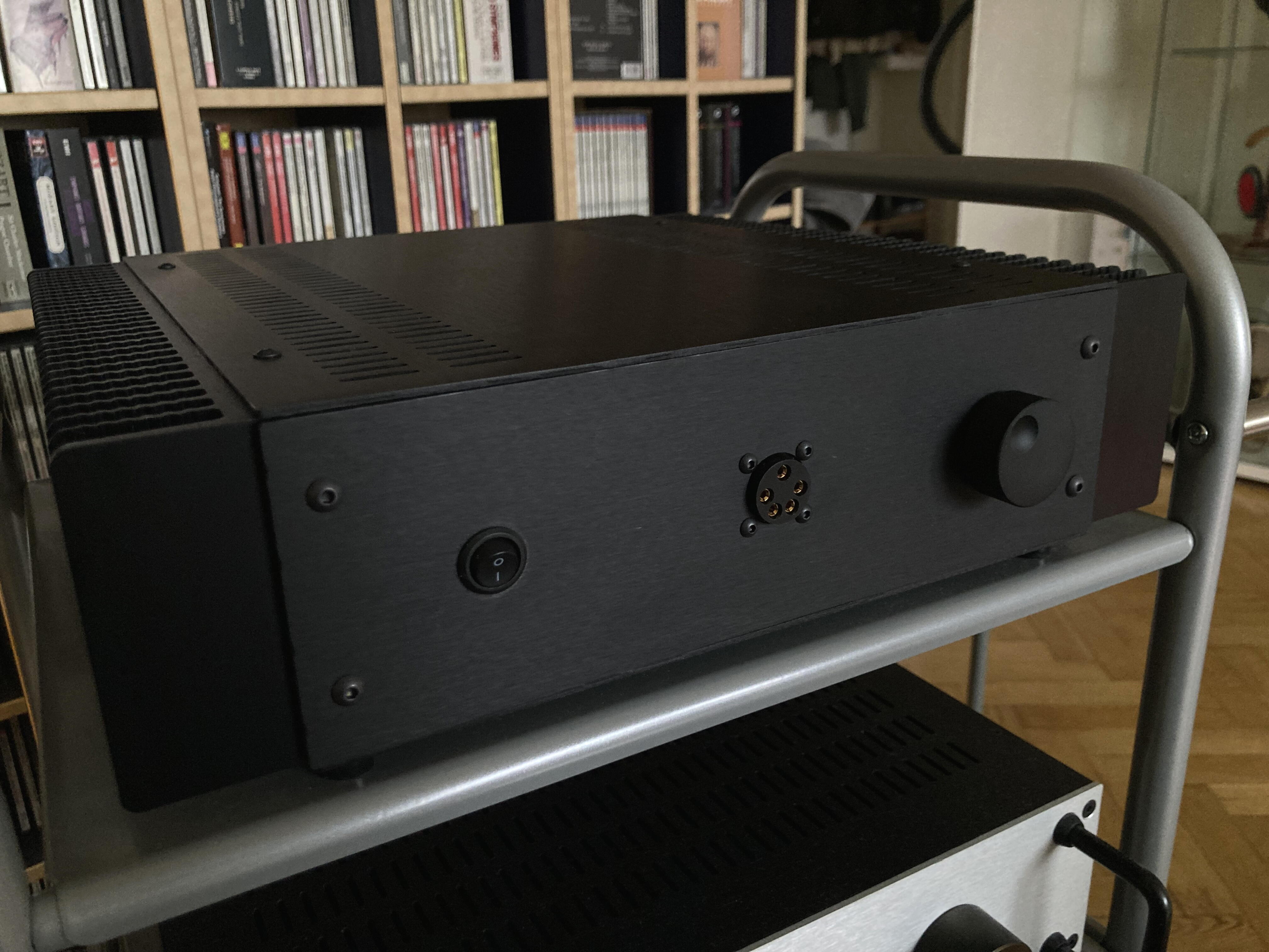

  10. Opened up a SRD7-SB to see if it needed any updates. Looks neat and tidy, and at least no electrolytics to replace. Is there anything I should consider before it's put into action?

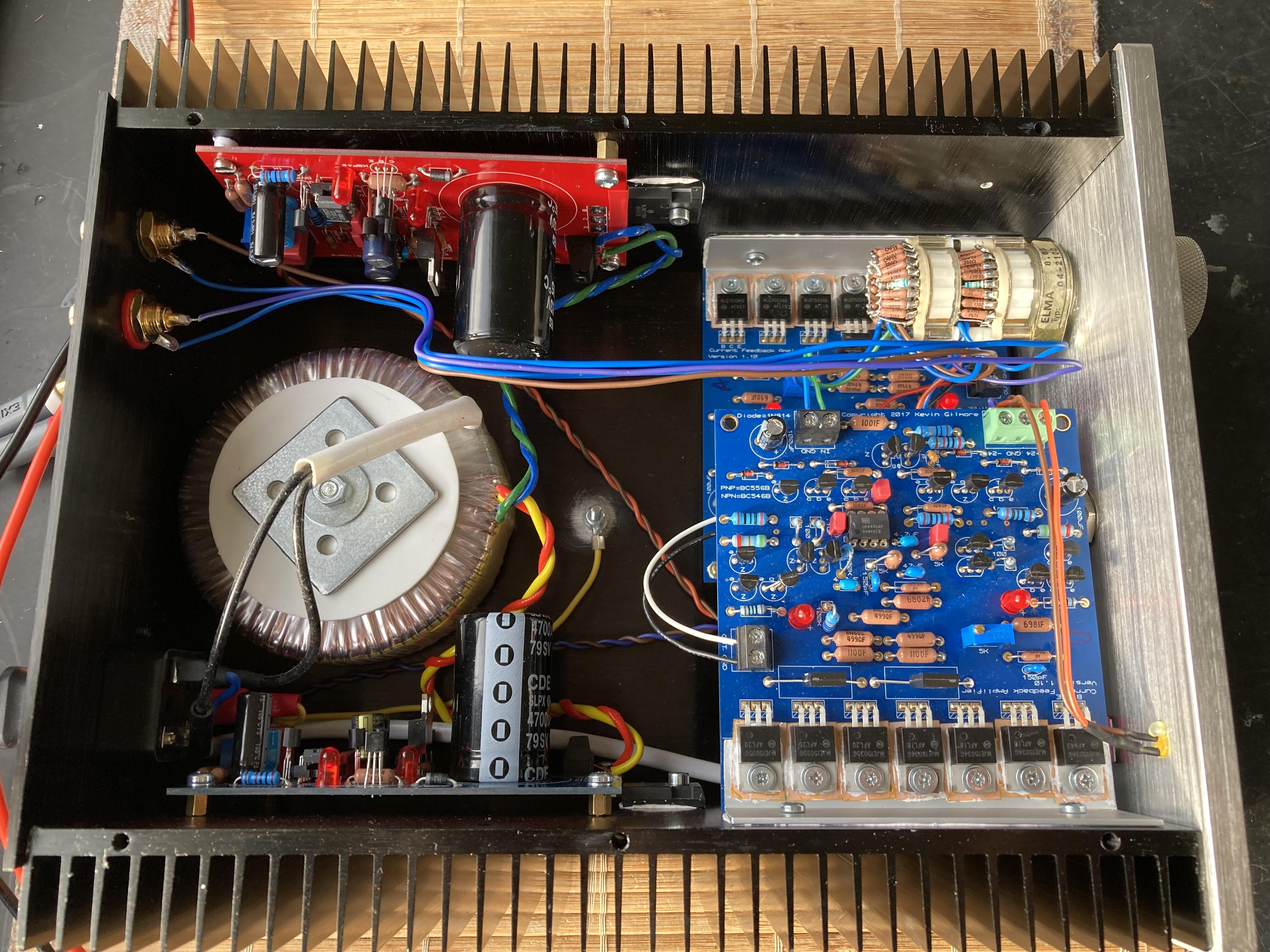

  11. Late to the party, but here goes. Lured a nice small case off of MLA for a cheap penny, wanted a compact CFA (SE). Took some time for my slow mind to figure out how to best use the space in three dimensions, but I found a solution that works fine so far, if you're planning something similar. No interfering leads or unwanted nearness of critical components, and bias can be set without problem. In reality, I'm surprised it turned out quite airy and spacious, considering the limitations. Note the Müller Rhombus transformer device ("Konzept Raute"). This romboid plate interacts wit the circular toroid shape and the electromagnetic waves are forced through the four holes in an endless loop in this electronically confined space, and thus traps all hum in an existant/nonexistant void. This amp is noise and hum free. I'm particulary happy with the volume control, a 24-position Swiss Elma switch that's been lying in a drawer for 35 years. 15K (why not?), shunt coupled and making as little contribution to the signal as possible. I think this plays a part in the clean, revealing sound of the CFA design. The odd resistor out is in the position I mostly listen to, a hand selected Syldavian military plutonium component (0,01%) from 1953, made in a numbered series of three of each value (I own the third one as well) and these days sold on ebay in Hong Kong for not less than $1200, if available at all (only one for sale during the last nine years). Set the bias at first to 150mA, it sank to 135 after some time, which was to be expected. Decided too raise it (why not?) to 200mA. Put the lid on and after three hours it was stable at 175mA after a last fine-tuning. Gets warm, but not too hot. Like all successful, completed builds it sounds wonderful , but if that lasts only time will tell. If so, I may be tempted to follow up with a CFA3.

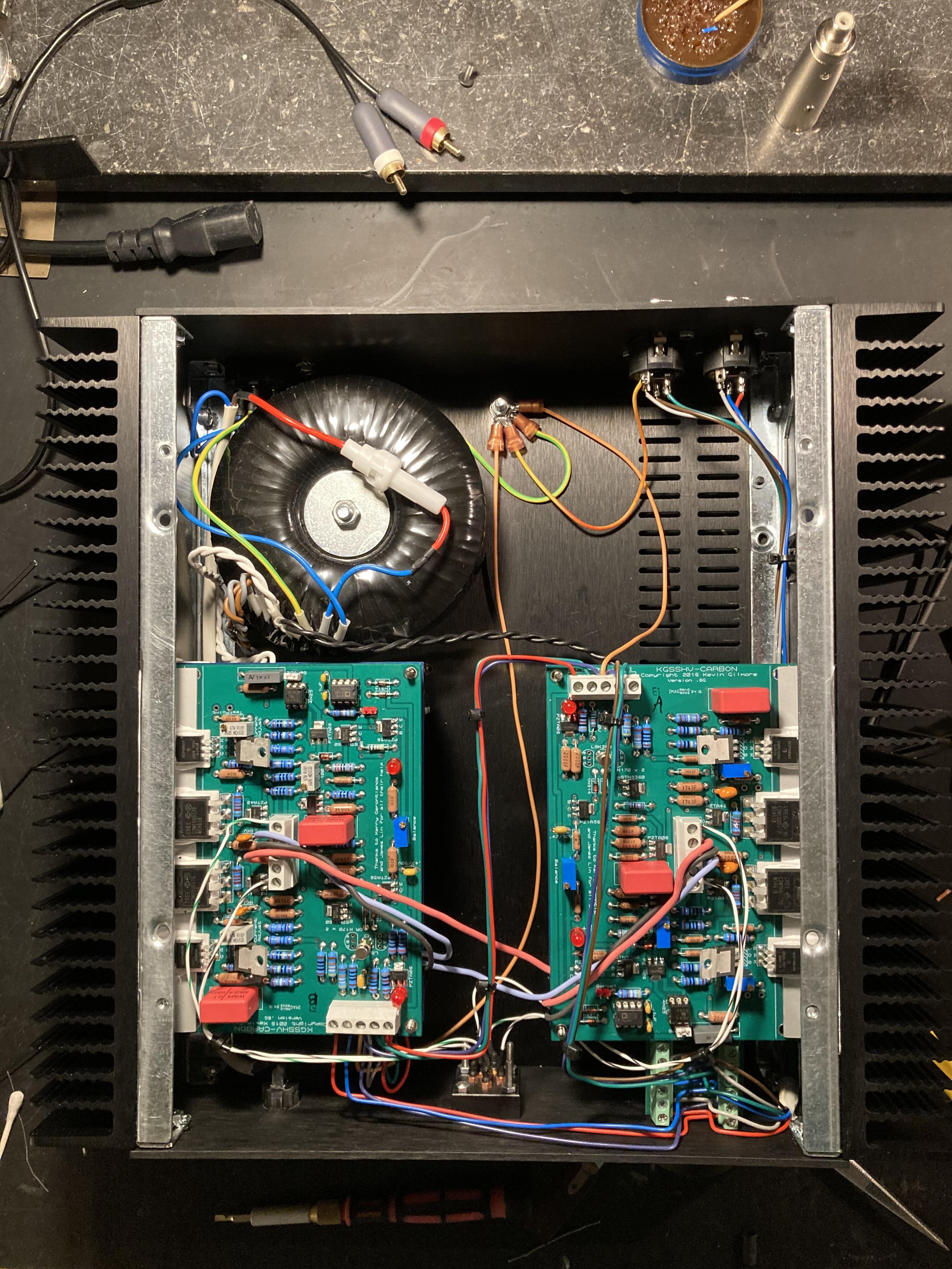

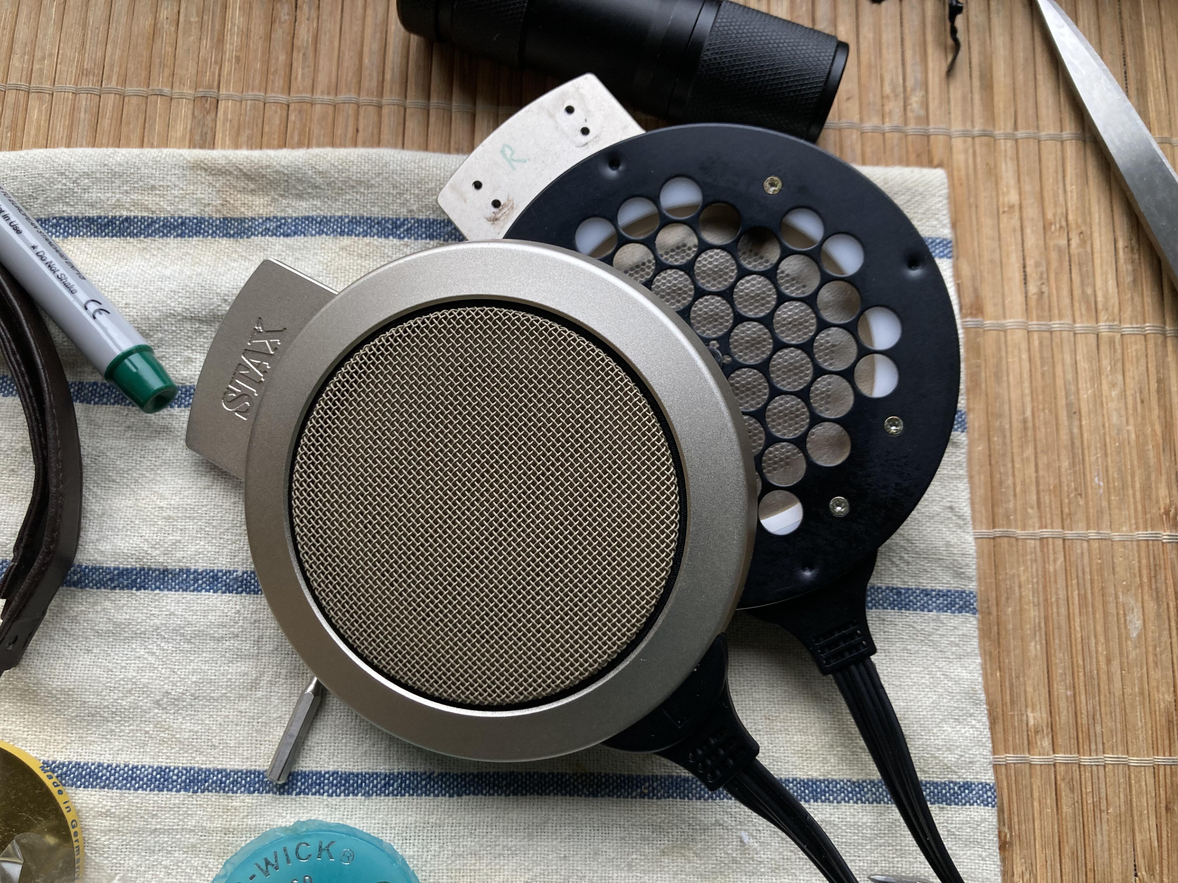

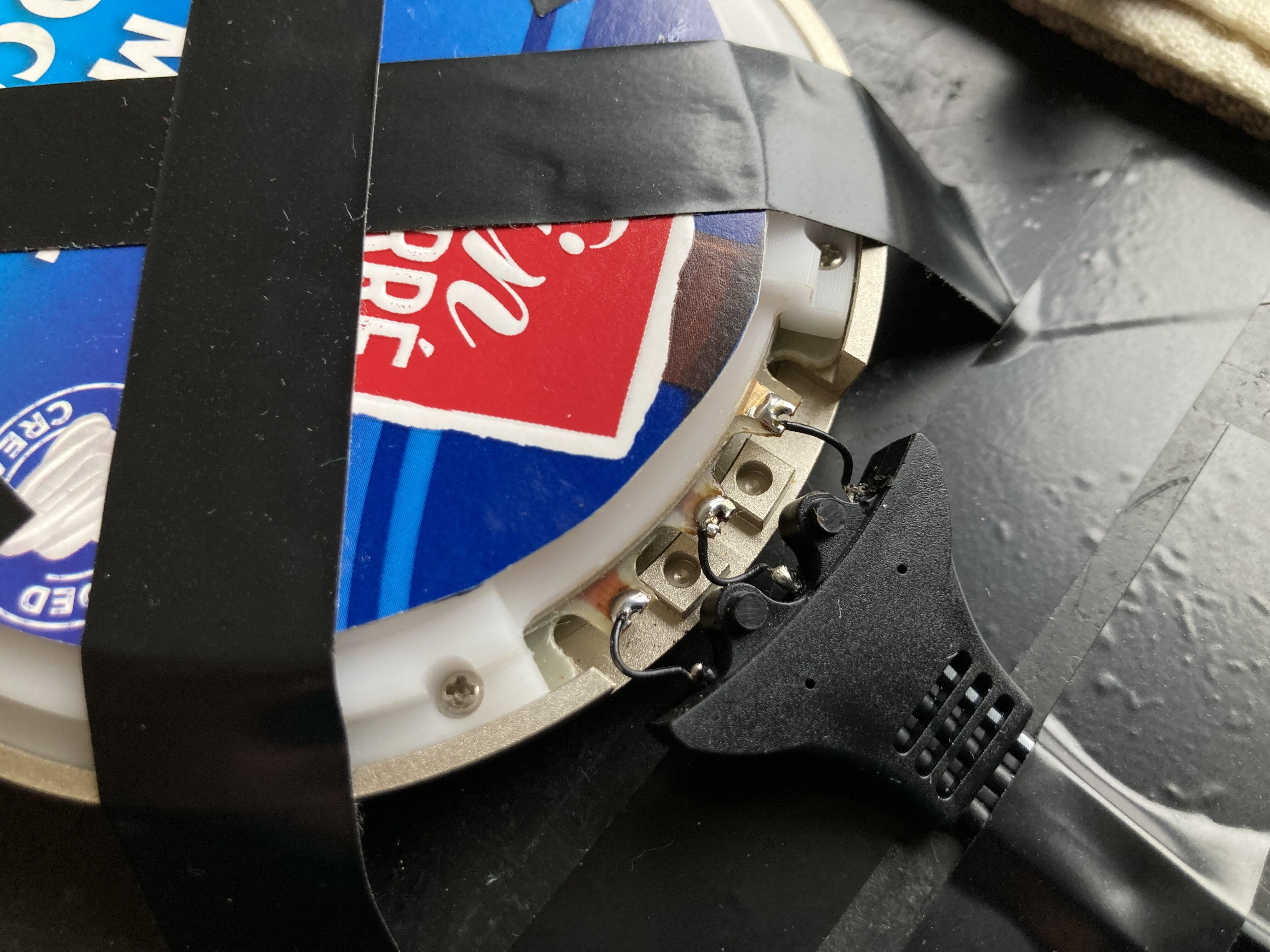

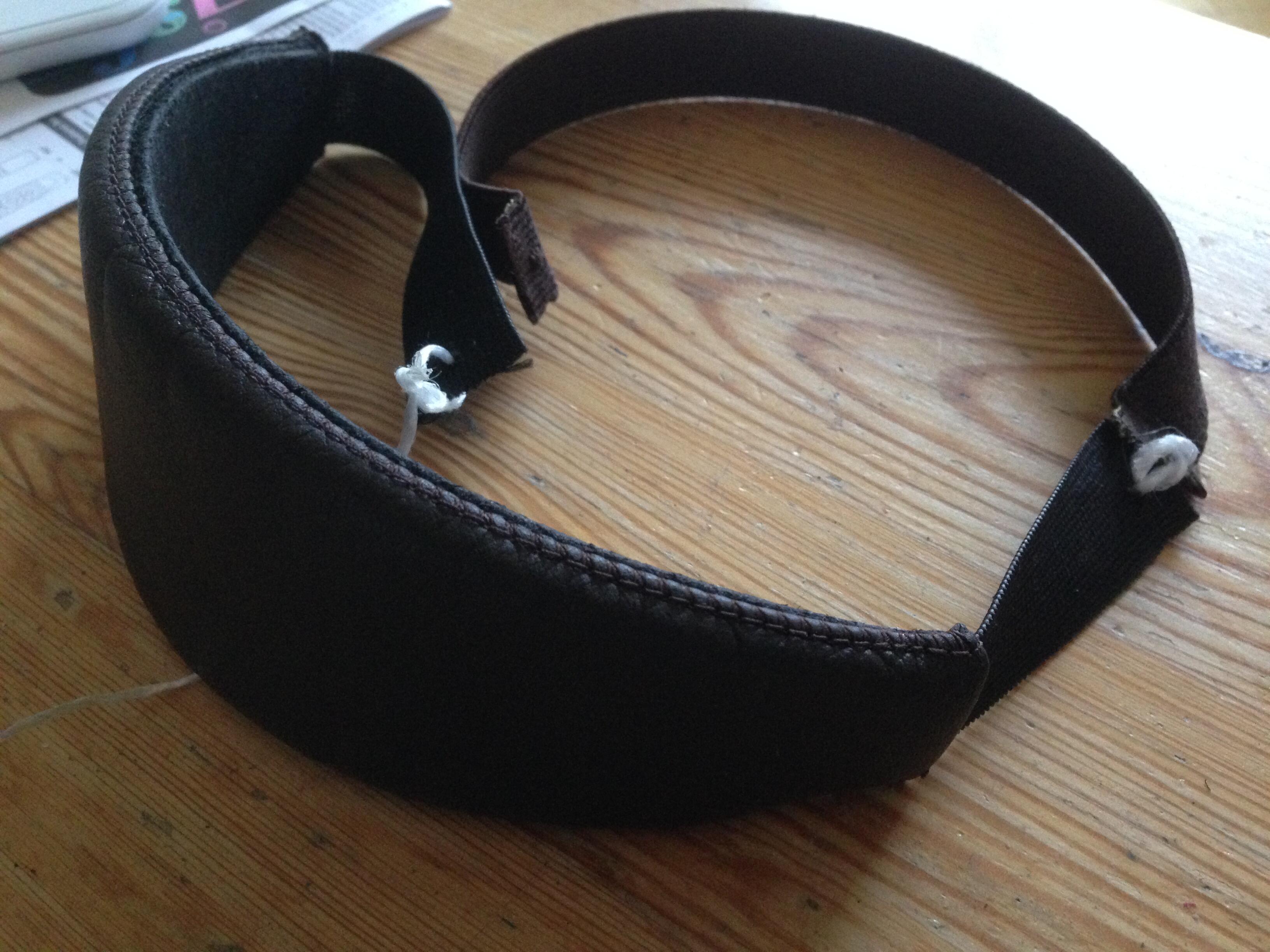

  12. So, finally time to replace the cable of my 007. Birgir and others have probably demonstrated this before, but I thought I'd show some pics for those who, like me, haven't done it before (and, sooner or later it will be necessary). Off with pads and front plate, and the nylon piece covering solder terminals. Solderer's best friend: electrical tape. Some sacrifices necessary too - had to buy and eat a bar of chocolate for the cardboard to protect driver from hot solder. New cable in place. Also adjusted the headband elastic and put on the pads correctly, wasn't done before. Now the 007 sits tight on my head, sounds better and is more comfortable. Promised myself to fix the 007 when I finished my Carbon, so here goes. Build without major problems. MLA brought his variac for startup, and there were high voltages on the outputs. My mistake, had missed to solder one leg of a PZTA56, hanging in air. Fixed that and it works fine. Wanted to keep it simple and clean. Might add a LED when I can afford it.

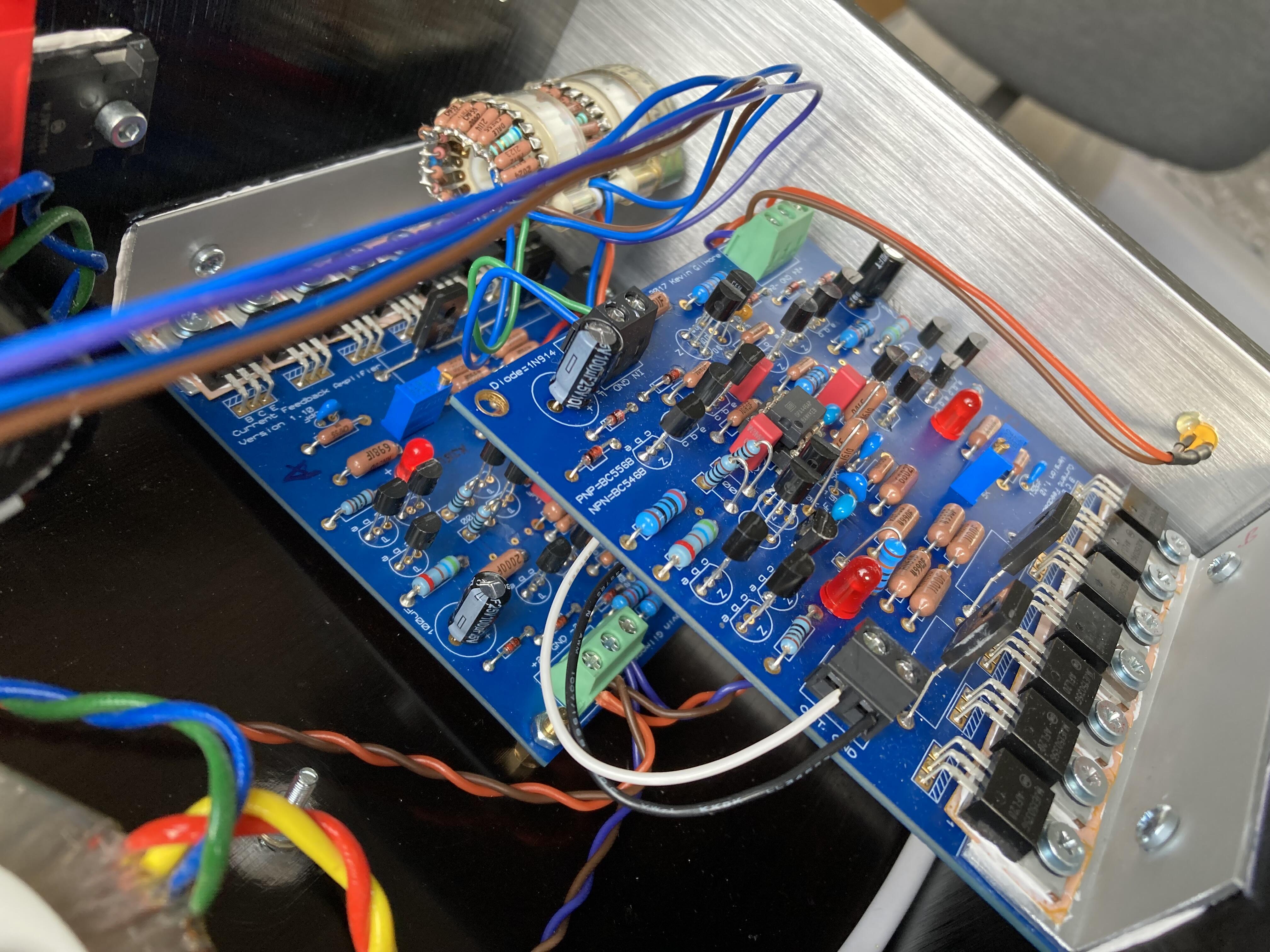

  18. Thanks, two jumpers did the trick. I think I'll lower the gain with 50K/5pF feedback, which I think are the parts at the arrow (don't have a schematic). The PSU is hopefully ok too, did not populate the transistors that popped at turn-on. Time to test the beast.
