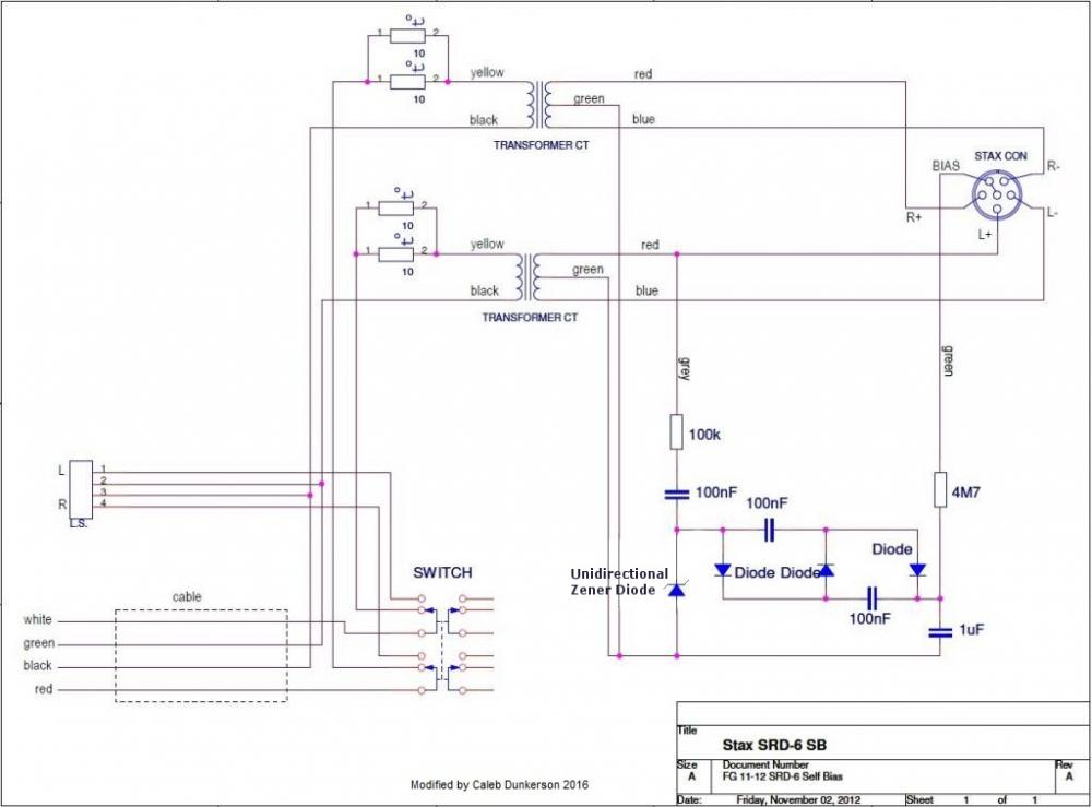

Also I just found this schematic for the SRD-6/SB.
EDIT: DO NOT BUILD THIS CIRCUIT. Look at my post at the bottom of this page for a corrected version of this schematic. This version has no zener diode to limit the input voltage and if built as is will create a very different bias voltage than expected. Basically, depending on the input volume of the audio signal, this one can generate bias voltages well in excess of 230V and will damage normal bias headphones.
There's no transformer in this self bias circuit. It looks like the signal is tapped from the output transformer and sent straight to the voltage doubler. How does this approach work?

Please forgive my ignorance, I only have a loose understanding of these concepts, but how exactly does the above circuit maintain a consistent 230v bias voltage when the input voltage from the step up transformer varies so much with the volume of the music being played. As I understood it the purpose of the extra transformer that is absent in this circuit was to ensure that the voltage would generally be well in excess of what the multiplier needs to make the 230v bias, and that excess input voltage was limited by zener diodes.
The above circuit doesn't appear to have zeners so how does stay consistent? Or am I reading the schematic wrong?
The way it works is that the same transformer that steps up the voltage to drive the headphones also provides high voltage to the bias circuit.  The bias circuit drains off a little bit of current from the signal voltage to fill up the bias capacitors.  Think of the diodes as being one-way doors for the electrons.  Every time the music voltage peaks higher than the voltage that is already on the bias capacitors, some current flows into those capacitors, gradually topping them up.  The reason this works is that the bias requires voltage but almost no current, except when you first start up, so draining a bit off the music signal will do the trick.  If you were to bias the headphones and then disconnect them, they will hold the bias for a significant length of time.  Usually the first couple diodes are zeners to regulate the voltage in the bias circuit to make sure it doesn't go too high.

I understand how voltage multipliers work, that's not the issue. What I don't understand, and would really like to, is how the SRD-6/SB bias circuit regulates it's voltage to 230V. There don't appear to be any zener diodes in that circuit to limit the voltage before multiplication, so what in that circuit stops it from generating > 230V bias voltages at high input volume?
Edited by Arthrimus
You are correct, there should be a zener diode in there.  My guess is that the schematic you posted is in error, the left-most diode should be a zener.  In my copy of the SRD-7 Mk II that is precisely where there are back-to-back zeners to limit the voltage.

Ok so I have another question, and this one has been bothering me for a while. How do any of the Stax bias circuits produce 230V bias if they are zener limited to 100V on the input side. Shouldn't normal bias circuits produce a 200V bias, and shouldn't pro bias circuits produce a 600V bias? What am I missing?
Edited by Arthrimus
I know old normal bias was 200V. They changed it to 230V later. So maybe 200V is what that circuit was made for?

I've seen that schematic. It's a copy of the SRD-7 MK2 schematic and I still don't see how it generates more than 200V normal bias. It's zener limited to 100V on the input and then doubled to 200V for the normal bias tap. Did any of the SRD boxes actually have 230V bias? So far the only 230v bias circuits I've seen have been in stax amps such as the SRM-1/mk2 which doesn't use a voltage doubler at all, but rather takes power directly from the hv secondaries of the power transformer.

The circuit is a 6 fold multiplier so limit the input to 100V (with a 5% error in the harmonic suppressor) and you are close enough.  All Stax bias supplies would fall under the "close enough" realm.  There is nothing regulated in any of the Stax amps except the SRM-300.

So I know it's been a while since I posted in this thread, but I just wanted to give a quick update. I recently acquired an SRD-7sb unit and was able to confirm that the circuit that I posted further upthread was indeed incorrect, but only insofar as the diode on the far left was not labeled as a Unirectional zener diode just as JimL said. I modified the schematic and built a test circuit using the new schematic and it works great.
EDIT: I initially indicated that the Zener Diode should be Bidirectional. This was an error, the Stax circuit uses part # 1Z100 there which is in fact a UNIDIRECTIONAL 100V zener diode. Using a bidirectional diode here causes undesirable effects to the voltage multiplier and will not generate the correct bias voltage. I have updated the schematic below to reflect the change. Sorry about that.

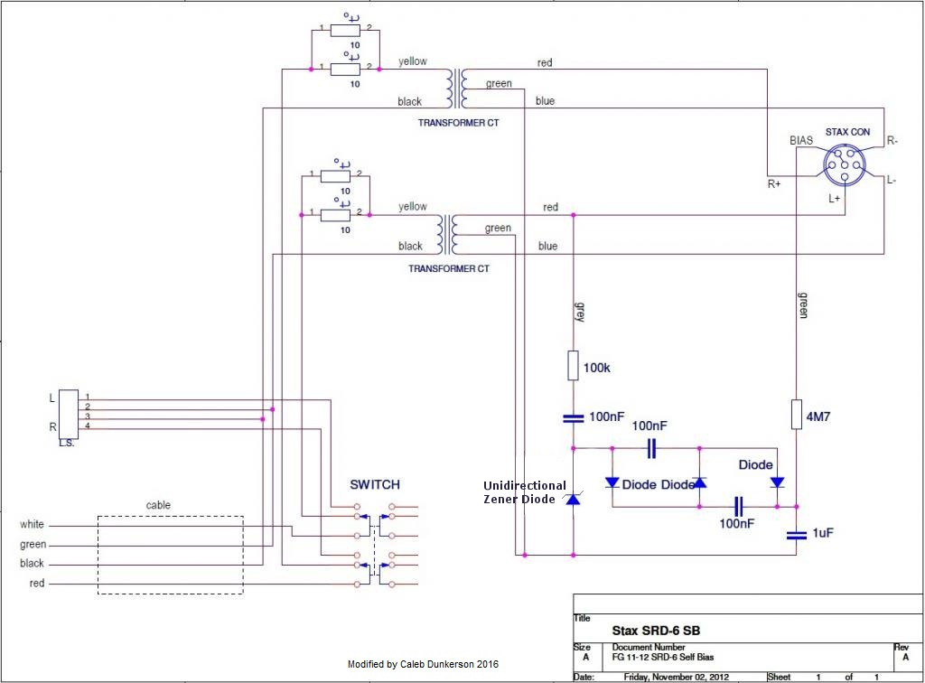

I have srd6-sb and planning to convert it to AC bias.
If i understand right, i simple cut the self bias “input wire”, and apply AC voltage from little 240V/??V transformer to the “green points”?(input of bias circuit) What secondary voltage transformator needed? (Little more than 100V zener?)
(no 12V AC, just error in my additional drawing)
