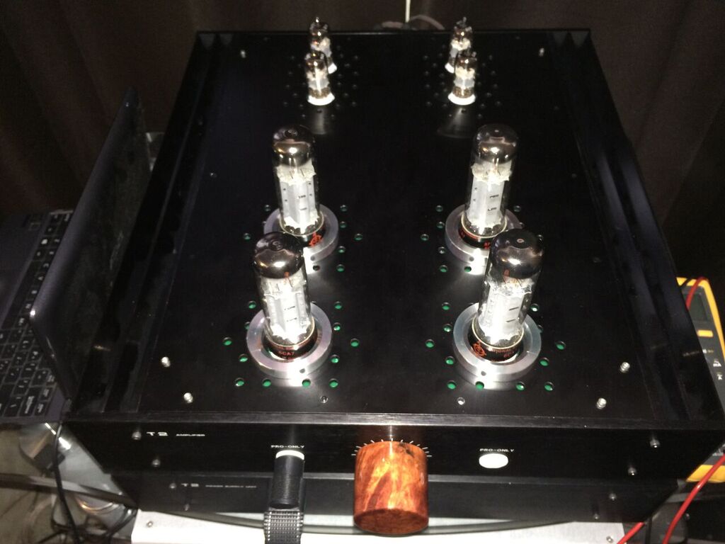

  8. George's suggestion to up the current limit worked like a charm, everything's up and operational. Sounds good, a bit of popping/clicking but nothing too noticeable. How should I go about tracking that down? For my personal use I don't know if I care enough yet, but I might try to fix it when I redo the internal wiring/etc. Knob courtesy of insanity, I probably should have measured it before sticking it on
