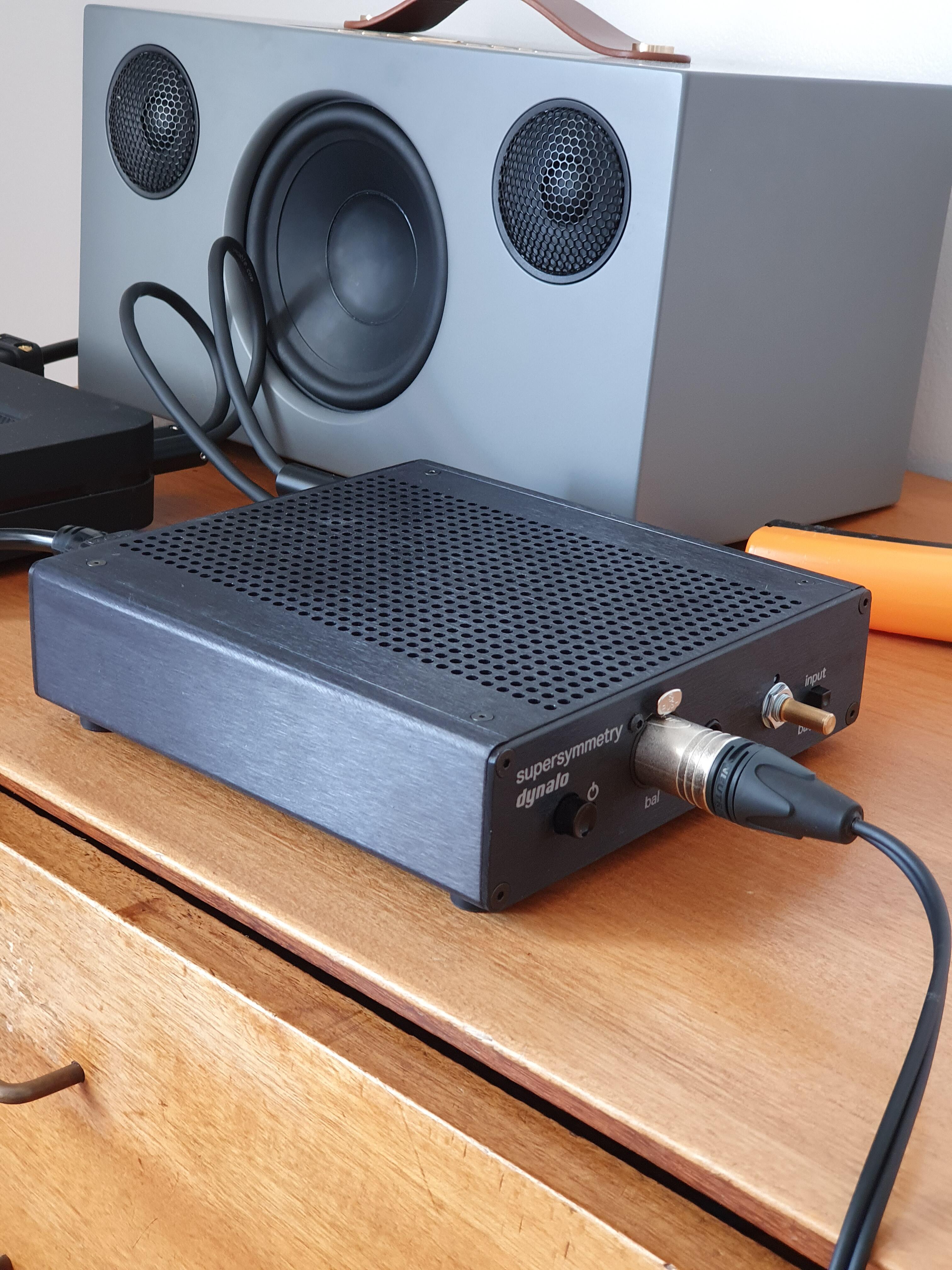

  7. So I finally got to finish my dynalo mini build. It is playing nice with 2SK170/2SK79 input jfets, 420ohm led resistors and 255 bias resistors. Temperature with cover on is 103C on left side (- channels) and 81C on right side (+ channels) transistors, is this sort of difference normal? I checked bias and L- is around 340mV while R+ is around 290mV. could this have anything to do with the offset trimpots? All the bias resistors 255ohm and led resistors (420ohm) measure within spec. Voltage drop on the leds around 1.65V When I remove the lid the temperatures drop quite a bit to around 60C-75C which is understandable. Sounds great though with my sennheiser HD650 recabled with 4 pin XLR. I would just like to understand this diferrence between plus and minus channels
  8. Hello guys, after a long time, and with a lot of time in my hands due to quarantine I finally finished my Dynalo MK2 mini and reterminated my hd650 with a 4 pin balanced plug. Transistors are a bit hotter than I wanted, at 90-100 degrees with the top panel on. I need to go read about reducing bias. Sounds good though! Source at the moment is a bluesound node, need to go and find a better DAC with balanced out that doesn't break the bank.

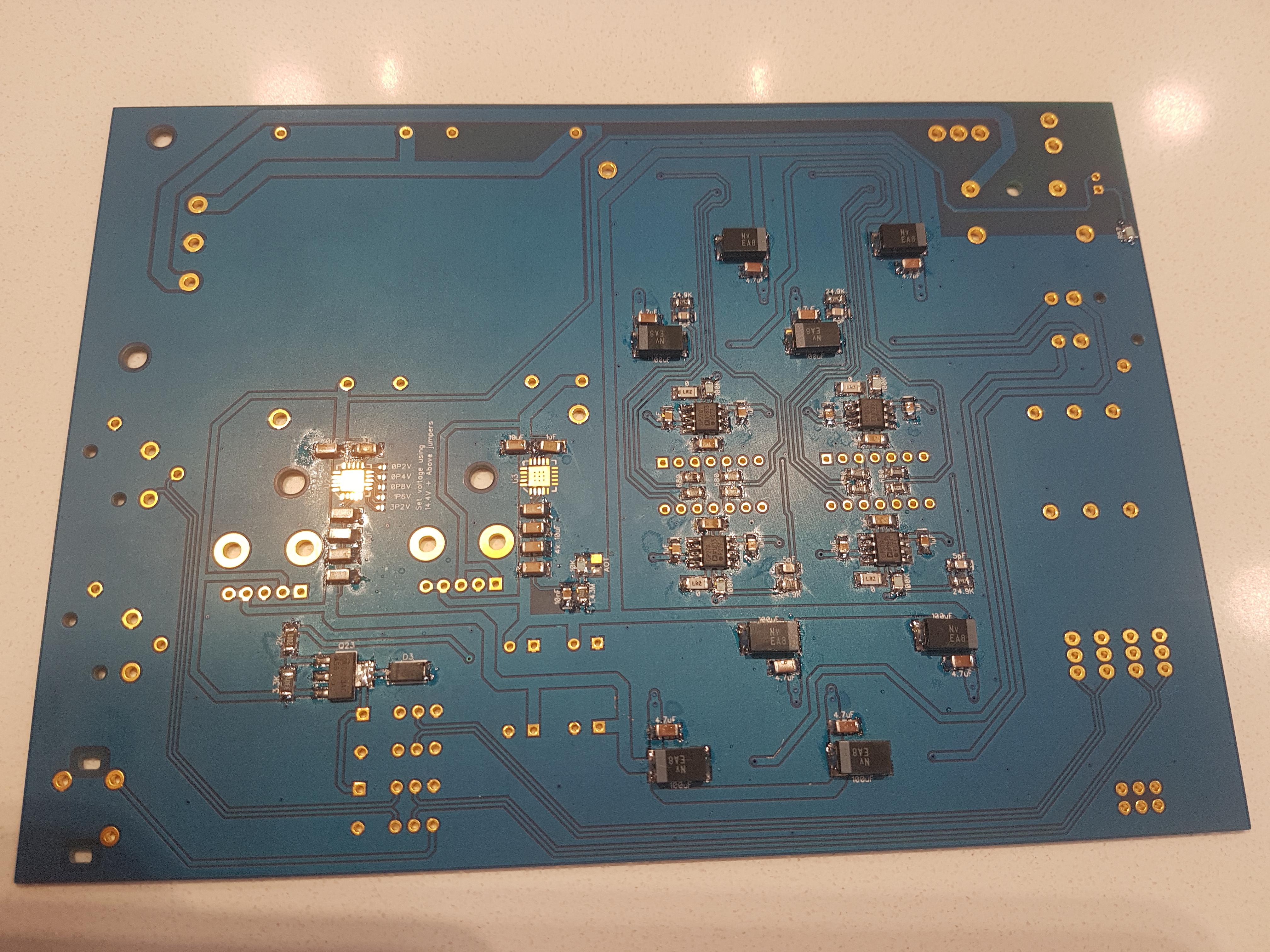

  17. Underside of the dynalo mini done, just need to clean the flux residue when it's all done. Those 0805 resistors are starting to be the smaller I can solder without magnifying glasses. I just noticed looking at the picture that the tantalum capacitors don't have the positive to the same side of the board. I must hsve confused this somehow and will take care of it in the morning.
