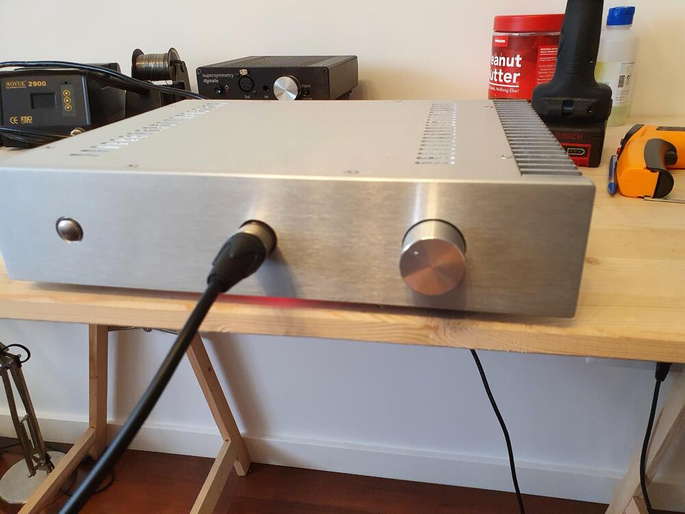

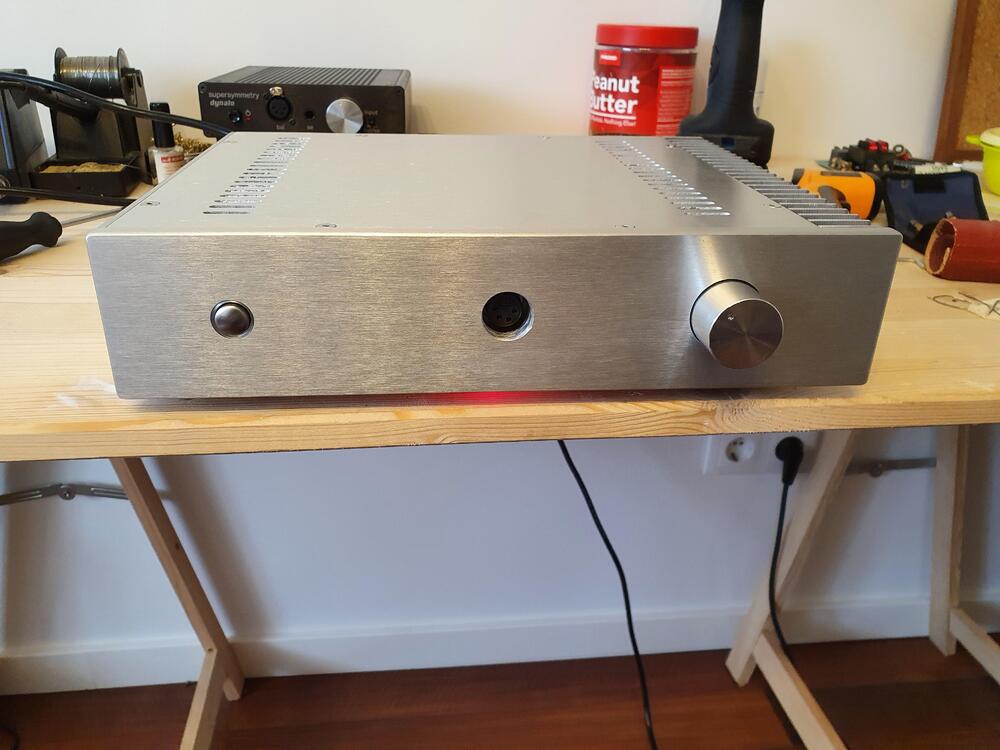

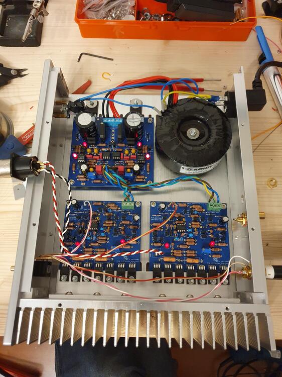

  20. Done! Neutrik 4 pin xlr mounted from behind with blind taps. all in all went well considering it was done all with a hand drill. No drill press around 😔 The on/off indicator led was mounted underneath the case, makes for a nice effect. Quite happy with the result! Now the quest for a better streamer starts!
  21. Thanks! I've listened to the CFA and dynalo mini for about 2 hours this afternoon trying to compare them. I liked the cfa better I believe but will keep listening. They are both great amplifiers but I can only keep one.
  22. I have about 160mA bias atm and the heatsink is about 34 Celsius. Transistors are about 10 C higher. I'll push it a bit closer to 180-200 once it is all done to see if it makes any difference.

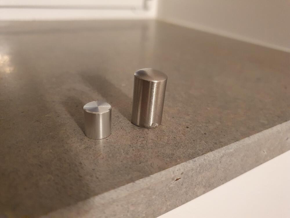

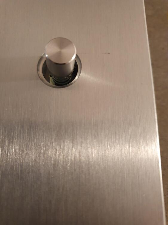

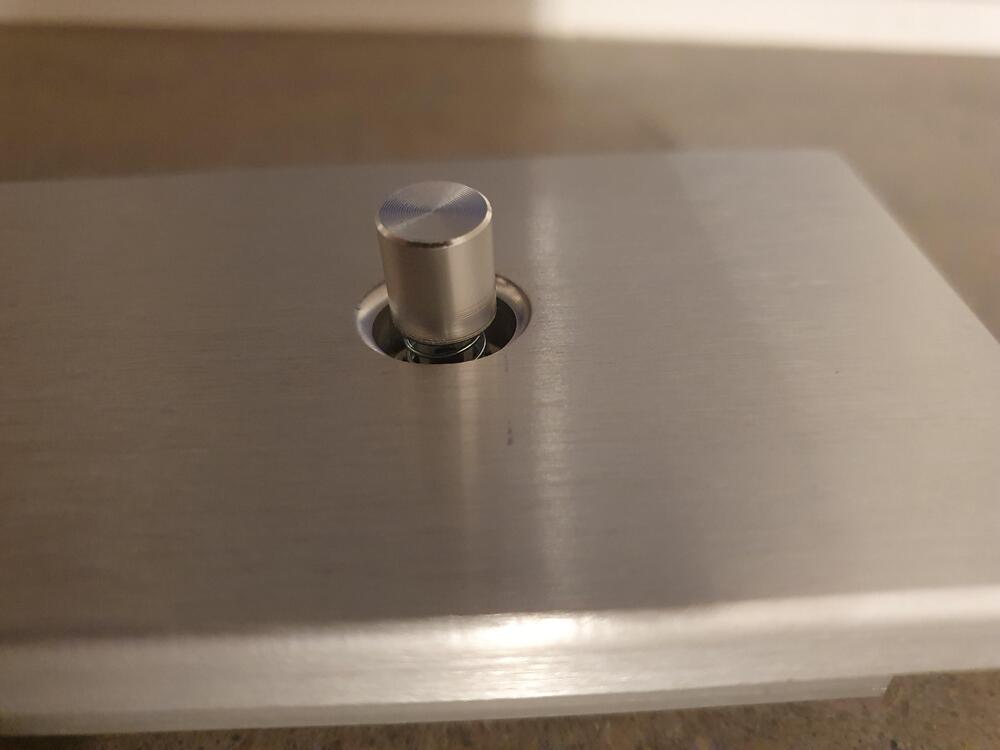

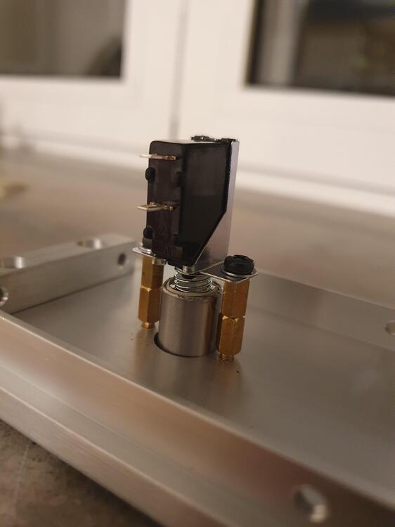

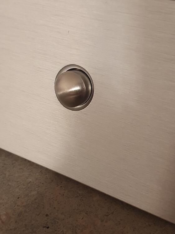

  23. The case is alright. Not top notch but also not a bad price considering it has most of the drilling done. The whole for the switch is 13mm wide with a little bevel on the front. The cap on the pushbutton didn't fit right so I made that cosmetic upgrade. I am considering painting the front panel mate black.
