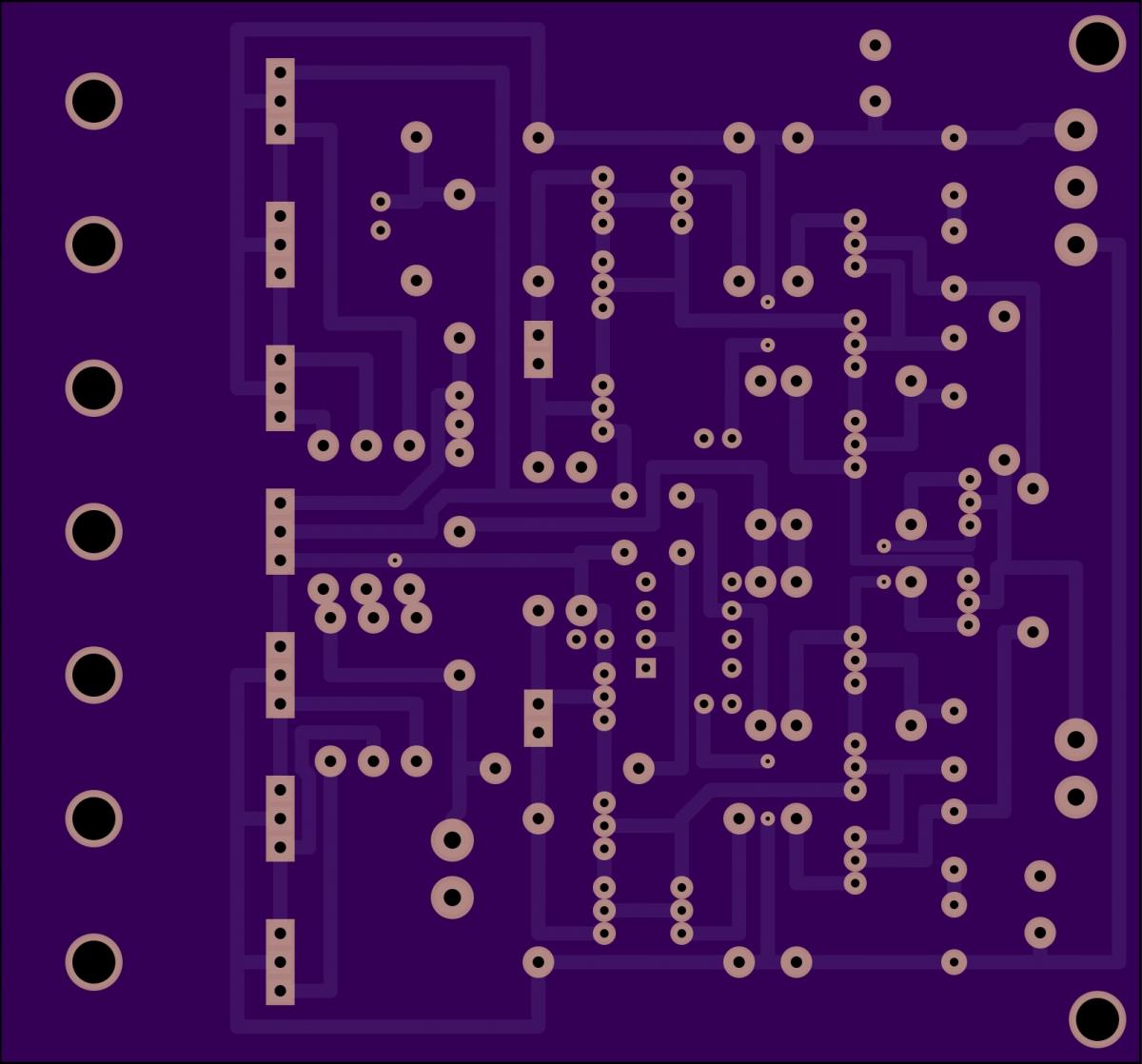

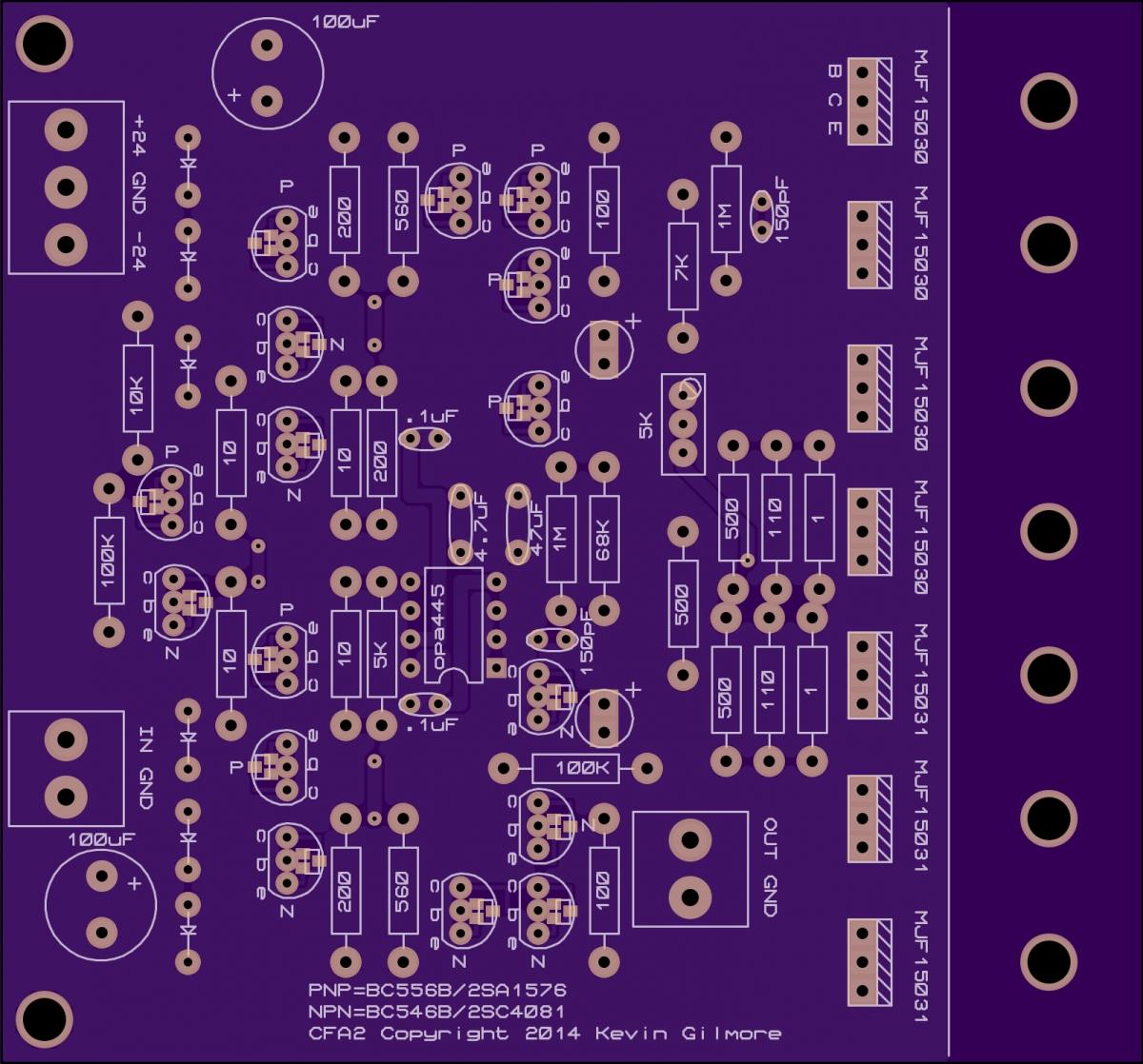

someone needs to check the board.
Hand traced and it looks ok to me. Subtle differences in the schematic vs the board:
C2 is 100uf in schematic vs 47uf on board.
C1 is 4uf in schematic vs 4.7uf on board.
The top two tiers of the triple darlington emitter resistors float in the schematic and are output referenced on the board.
Also noticed the ground in and out connections, the 100uf and .1uf cap grounds don't have thermals...not sure if you typically use them there or not.

  • Author
They float on the board too. not tied to the outputs.
For power supply caps i like to do complete solder to ground as the
thermals have some impedance, especially at higher currents.
Edited by kevin gilmore
Doh...I Must have been dazed by staring at purple on purple for too long. :)

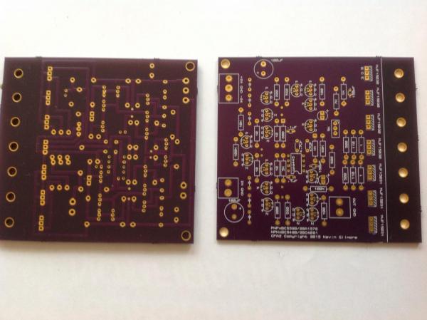

  • 4 weeks later...
Looks like a project weekend! Boards are in. :)
I plan to do one set as throughole and one as SMD.

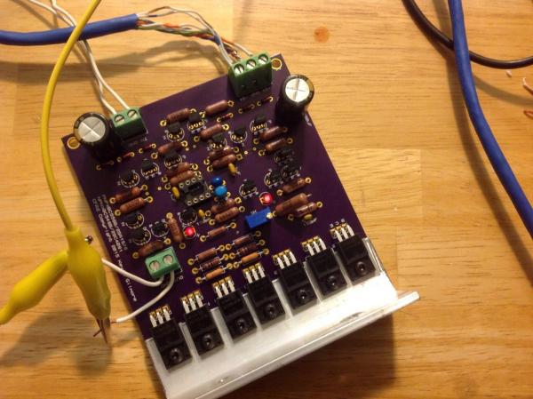

Soldering under way. :)
Possible error on board. In the schematic, the positive input of the opa445 is grounded. On the board, pin3 is not connected to anything. Pins 1, 3, 5, 8 are floating. I plan to run a short jumper from pin3 to the nearby .1uf cap ground if it needs it.
  • Author
thermal on pin 3 is definitely missing.
will fix on the layout in a few minutes.
pin 3 has to be connected to ground.

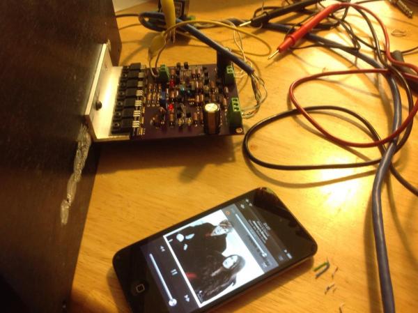

It lives! Without the servo (still need to add the jumper) it's only got a few mV offset and is dead quiet with cheesy iems Now I've got to figure out the bias....oh, I think I've got it. 150mA across the 1 ohm. Now I've got to get the second channel built. I think this one may be a winner. :)
I'm observing interesting behavior...seems the bias current changes with input pot position. May be because the servo is out, or could be my input wiring. Driving my headphones in mono it sounds great!

Looks good, keep us posted when you finish the other channel :)
Just out of interest, which caps did you use for the 4.7uF/47uF positions?
