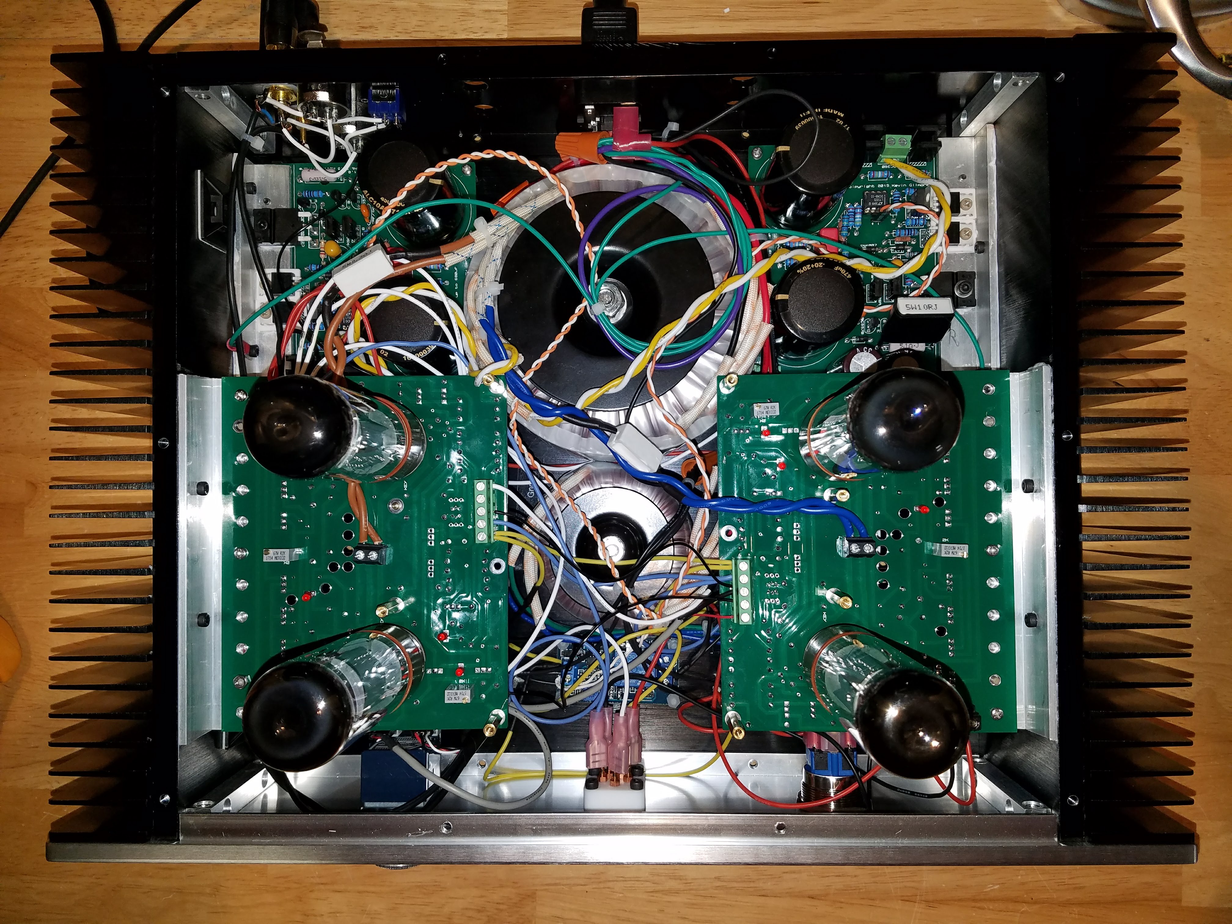

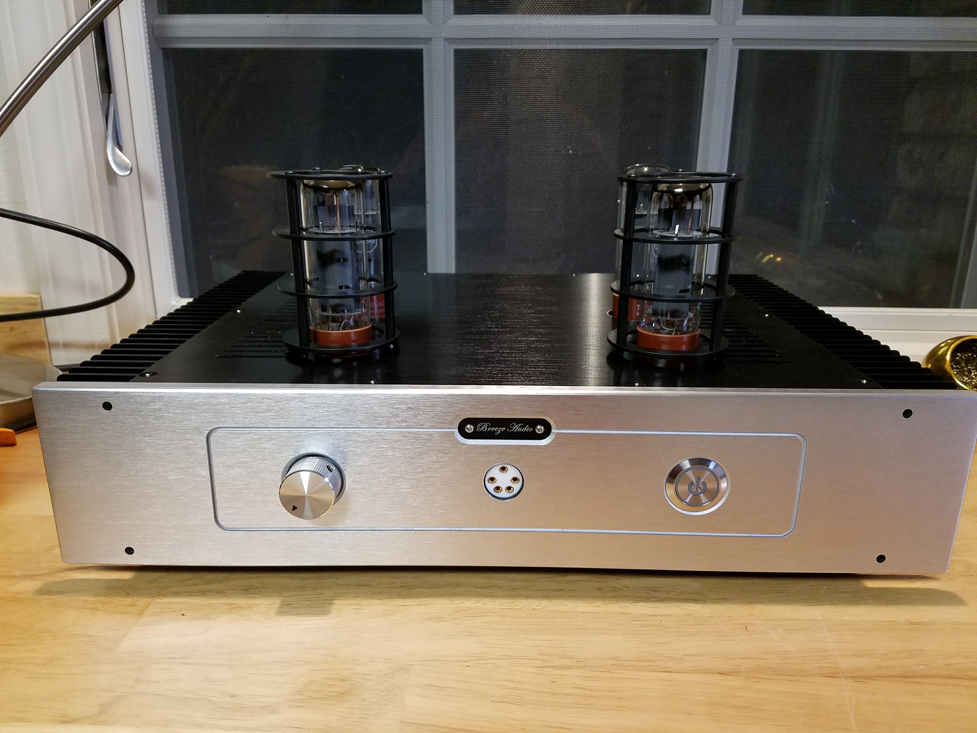

Blueman2 Posted January 21, 2018 Report Posted January 21, 2018 (edited) Got the filaments down to exactly 6.0VAC using 0.3R 5W resistors. B+ and B- are both solid now as well. +375V and -378V. About 0.2 drift over 30 minutes of warm up then stays fixed after that. Still comparing to my SRX and Carbon, but the sound is certainly glorious! I know, pics or it didn't happen. So.... Above, you can see that in order to make this fit in a 300mm deep case, I had to create 2 layers of boards. PSUs on bottom, Amps on top, with about 30-40mm of overlap. There was actually plenty of clearance and I could have moved them to overlap even more if needed. I was able to leave enough room in front for the power switch and future quad pot when it arrives. Please don't give me too much crap for the messy wiring. I plan to take it apart next week to add the quad pot and clean up the internal build a bit. I just wanted to prove to myself that it would fit! Also, notice that I am using the 755-SCT2H12NZGC11 as a replacement for the C2M1000170D for the PSUs. It appears to work just fine and runs cool. So we do appear to have a backup device for when the C2M1000170D SiC is out of stock. Also, in the front middle (under the mess of wires) is a timer delay for the CPC1117 HV delay turn on, as referenced earlier in this thread. I have it set for 60 seconds. Above with the tube cages. I have not install yet, but just wanted to see how they will look. That will be next week... And finally, sharing some room with my Carbon. Not pictured are my SRX builds (one mine, one my son's). BTW, so far, the BH runs cooler (both case temp and silicon temps) than my Carbon. Both running at 20ma. Edited January 21, 2018 by Blueman2 10
mypasswordis Posted January 21, 2018 Report Posted January 21, 2018 Big fan of 3d space optimization for amps. Haven't managed to implement it yet but this is giving me inspiration Do you have a link to the case you used? What do those four mounting holes on the faceplate do since it looks like the plate is actually held in by those corner post block things?
Blueman2 Posted January 22, 2018 Report Posted January 22, 2018 The case is available in several configurations from several sellers on eBay. Search on "BZ4309" or just "4309 aluminum chassis". Mine was a great price: $110 including shipping and arrived from China in 4 days! Seems like the price jumped to $150 or more now, so I was lucky. The holes are for rack mount front handles. I did not like the look and plan to tap holes and put aluminum screws in the front to cover the holes. 1

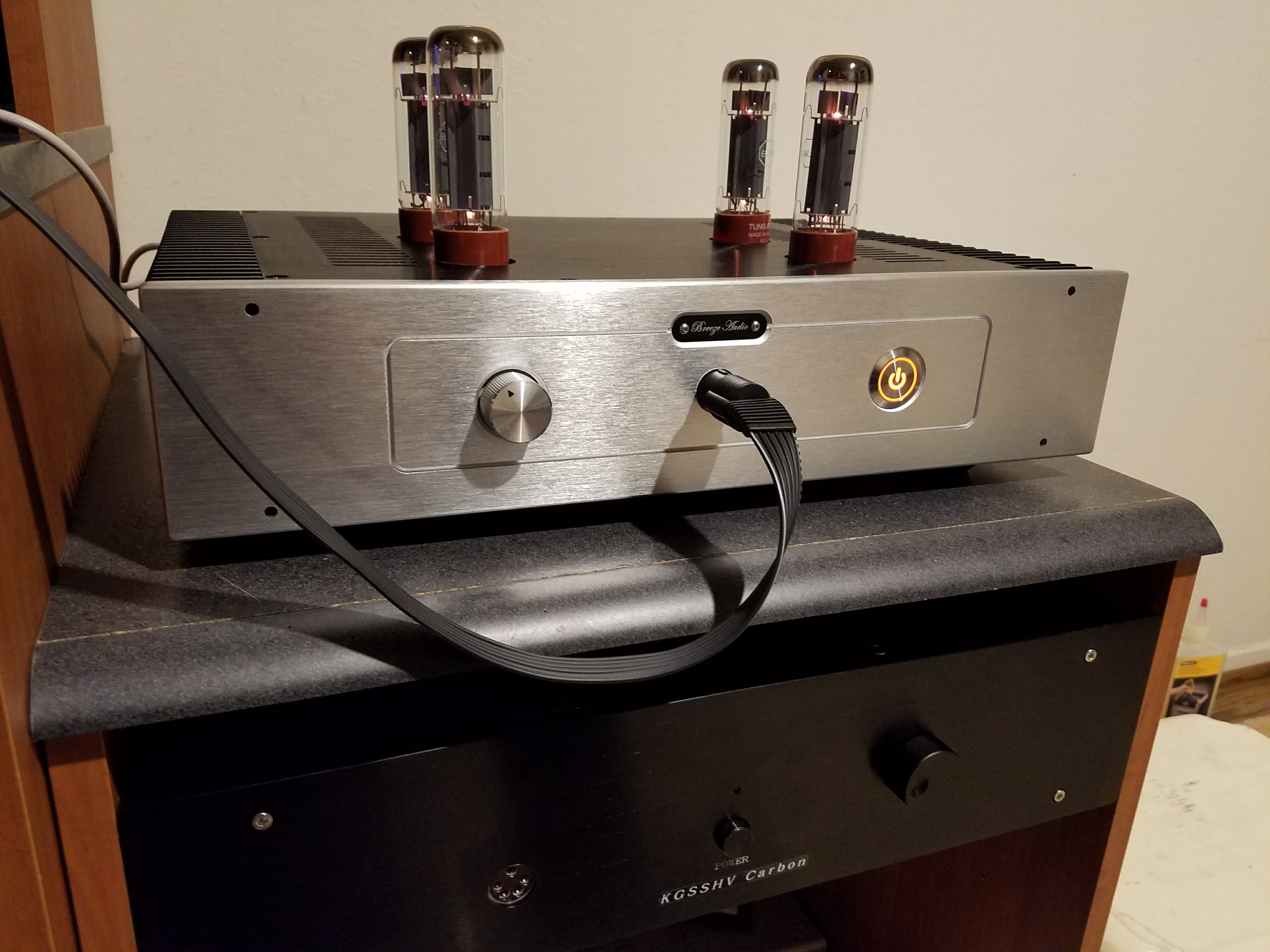

JimL Posted January 23, 2018 Report Posted January 23, 2018 (edited) On 1/20/2018 at 9:57 PM, Blueman2 said: Got the filaments down to exactly 6.0VAC using 0.3R 5W resistors. B+ and B- are both solid now as well. +375V and -378V. About 0.2 drift over 30 minutes of warm up then stays fixed after that. Still comparing to my SRX and Carbon, but the sound is certainly glorious! I know, pics or it didn't happen. So.... Above, you can see that in order to make this fit in a 300mm deep case, I had to create 2 layers of boards. PSUs on bottom, Amps on top, with about 30-40mm of overlap. There was actually plenty of clearance and I could have moved them to overlap even more if needed. I was able to leave enough room in front for the power switch and future quad pot when it arrives. Please don't give me too much crap for the messy wiring. I plan to take it apart next week to add the quad pot and clean up the internal build a bit. I just wanted to prove to myself that it would fit! Also, notice that I am using the 755-SCT2H12NZGC11 as a replacement for the C2M1000170D for the PSUs. It appears to work just fine and runs cool. So we do appear to have a backup device for when the C2M1000170D SiC is out of stock. Also, in the front middle (under the mess of wires) is a timer delay for the CPC1117 HV delay turn on, as referenced earlier in this thread. I have it set for 60 seconds. Above with the tube cages. I have not install yet, but just wanted to see how they will look. That will be next week... And finally, sharing some room with my Carbon. Not pictured are my SRX builds (one mine, one my son's). BTW, so far, the BH runs cooler (both case temp and silicon temps) than my Carbon. Both running at 20ma. Nice! BTW, probably the reason the BH is running cooler is that you've got 70+ watts sitting outside the case (those 4 EL34s at 9 watts filament power plus 9 watts plate dissipation per tube). Edited January 23, 2018 by JimL 1
Blueman2 Posted January 23, 2018 Report Posted January 23, 2018 3 hours ago, JimL said: Nice! BTW, probably the reason the BH is running cooler is that you've got 70+ watts sitting outside the case (those 4 EL34s at 9 watts filament power plus 9 watts plate dissipation per tube). Yea, that must explain it. I had been warned that the BH BJT runs really hot, so was expecting more heat from it. So far, it is maxing out at 39 °C on the heat sinks, and 45-48°C on hottest silicon. Carbon is running 3-5 degrees hotter. Of course, both cases have pretty large heatsinks due to single PSU/AMP case design, which probably helps. 12 hours ago, jose said: You need a Megatron... <FEAR> Nooooooooooooooooooooooooooo! </FEAR> Must resist even reading Megatron thread. Must repeat to myself: I do not need another amp. I do not need another amp. I do not need another amp...... 1
