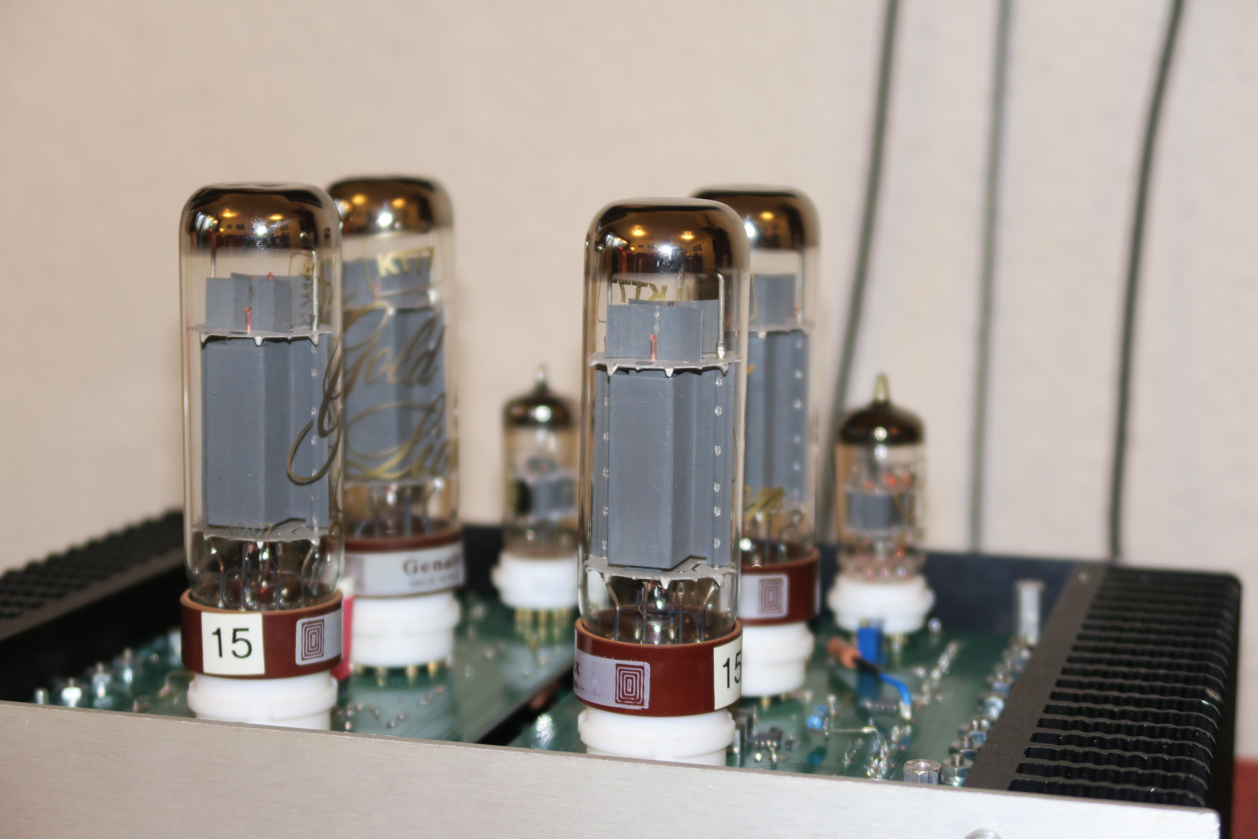

Four Gold Lion KT77 in a mini T2. G3 connected to plate on PCB.
It rocks Beautiful!
