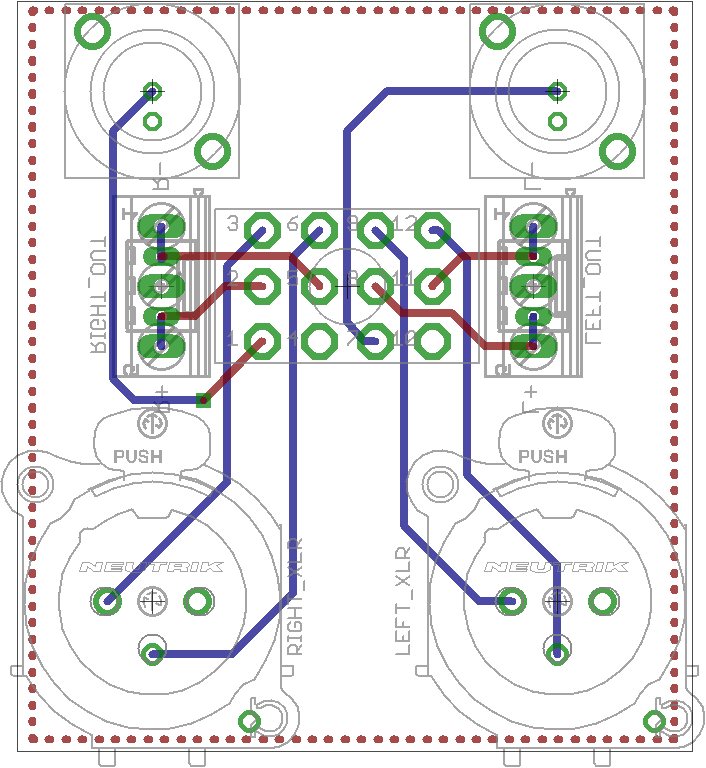

Bought a pair of the Vampire RCAs (ebay) and measured them. I've attached an Eagle library with these in them as well as a board layout using these and Neutrik jacks and NKK switch. I haven't verified any of the board <-> panel spacings yet, but they seem reasonable, with some soldering slop.
Change the file extensions from zip to lbr for the library file.

A note on the board you posted earlier - I'd recommend flipping the schematic symbol or rotating the switch so that all the traces are short and direct. You've got a lot of unnecessary length and an unneeded via. The datasheet for any switch should also tell you the height for spacing needs.

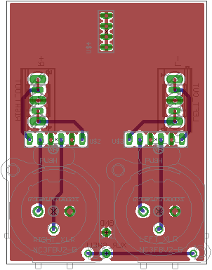

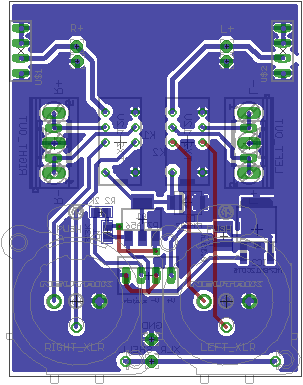

OK. After 2 sets of board runs (pretty much into the trash; fortunately another larger board I need paid for the shipping), I discovered that the Neutrik jacks (as alluded to in willsw's helpful posts) sit too damn high from the board. Even if I had done slots to allow me to push the XLR all the way down, they are still too high, at least for the 4DPDT switch. So, I've decided to do daughter boards. For the mechanically switched board, the switch and Vampire (or ELECAUDIO ER-107) are on the daughter board. For the relay switched version, only the Vampire jacks are on the daughter board, and the main board allows for std. RCA jacks to be wired in. The daughter boards are wired in using standard 2.54mm headers, so distance is adjustable. If I put the Vampire footprint on that board, I'm still not sure that the jacks would reach even with the pins tack soldered on. It would be close, but since I have the boards designed, no point in fucking around.
Switch board, and relay board sets.
