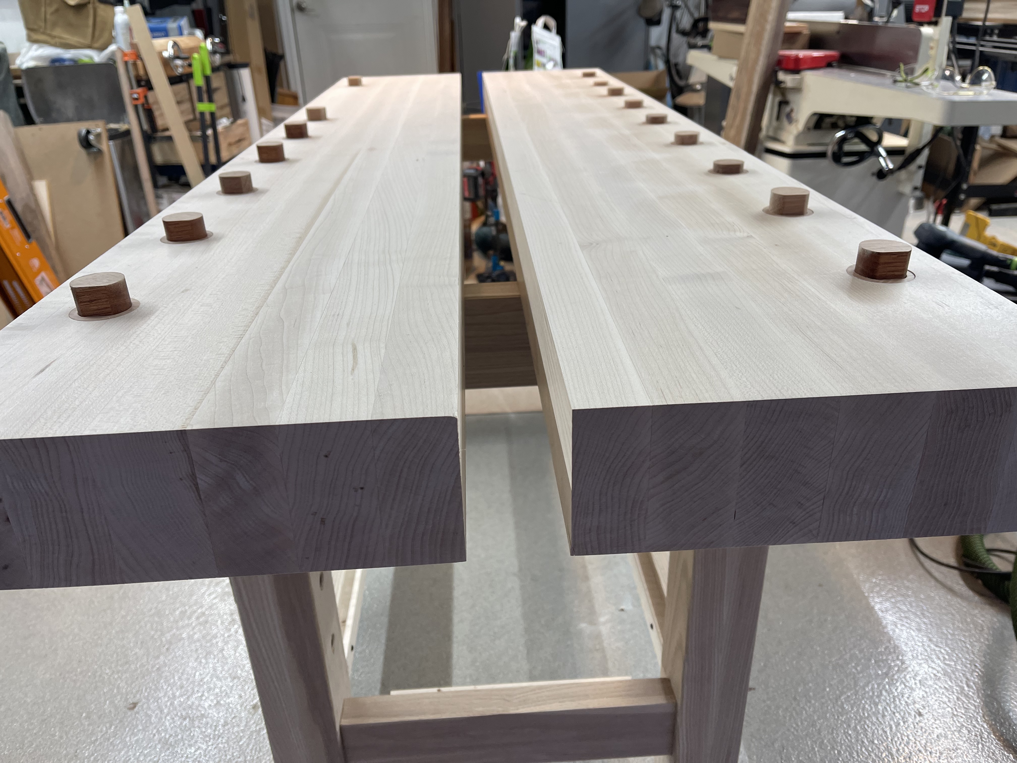

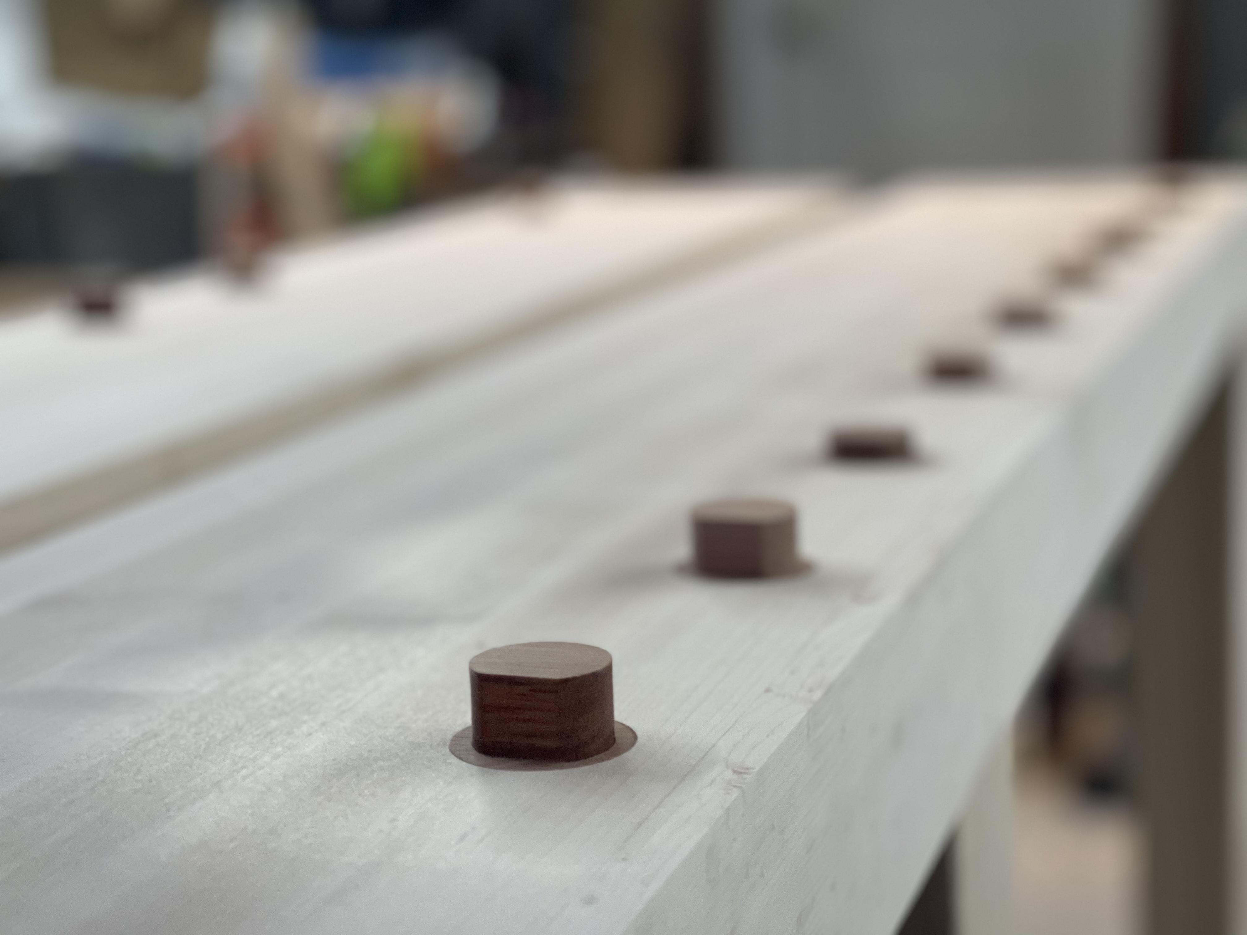

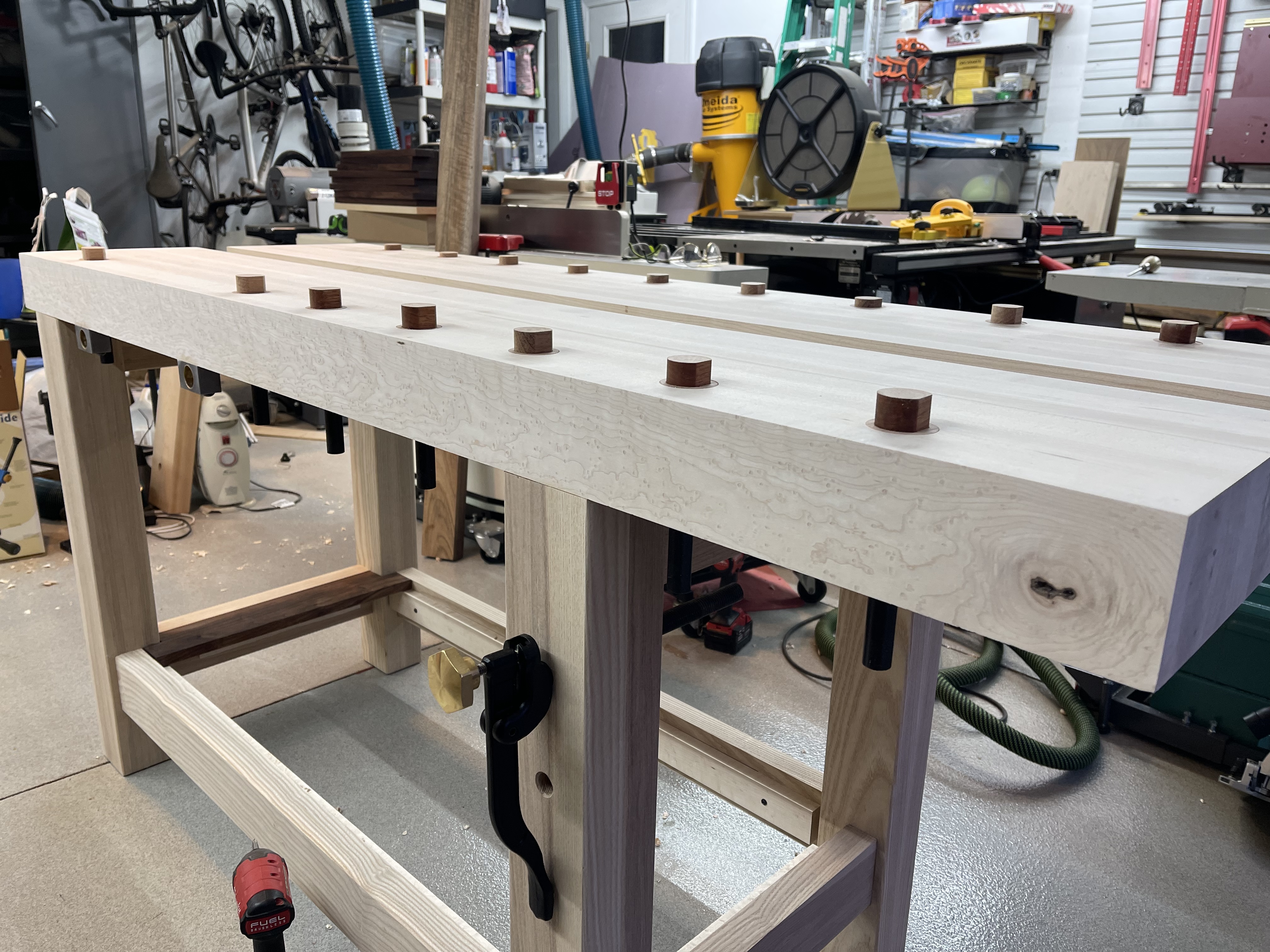

VPI Posted March 30, 2023 Report Posted March 30, 2023 I bought 24 and at the moment only think I will need 7-8, so I am going to start putting dogs on everything. 1

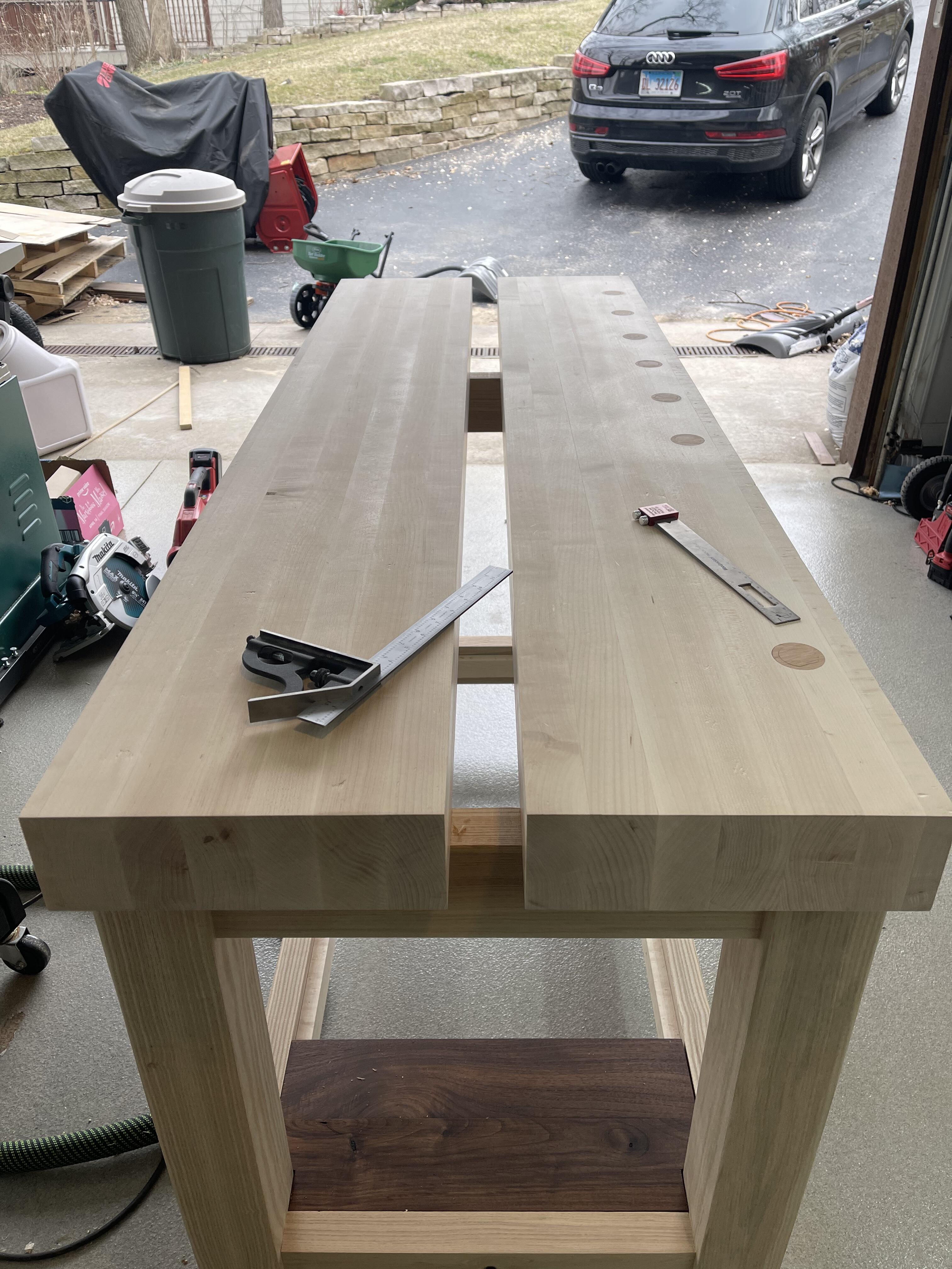

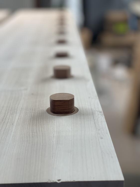

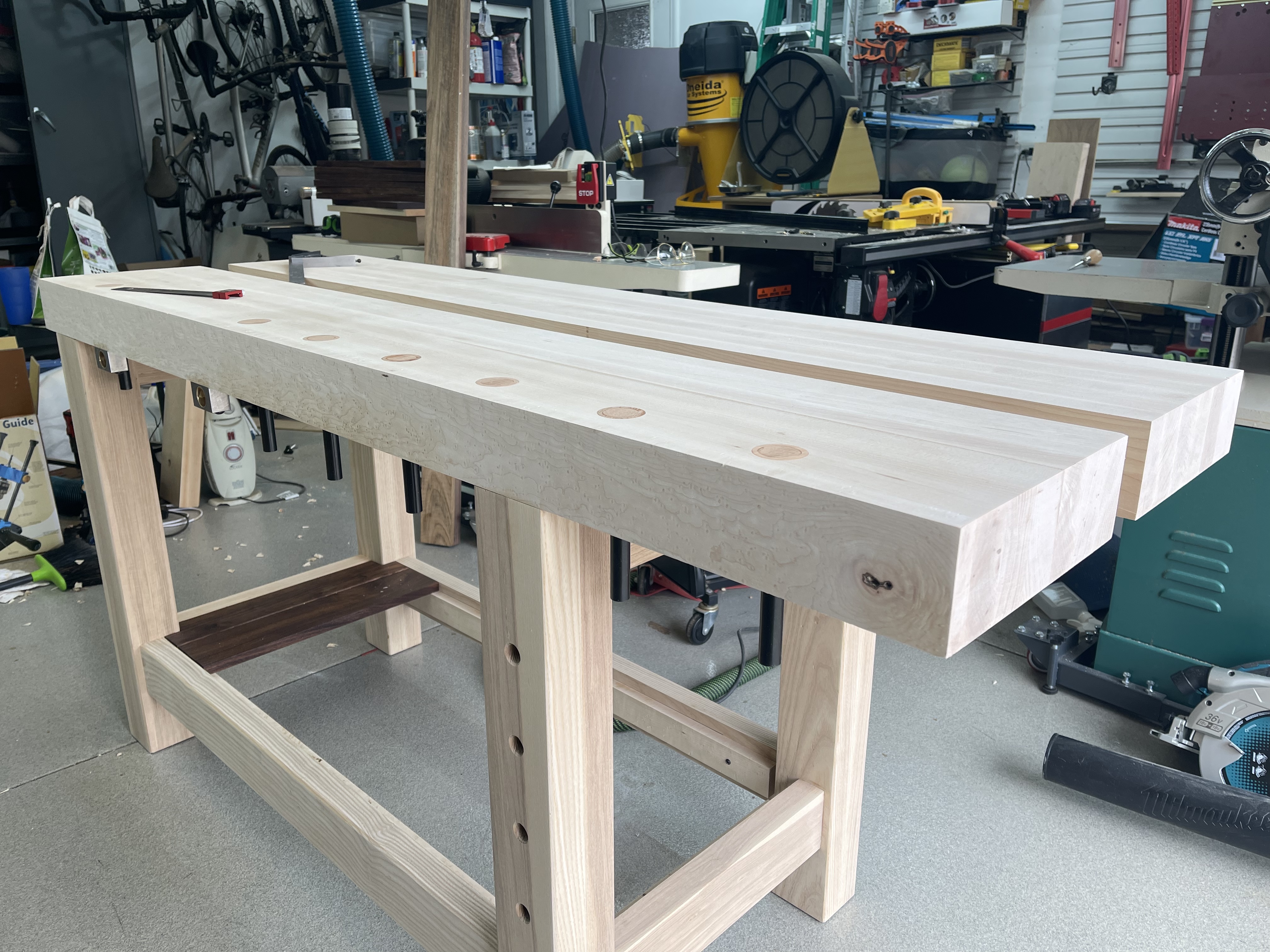

VPI Posted March 30, 2023 Report Posted March 30, 2023 I am down to a decision point on bench dogs. I have almost 20 extra so I am trying to decide if I run a strip down the opposite side of the bench for symmetry or just stay with the single run of bench dogs. Any opinions????

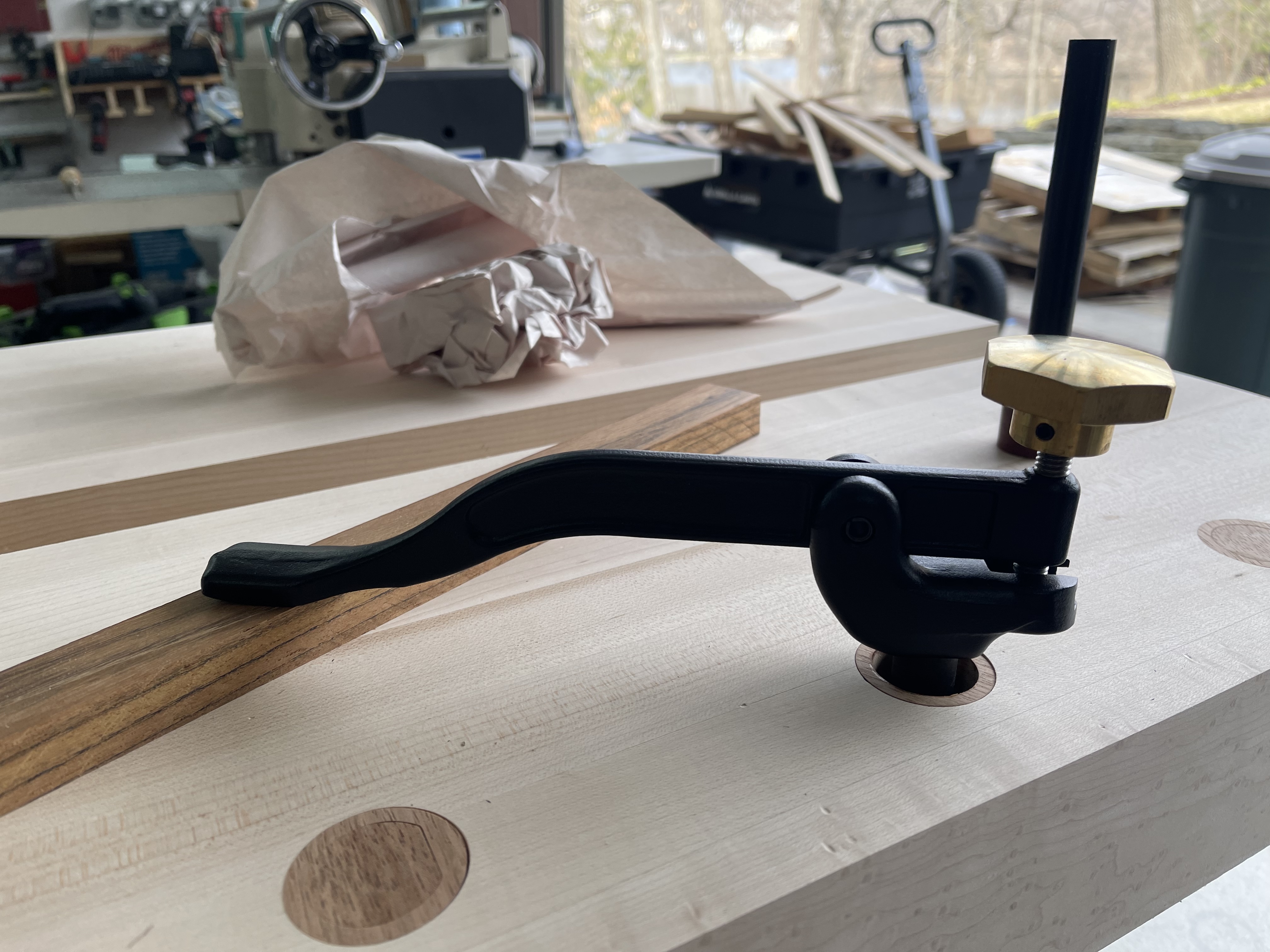

VPI Posted March 30, 2023 Report Posted March 30, 2023 (edited) I will have some regular 3/4” dog holes on that side for the Veritas whatever dogs/hold downs. Might start getting Swiss cheesy, but I guess I can supposed use them with the 3/4 through holes made for the In-Kleind bench dogs. Edited March 30, 2023 by VPI
Voltron Posted March 30, 2023 Report Posted March 30, 2023 I would not add a third row if you are doing ¾ holes already.
VPI Posted March 30, 2023 Report Posted March 30, 2023 The 3/4 holes were just going to be maybe 3 in the middle for the hold fasts. Mostly for domino holding, etc. Looks like the Veritas ones work great if I remove the dogs from the In-Kleind setup. 1
dsavitsk Posted March 30, 2023 Report Posted March 30, 2023 More is better. I have a crappy bench that is covered in them, and it is still not enough.
Voltron Posted March 30, 2023 Report Posted March 30, 2023 I'm back to my original answer given your response and Doug's experience.
Voltron Posted March 31, 2023 Report Posted March 31, 2023 Agreed. And I would probably buy some of your extra doggies if you don't want to throw some onto your dining table or wherever 1

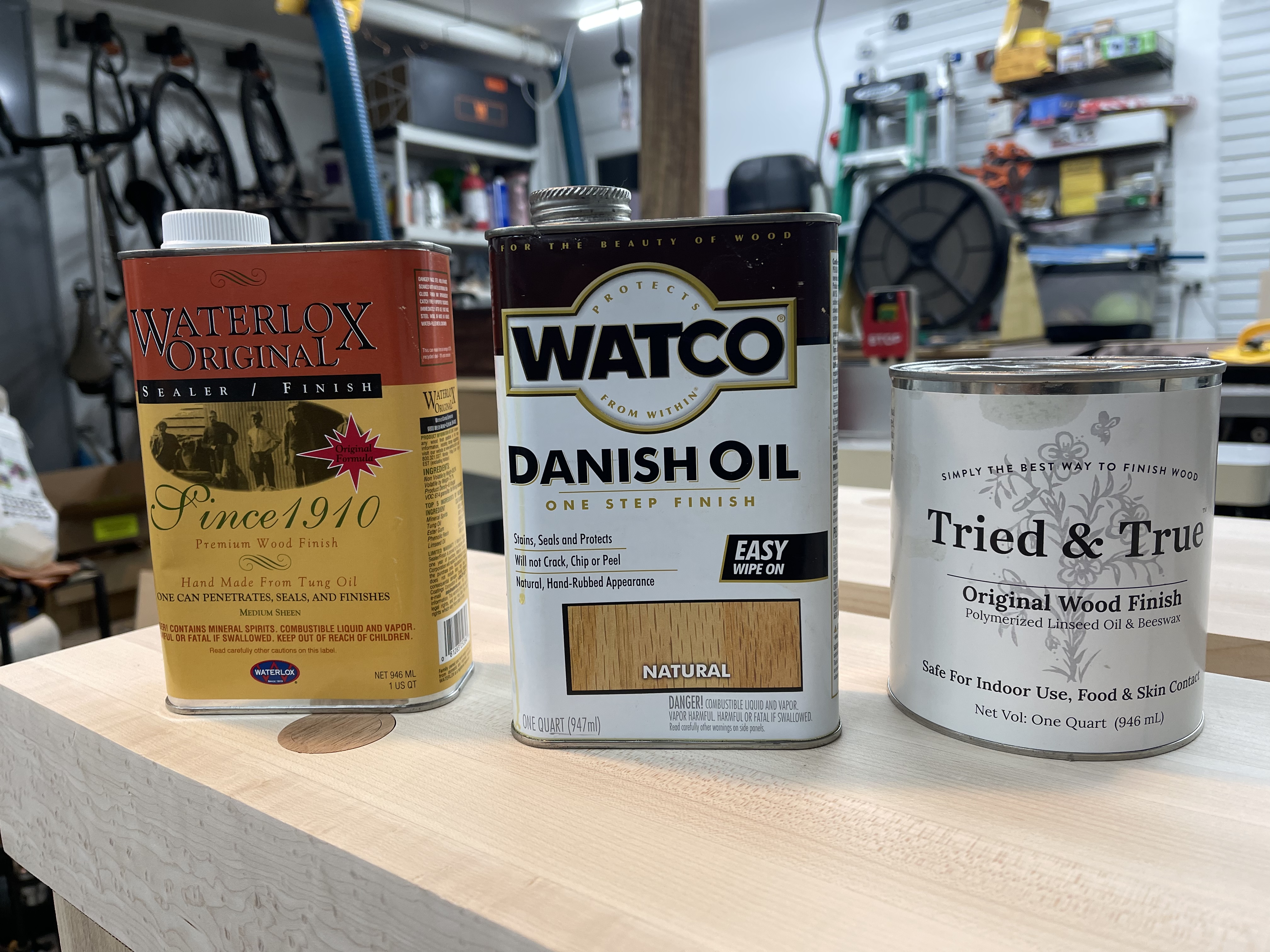

VPI Posted March 31, 2023 Report Posted March 31, 2023 (edited) Thanks guys. Luckily none of you have to see it in person to pick out all the issues I have. Next poll, which finish for this thing. I know Naaman used Tried & True and some big bench nerds recommend Waterlox and about everyone else recommends Danish Oil. Cannot decide. Al, since you guys convinced me to add them to the other side I will only have 6-8 leftovers. If you want to use them on your bench let me know. The require a 1 5/8” Forstner, 3/4 auger and a Brad point 3/8” bit for the magnets that hold the dogs at whatever height you want. Edited March 31, 2023 by VPI
swt61 Posted March 31, 2023 Author Report Posted March 31, 2023 From what you have there, Tried & True, not even an option in my mind. 2
naamanf Posted March 31, 2023 Report Posted March 31, 2023 (edited) 7 minutes ago, swt61 said: From what you have there, Tried & True, not even an option in my mind. What I used, but being a shitty woodworker my bench gets used more as a giant charcuterie board. Edited March 31, 2023 by naamanf 2
swt61 Posted March 31, 2023 Author Report Posted March 31, 2023 18 minutes ago, naamanf said: What I used, but being a shitty woodworker my bench gets used more as a giant charcuterie board. And what is wrong with that?
Voltron Posted March 31, 2023 Report Posted March 31, 2023 I still like Tried & True original. I've never experienced the annoyances with it that people complain about. And so easy to update with a new coat
dsavitsk Posted March 31, 2023 Report Posted March 31, 2023 I suspect that the people who complain are expecting something that works more like a poly and who don't want to put in the necessary elbow grease The danish oil is a lot thinner and easier to apply
swt61 Posted March 31, 2023 Author Report Posted March 31, 2023 Applying oil can be a difficult thing. 1 1

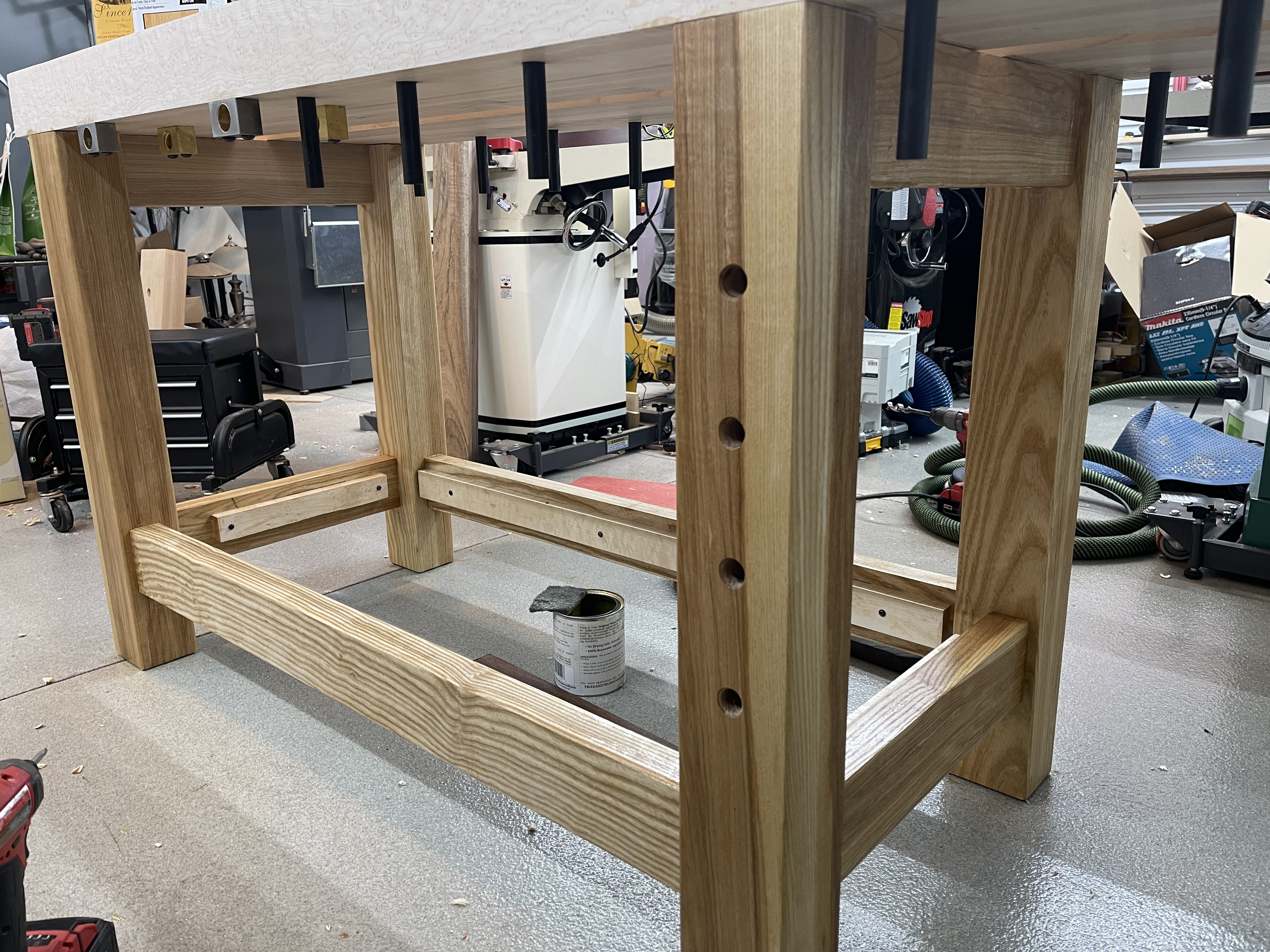

VPI Posted March 31, 2023 Report Posted March 31, 2023 My main concern with the tried and true is that I did the shelf with that and sawdust seems to stick to it like crazy. Maybe I did not rub off enough of the excess, I kind of treated it like I do Odie’s with a sander buffing pad to remove excess.
swt61 Posted March 31, 2023 Author Report Posted March 31, 2023 That's it exactly. You need to buff off all of the excess after how ever many minutes stated on the label. Al uses a buffing pad on his Festool orbital sander. That works nicely.

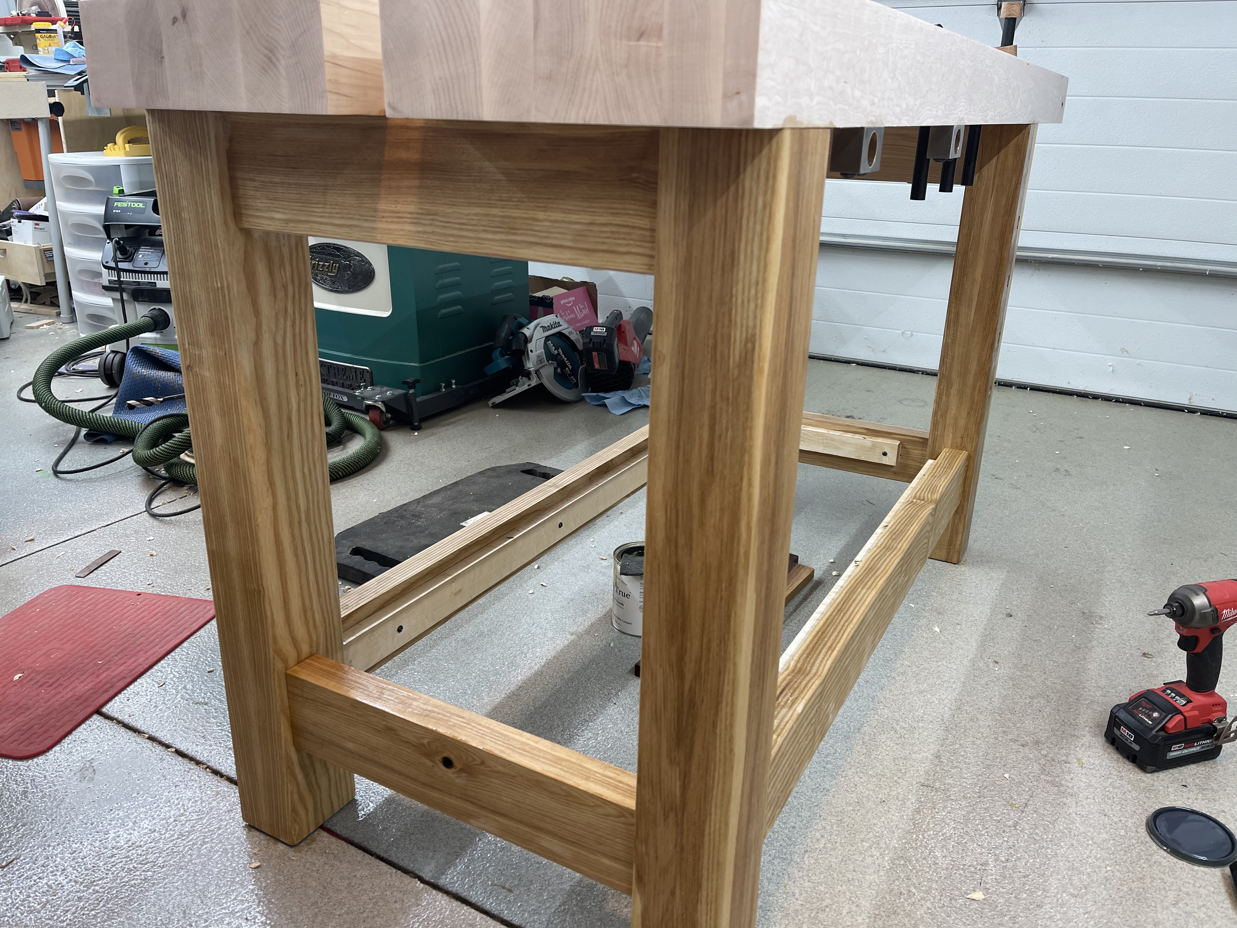

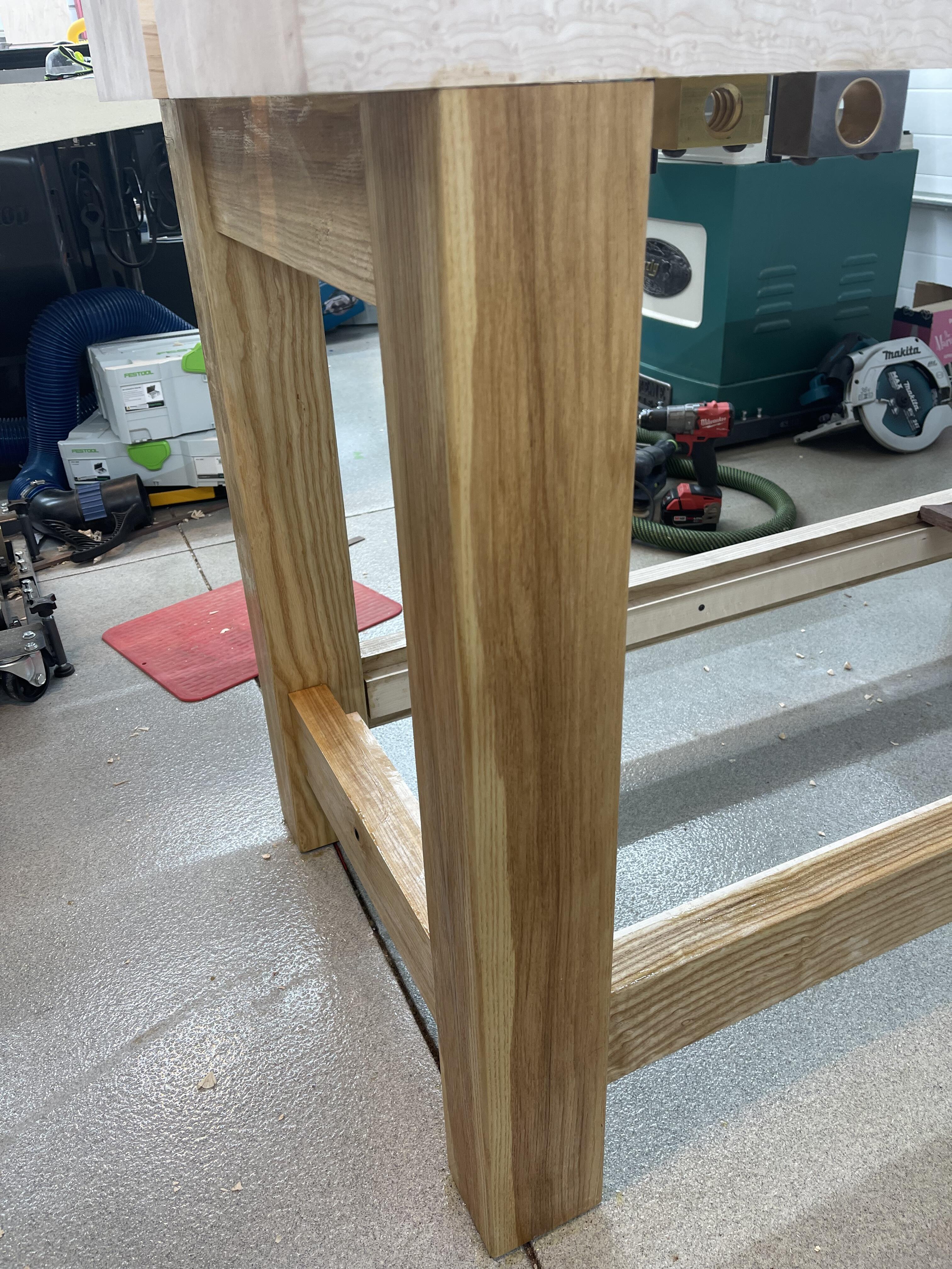

VPI Posted March 31, 2023 Report Posted March 31, 2023 Applied a first coat of Tried and True on the base (ash). Kind of wish I had treated the Ash with a water based finish, as it went from looking okay to looking Home Depot lumber real quick with the yellow tint. 2
