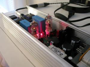

luvdunhill Posted July 8, 2010 Report Posted July 8, 2010 action shot [ATTACH=CONFIG]3347[/ATTACH] Doug: With respect to the noise, you could try a low ESR cap for C5 (tantalum) perhaps?
