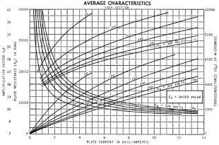

I was wanting to up the gain while I'm in there to up the current as you recommended above. Any recommendations here? I don't have a single can that I use below 70% of the pot and all in fact are comfortable at 100% if the source material is recording at a low level. My source is 2vrms output and cans are all (properly damped) orthos.
Gain is what it is. It is slightly adjustable depending on the impedance of the bias and the amount of current, but not enough here that you'd ever notice. I have my doubts that this is appropriate for orthos, though there is no reason to not turn the dial up to 70 or 100%.
