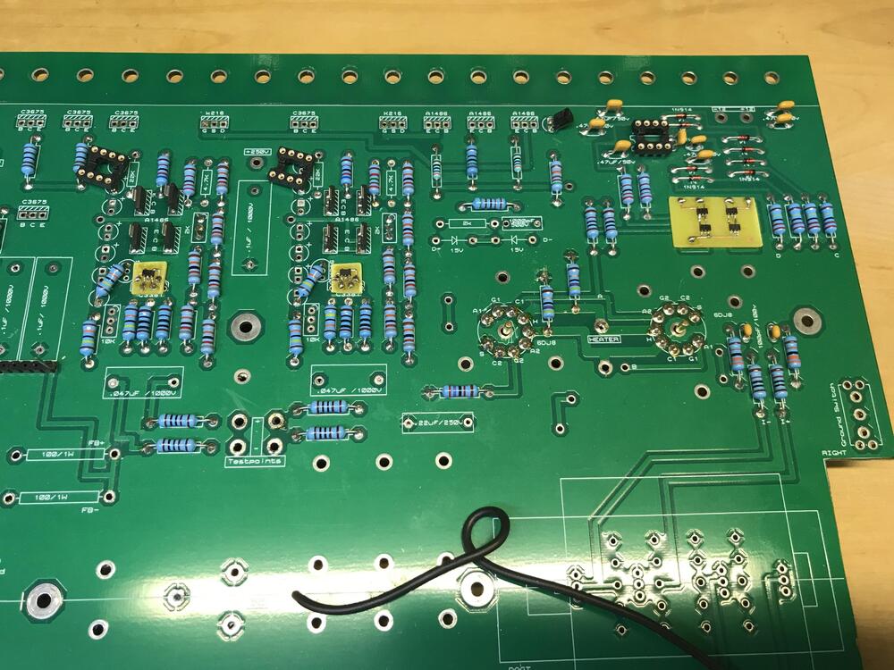

  23. Now completed mini T2 with the new boards version .23. Squeezed in film caps with 0.8 mm leads on right channel with 0.76 mm hole diameter, elevated and soldered both sides (see below). Both channels worked right away. Only issues I’ve found with those new boards are mentioned in posts above.
  24. Warning! 0.1u/1kV film cap pads on right channel have 80-30 pads meaning hole diameter is 0.030 in or 0.76 mm. This is to tight for most film caps that have lead diameter of 0.8mm. There are some Panasonic, Cornell Dubilier, Nichicon and Vishay caps with 0.6 mm leads and 15 mms lead spacing. Do not drill the holes for the film caps. The through hole plating is needed as it ties ground planes together and also needed for -460V to be fed to none tube side of the board. Left board have 90-40 pads – 40th or 1.0 mm. This mistake is done by me and the blame is entirely on me. I’m sorry.
