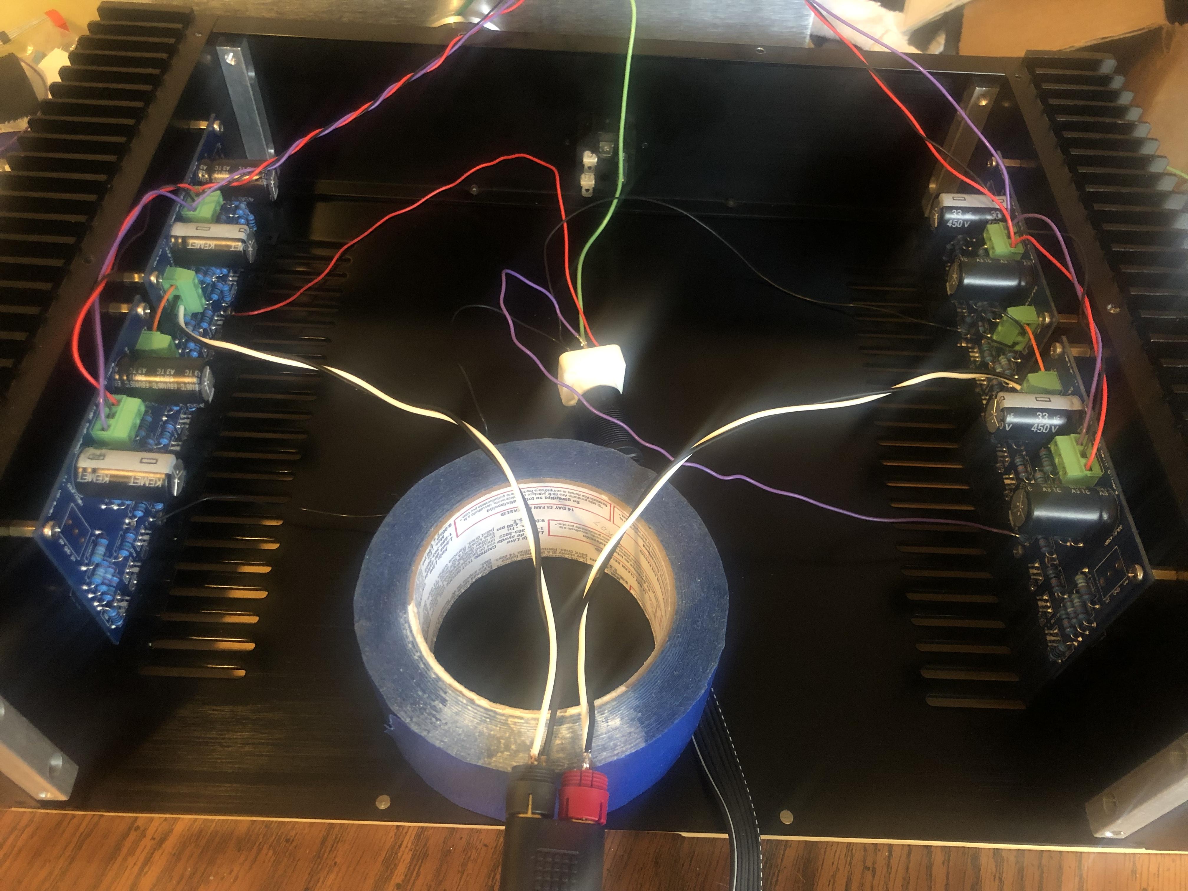

  12. Another Gilmore CFAE is first powered up. No smoke, no POP, no drama. I used the first GB split PCBs for this build. All part values per the PCB. Powersupply for the moment is a BHSE from an old KGST: B+ = +353.8; B- = -358.1 Left Channel Offset: +7.19/+10.53; Balance: 3.34; Bias(mA): 8.28/8.24/8.23/8.15 Right Channel Offset: +8.42/+8.91; Balance: 0.49, Bias (mA): 8.35/8.23/8.68/8.60 After an hour, heat sinks are barely warm to the touch. Hooked up with an iPhone X direct input as source and STAX 207 it sounds very promising. Will swap in a TKD volume pot soon to see if things improve ditching the distal volume control. Thanks to all, especially Kevin, Congo5, Joachim, Michael, and Jose.

  17. I was only curious what Jose was using, as my heat sinks are about the same size as his. For first power up, I wanted to be able to run them awhile without worry as a baseline. Did not wish to cause big confusion here for no reason. Thanks to each for your input.
