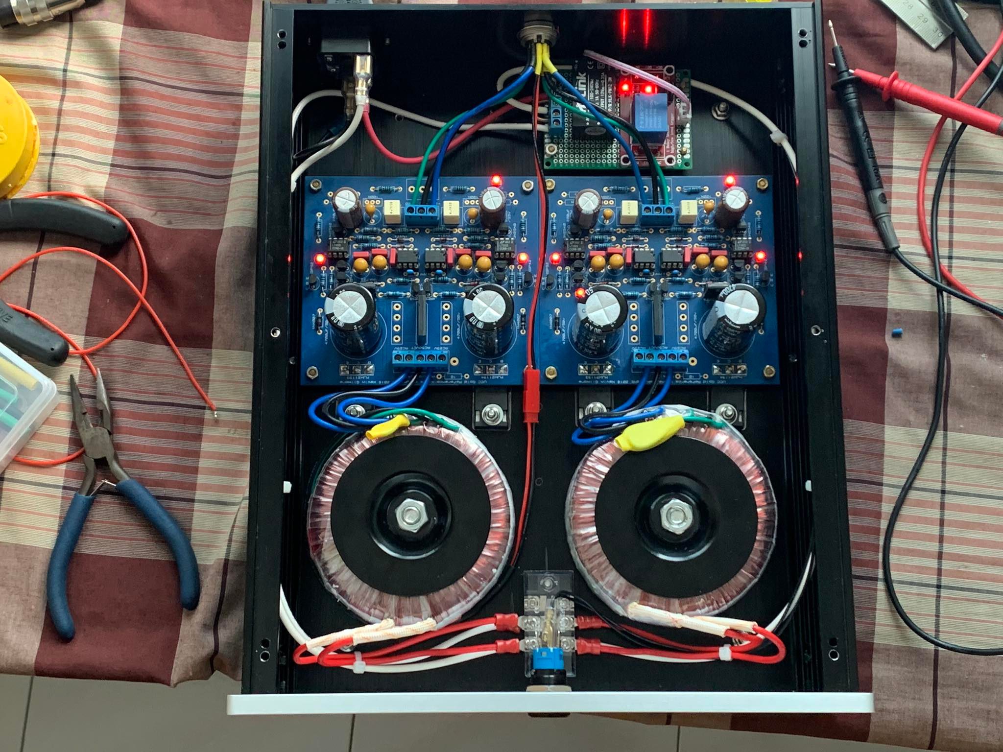

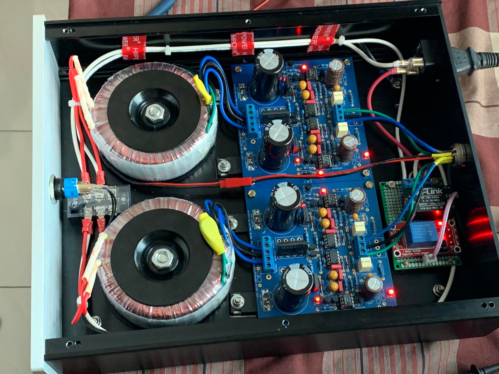

  4. Sounds all good then. My GRLV runs probably around 40-45°C but the case for PSU only has vents at the top panel and no bottom panel holes (hard to convect heat if there's no air inlet at the bottom). It's not as hot as Dynahi heatsinks.
  5. What's the normal temperature for the transformer and PSU of a pair of GRLV powering Dynahi?

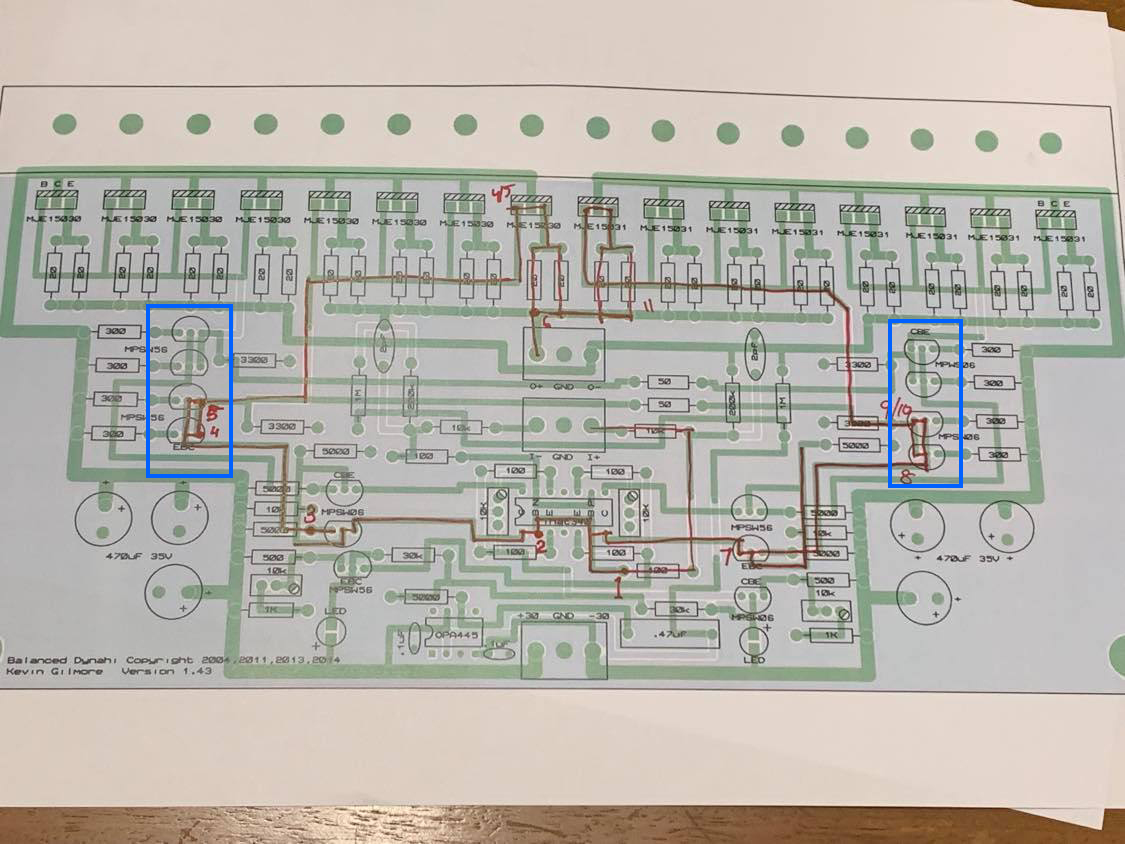

  8. Thanks. I’m currently using MPSW parts from eBay. My assumption is they’re genuine but it’s been years ago so I can’t check anymore. Bought as a lot for 06 and another lot for 56. I matched them by HFE with a diy transistor tester.

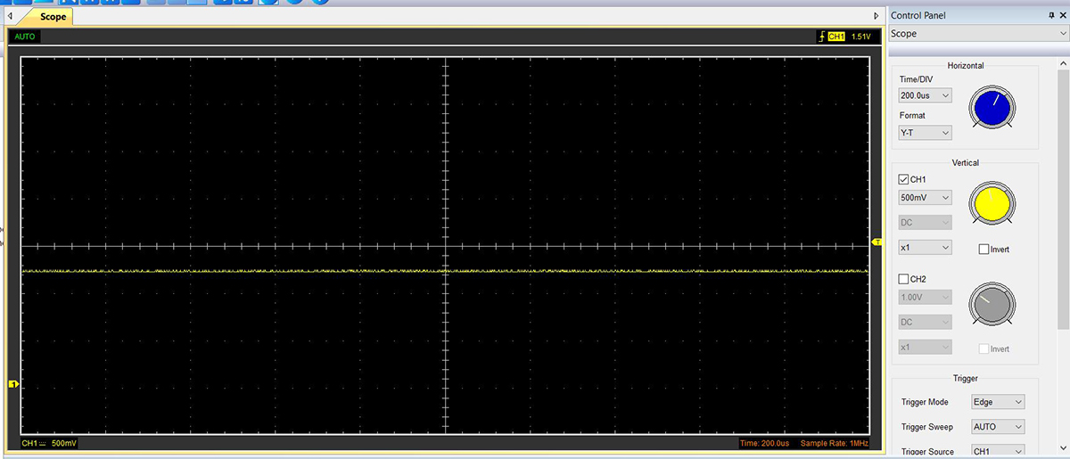

  9. After replacing the input devices with K170/J74 I'm still hearing noise from the single ended out (with sensitive headphones). It sounds sort of like a frying sound that comes and goes. I probed the amp with my USB scope. The signal from FET devices and the first transistor is very clean (Q4, Q5). I found the noise came from the transistor pairs before the power transistors. Not sure what causes this. Is it because they're not closely matched? Is it dirty power?

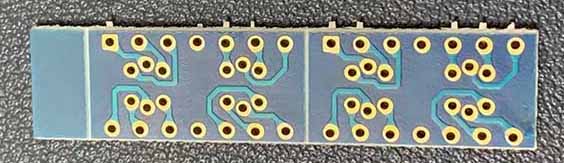

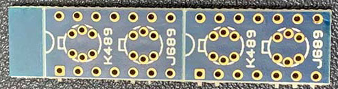

  11. Just found these k849/j689 adapter boards with incompatible traces from last time's group buy. I could probably adjust these instead to make them pin compatible with back to back J74/k170

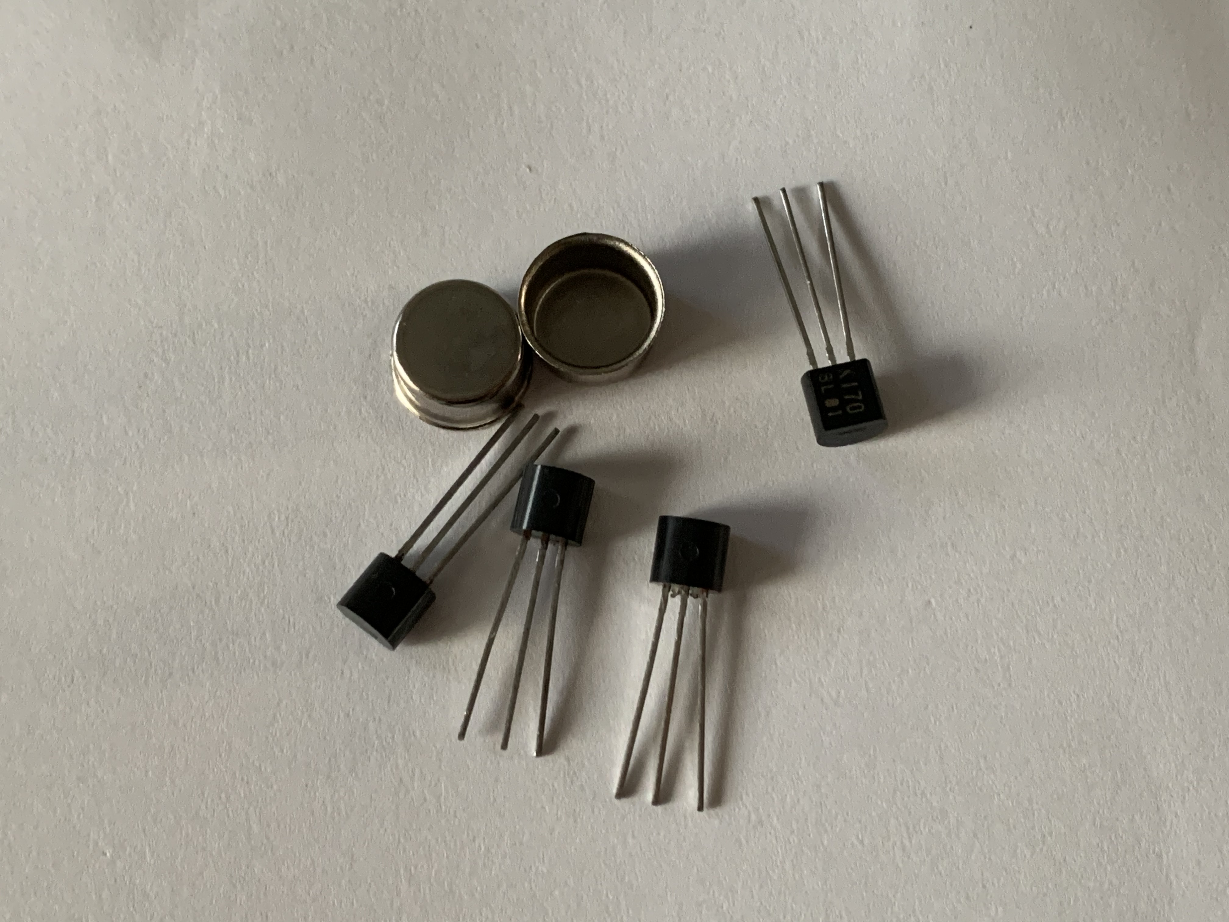

  12. Received my j74/k170 from punkydawgs the other day. He even included some metal cans to thermocouple the packages. Installed in my Dynahi today (left channel shown) and did some bias checks. All look good. The difference between left and right is just a bit perceptible I’ll fabricate some adapter board with protoboard if feasible so I can heatshrink the packages back to back. If can’t I’ll just use the included metal cans with some thermal paste.

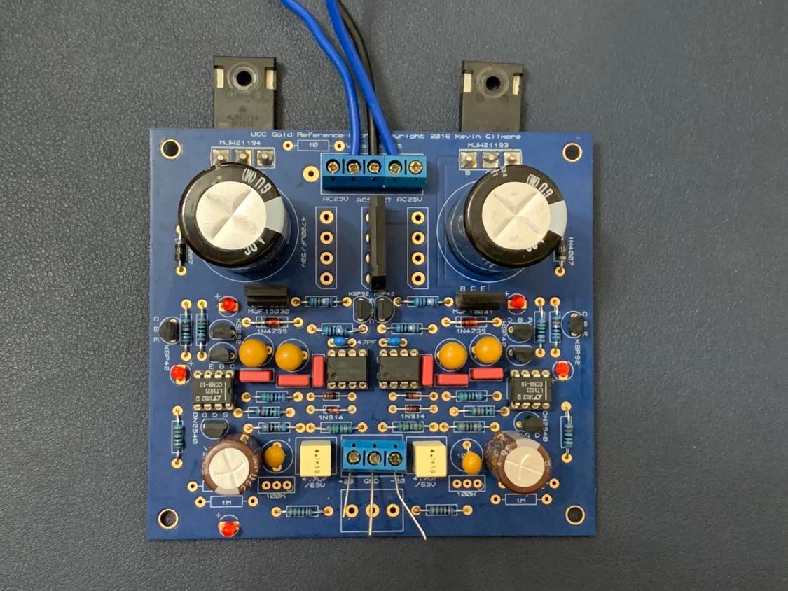

  14. ***Edit 2: Seems that the BR was faulty, it works fine now. Can someone suggest me where I can start troubleshooting? I have a GRLV set for 30V that worked previously with a dual transformer. I got myself a center tapped transformer and adjusted the bridge rectifier accordingly - only one in the middle. Wiring in is correct for a center tap. The GRLV blows a 1A fast blow fuse every time turned one. Left side +30V has time to reach +30V before the fuse trips while the right side -30V will not light up in time. Transformer is 100VA 30V - 0 - 30V The bridge rectifier is reused from the same board **Edit Here are my findings If I connect only the center and right terminals, the whole board works fine. + and - 30V on the outputs If I connect only the center and left terminals, the board reads wrong and the bridge rectifier heats up. I think the BR is toast from desoldering. I'll try taking it out and testing
