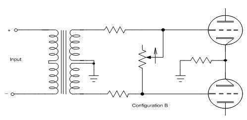

the idiot at eddie current was big on that circuit. and did that on his electra.  and then tried to get too much gain out of it. and the tubes went into saturation and then you have to hand pick the tubes etc.  biggest problem with that one is the 100k pot starts off with 2nv of noise all by itself.
Yeah, never seen anybody except the hack Craig actually use that one.

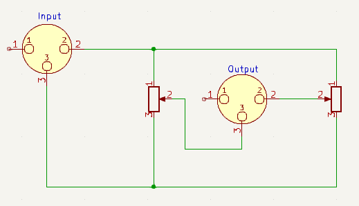

I may be a hack, but I switched from using 4-gang pots to shunting stereo pots because I think they work better.
A big part of the reason why I would build a balanced circuit is to benefit from its CMRR (and even order distortion cancellation by proxy). I measured the matching between gangs on a 20k RK27; it's better than the specified 20% tolerange, but it's not great. Here are some measurements at arbitrary rotations.

The matching is directly proprotional to the CMRR. So I took a measurement of CMRR using the following circuit.
The idea is that this simulates the balanced input of an amplifier and will tell us how balanced things actually are.
Not very, it seems. Each trace is a different rotation angle on the pot, with the -115dB one being with the signal fully shunted. (There is some resitual resistance with the pot at 0.) -35dB of CMRR will significantly degrade an amp's performance.
I repeated the measurements with a shunting pot configuration, using Yageo 1% 2k resistors and the same 20k pot.
Although the AP input capacitance degrades CMRR at high frequencies, even the worst 1kHz measurement is about 12dB better than the best measurement with the series pot. The low frequency degradation is most likely caused by the AP's 1/f noise-- we're measuring microvolts at this point.
If I wanted to further improve performance, I'd use resistors with better matching. The Vishay ORN arrays are available in 0.01% and would probably be my pick. LT5400 isn't bad either.
https://www.mouser.ca/ProductDetail/71-ORNTA1001ZUF
I don't know that this is necessarily relevant to the design in the first post-- looks like it doesn't use a pot at all-- but the circuit has its place. :)

I think you are not measuring CMRR, but rather the common mode to differential mode conversion ratio. With the ‘conventional’ dual pot connection, the common mode signal at the input is attenuated at the same ratio as the differential signal; while with the shunt connection (without the help of a line isolation transformer), the common mode signal is not attenuated at all. Apx has common mode drive, why not use it to evaluate CMRR?
So complicated. Like the volume mute function.
I think you're right-- thanks for picking up on this. I do still think it matters; if the CM signal is getting converted to DM, the system's CMRR will be limited, no?
Bill Whitlock of Jensen makes a big kerfuffle about balanced impedances. Here's an AES presentation that you may have seen. It's a bit goofy, but gets the point across.

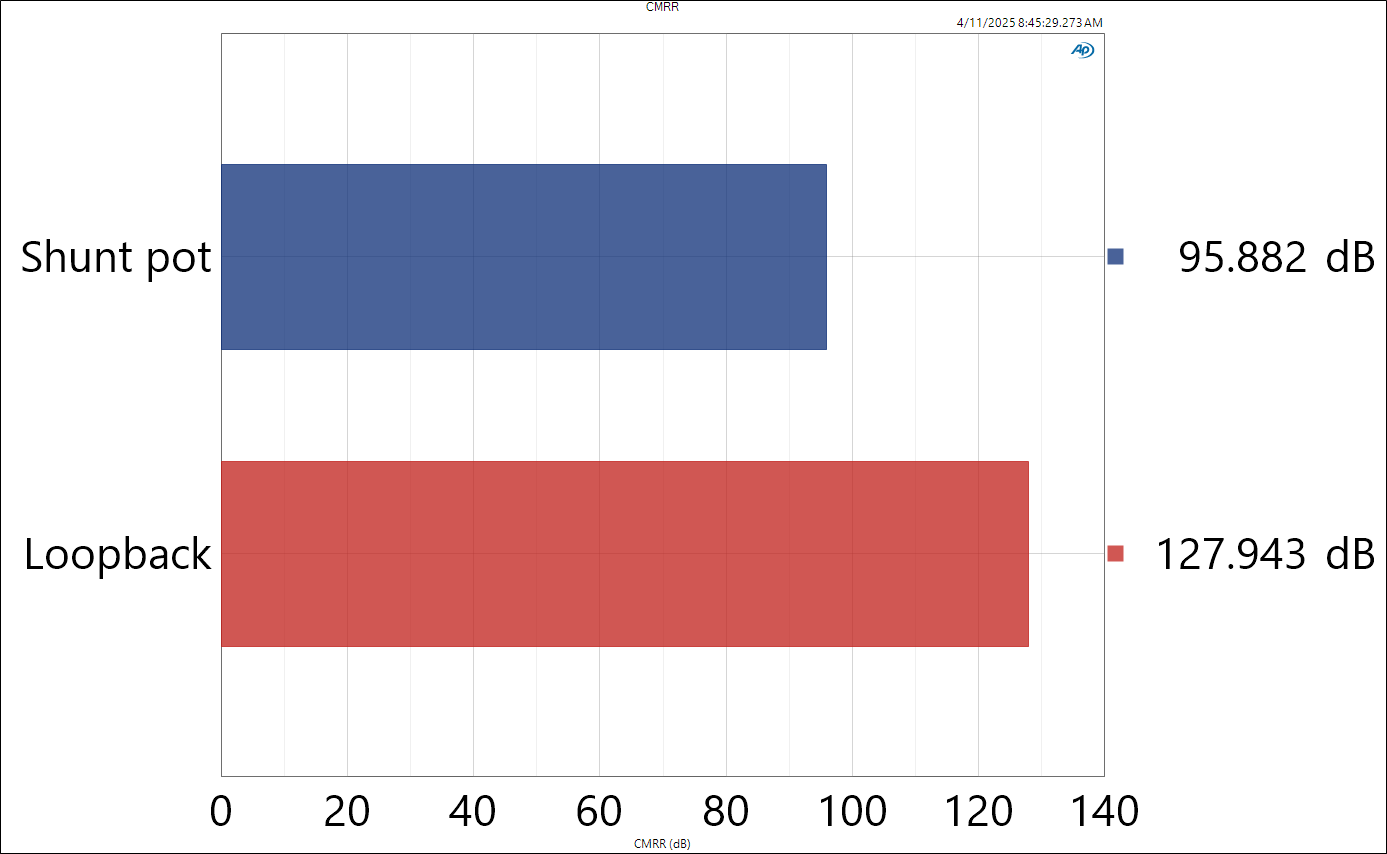

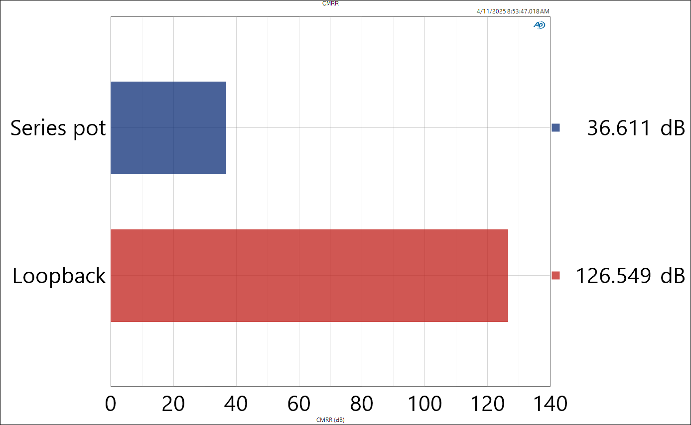

It can't do sweeps and I don't think it can append results in APx500 v4, but here are some results tested at 1kHz with a 1VRMS signal.
I tabulated some data at different positions. Looks like there is a "sweet spot" with the conventional pot hookup, whereas the shunt pot does very well once you clear the first few degrees of rotation.

I’m surprised to see the series pot only gets 16dB CMRR at min position. The attenuation at that position would have been much higher than 16dB already, for both common mode and differential mode signals. Did you use the same schematic in your earlier post to connect the series pot when using the APx CMRR measurement? I think the source XLR pin1 should be connected to input XLR pin 1, and series pots’ pin 1,3 should be between the source XLR pin 1 and 2/3 respectively, like how you would connect in a real system.
I was also surprised to only get 16dB at min with the series pot. To take the measurements in my last post, I did connect the pot as you describe, as if it were the input of an audio amplifier.
To make the measurement, the analyzer sends a balanced differential mode signal measurement, then switches its relays to output a common mode signal and measure the output. It then calculates the ratio of the DM measurement over the CM measurement. With the pot in the minimum position, I'm guessing that the DM signal is attenuated enough that the noise floor eats into the measurement accuracy. There's some 40dB (!) of CMRR degradation on the shunt pot configuration as well at the minimum position.
To test the theory, we could boost the test signal level... But I feel confident enough to say that the shunt pot offers better CMRR without repeating the measurements.
