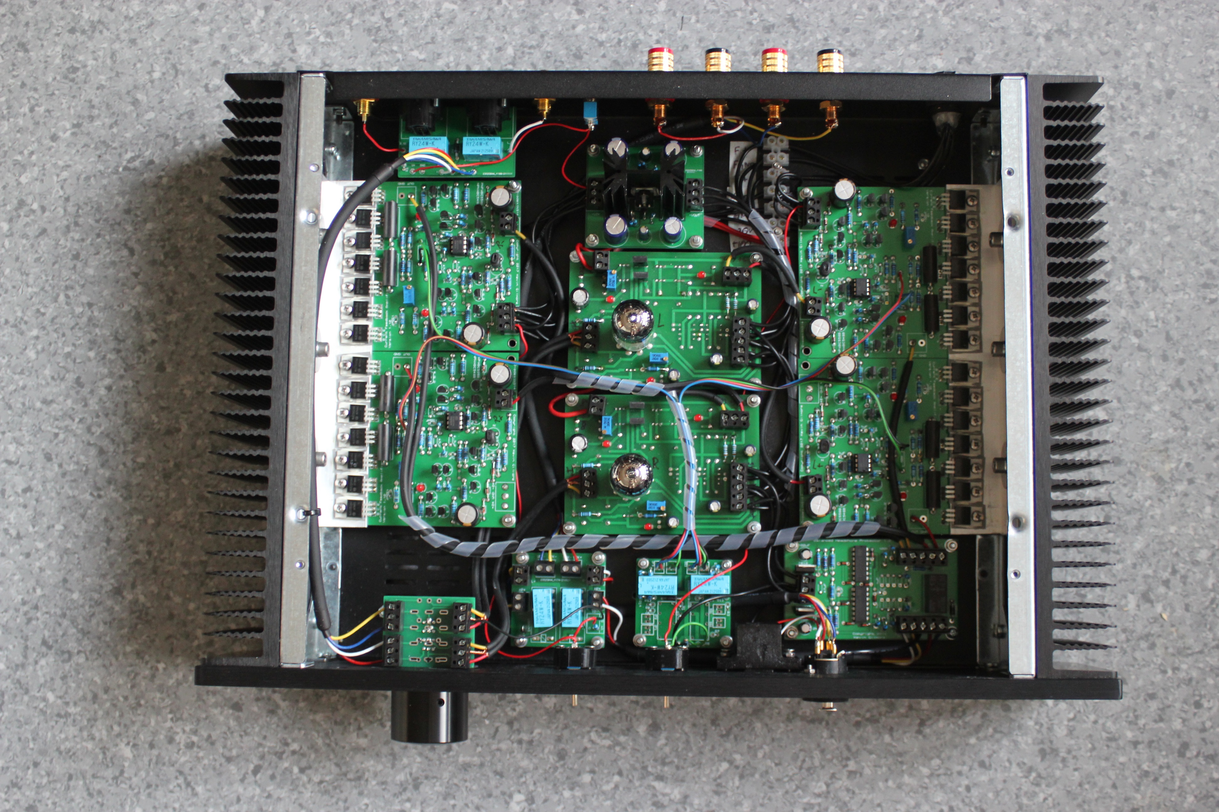

Satyrnine Posted May 17, 2023 Report Posted May 17, 2023 (edited) Here's one of Dukei's he sent me. Primo work as usual: Edited May 17, 2023 by Satyrnine 5

audiostar Posted May 24, 2023 Report Posted May 24, 2023 On 5/23/2023 at 9:20 AM, ang728 said: so after some fiddling around , now my CFA3 working perfectly.I replaced all my old stock BC546/556 to newer parts with roughly matching,offset still 40mV w/o Servo but no big difference switching back to 300ohm maybe my problem comes from some crooked old BC parts...? I dunno but fixed anyway lol Those large boards on top look interesting.
