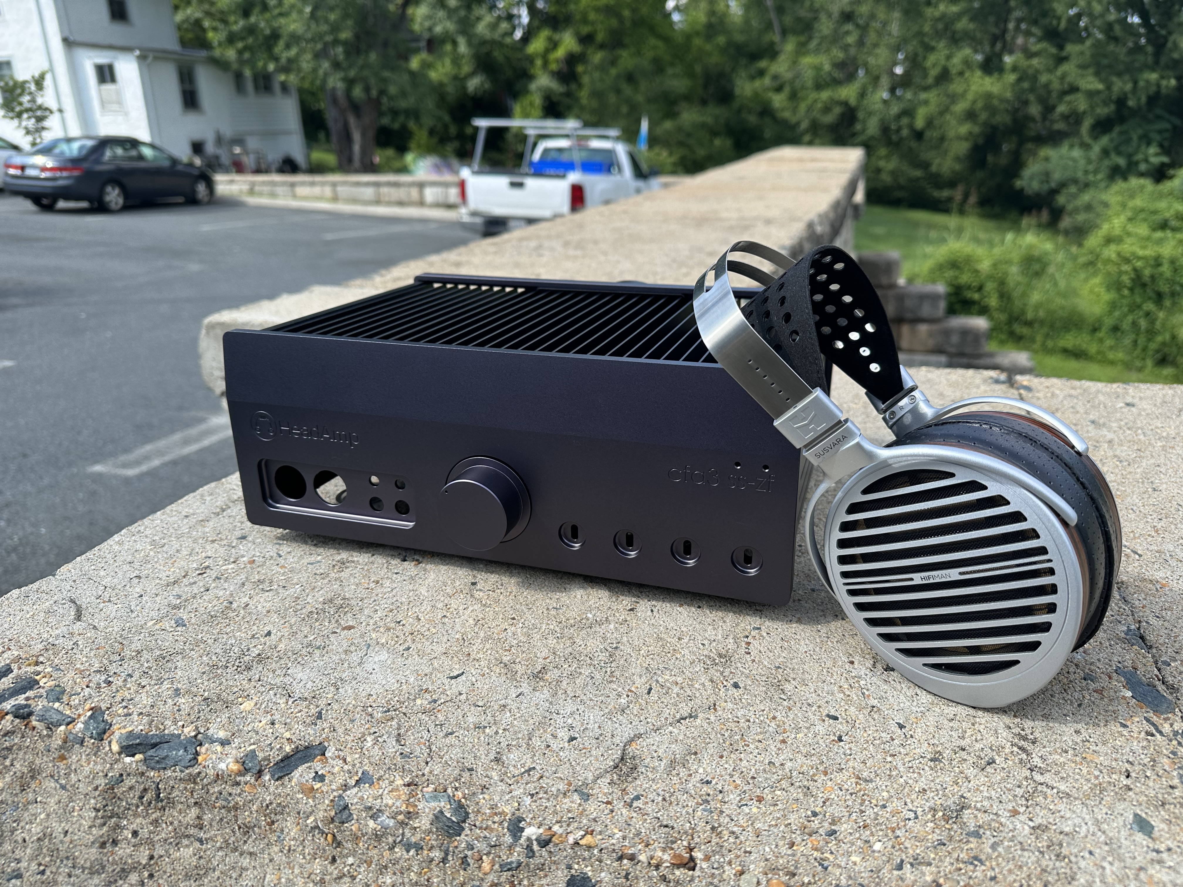

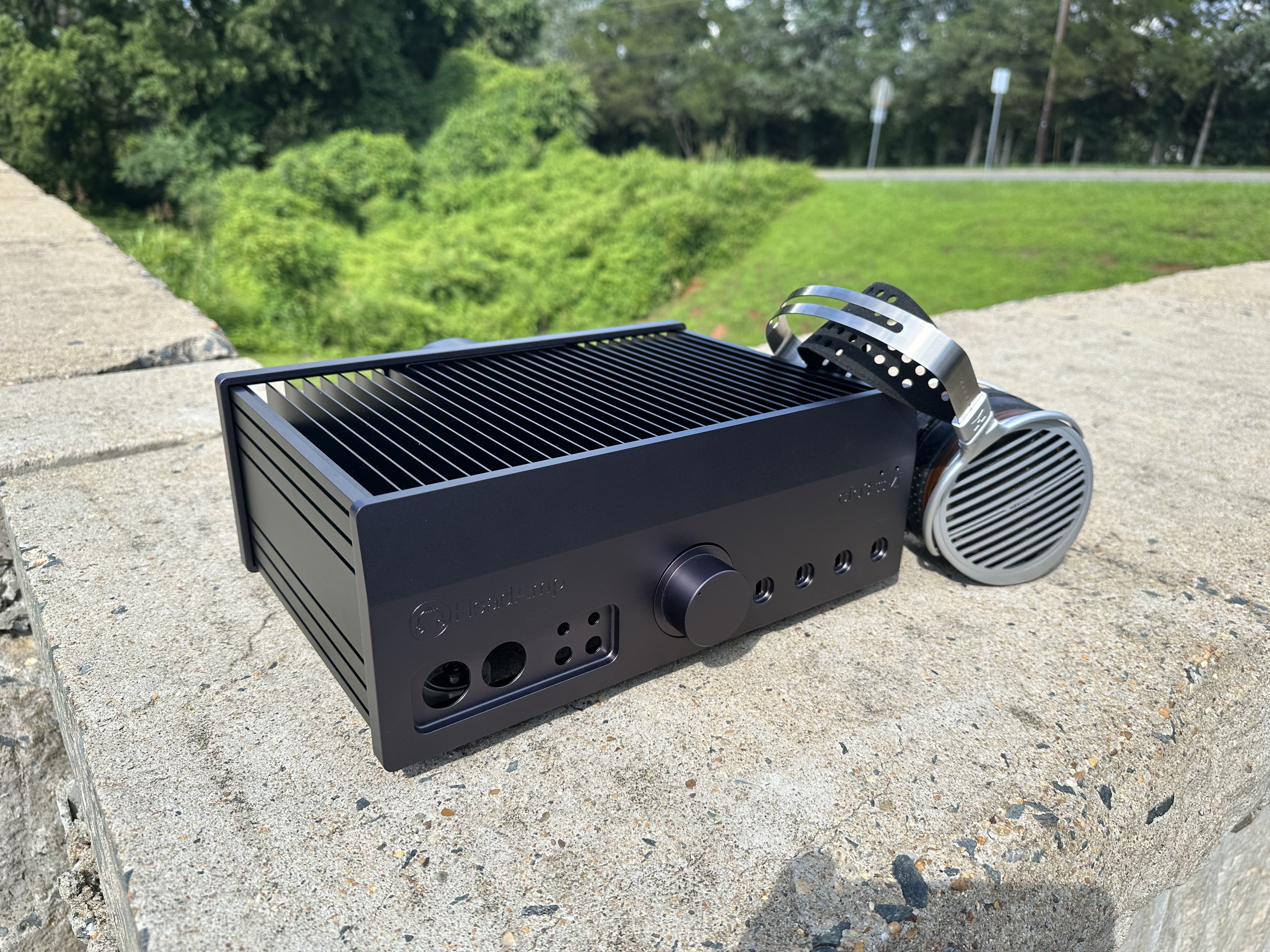

    A CFA2 balanced. Finished this a whiles back.
