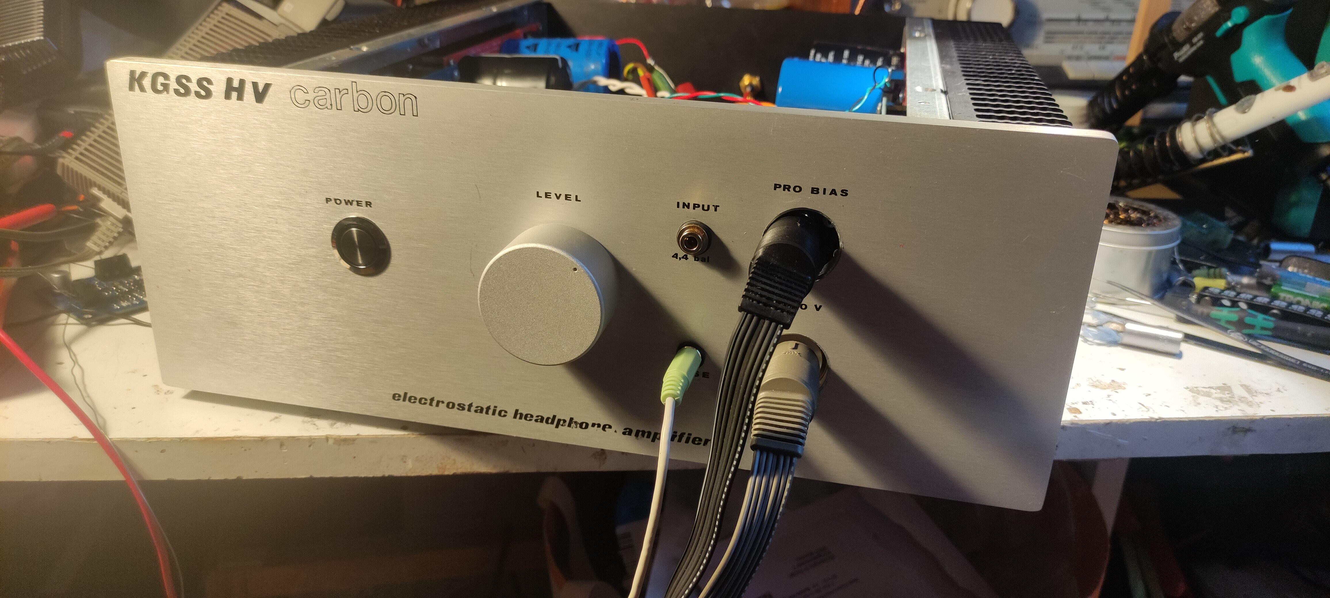

Friends, this is my first home experience with stax cans, now with a sr303 bought for a dime.
And I guess it'll be a long, long journey...
I'm in love with this cfa, its speed and clarity are a perfect match with speed and clarity of staxes, wow... It is refined, delicate and well behaved (apart the offset that needs a screwdriver sometimes... What's the tolerance for balance and offset? Trying to keep em spot on on zero, but slowly drifts away...)

From the picture it looks like you didn't engage the servo?
Not yet, yesterday had the first working power up and wanted to listen to it a couple of hours 😁
if you engage the servo, you'll see the output will hover around zero pretty quickly

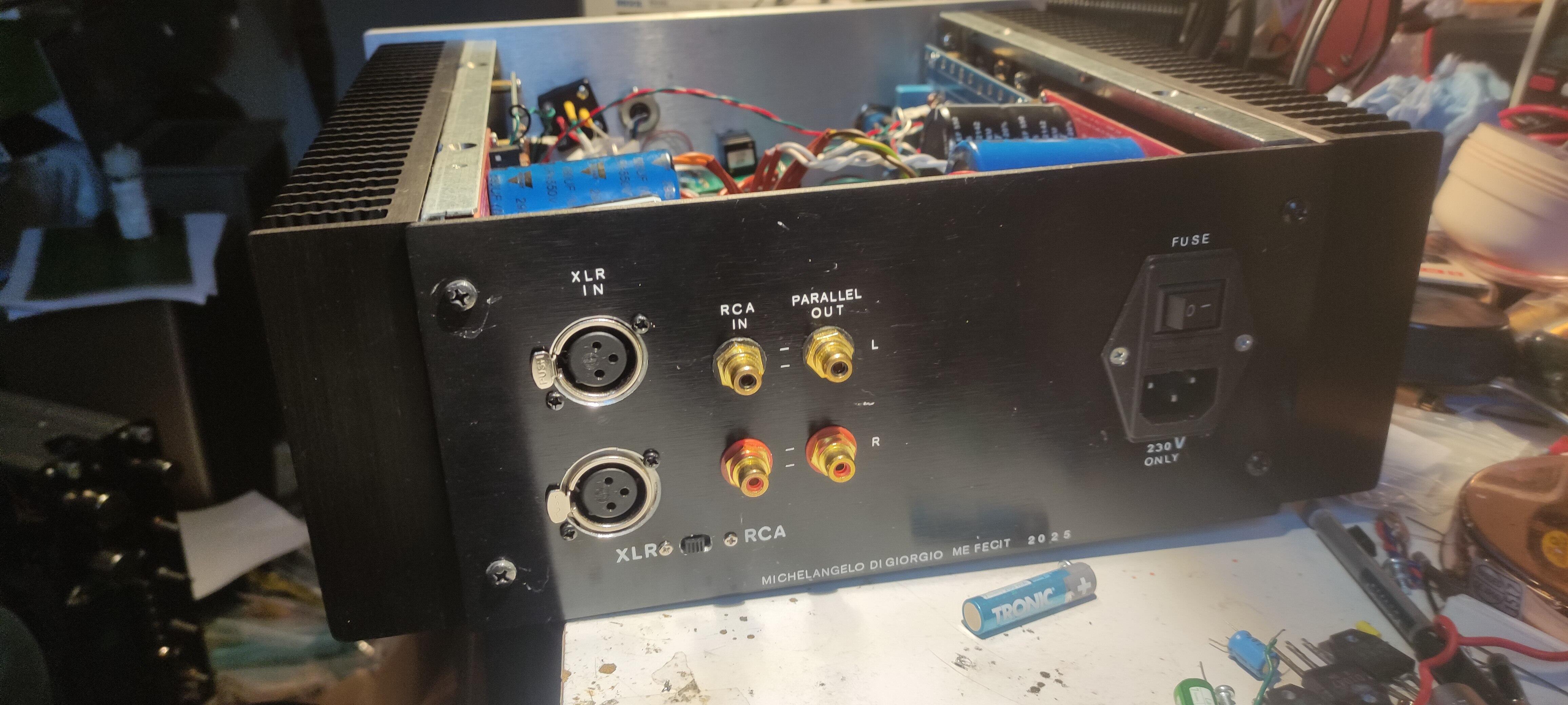

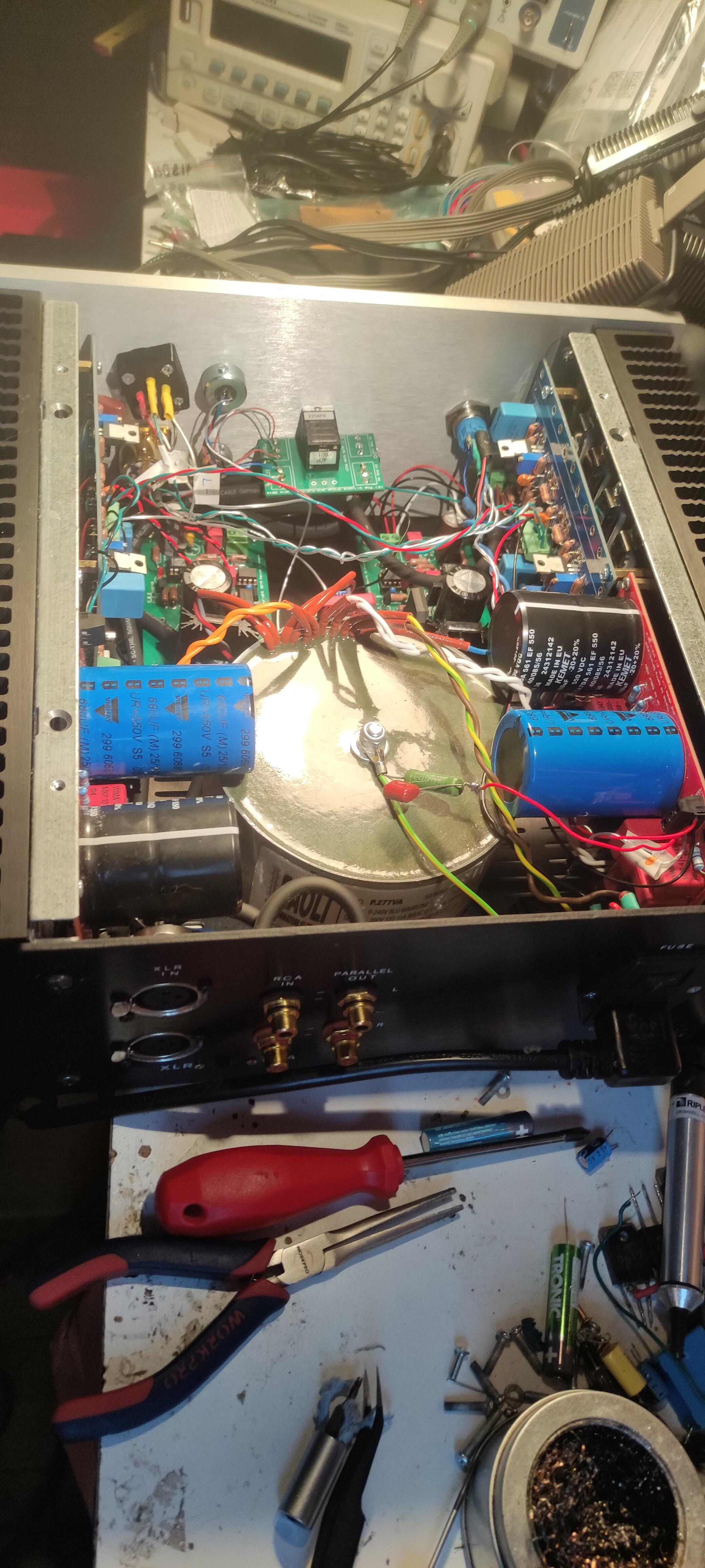

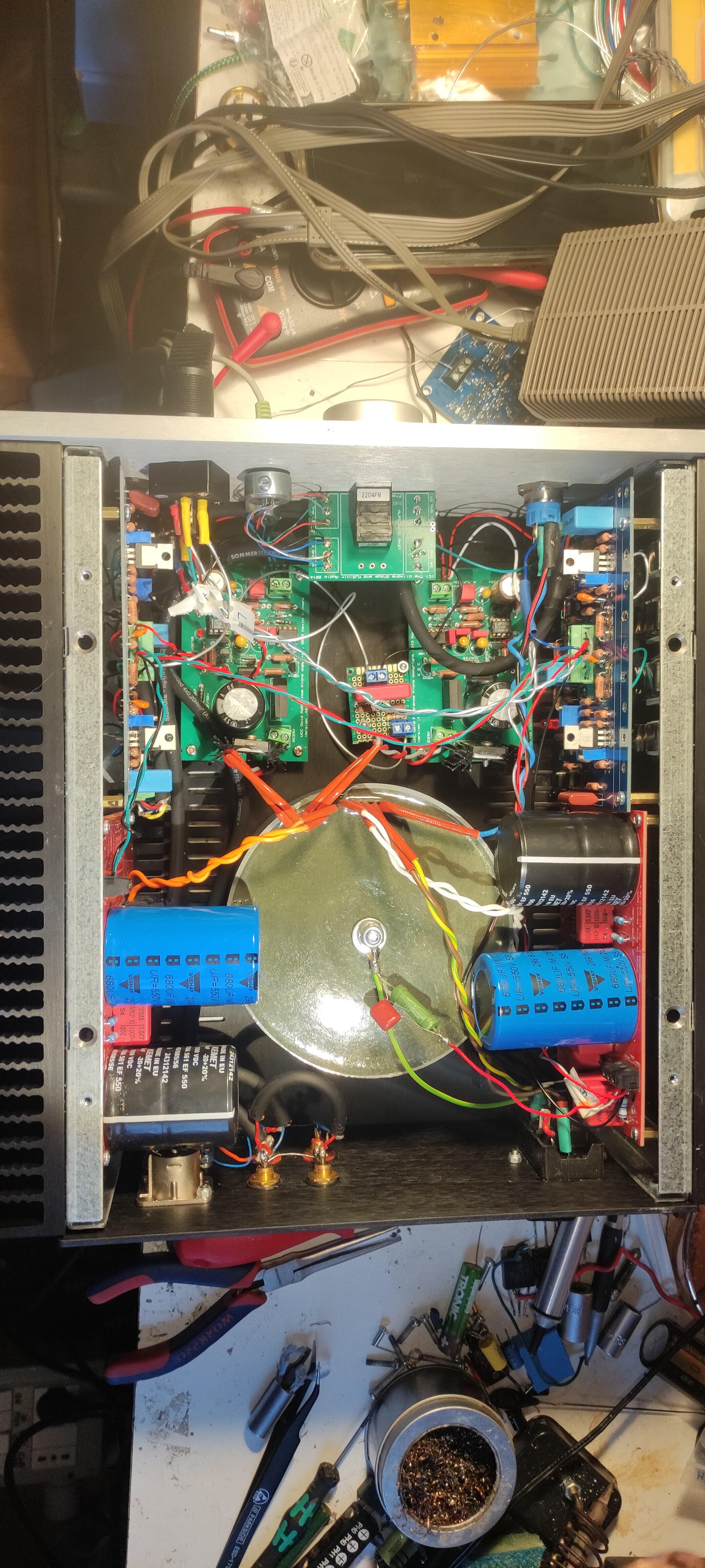

And so, yesterday was the great day of final close in the enclosure, it played flawlessly for a couple of hours, I came back at it for some music after dinner and PAM! A resistor burnt down with sparks and a flame in the region of DN2540 in the B+ board.
Me sad .
Have to tear it down again to investigate about arcing or whatnot, a nice picture of the event, so that you can smell that burnt chicken flavour 😁
More importantly, forgot to say that that PAM took along my DAP, as if a 450V discharged to ground suddenly, and my Fiio player (5 yo thanks God) broke down, not to restart anymore. One more thing to repair. 😒
I've seen someone experienced something similar, but mainly in the amp board, never on the HV one.
Possible cause?

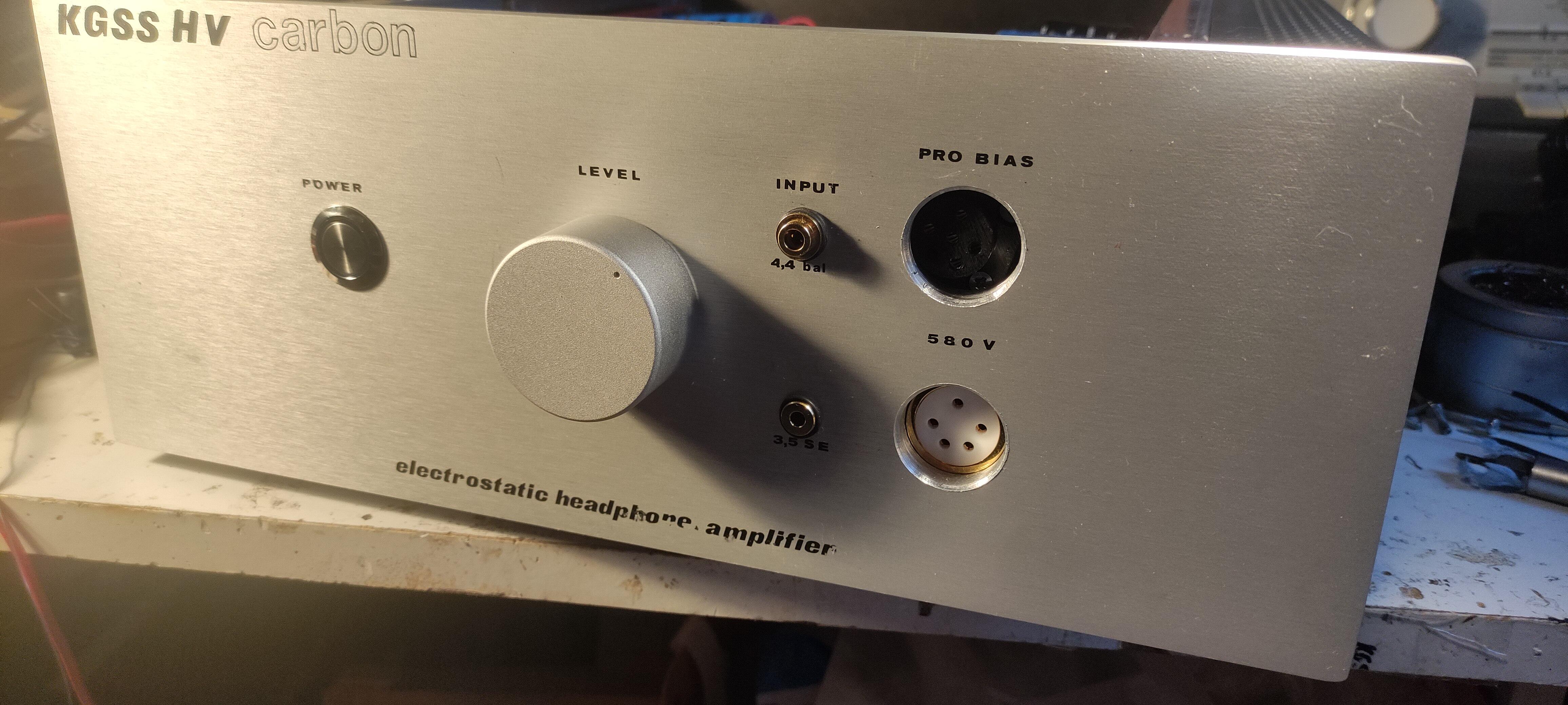

Thought I never shared pictures of my build, et voilà.
Those 3.5 and 4.4 input connectors on the front do really a pragmatic job...
I fit a normal bias plug (thanks @JoaMat) so the writing is now aged 😁
