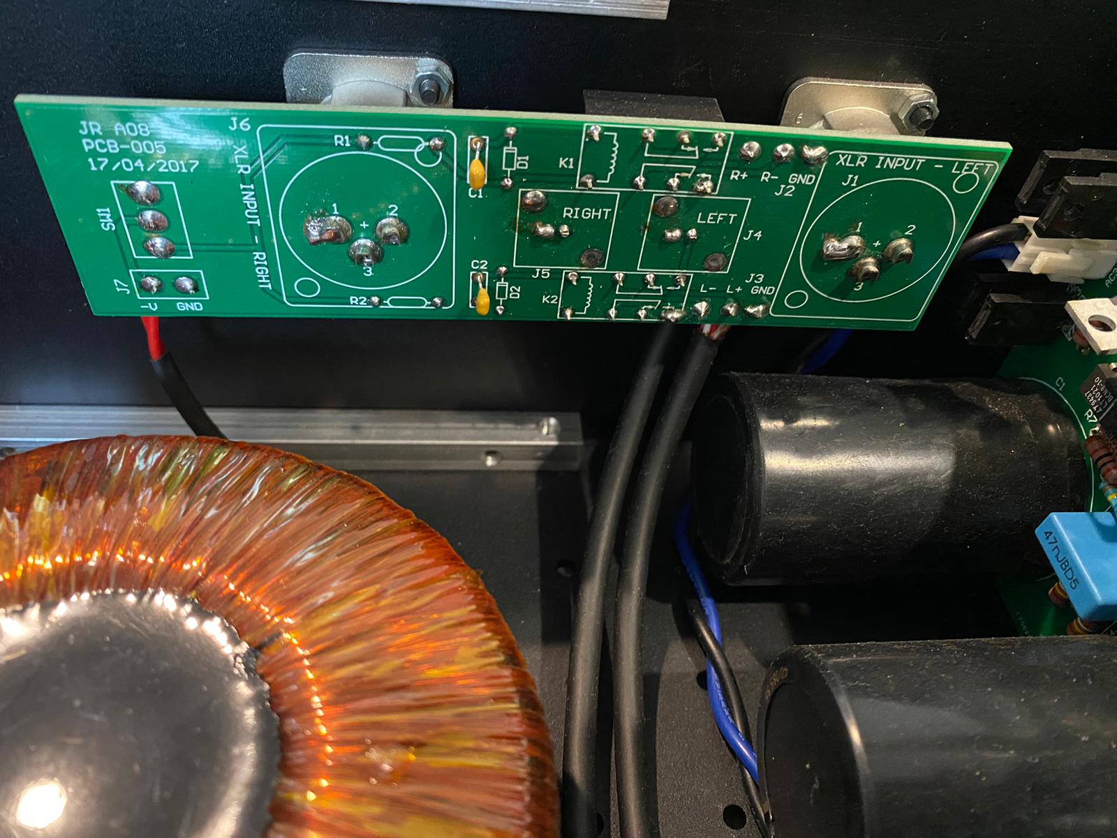

18 hours ago, tonyxu said:
Looks like those relays on the input board are used to switch between chinch and XLR inputs. But that soldering job...
Edited by audiostar

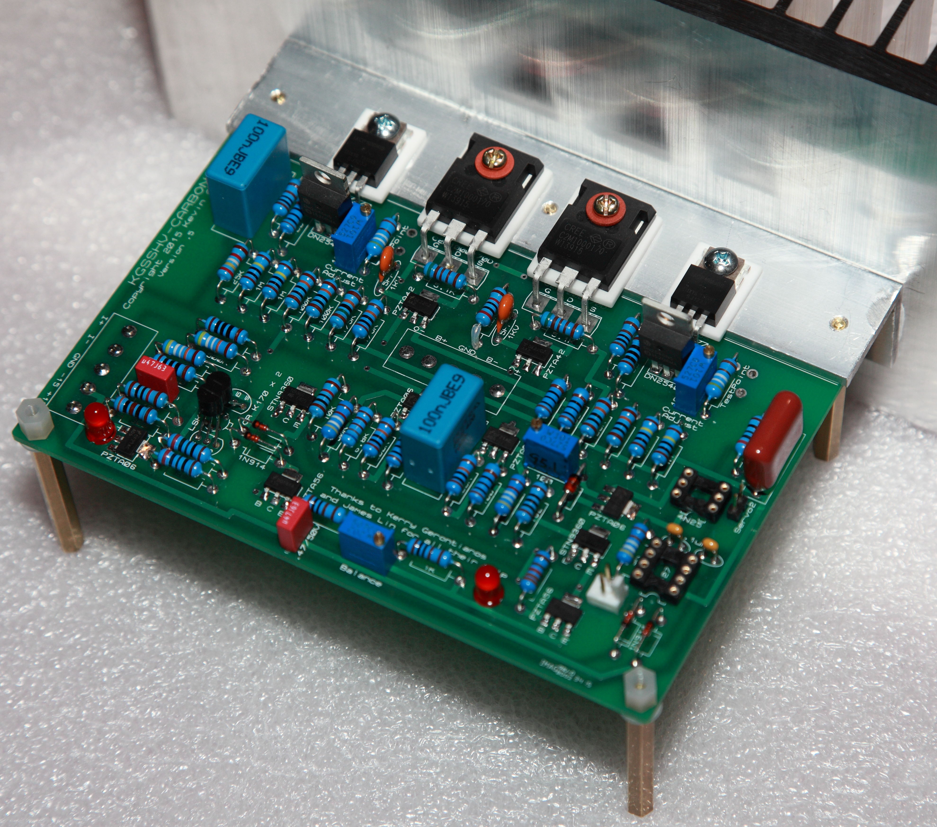

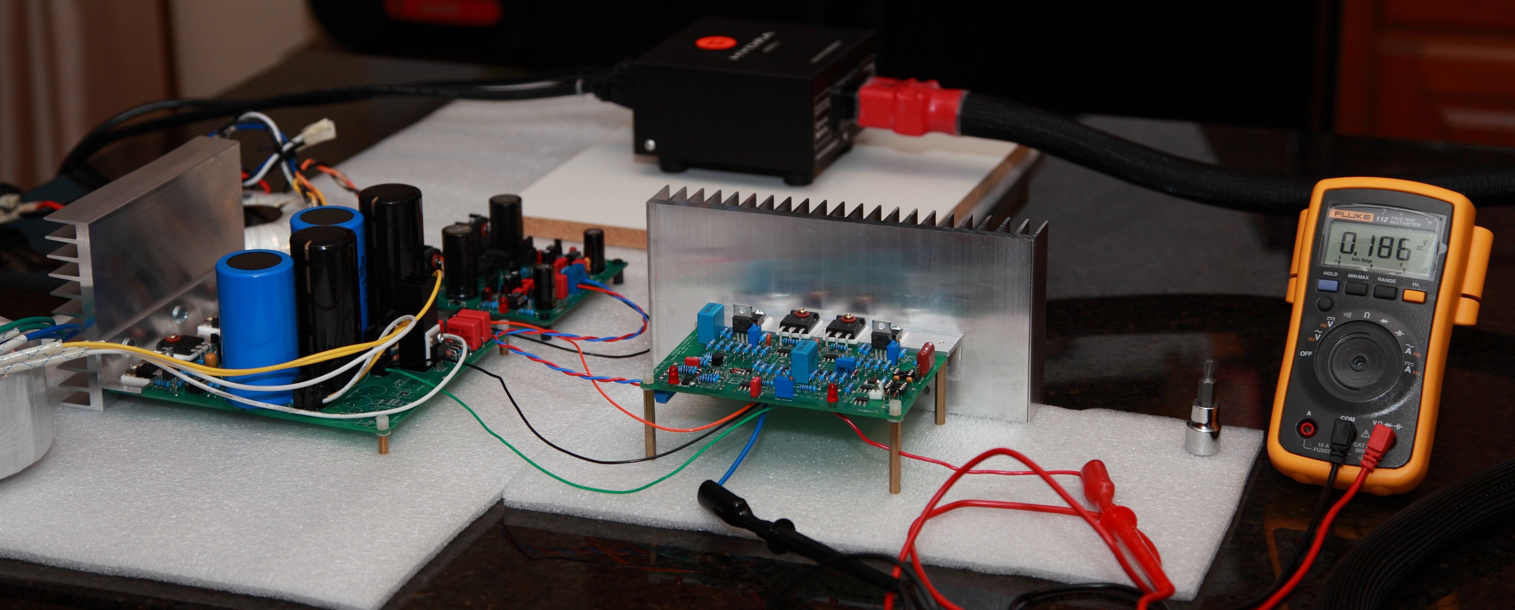

On 11/29/2015 at 5:15 PM, mwl168 said:

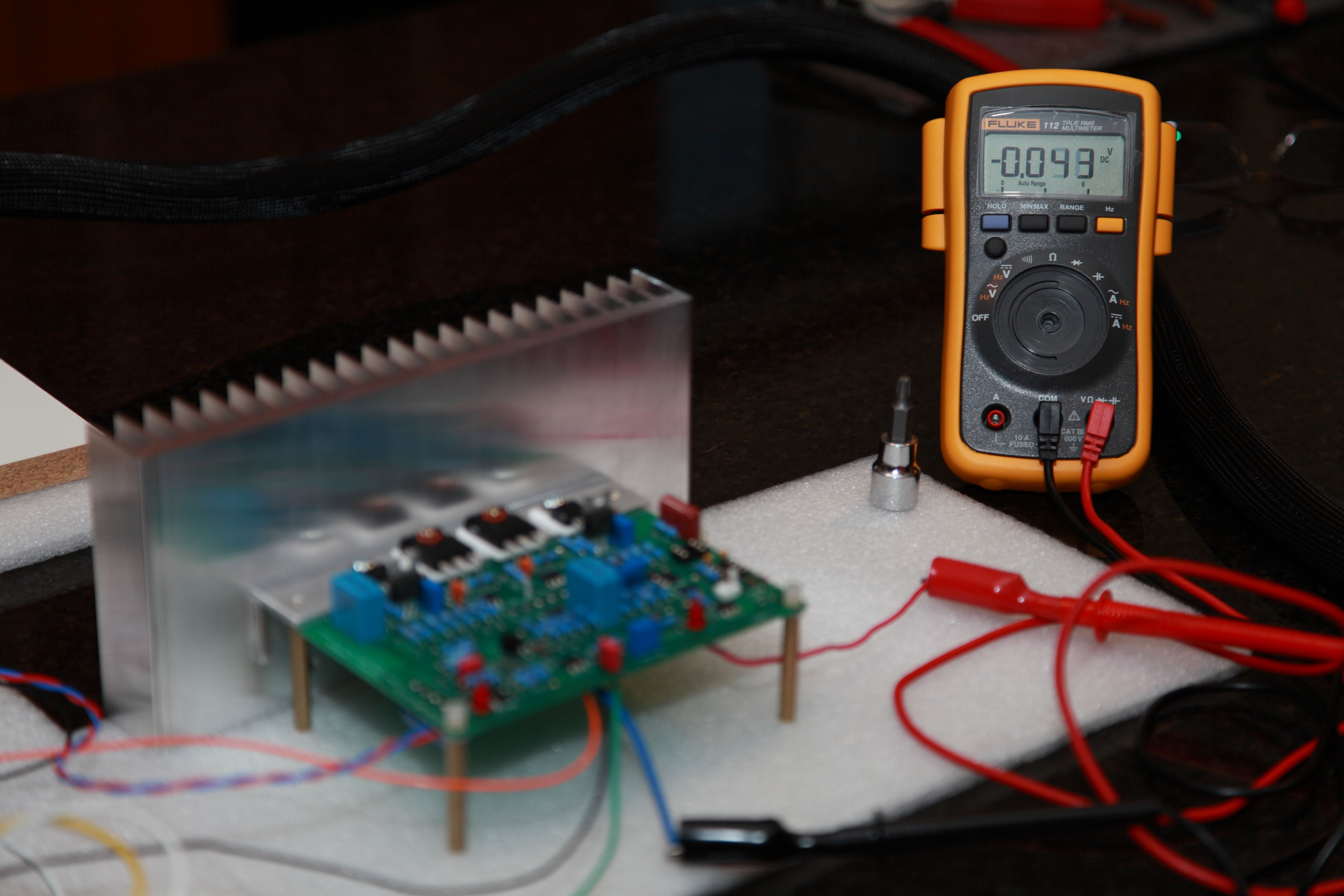

More progress today testing my HV Carbon build (V5 board from the GB). I am running 20mA (1.00VDC measured at test point) and have substituted the 182R tail resistor of the offset VR with a 100R one. No problem zero-out the offset and balance.
A few observations at start up (I have all VRs adjusted to mid point of its value before soldering on the board, I also hand measured and picked all passive parts including the LEDs except a few tiny capacitors):
1. the test points measured between 0.71V to 0.76V
2. the balance is around 3.8V
3. the offset is around 38V
I also found the following sequence of procedures worked well for me for adjustment:
1. Adjust the two 100R VR next to the test point to read 1VDC - my desired 20mA output current
2. Adjust the 2K balance VR to as close to 0V as possible (it'll drift a bit)
3. adjust 100R offset VR to as close as 0v as possible (it'll drift a bit and also interact with balance adjustment)
Next will be to wire up the input and output connectors and see if I'll get music. By the way, this thing runs HOT, much hotter than my KGSSHV. My test heatsink got very warm to the touch.
Here are some photos:
A couple of questions:
  1. For the balance adjustment, should you measure from O+ to O-? Or is this O+ to GND? I'm guessing the former.
  2. For the offset adjustment, I'm guessing O+ to GND (and also check O- to GND)?
  3. Also, how critical is it to GND out the I+ and I- (I don't have a pot wired in yet, but could jumper these).
It isn't clear in Michael's pics where the blue wire is running to. I bought a 2nd meter (Brymen BM867) so could look at both the +/- offset at once. Thanks!

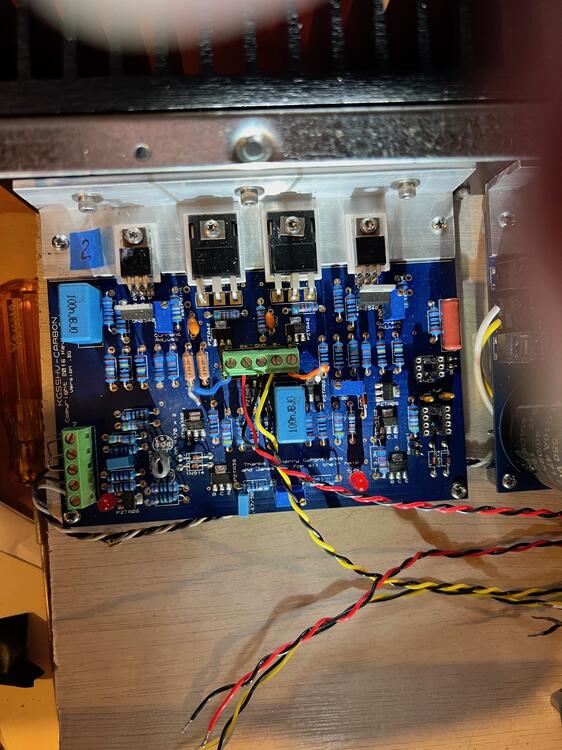

Fired the first board up after rechecking all connections, and wiring the inputs to ground. I'm getting full voltage (806 Vdc) from O+ to O-. Nothing exploded or seems to be getting hot, though I didn't leave it on very long. Both LEDs are lit evenly on the board. All pots were centered when I built it, and other than the current source pots, which I had adjusted using Soren's method to ~17mA, haven't been touched yet. I know I've seen this problem in the thread somewhere, off to find it.
Thanks Kevin. I'll check it out tomorrow (having a beer, not conducive to HV stuff). On your production schematic (kgsshvcarbonproductionv5.pdf), the offset pot is RV4 and the balance pot is RV2 I take it? I'm pretty sure I have either a 120R or 100R ohm resistor in instead of the 182R.

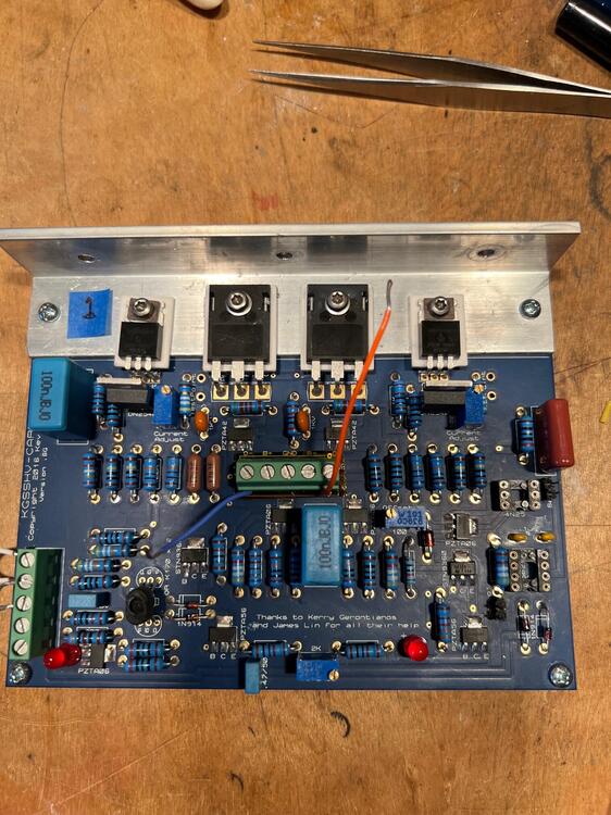

Went down and started working on this again. The offset pot measured 54.5 ohms in circuit. No adjustment I made to this made any difference and stayed pegged on 404Vdc on the O+->GND. The only thing I've noticed is the right side current adjust TPs show 0.11V. The left side is 0.85V, which is the 17mA i had adjusted to using Soren's procedure.
Ohming out the larger devices shows no differences. When you say do a diode check on them, you mean use the diode function on the DMM? I also assume to check them both ways (flip the leads)?
From the schematic, the DN2540 or 10M90s could be the culprit on that side. I didn't try adjusting the trimpot, but know they were both set to 17mA. I have a couple of DN2540s, but don't think I have any more 10M90s.
I'm going to hook the other channel up and see how it behaves.
I verified that the tail resistor for the offset is 120R and not 182R.
Edited by Pars
Update: fired up the other channel and it works fine. Bias was right where I set it at 17mA. Offset and balance look good. Initial offset was around 32V, adjusted easily down to 0. Let it run a few minutes, it had drifted around 10V, adjusted back down (no servos yet). The heatsink (Modu 2U 300mm) was starting to get warm on that side. The one on the bad channel not getting warm.
I did attempt to adjust the bias on the bad channel right side, but the pot had no effect, so guessing a bad device somewhere. I'll probably start with the DN2540 as I have a couple of those. I do not have any more 10M90s. I of course have some C2M1000170D but they are back in stock at Mouser now, and probably not one of those which is bad. I'll attempt to use the good channel to troubleshoot the bad one.
I started troubleshooting this today (I'm working, so limited time). After disconnecting from heatsink/wiring, I decided to rerun Soren's CCS test using a bench supply. Both CCS's adjust fine on the bench, so I guess that tells me the 10M90s and DN2540 are fine?
I guess the SIC and the PZTA42 are next up. I'll look the board over for solder joints, etc, and run diode tests on those devices. I do have some SICs and I should have extra PZTAs.
I did have the opamp and the opto in on this board (no jumpers in). Hope this didn't destroy either of those. I don't think these (if dead) could be causing this issue, but will remove them for the time being.

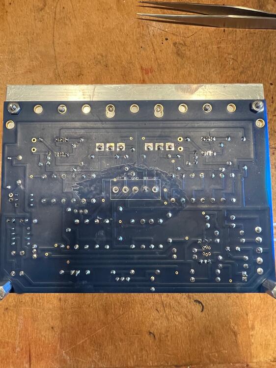

Posting some board pics, hopefully of good enough quality. #1 is the bad board, #2 is the good one.
Spotted a solder bridge on 2 pins of the TO-71 socket. It was definitely shorted, now removed. I'll try to test it later. If that is it, that was easy :)
Put it back together and that was the problem. Offset and balance adjusted fine. I was a bit concerned when I first turned it on as it started to come up but blew the fuse (3.15A Slow blow). Replaced the fuse and it came up fine. No soft start or anything. Lights didn't dim or anything. Not sure if this is a problem or not. I'll see how it starts up in further starts to adjust and implement the opto servo. Bias is ~17mA; heatsinks don't seem to be warming much, but I didn't run it much (5 minutes). Might turn it up to 20mA bias, need to read the thread more (again) to see user comments on that.
Can't believe I hadn't noticed that solder bridge before, but glad I don't need to try to source any unobtainium parts right now :)

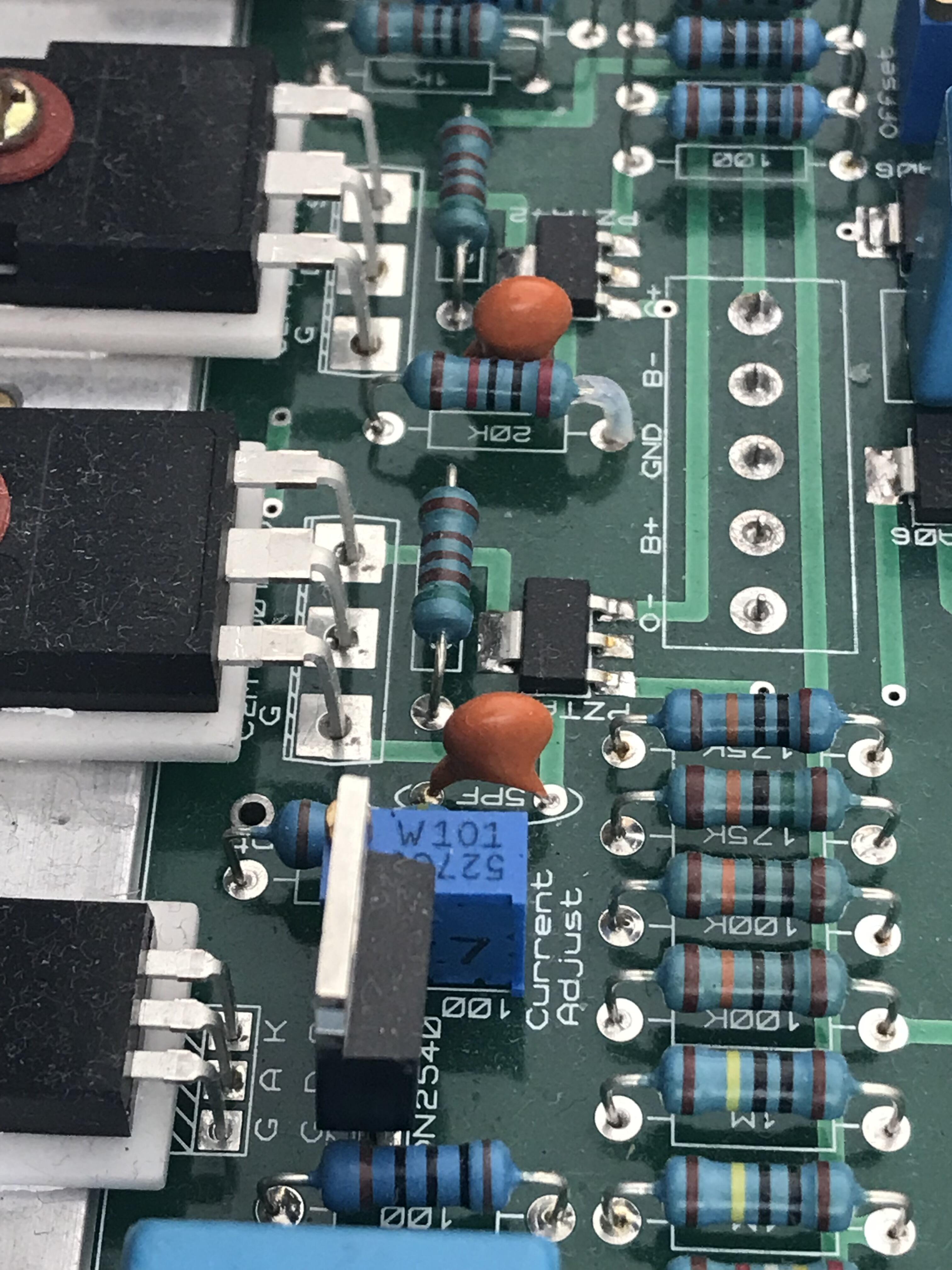

Today I decided to make this mod to my Carbon I built in 2015 and parallel a resistor to one of the 175K to raise the Vce of the PZTA42. My Carbon is running on +/-406VDC rails and 20mA bias.
To my surprise, instead of the 175K + 175K bias resistor chain, I had already replaced them with 150K + 100K at some point. As such, I measured Vce  = 10V for PZTA42 and 21.8V drop across the 20K resistor. According to the graph above, this should put the PZTA42 in its linear operating region. Some wise man must have suggested this mod to me (I suspect SorenB) very early on.
However, I measured Vgs  of the C2M1000170D to be only 3.2V. Based on how I understand simmconn's posts, I was expecting 20V or higher. What gives?
If I read simmconn's post right, simmconn measured G to B- (over the 20K resistor) for those 20+ volts, not Vgs directly. So your 21.8V is that measurement and thus indicates all is well :)

The long tail resistor (offset pot plus the one in series) should drop about 8.xV so
Vce(PZTA42)+V(offset res)+Vgs(SiC)=Vg(SiC)-V(B-) //10+8.6+3.2=21.8
For PZTA42, Vce=10V and Ic=20mA is still not out of the woods. Just look at the DC current gain curves in the datasheet below.
The non-linear region (due to Early Effect?) is not apparent in the SPICE model from the manufacturer. That's probably why it didn't catch the amp designer's attention.
On the other hand, I was probably over worried about exceeding the C2M1000170D's max Vgs rating.
