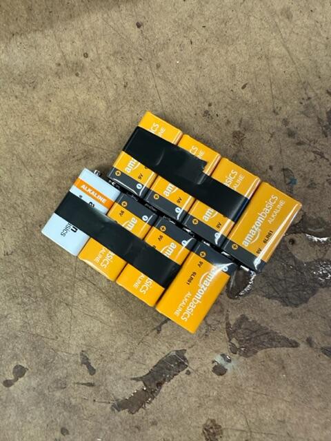

  • Here is a low noise 100v supply i worked on just need another pack of batteries

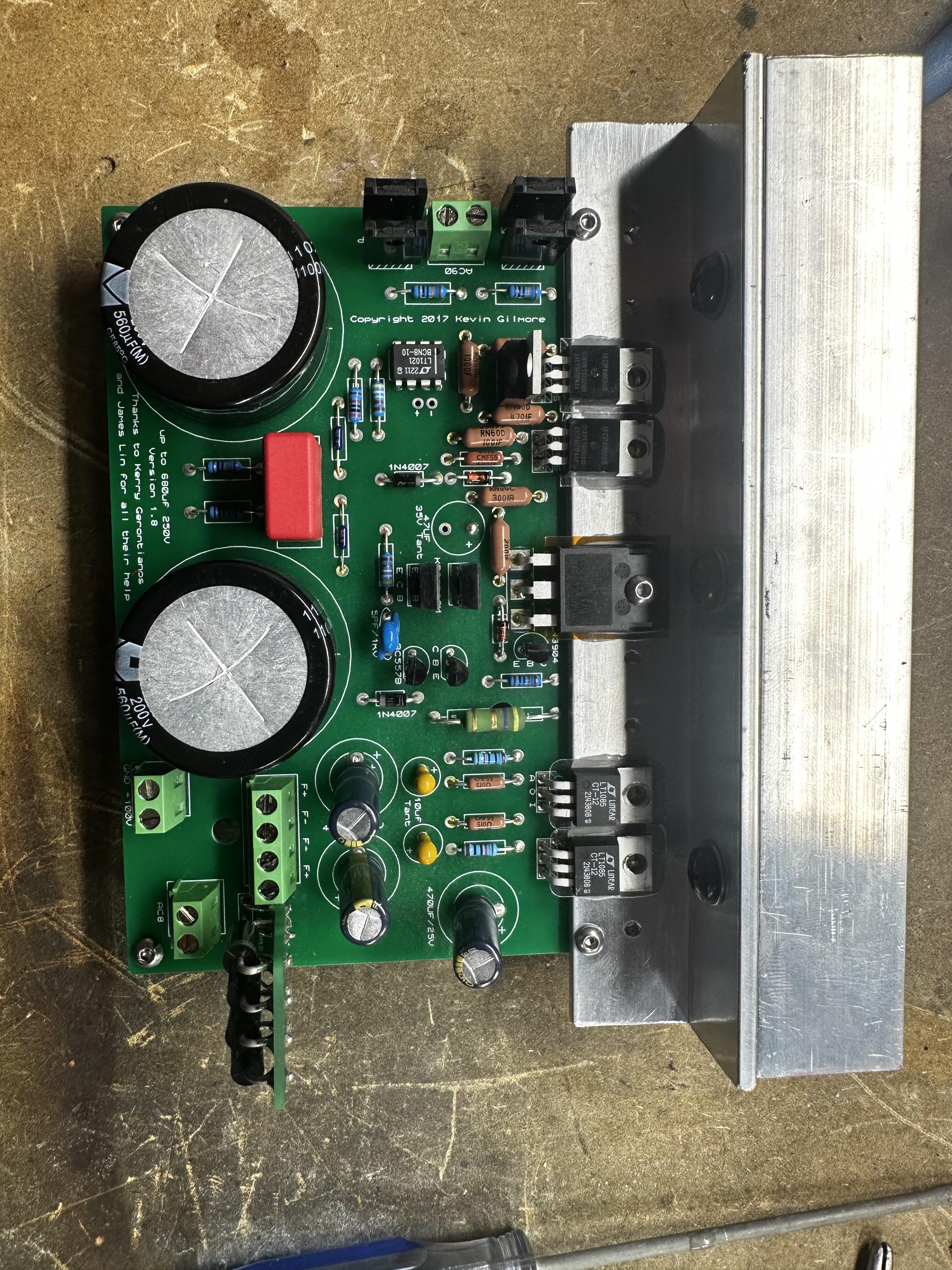

  • Grhv100 nearly ready to test, waiting on 90/8 trafo from toroidy and some shoulder washers for the to-220’s. Sink is temporary. Added discrete bridge for heaters per Dukei/miroslav, who’s built a

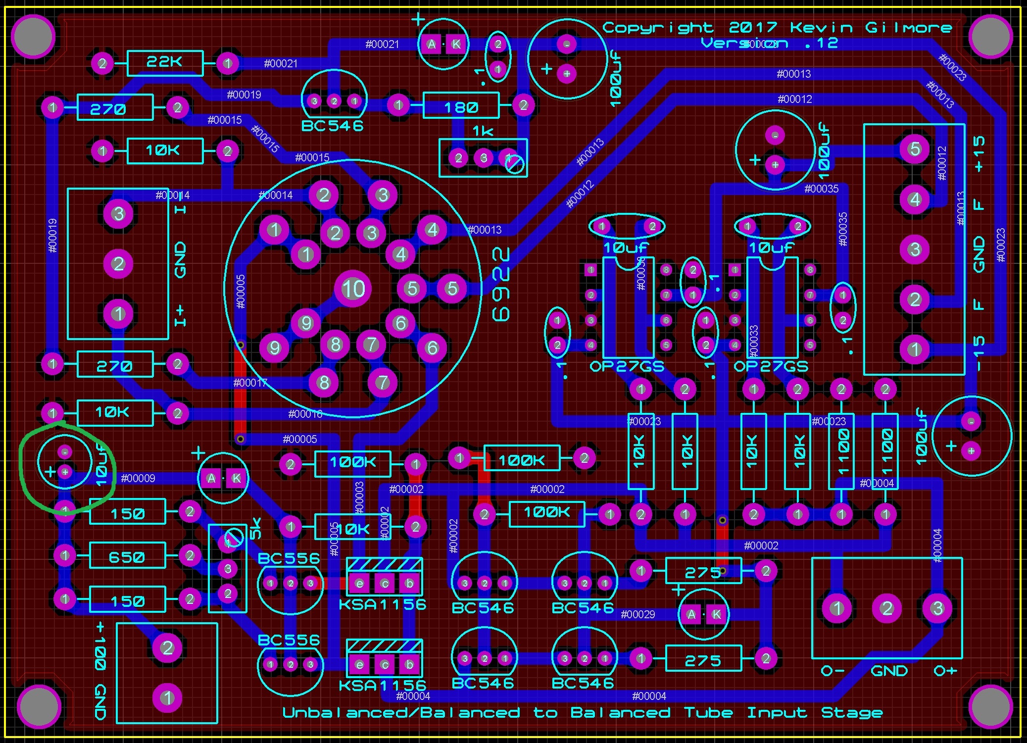

The cap circled in green in the lower left has 100vdc across it. Having trouble finding a 6mm EL cap that size in ~120v+. Spend $25 on a tantalum? Just wedge an 8mm in there? Opa445's (I'm running 30v) are out everywhere in dip, so going smd+adapter.
Can anyone give me a 101 on how to properly set the 1k (balance?) and 5k (bias?) trimmers?
Here's the link the to BOM for this board. https://www.mouser.com/ProjectManager/ProjectDetail.aspx?AccessID=1d87f242f2
The circled cap in the BOM is an 8mm, and the socket is not available at mouser.
Added discrete bridge for heaters per Dukei/miroslav, who’s built a few.
Are the +- pads out from the smd relay for an LED? Warmup delay?
Any details on bias/balance adjustment on the tube board? Looks like plate balance and cathode resistor trim?

On a scale of 1-10, how ok is it to use mica insulators instead of ceramic for the HV section?

I would guess that those are for turning on the opto coupler ( CPC1117NTR), same as the normal GRHV's have, for delay purposes. Haven't looked at the schematic for the 100, but for the normal GRHV, you have to apply a voltage to turn it on. You can leave the CPC1117 out if you don't need this feature.
I probably wouldn't use mica insulators for something like this (aluminum oxide instead), but I know mica has been used throughout the years for HV applications.

Oh hey, something I can answer! I'd give it a 6-7. My electronics experience is mainly with HV tube gear. I'm a repair tech and do custom builds, so lots of experience there. While Alum Oxide definitely IS better, we're only talking about 100v here, I don't think mica will give you any trouble. Be smart with thermal paste, as some types CAN be conductive and can cause a "bridge" if you're too generous with it. I've seen far worse than mica insulating 500+V successfully, but you should be OK. It's typically 600V insulation per mil of thickness.
another thing that gets people is not deburring their tapped holes
ive had to deburr entire batches of Aavid heatsinks before
Very good point, agreed!
Always check for (lack of) continuity from device to sink before powering on as well,  obviously.
Ha, the mica insulation for the 100V section made me nervous. Its great that I shouldn't worry about it.
I would also check for HV breakdown as there is continuity and then there is continuity at high voltages.  ;)
90vac transformers under 1M /s VA seem to be unobtanium. Think I can get away with 80vac and some low dropout diodes for the grhv100? Next available option is 100vac. Otherwise it's ~$250+ custom and 2-3 months wait min. Any off-the-shelf options I'm missing? Bonus points for 8vac + 90vac in one!
I would check with Toroidy in Poland. I had a pair of 6 secondary 100VA transformers done and they were pretty reasonable. Dual primary, 4x24V and 2x8V for either 57 EUR for their standard audio grade or 107 EUR for the audio supreme grade (I went with the audio supreme). They could do your 90Vac and 8Vac with no problems. Shipping was a bit high as is to be expected, but they came in about the same delivered as SumR, who I wouldn't use now.

I just realized, while working on a hand-drilled prototype, how much more likely it is for this type of thing to be problematic for a one-off or a DIY project that doesn't have CNC machined holes, pre-calculated lead bends, and things that result in the transistor lining up perfectly with the hole. Even many hand drilled/DIY projects where the transistor 'lines up' there may be force required to get it in place, a screw head going in at an angle - due to placement of the transistor, the hole drilled at an angle or both...all recipes for issues with insulators
Edited by justin
Definitely! I'm able to make plans/drawings to get all my holes drilled/tapped if I wanted to, but since I'm not planning on making multiples, I decided to just do all of that by hand, and have just the main front/rear panel cutouts done by Modushop. All the heatsink interface will be done by me by hand. I figure there are too many variables to be 100% sure with my placement until I have the chassis on-hand. What I do is drill the mounting holes first, then place the transistor without any thermal pad/compound, bend leads as needed, THEN apply thermal pad/paste, insert, solder. Def way more time consuming that having pre-drilled, pre-bent. I'm using shoulder washers for anything with a exposed tab/hole, to verify no continuity. I've found that forming taps tend to be less troublesome with aluminum than fluted cutting taps as well.

Trafo from Toroidy arrived! I'm getting about 7.2vdc for filaments, loaded. I'm currently using the stock 121R(series)/510R(to neg) resistors on the adjustable regs. Can anyone help me with the math to dial that in closer to 6.3vdc? 200R/510R? I assume that'd be easier on the regs than 121R/450Rish would?
That's the LT1085 regulator, right? Formula for setting voltage is on page 11 or 12 in the data sheet if I remember correctly.
