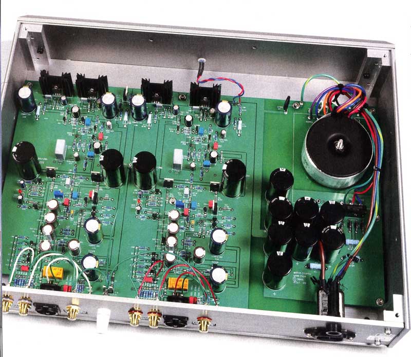

hm, lookie what I found:
Is that a balanced Pearl?
When will you have mine ready? :P
  • Author
no, it's the new Pass single box phono called the XP-15. Supposedly sounds better than the Xono at half the price.
Is mine finished yet?
