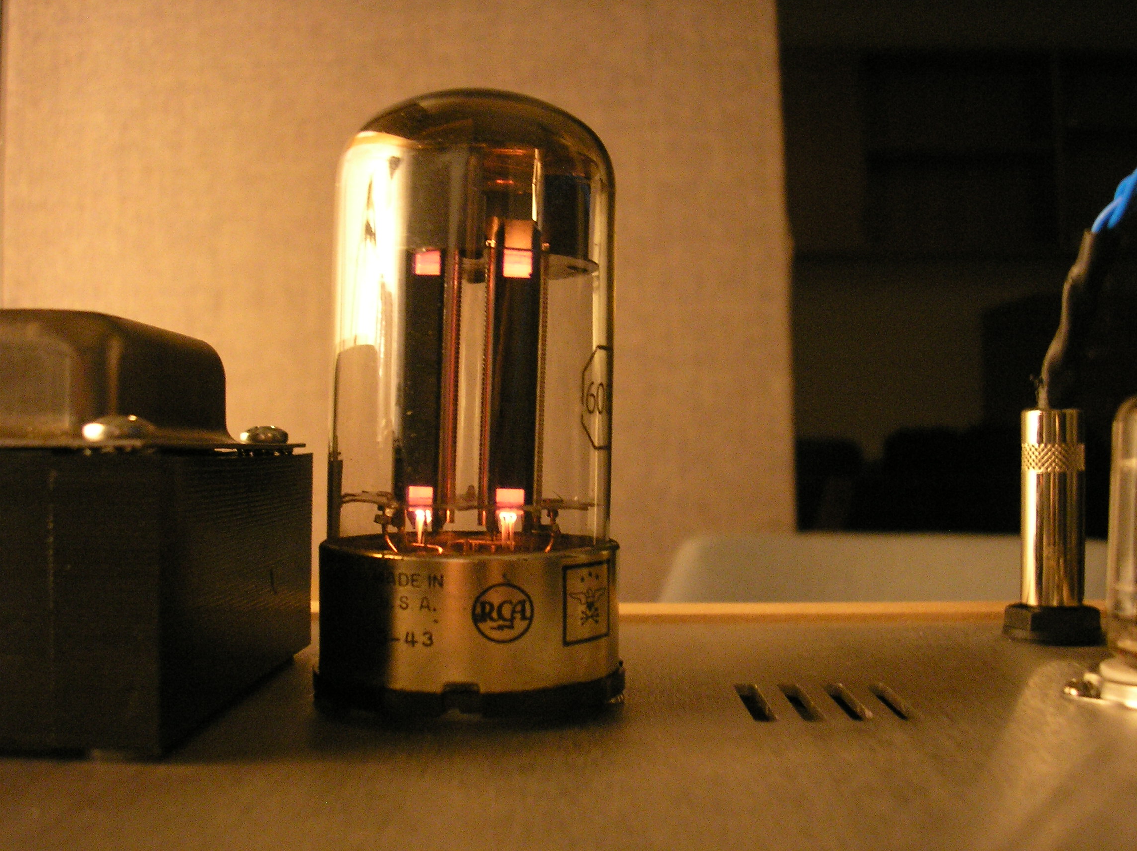

plugged in an rca 6080wc tube that i was given by the nice gentleman upstairs. the bass with the 650s is stupendous. downright silly amounts of bass. a little tightening up would help but waaaaaaaaaaaaaay nicer than the jan 6080wc that was supplied with the kit. i can feel the insides of my head rattling on "poem of chinese drums" by yim hok man.
still looking for a bit of mid range sparkle. nice and smooth but would like it to be more liquid. perhaps even a little bright. (coming from someone who hates anything bright)

That's one of the things I really love about this amp. You can really hear what each tube brings to the table. Of course there are some that sound pretty close and you need to find the right combination for the particular headphones you're listening to.
I think you'll find that rolling the 12au7 will help just as much as the 6080.

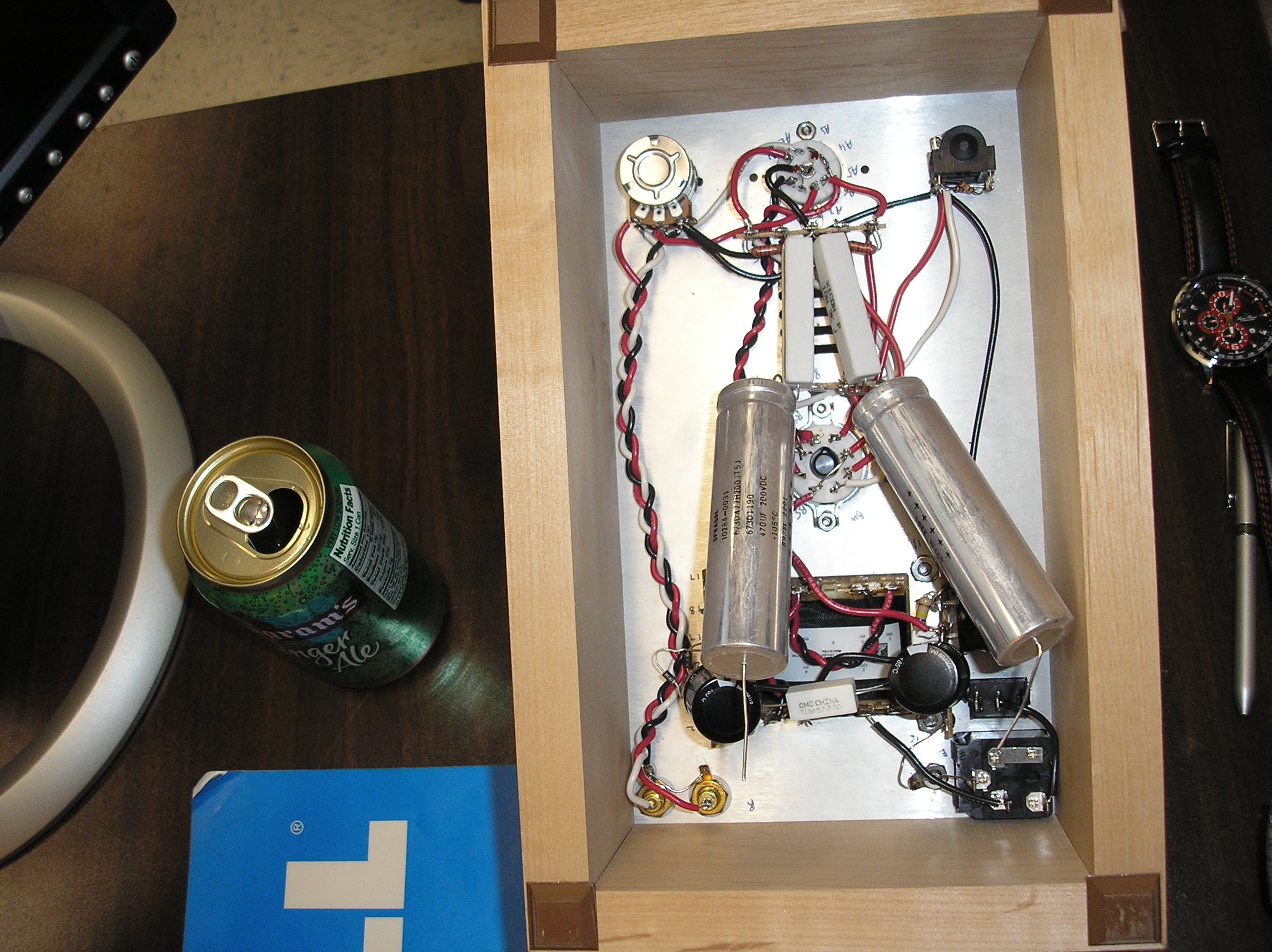

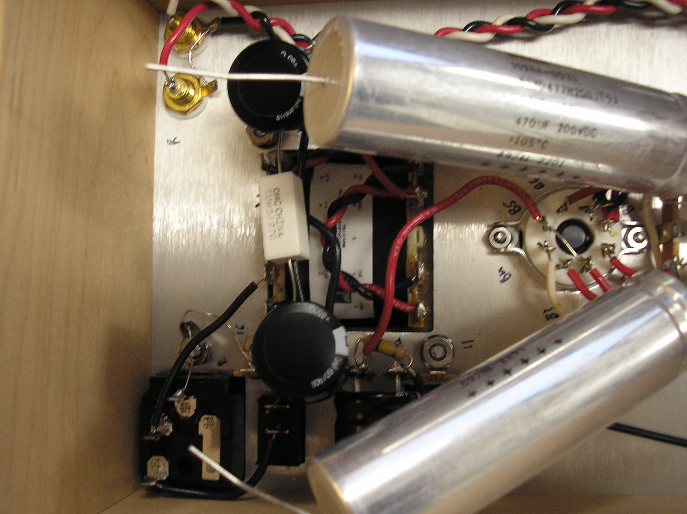

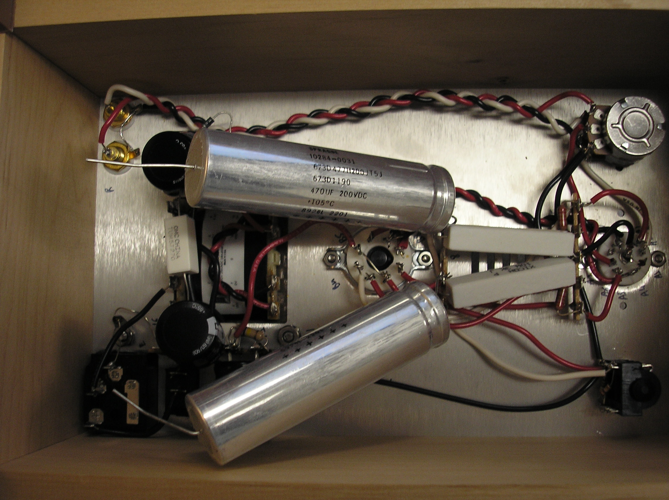

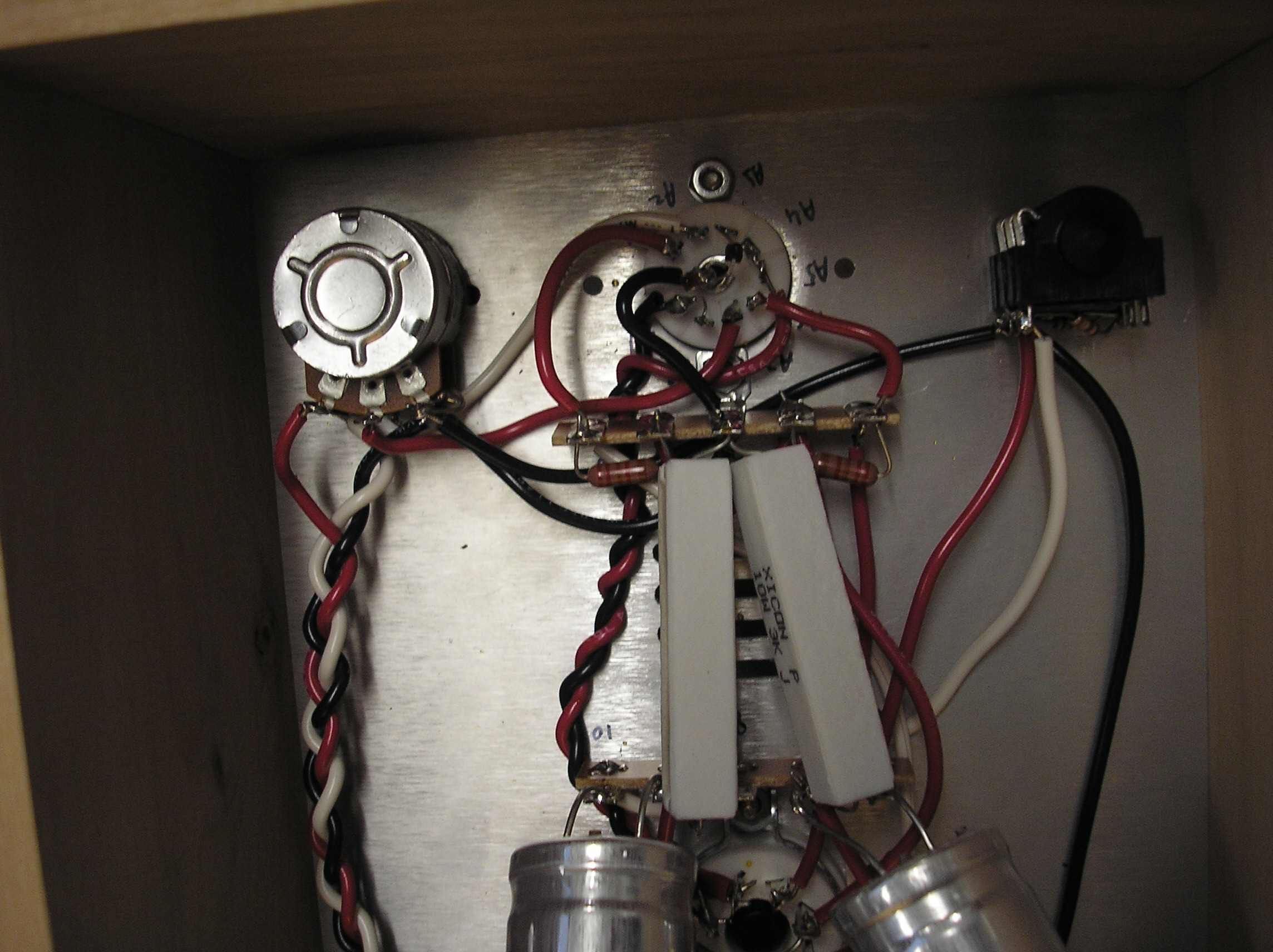

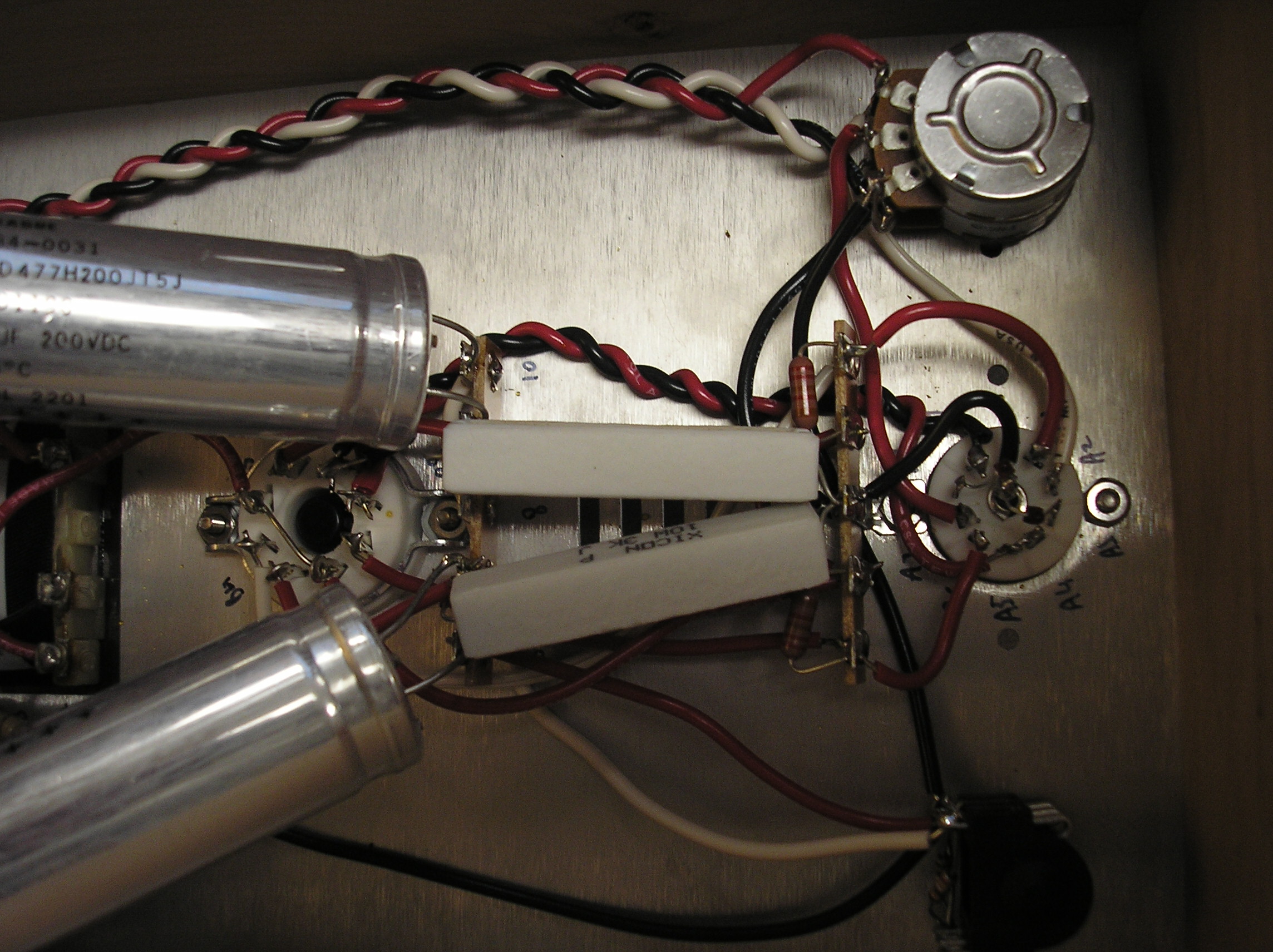

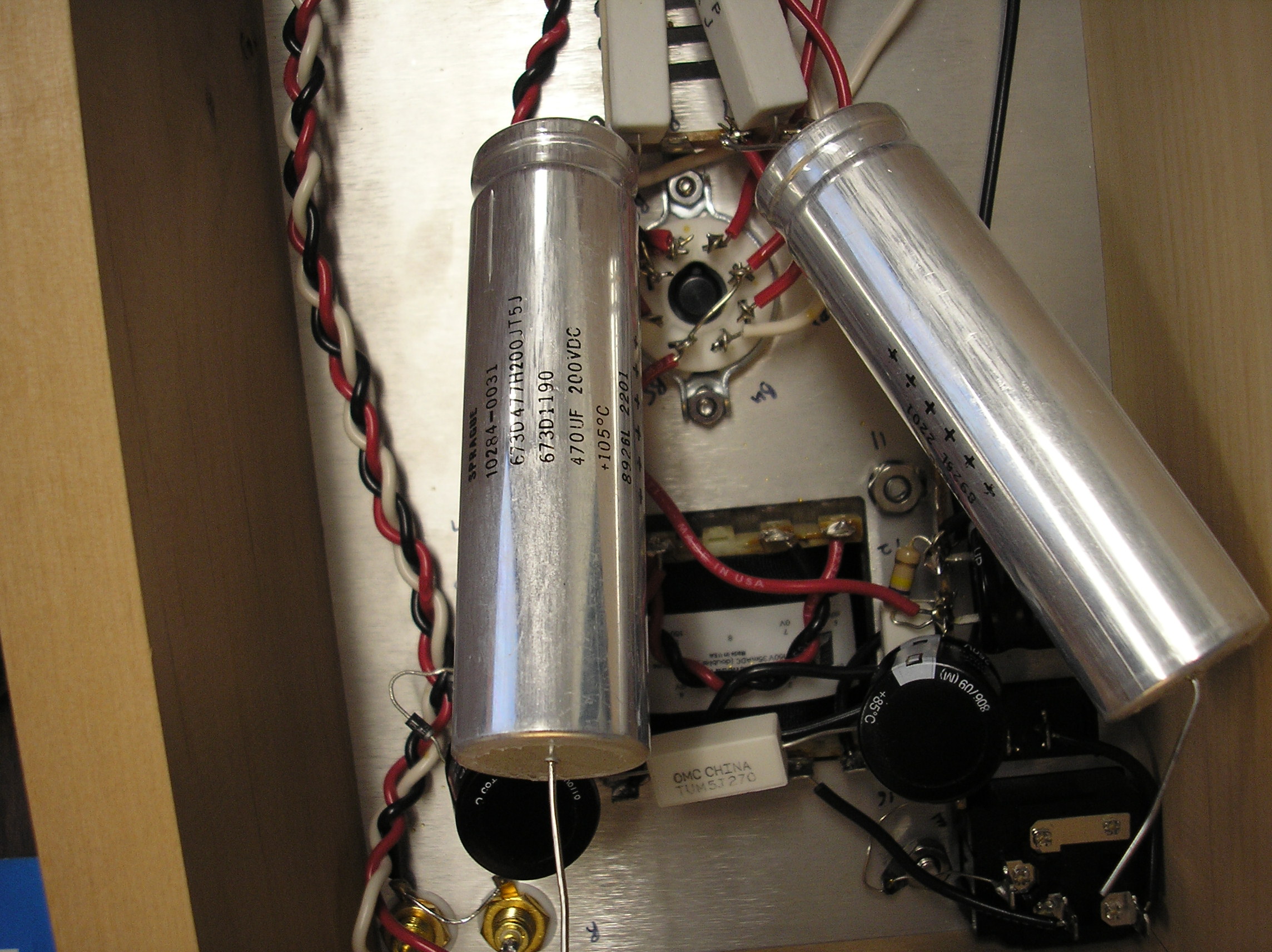

any comments on how to improve the build would be much appreciated.
[ATTACH=CONFIG]3599[/ATTACH][ATTACH=CONFIG]3600[/ATTACH][ATTACH=CONFIG]3601[/ATTACH][ATTACH=CONFIG]3602[/ATTACH][ATTACH=CONFIG]3603[/ATTACH][ATTACH=CONFIG]3604[/ATTACH]
  • Author
It's probably better if you wait till after the Speedball is installed. Heck, you never know,.. with a little tube rolling it could be perfect for your tastes!
i meant the actual construction of the amp - soldering, wiring etc. what could i be doing better or different for that matter?
If you have access to an IR thermometer, do you think you can measure the temperature of the transformer bell? I'm planning on painting it but want to make sure that it's not going to get too hot for the paint I'm going to use.
I don't have any advice for you as I haven't built mine yet >.> Most of the parts came in today though, so I should be able to get started once I find an anodizer/powdercoater to do the panel!
  • Author
Everything looks pretty tidy. It's really hard to see any particular solder joint without the ability to move the amp around to see it at different angles. As long as the solder flowed onto the different wires/terminals/components and the fillet is shiny and without any peaks, they should be fine.
You may have a little trouble fitting the CCS in between those output caps but where there's a will,..
With point to point connections, you may find that you have to move things around a little bit if you end up with some hum (from getting the signal wires from the RCA jacks to the pot too close to the filament wires) but that's something you have to experiment with yourself. It is worth taking the time to shift the signal wires around while you listen to to the amp with the volume maxed to find the best spot and use some cable holders to keep them there.
Once you install the Speedball, you should find a way to secure those caps since they do put a strain on their leads and the terminal strip they're connected to. And depending on how close the caps leads are to anything else, you might want to cover the leads with some tubing so they won't make any untoward connections. You can use the insulation from any spare wire you have.
