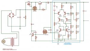

Well, there has been a lot of “talking” on this thread, but not too much bench testing of the ideas. I think that KG is the only one to help out in that area. So, I decided to do my share.
I’ve built a breadboard of what I egotistically call the kgdwhps1, and I think that I have some interesting results. The circuit incorporates KG’s hybrid idea (post #19), and my series element (post#24 on the left), but with a bipolar pass device with an ixys FET current source driving its base. (I suggested this exact configuration as “dwpass6” to KG in an email on March 31.) This pass element only has the isolated package MD2310FX on the heatsink Also, I’m using a re-designed version of the “active battery” section (in the blue box) that I call “dwsr”. It doesn’t use any HV transistors (more details on the dwsr later). See the attached schematic. I’ve also attached a photo of my bench setup.
This thing is designed to deliver 250V @ 50 mA. It can run as a shunt, hybrid, or series PS, just by changing the values of Rs, and Rh. I’m using a Hammond 229B230 “semi-toroidal” 12VA EI type transformer. These are widely available and only cost about $12. It would take 10 of them to build a full T2 supply, and they could be mounted on the PCB, thereby spreading the transformer heat around. I know they exhibit poor load regulation (20%), but the regulator can handle that. Tell me again why I should order custom toroids? Unfortunately, my ixys diodes are on order. I thought I had some 1n4937 (200ns) diodes around here somewhere, but I can’t find them. So, I’m using “double O seven’s”. I’m not sure how bad (or good) the initial switching noise is with this arrangement (compared to DSEP12-12B’s and a toroid). Comments are welcome (see posts #82, 83, and 84).
RESULTS
It works! I had to put 50 pF caps across the CB junctions of Q2, and Q1/Q3, to stabilize and set a dominant pole for the two feedback loops. Once that was done, I tried it with no load, dead short circuit (47 mA) and with a 25 mA load. All OK. Hybrid mode also works fine. Obviously, I need to do much more testing, and probably add a couple of zeners for protection. Could try MOSFETS (eg fqpf8n80c), which would hopefully be stable. Looks like a TL431 (Basaudio style) in the series element is NOT stable with the dual feedback loops (KG’s tested it). I’m probably wasting my time testing noise until I get my ixys diodes, right?

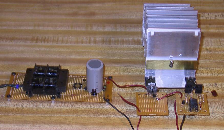

HEATSINK
I have been looking at the heatsink issue for a while (see DIY T2 Clone thread), and so I decided to try a piece (3” long) of the “super large” one I have. It’s cross-section is 4” x 5” with 19 fins! You can see it in the photo. I ran “kgdwhps1” in shunt mode, pumping 11.2 W into it. The ambient was 74 F, and that 3” piece of heatsink stabilized at 114 F. That means an 18” length could handle 67.2 WATTS! That’s just ONE side of a T2 type chassis, so it’s 134 W for a full chassis. KG, your 150 watt chassis is reality!
Stay tuned. More to come.

Those are the same as the krell heatsinks from the ksa series,
anodized black, in 9 inch lengths, and turned sideways.

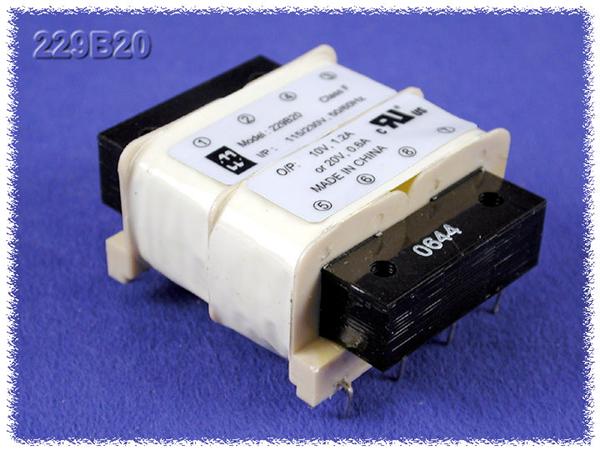

For transformers, why not use 10 Hammond 229B230's, a 229B56 to get 60V for the 560V rail, and a 229B24 for the +/- 12V. Make it modular, using 12 identical PCBs. The PCB layout could take any of the 229 Series transformers and could then be stuffed to create any voltage. (Triad also second source the 229 Series, as their FP line.) As I said before, this would really spread the heat generated by the transformers around the PS chassis.
So what's wrong with using these "semi-toroids"? Let's hear all the advantages of using toriods. Check out what you get for $12 in the pic below.
post-2933-0-66242900-1301940645_thumb.jp
Isn't that Hammond just a split bobbin? I don't see how that is related to a toroid at all. I would imagine the benefits would be extremely low interwinding capacitance and very low bandwidth.
Yes, the Hammond 229 series is a split bobbin. (They call it a "semi-toroid" because it has a few characteristics in common with toroids.) I want to compare the 229 against true toroids, which would have better regulation, lower self-magnetizing current, etc.....
In other words, are true toroids that much better that we can rule out using the 299 series?

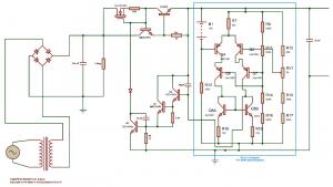

"Bug Fix" on the ".kgdwhps1". Latest version attached: "kgdwhps2"
Added diode in series with series element to avoid reverse current through 2n3904 and Rs.
There may (actually, probably will) be additional "fixes". So, don't generate your BOMs just yet! This means you, Justin! :D (By the way, I really like your chassis work.)

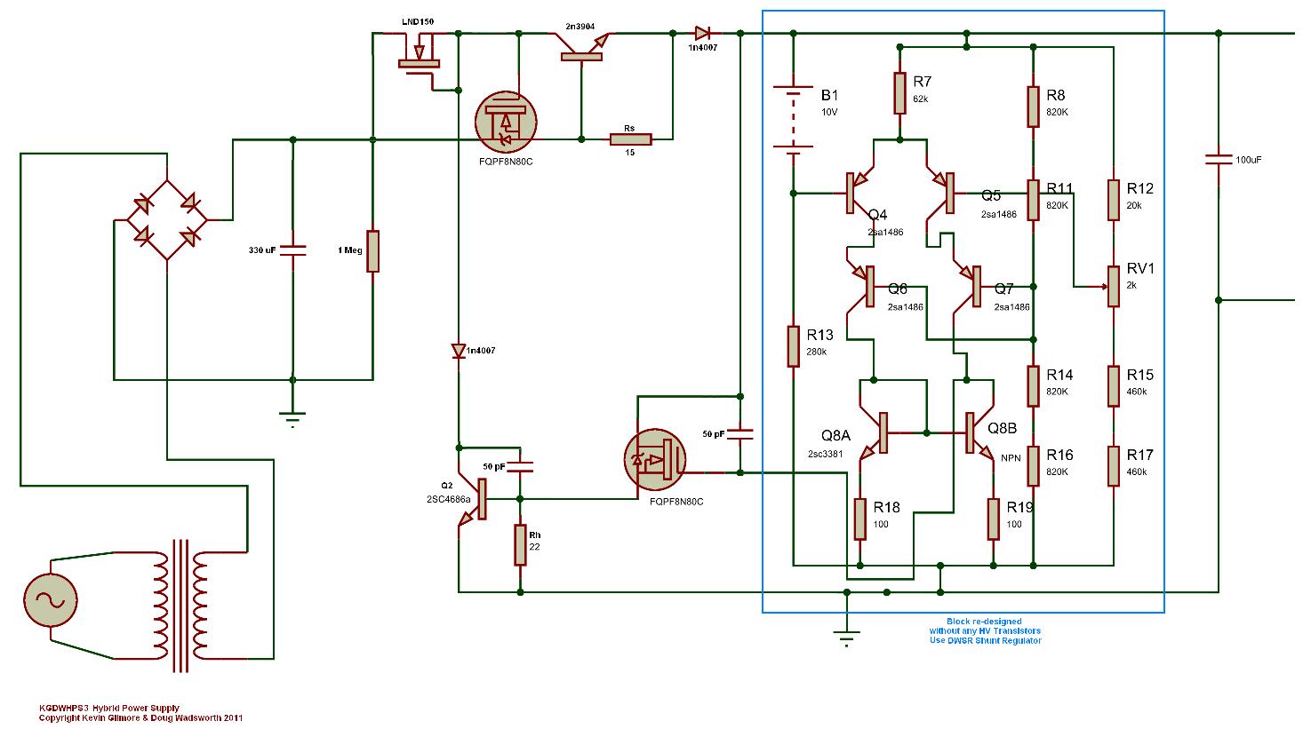

Attached is "kgdwhps3". I haven't tested this yet, but if it can be made stable, I think it would be the best topology for the new Hybrid PS. (I'll get it on the bench as soon as my fqpf8n80c's arrive from Mouser.)
Compared to version 2, the HV NPNs are gone, replaced by the MOSFETs. The ixys10m90s is gone, replaced by the Supertex LND150 (available at Mouser). This is a TO-92 device, off the heatsink. Only the isolated package MOSFETS are on the heatsink, making this easy to build. For higher power and voltage (I'm testing these ideas at 250V @ 50mA), we might add more '8n80c's in parallel, and more LND150's to share to load.
Thanks to luvdunhill and the Basaudio guys for suggesting the LND150 (only $0.69!). It's a handy little HV current source. Check it out.
Linear
Update: Has been tested and has stability problems. See next (#92) post.

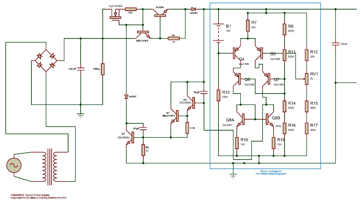

Time for an update on the "kgdwhps3" schematic shown in the previous post (#91). My MOSFETS finally arrived, and I got it on the bench.....
Bottom line: It is VERY difficult to make stable with the MOSFET output on the active battery. Using the FET increases the gain of the circuit dramatically, and this is a problem. I cut the gain down by adding a resistor (51K) across the gate and source of the fqpf8N80c, but it still takes lots of capacitance to tame it. So, right now the MOSFET version is a work in progress.
MEANWHILE, the bipolar version "kgdwhps2" (post #90) seems to work perfectly, with only 50 pF compensation caps. I've taken it up to 50 mA with 50 uF on the output and it's fine. I haven't measured any noise yet because my "Plexiglas blast shields, Teflon caps, and 5 digit floating noise analyzer" are still on back order! :D (as recommended by KG for diode noise measurements. B) )
Regarding the DWSR block that I re-designed, I will have more information very soon.
