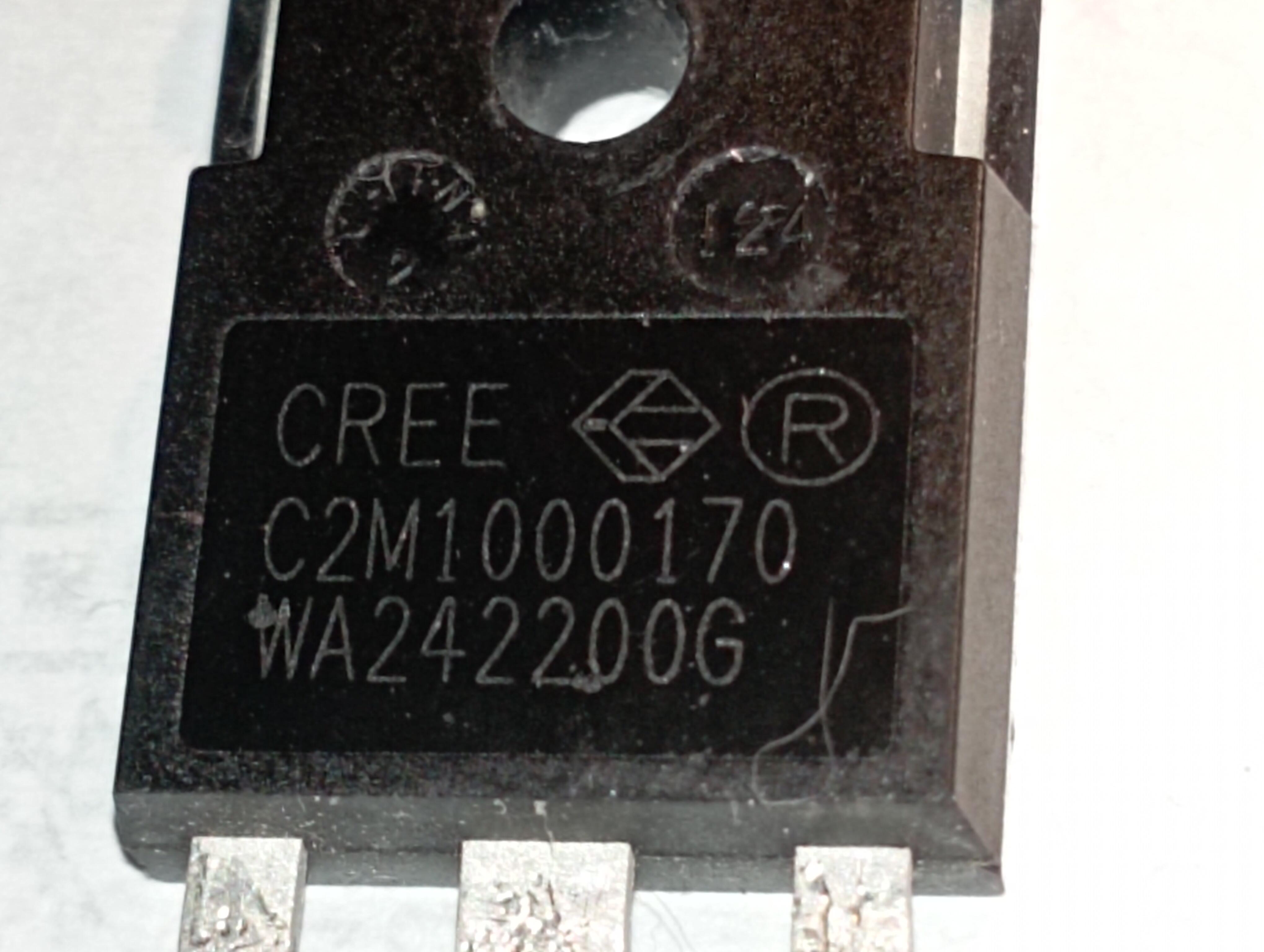

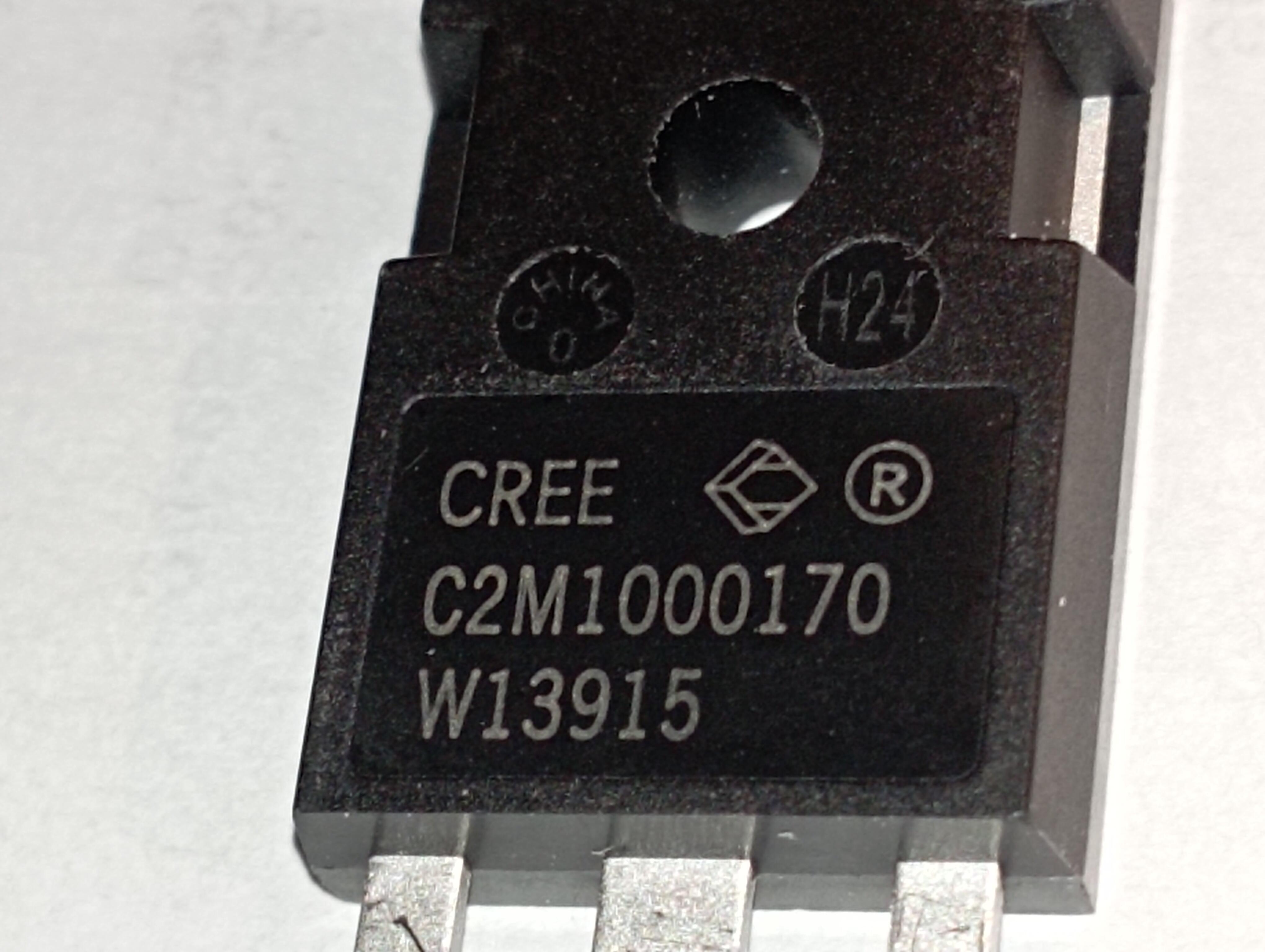

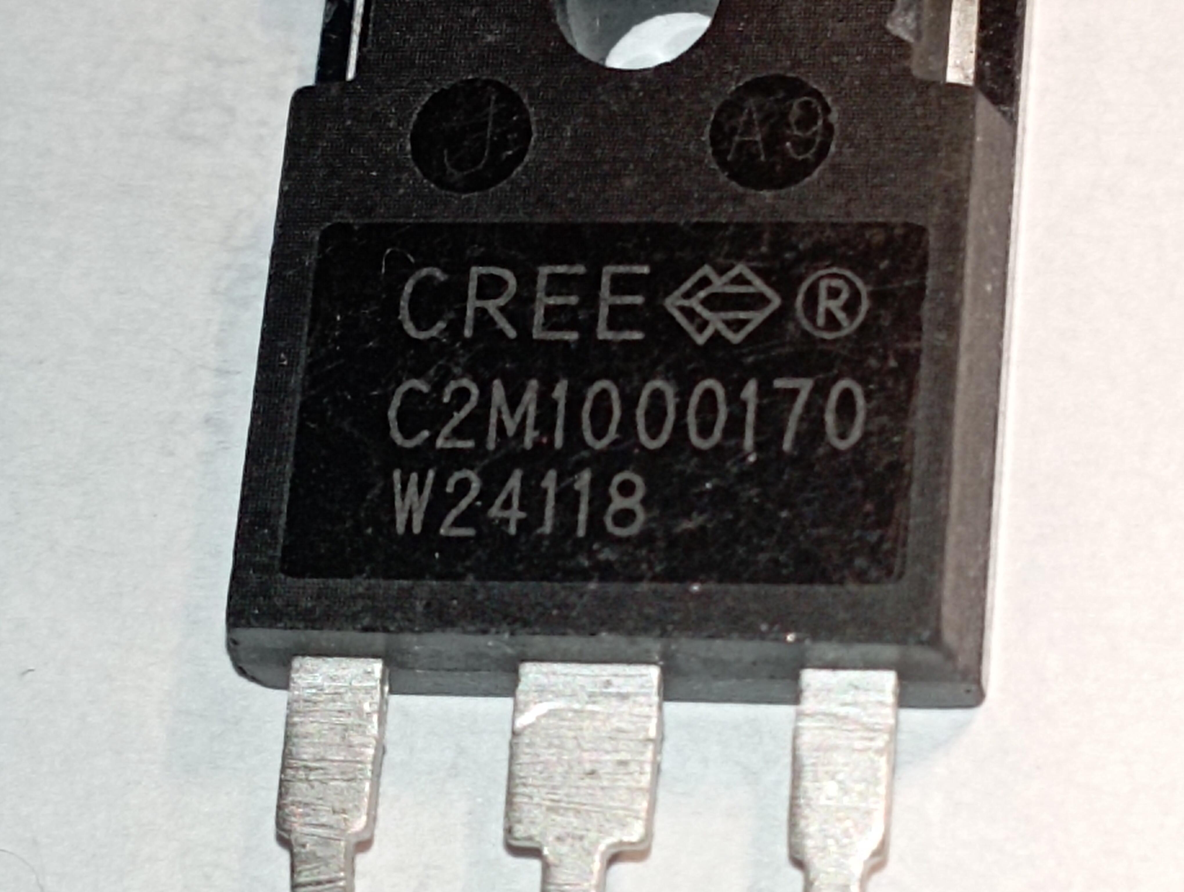

  3. How do you determine if a part is a fake? If a part with a poorly done or a suspiciously looking marking meets all the specifications of the genuine part that you can verify, would you still declare it a fake?
  4. the 3rd one is the only one with the box after the cree label that matches parts i have. my parts mostly have a w13814 date code
  5. I will show three photos as a riddle. One copy from DigiKey/ two variants from China, and surprisingly, one of the Chinese ones is not a fake. Who can visually determine the fake?

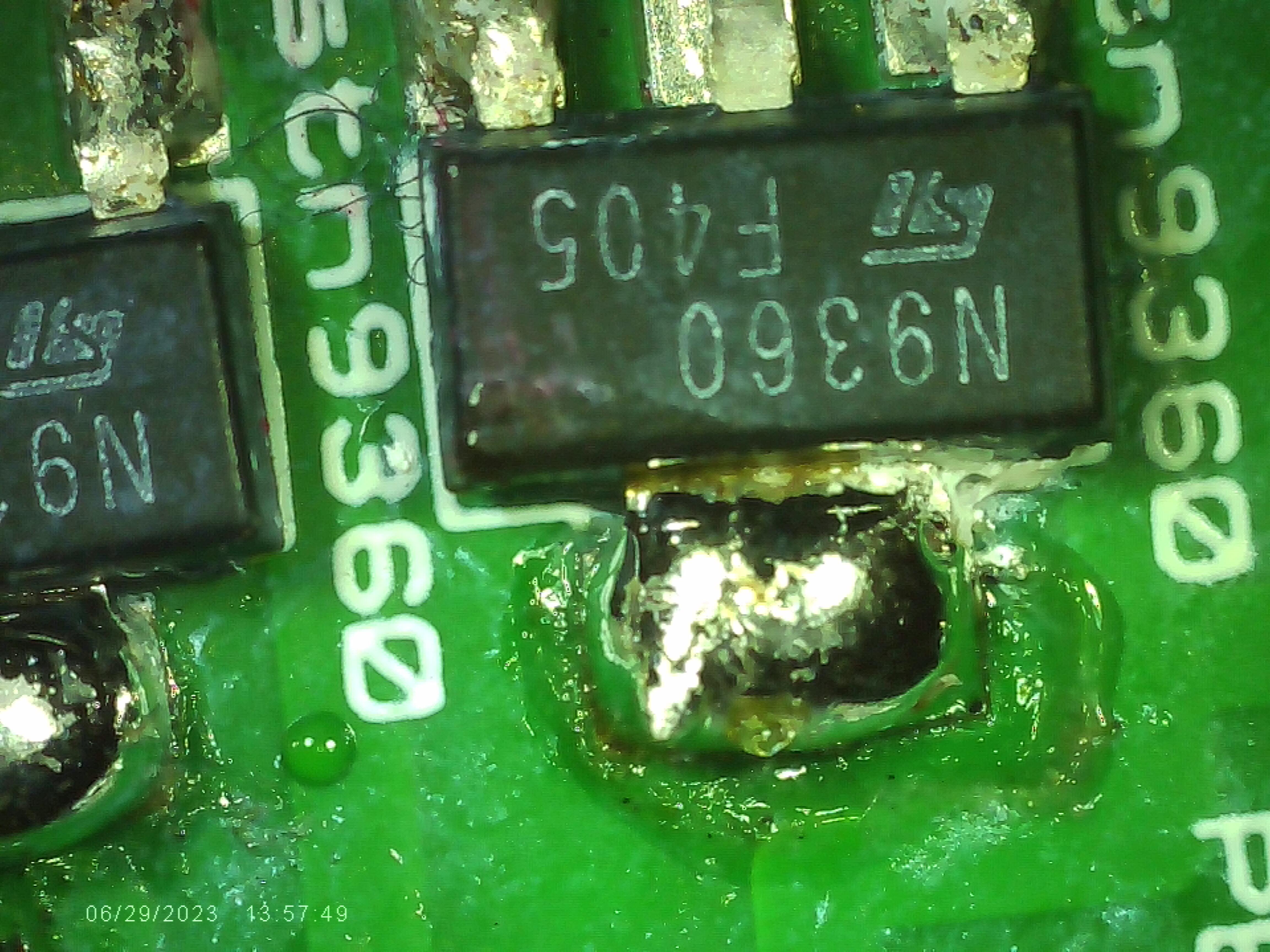

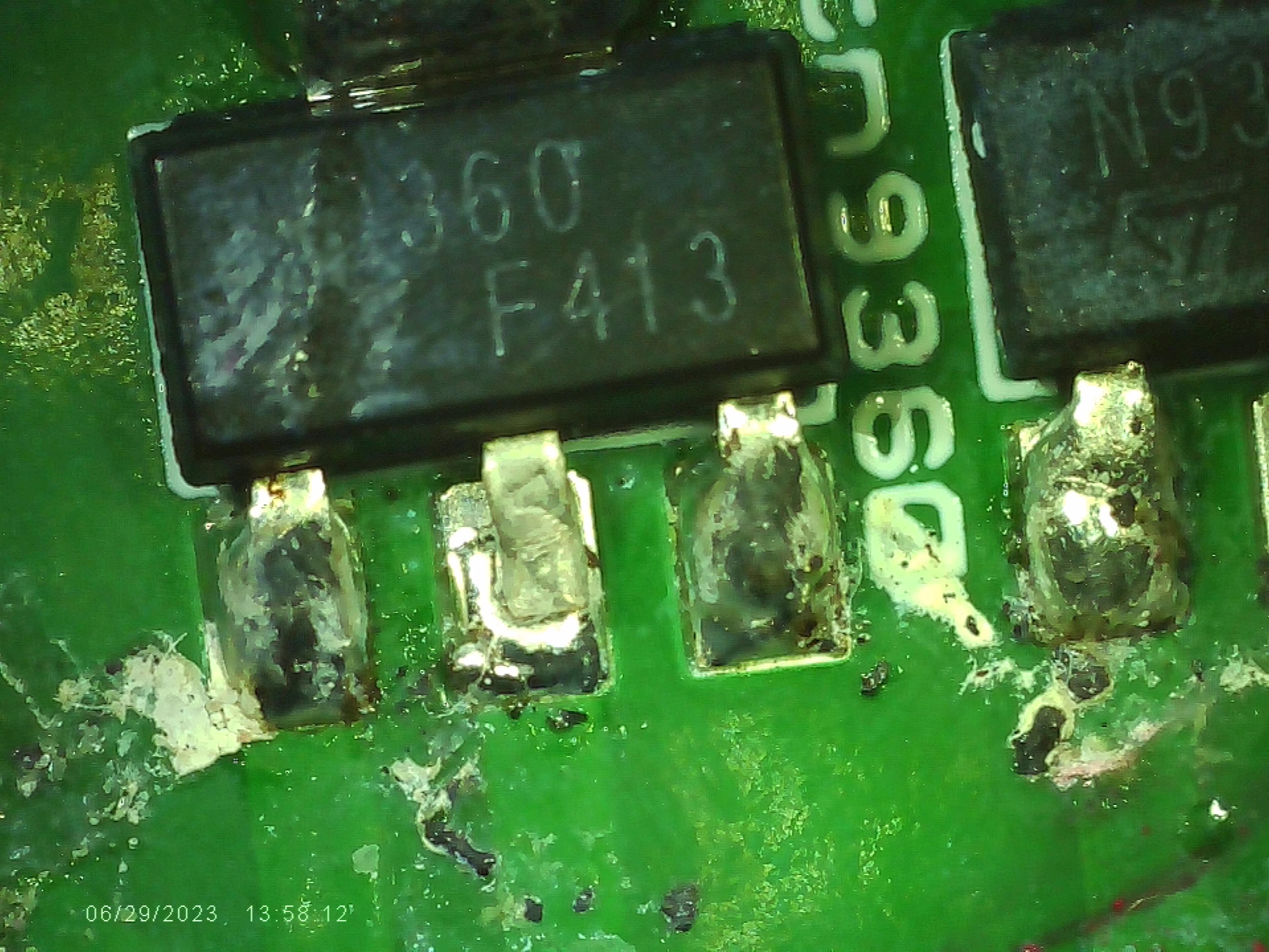

  10. please show a photo of the ST brand sign. And if you write that I show hFE measurements, I will have a holiday.

  13. i just looked at what i had in stock. F405 and F413. both work fine. logo looks printed on. not etched and not stamped either.
