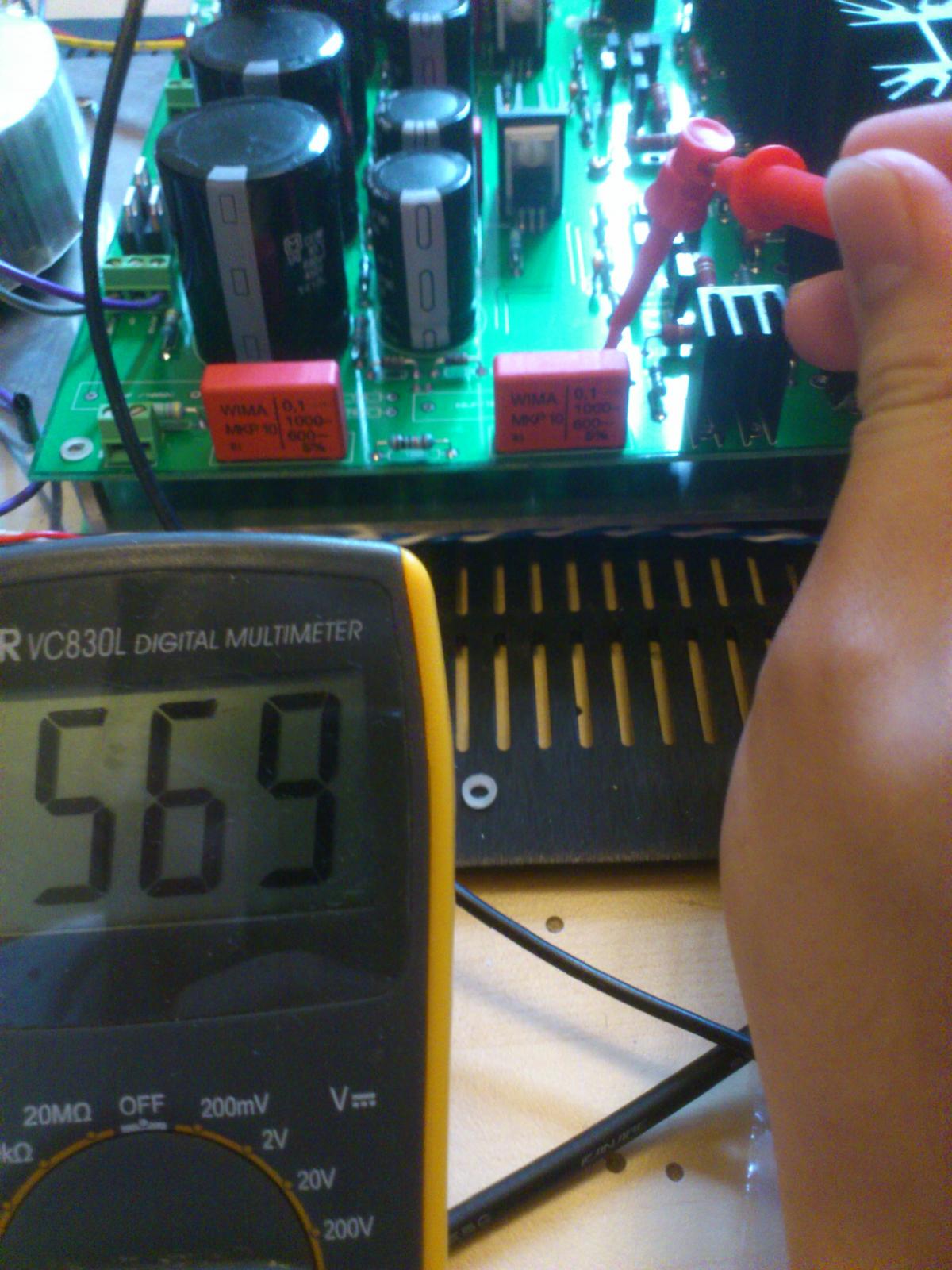

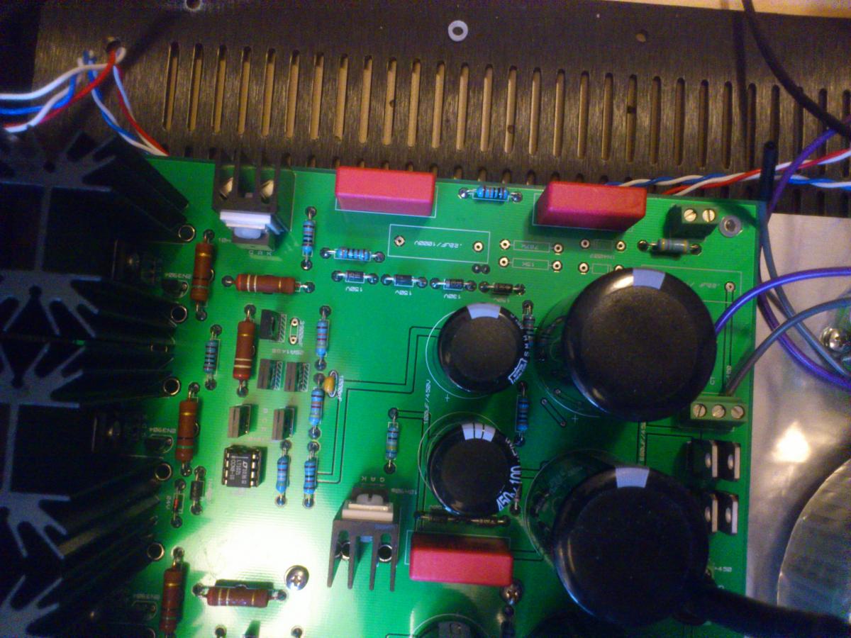

  12. Some images of the bias supply readout: jumper: zener string: before 4.7M resistor: Overall shot of the bias supply: Can I assume that the voltage drop over the RCRC filter is normal?

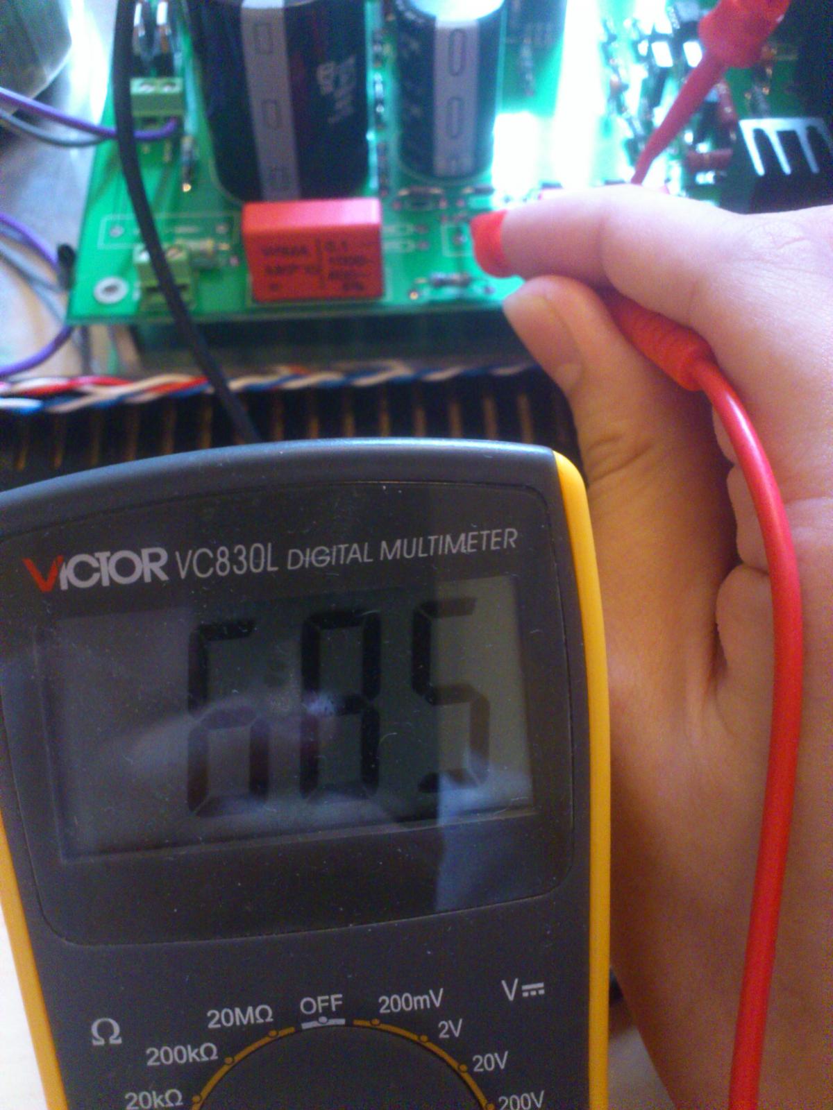

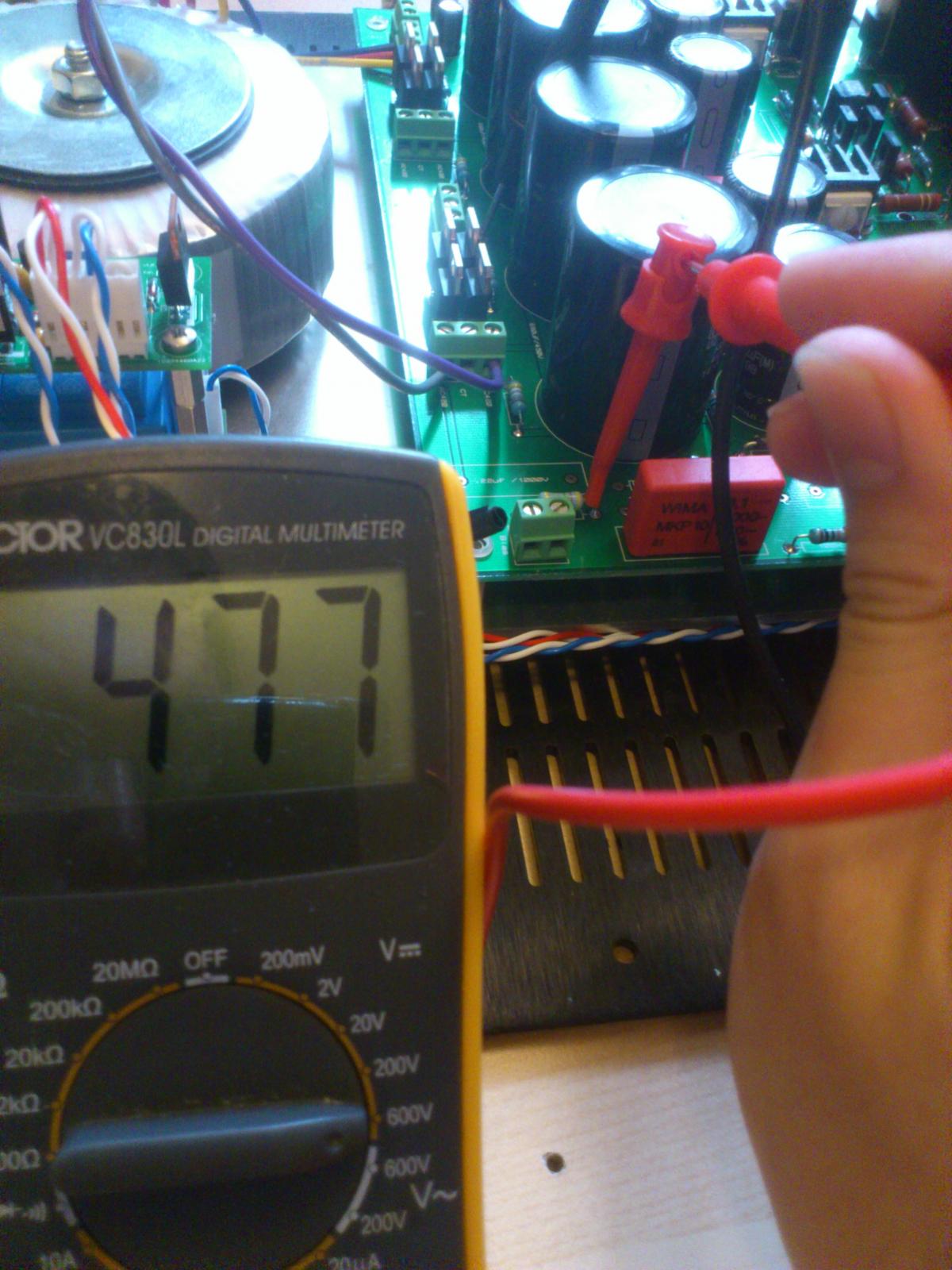

  13. Actually, I'll have to take your words with a grain of salt. I'm sorry, but I don't know you, I don't know your technical background, and you've come in directly with a strong opinion about a product that's yet to be released. Please read the welcome PM again.

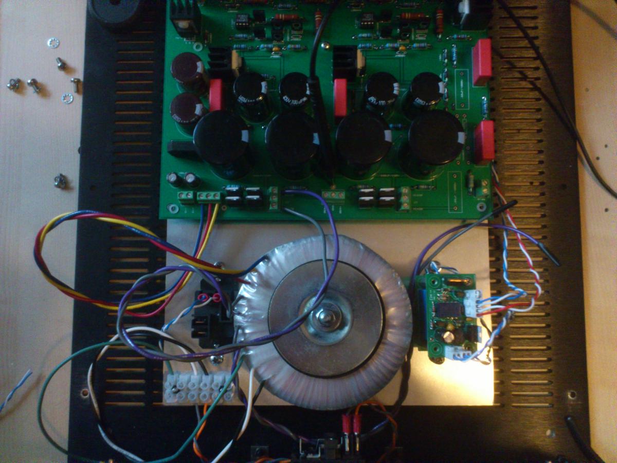

  14. I left out the voltage doubler. Connected the jumper. The voltage readings at the jumper was about 630VDC. Here's an image of the wiring when I was testing the negative rail. It should show the parts I left unpopulated. I'll take a better image tonight when I get home.
  15. Thanks! Measuring before 4.7M to bias output gives me 480V, measuring the zener string gives me 580V. I'm guessing the RCRC filter dropped 100V. I'm also reading... 99VDC at the bias supply output; with reference to ground. I was using 1A fuse before. It immediately popped at start up. I think startup transient caused it to blow.
