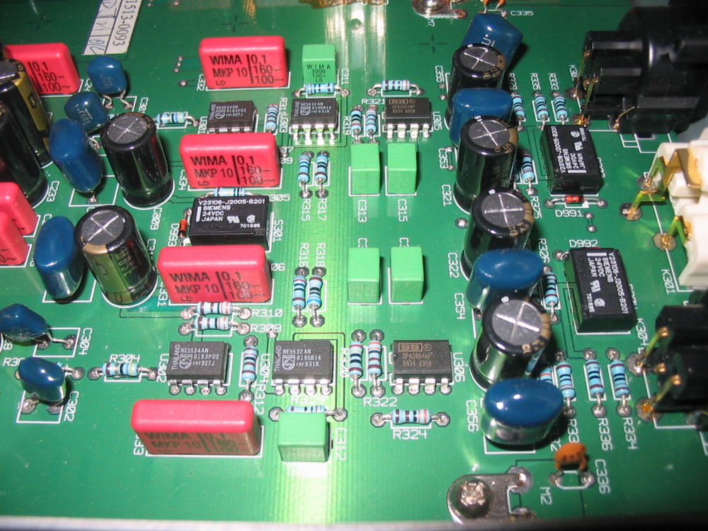

  14. I'm getting ready to build up one of Colin's tooleaudio I/V stages to put into my Rotel RCD-991. This is a dual PCM-63P player with pcm100 filter. I have currently been listening to it modded with THS4031s for the I/V stage and AD8599s doing the buffer/bal conversion. stock output stage: U302 is the single I/V opamp, U306 is the buffer/conversion opamp (dual) and U304 is an anti-aliasing opamp (socketed now, but not populated. I am trying to decide whether to Retain the AD8599s as buffers/conversion Replace the AD8599s with different opamps Use transformers? If so what? Other? I want to retain the muting relay functionality. The markup below is a first stab at what I think needs to be removed (green) as well as the output (to I/V stage) and input (from I/V stage) back into the player. DC coupled, so the coupling caps will be removed and jumpered. Any suggestions welcome.
