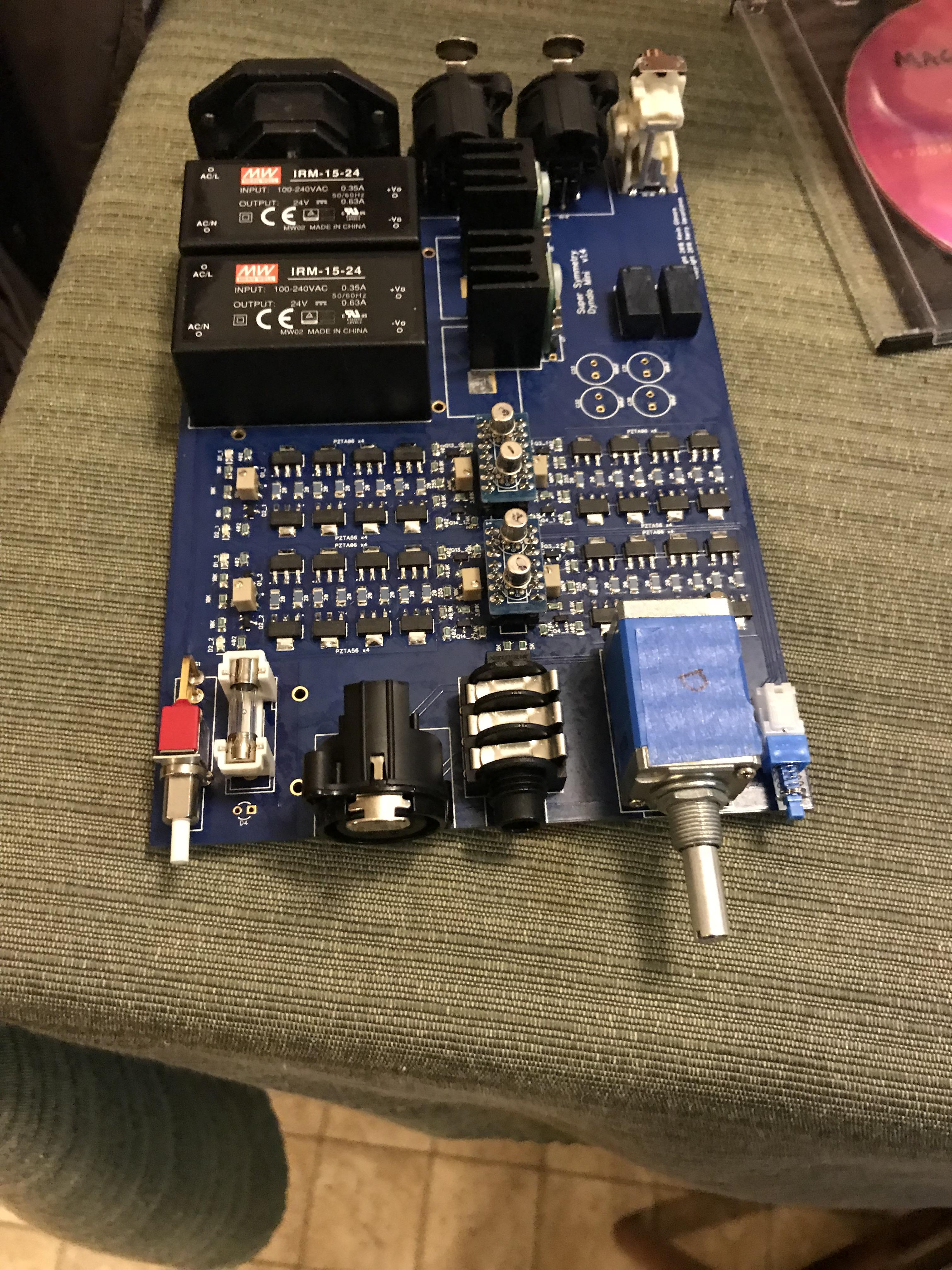

Got the first of the 3 minis finished more or less (less case, etc.).
Had it running on AC for about 5 mins or so. 255R bias resistors, +/-20V PSU... I'm only seeing around 170mV across the 20R resistors. Low, and seems strange with others getting 18mA with 220R, etc.
As for adjustment (offset), I used the pots by the LEDs to get the offset between +/- for that channel centered around ground, then had dialed the individual offsets in using the other 2 pots. Anyone have a different adjustment method? I may play with the pot by the LEDs and see if that does anything to the bias current or not.

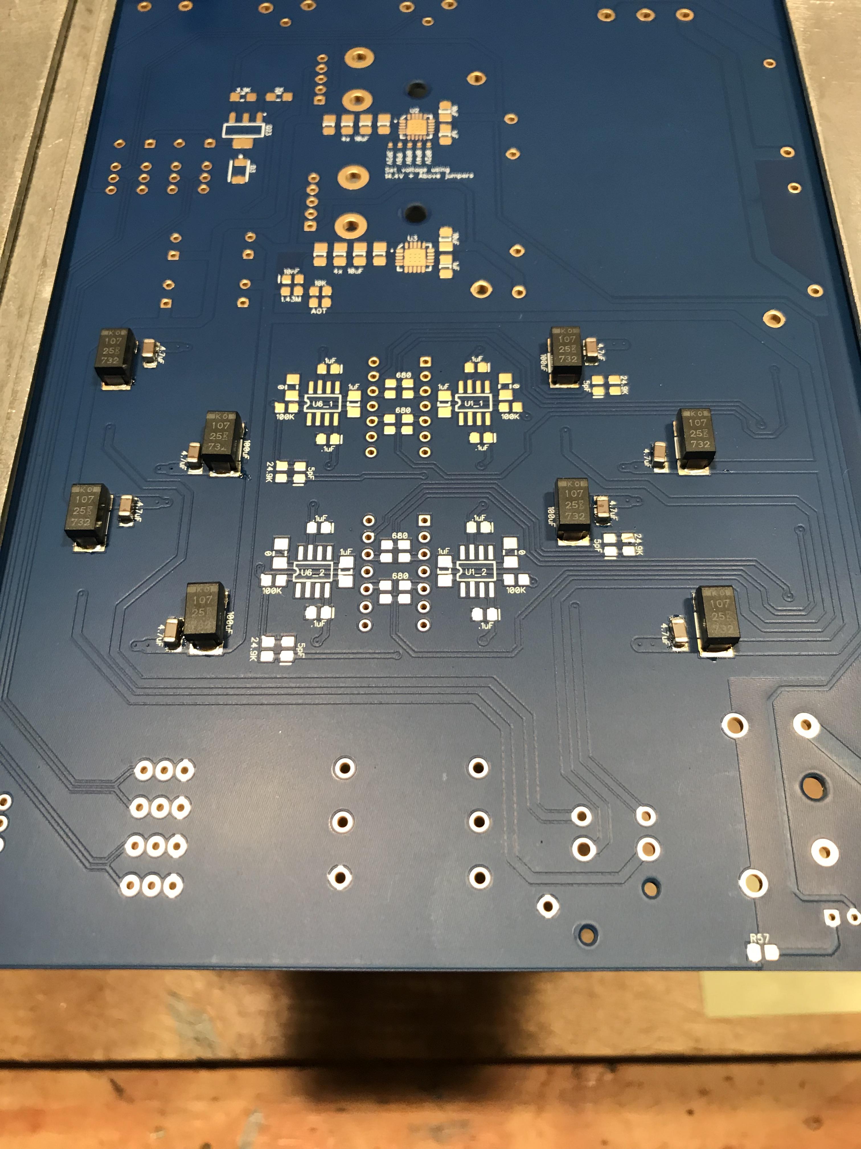

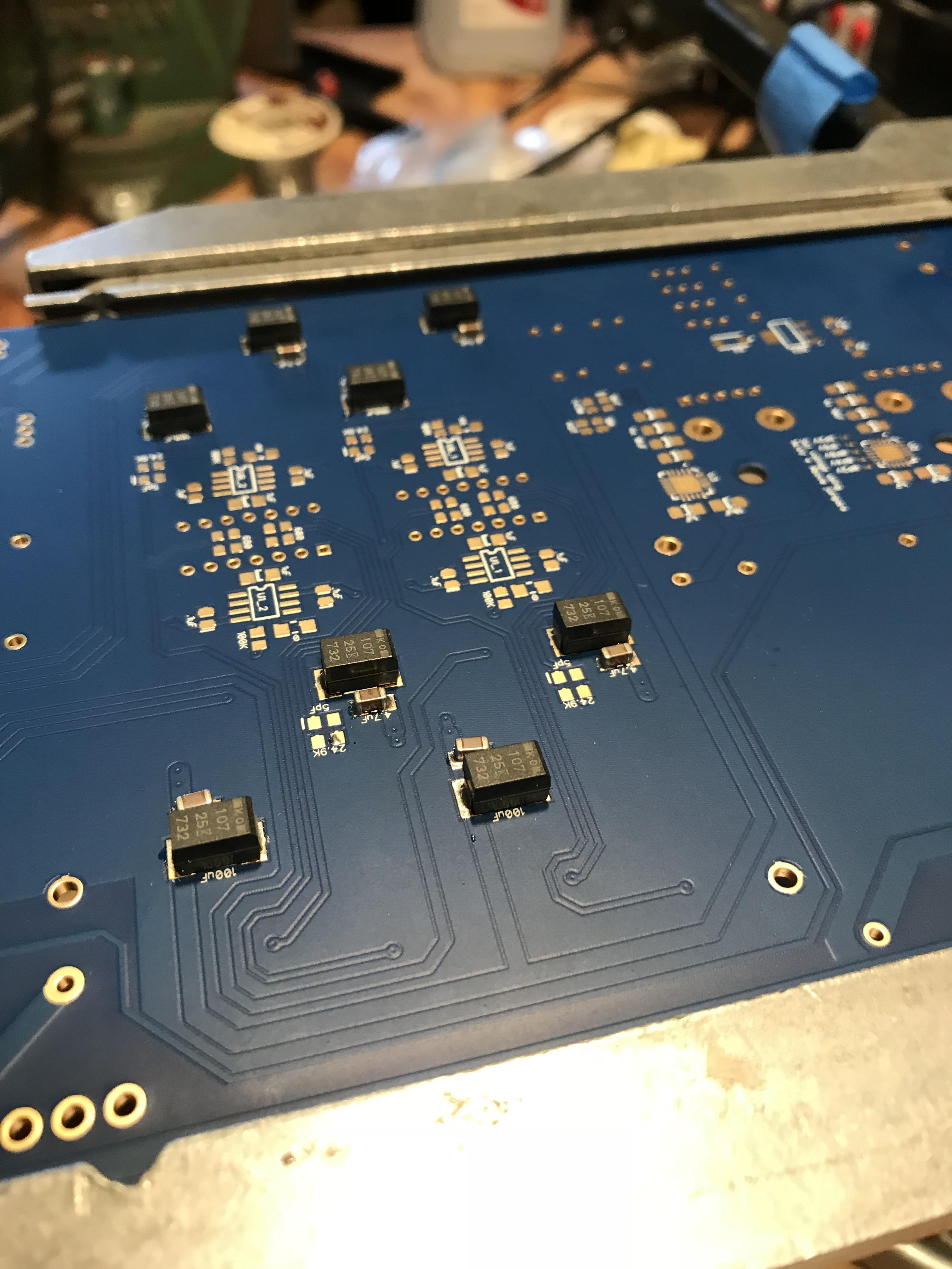

Did a little "baking" yesterday, using the Kester EP256 paste I got. Still had to preheat the boards with a hot-air gun before applying the paste, but I like this paste a lot better than the Chip Kwik I had gotten. I think it turned out pretty well.
