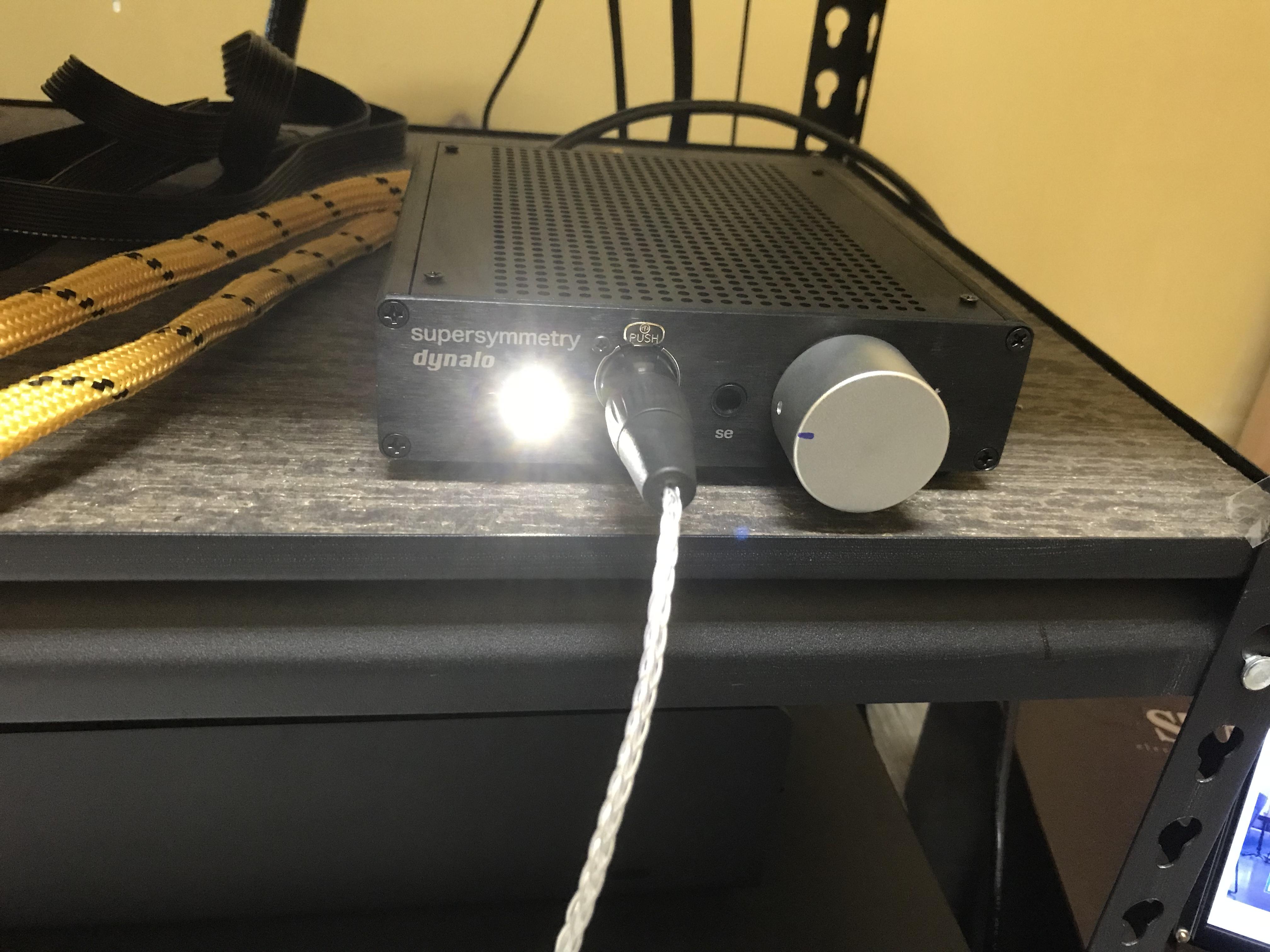

Whitigir Posted October 29, 2018 Report Posted October 29, 2018 (edited) Alright, after the adjustment on the pots. I tossed in all the heat sink and 0 ohm resistors and had a test spinning. The result is staggering ! HD800S sounds so wonderful and Excellent to take around ! Woaa Finally, thank you first of all @Kerry for this amazingly portable design and awesome list of BOM and so on. Thank you @kevin gilmore for the amazing cook!. Thank you @cspirou for this beautiful chassis run (it was a perfect fit every where from even the screws itself). Thank you @sbelyo for this amazing GroupBuy on the Boards and Pot which made this project a possible. Then to the last but not least, all of you who contributed into this thread still looking for the beautiful black volume knobs LoL. Also, please don’t mind that LED, I didn’t think it was that bright X_X lol Edited October 29, 2018 by Whitigir 3
cspirou Posted October 29, 2018 Report Posted October 29, 2018 That is one blinding LED. Nice work! Where did you get the heatsinks for the THAT chips? For knobs I was going to go with diyaudio or Parts Connexion
Whitigir Posted October 29, 2018 Report Posted October 29, 2018 (edited) 31 minutes ago, cspirou said: That is one blinding LED. Nice work! Where did you get the heatsinks for the THAT chips? For knobs I was going to go with diyaudio or Parts Connexion Yeah, probably was meant to stay inside but I slot it into the front chassis and it is bright the THAT heatsink was bought from Amazon, but I cut them to fit. Using double sided tapes as you recommended I will give you the exact parts tomorrow Amazon seller is no longer listing this parts. I had to cut it anyways and since it was only 0.5mm thick, it was easy. The brand was BNTechGo 20x20x0.5mm. This link shall bring you to the similar but thicker one, and you can cut it to fit as well ? Edited October 29, 2018 by Whitigir
Pars Posted October 29, 2018 Report Posted October 29, 2018 I used knobs from eBay seller AudioGD and liked them quite a bit, finding them to be nicely finished. 25mm is about as big as you can go on these; might get away with 30mm.Sent from my iPhone using Tapatalk 1

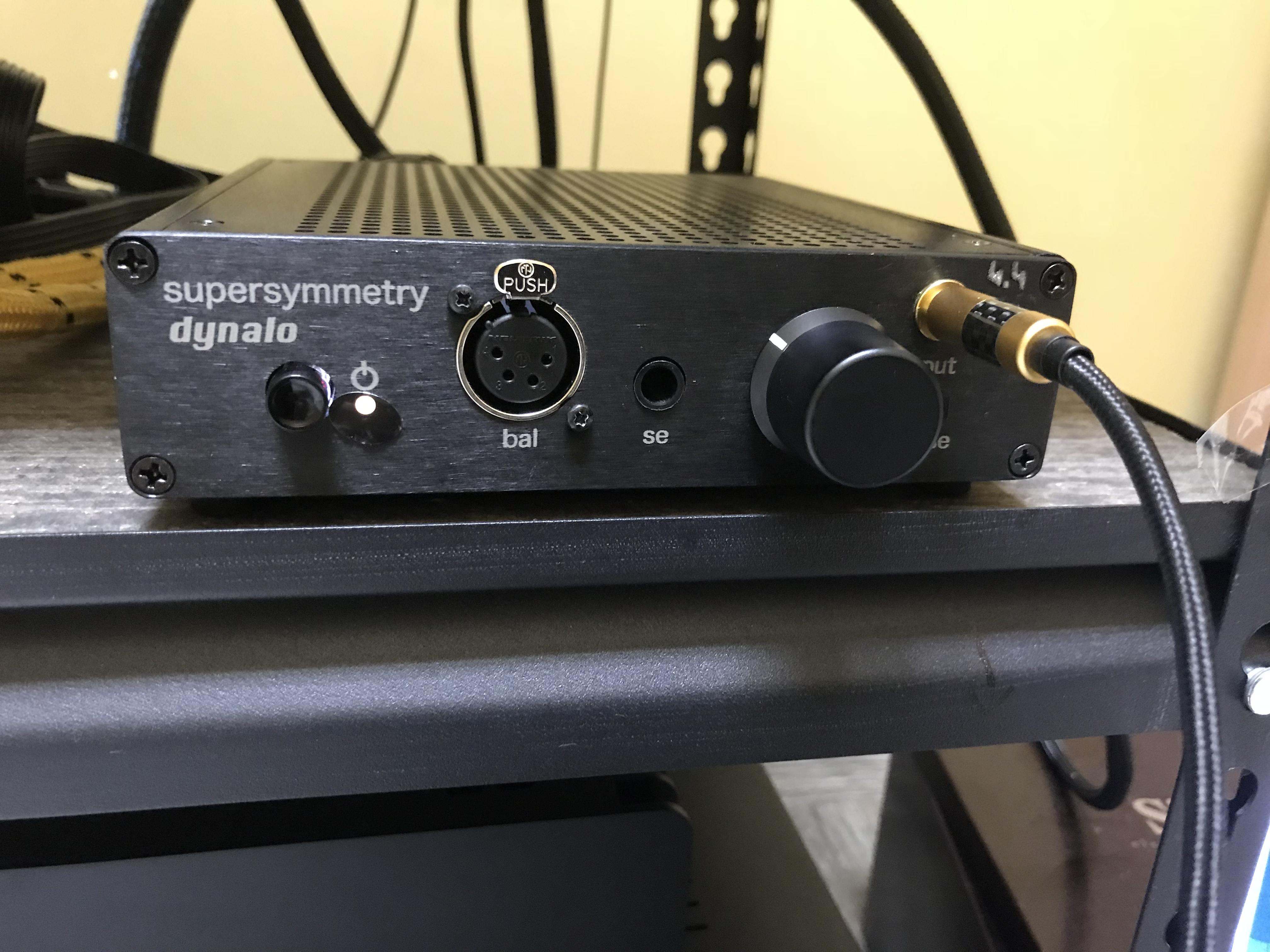

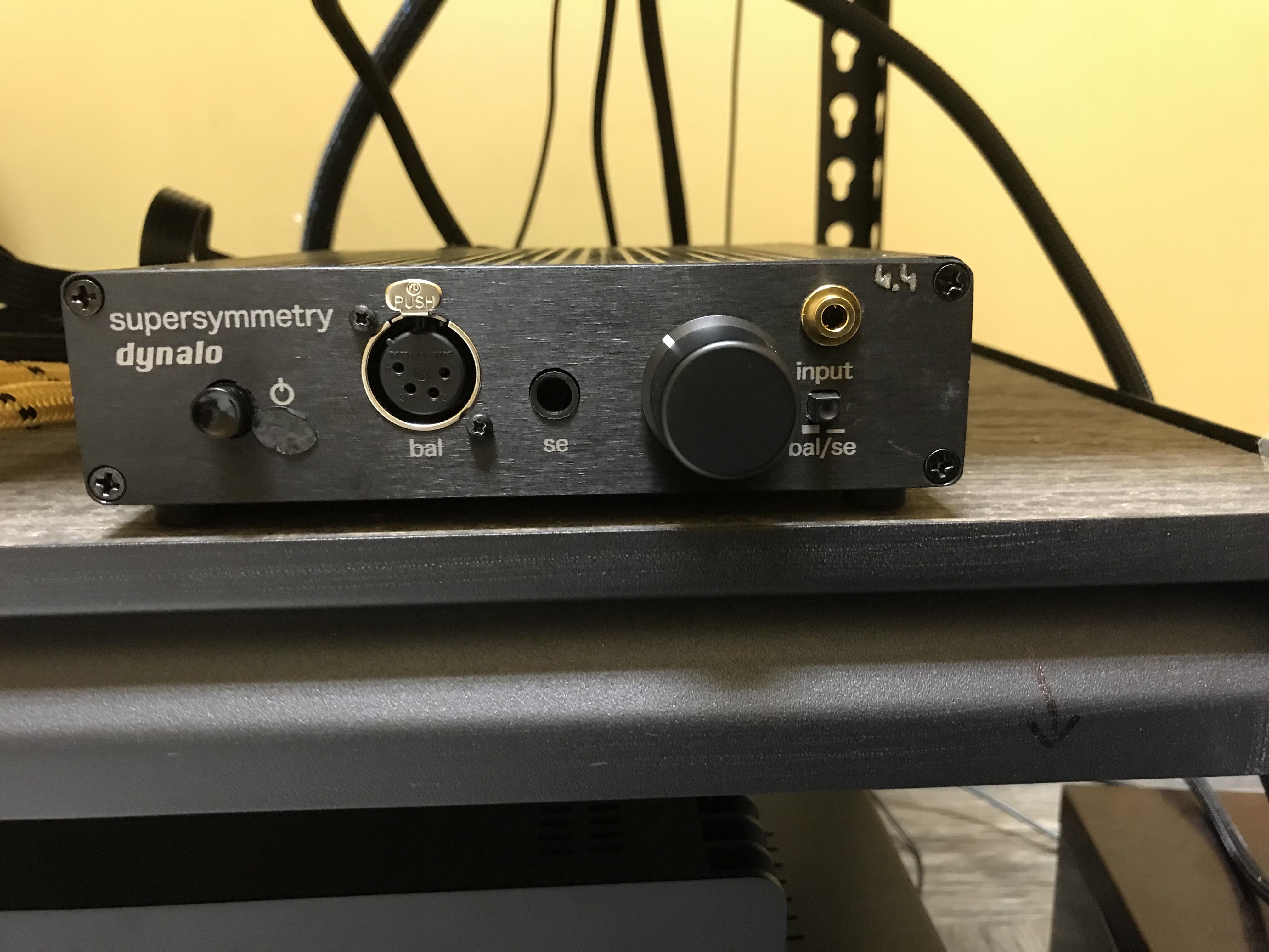

Whitigir Posted November 2, 2018 Report Posted November 2, 2018 (edited) I can not even touch my Mini heatsink after 2 hours on. It literally sits around 70C X_X Anyways, I found the brightness spikes and sizzling top was due to THAT340, as I swapped in the 3381/1349 and I got an observable improve in performances. I used Volume knob from Goldpoint which just came-in, the smallest knob, and she look awesome! http://www.goldpt.com/knobs.html Edited November 2, 2018 by Whitigir 1
cspirou Posted November 2, 2018 Report Posted November 2, 2018 @Whitigir - Did you drill another hole?
Pars Posted November 2, 2018 Report Posted November 2, 2018 You didn’t consider an adapter cable instead?Sent from my iPhone using Tapatalk
Whitigir Posted November 2, 2018 Report Posted November 2, 2018 (edited) 4 minutes ago, Pars said: You didn’t consider an adapter cable instead? Sent from my iPhone using Tapatalk Yes, I did, but have to unplug it and carry it where I want is a hassle. My cables are all 4.4mm it also look good :D, except that I do not have the digital printing, so I just touched it up with paint Edited November 2, 2018 by Whitigir 1

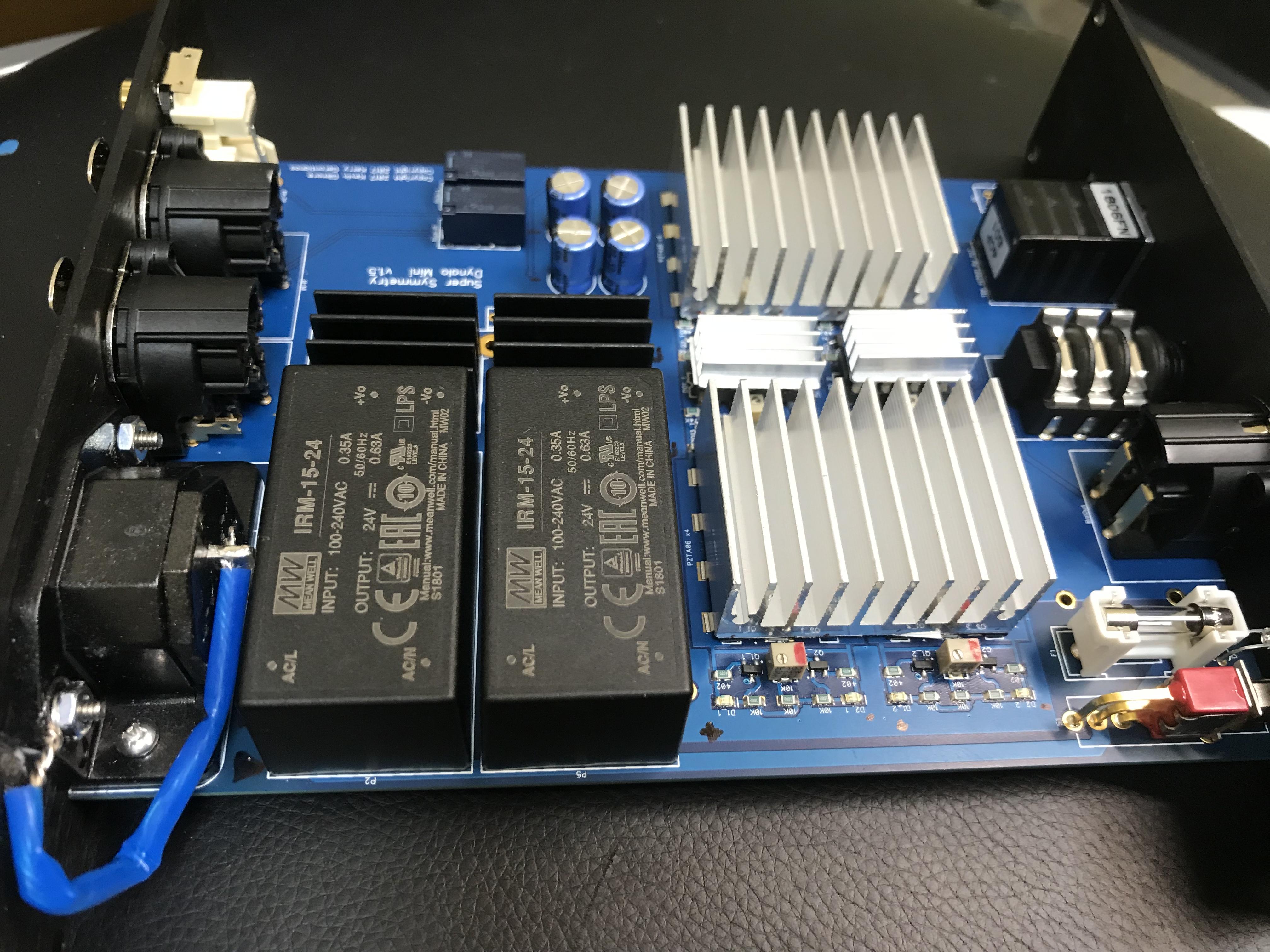

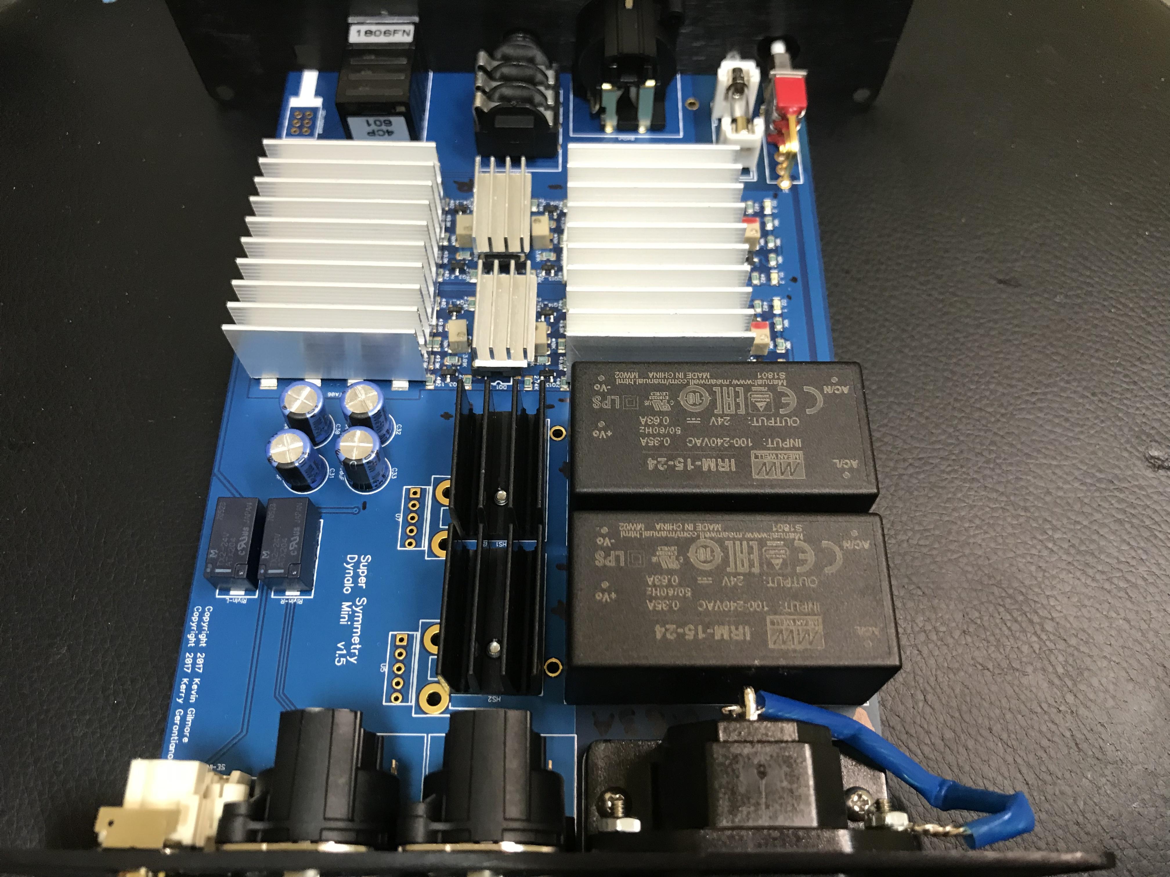

MASantos Posted November 3, 2018 Report Posted November 3, 2018 Regarding the output transistors heatsinks, what size should I look for?
Whitigir Posted November 3, 2018 Report Posted November 3, 2018 (edited) 4 hours ago, MASantos said: Regarding the output transistors heatsinks, what size should I look for? 45x35x18mm https://www.ebay.com/itm/New-Aluminum-Heatsink-Cooling-Fin-Heat-Sink-Multi-Size-Choice-38mm-to-200mm-/263051780518?var=&hash=item3d3f1ba1a6 Edited November 3, 2018 by Whitigir
Pars Posted November 3, 2018 Report Posted November 3, 2018 Yes, that is the same size I used. As I noted above, I'm not sure these run cooler with the heatsinks. I'm going to do some more testing tonight.

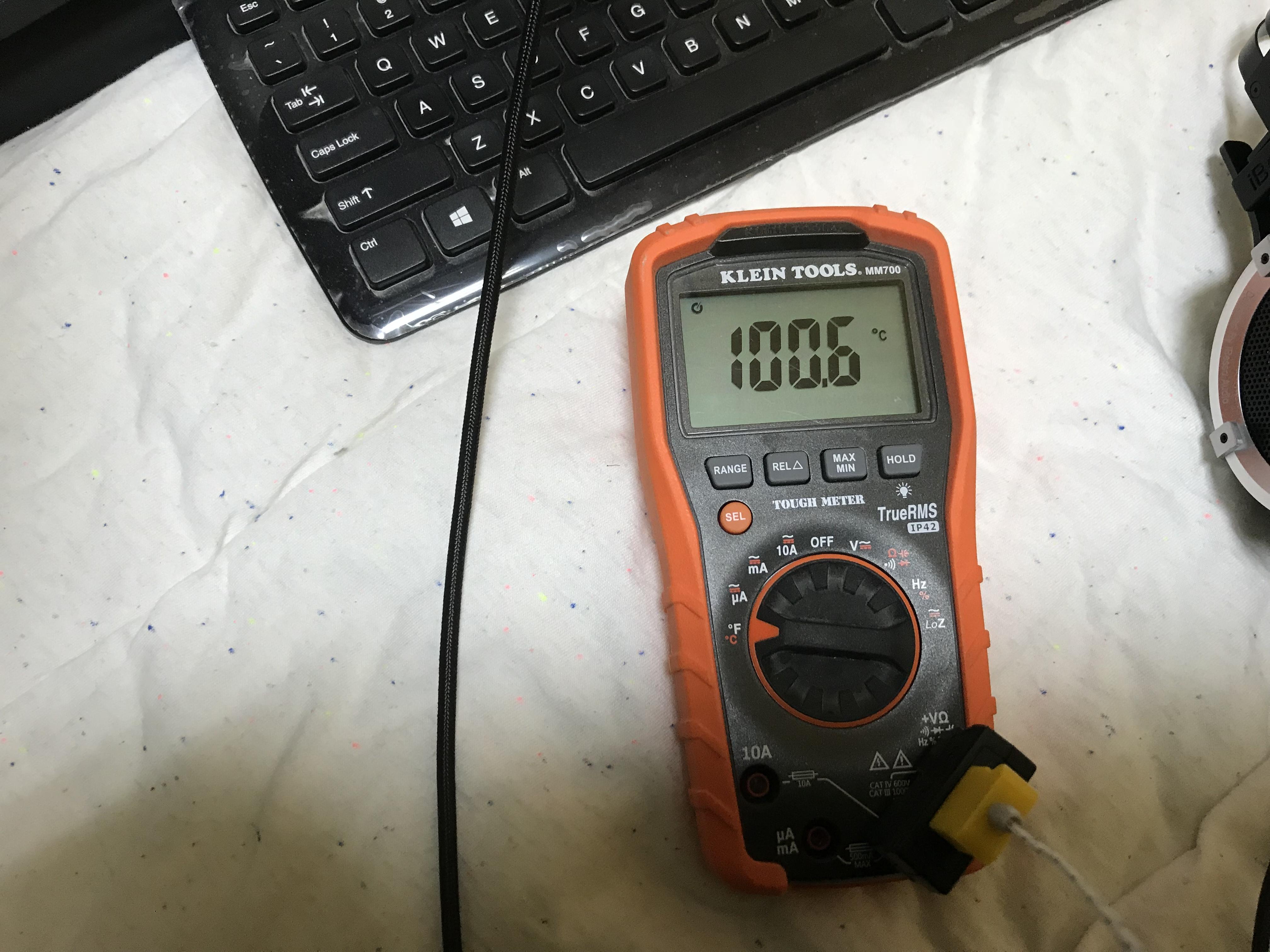

Whitigir Posted November 3, 2018 Report Posted November 3, 2018 (edited) It gotta help right ? The amp runs crazily hot here is right on top of the lowest part of the heatsink, which is closest to the trans after 90 minutes mark or so, and seem to stay at it. The IR-guns only show 70C though...strange Edited November 3, 2018 by Whitigir
cspirou Posted November 3, 2018 Report Posted November 3, 2018 13 minutes ago, Pars said: Yes, that is the same size I used. As I noted above, I'm not sure these run cooler with the heatsinks. I'm going to do some more testing tonight. I think i share this observation as well. Heatsink temp is lower then the naked transistor for sure, but i am not so sure that the transistor itself is actually that much cooler. The vented PCBs like Headamp has on their newer amps would be the way to go, or some sort of PCB mounted heatsink like this.
MASantos Posted November 4, 2018 Report Posted November 4, 2018 Have you measured the top.of the transistors without the sinks?
