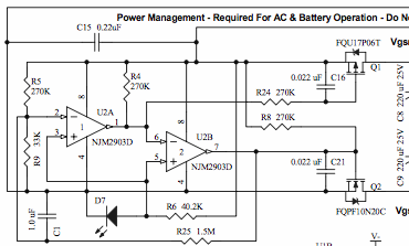

A month or so ago, while perusing diyaudio, I ran across a comparator circuit used for power management in, of all things, the O2 amp. This circuit, placed before or after the regs, with proper parts selection for voltages, would cure this "problem". I realize virtually no one would build one of these for SE output use, but one thing to be aware of. If you are using SE phones with these, wait about 30 secs. before plugging them in.

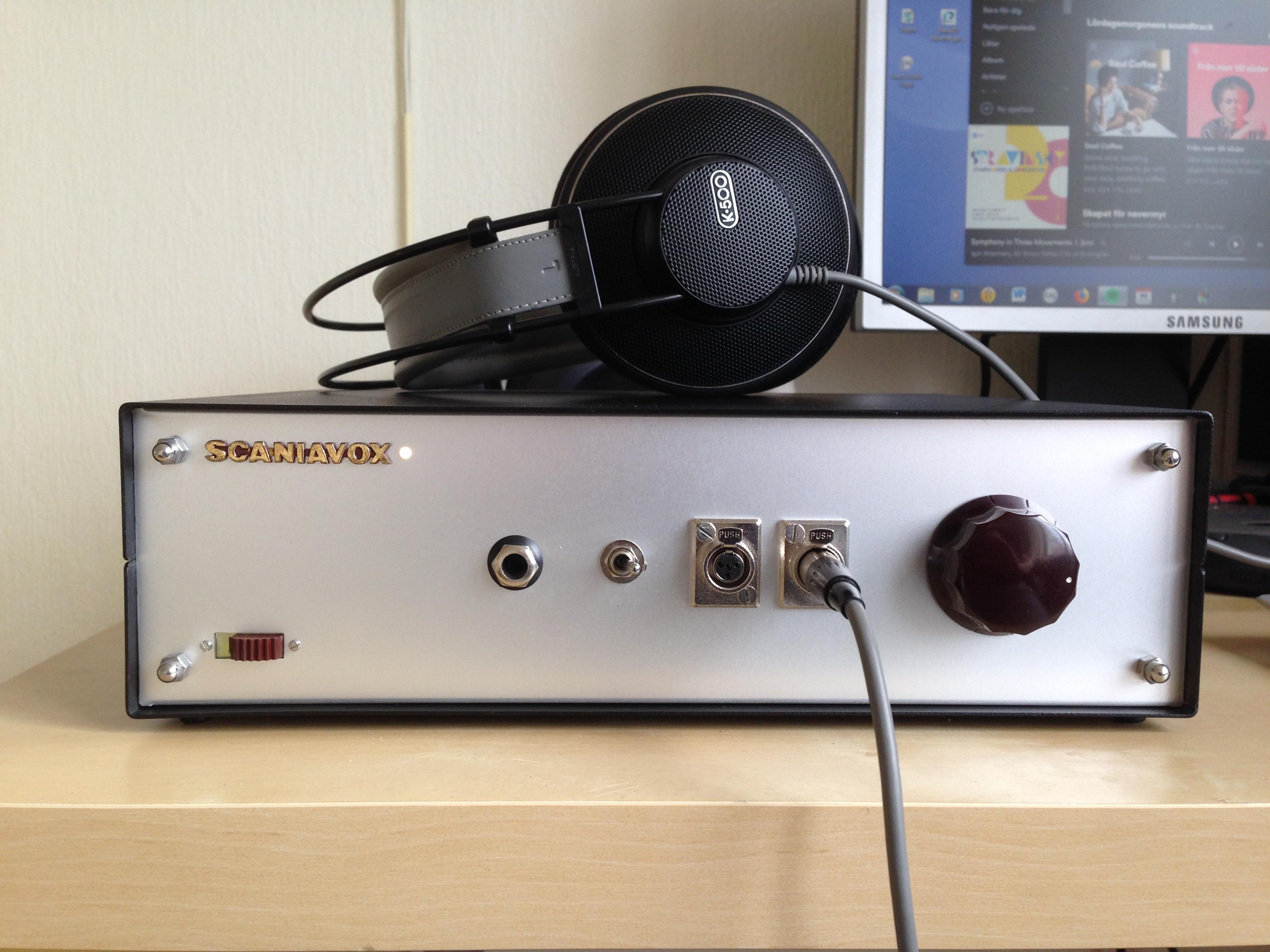

Wow, I like that Scanivox box – beautiful.

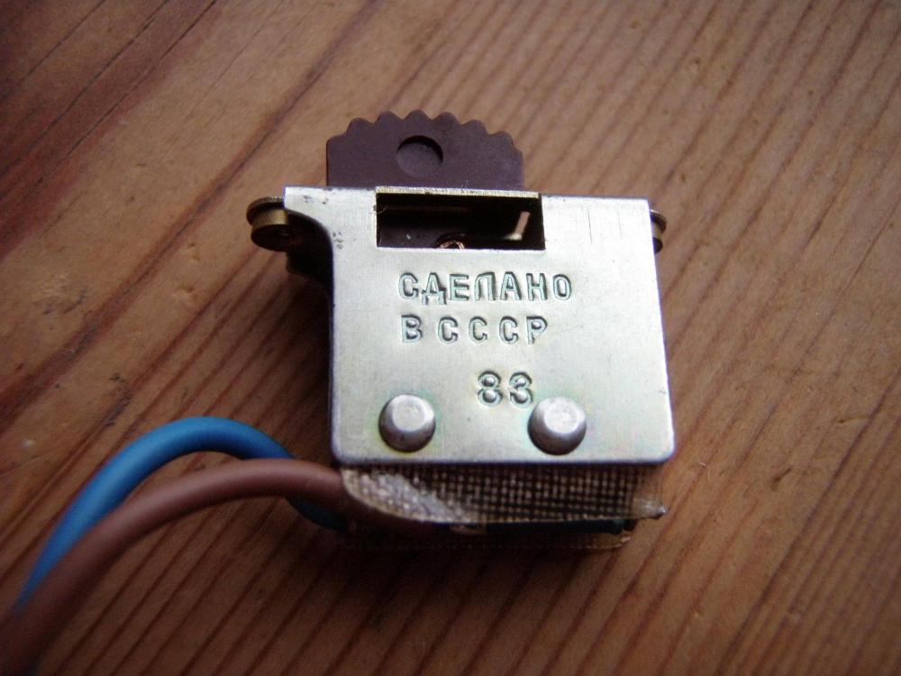

Thanks. Of course a small homage to the Swedish radio manufacturer 'voice of Scandinavia' (1940s). The vintage knob has the patented double dot feature which guarantees perfect channel balance. On-off switch is a spiffy little Russian thing with nice M1,6 threads. Bought a pair from Bulgaria delivered in oiled paper. Strange thing: manufacturer has the same name as me.

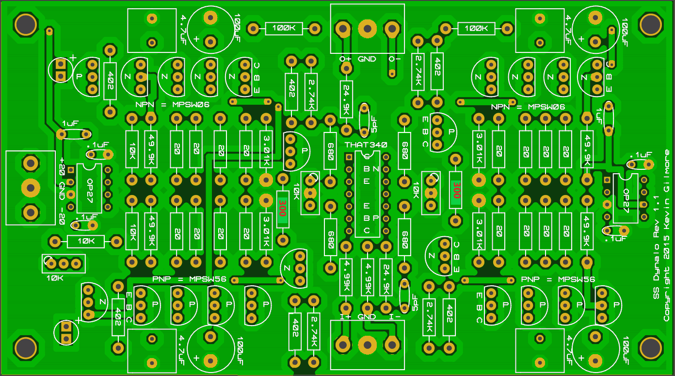

I am going to build myself a mini, and since I have plenty of MPSW06/56, was thinking about using these instead of the PZTAs for the outputs, mainly to look at the thermal characteristics compared to the hot running PZTAs. I know the pin-out is different, but I did a feasibility check with one with a touch of teflon tubing and found it is quite doable. Pain in the ass, but doable.
Head-case? Anti-Head-case? So daft you don't know what to say? :)
Don't know about Mini compatibility (I'm still working on mine), but I built two full-size Dynalos with MPSW parts (I have a small stockpile). They run entirely cool as far as I can tell. I never checked with a thermometer, but there's no sensation of ambient heat if I hold my hand near the boards. Honestly seems like a good idea to use the cooler parts if you can get away with it, though it seems to me like it'll be a tight fit to stuff all those TO92 packages in such a small space.
Agreed on the heat (full size vs. mini). I really don't view the MPSWs as being a problem though. Rough install... if I do this, I will attempt to get everything aligned all nice and purdy...

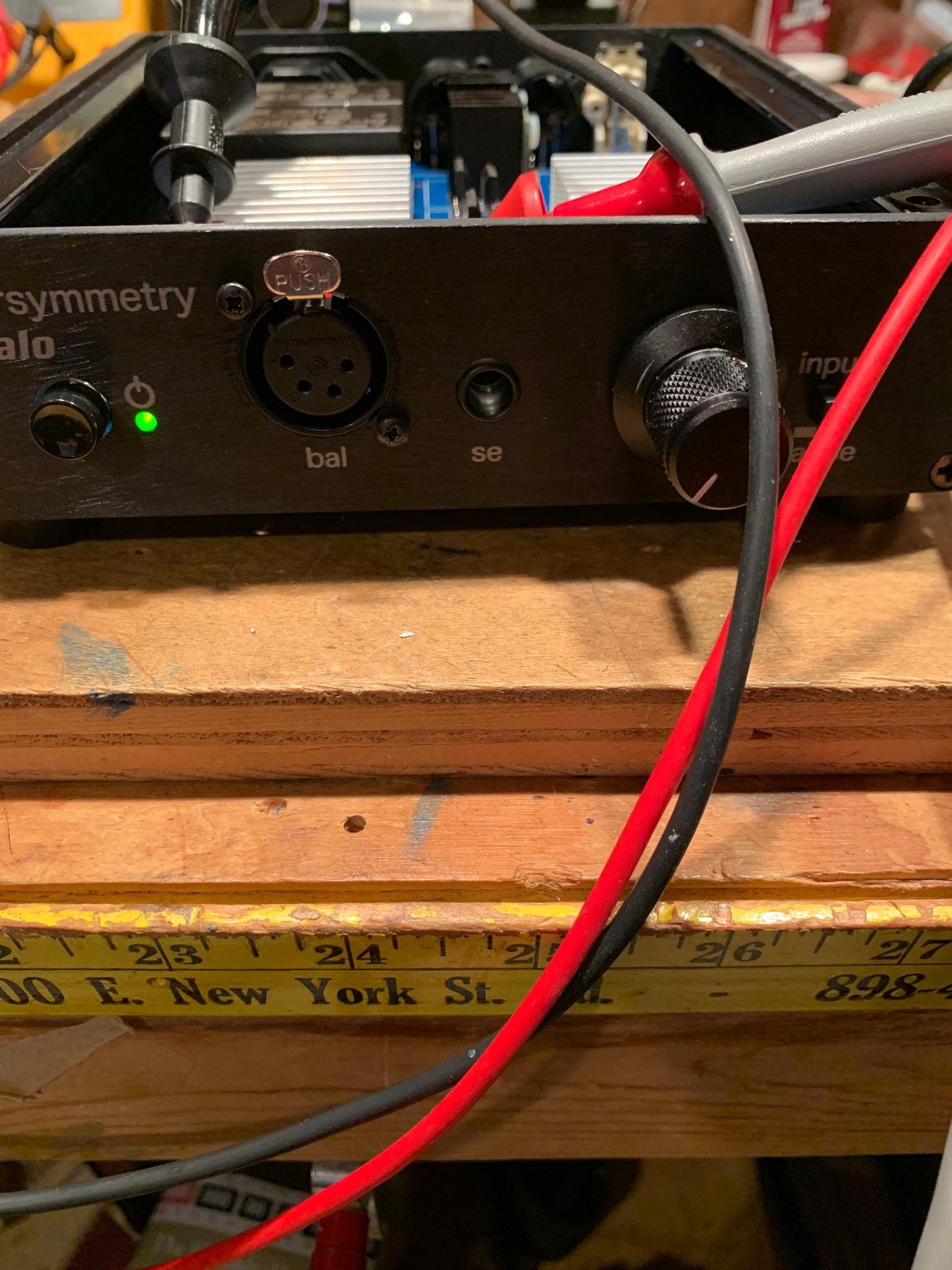

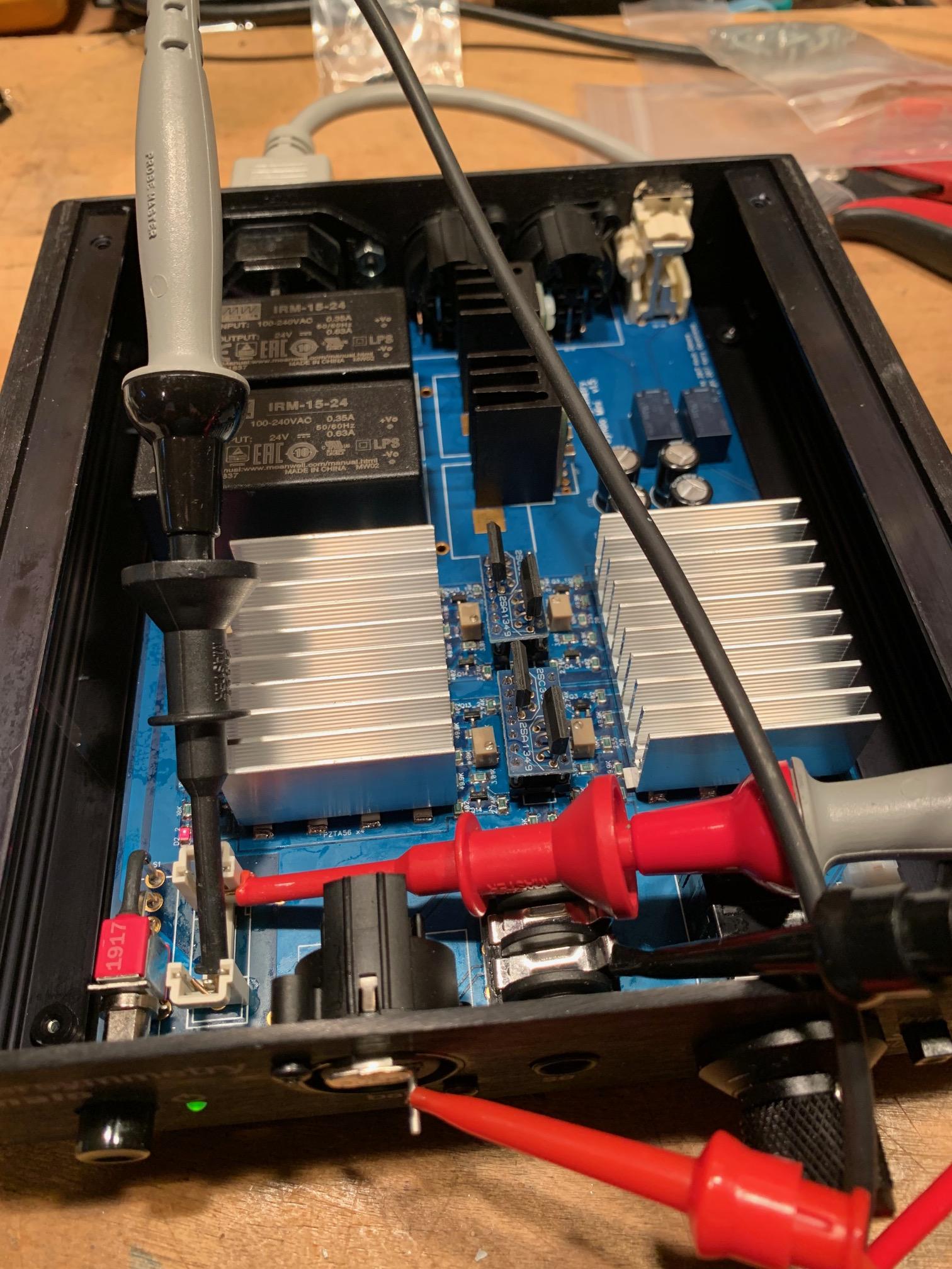

Haven't listened to it yet. I was doing current draw testing here. Without heatsinks: 275mA AC. With heatsinks: 249mA AC. Bias was around 15mA (~300mV across the 20R). Heatsinks should keep that in check.
Edited by Pars

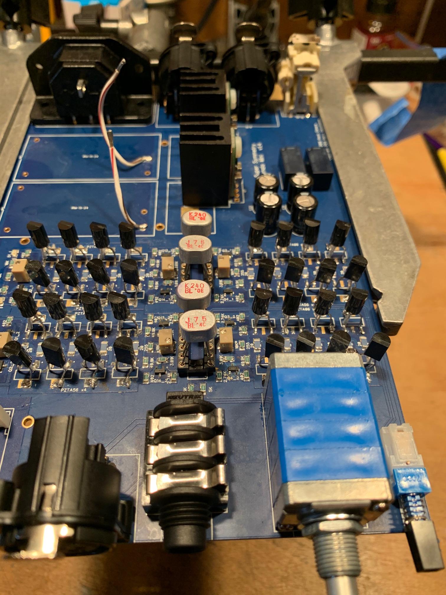

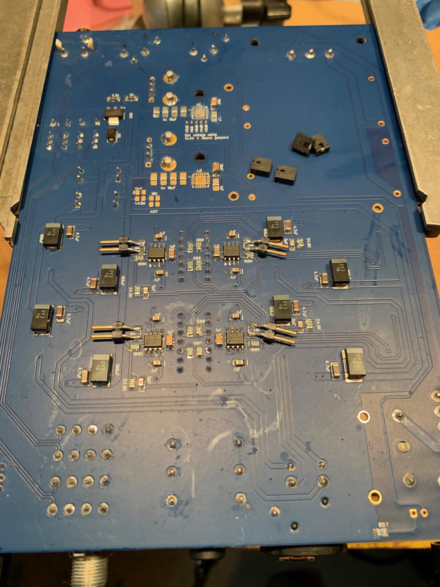

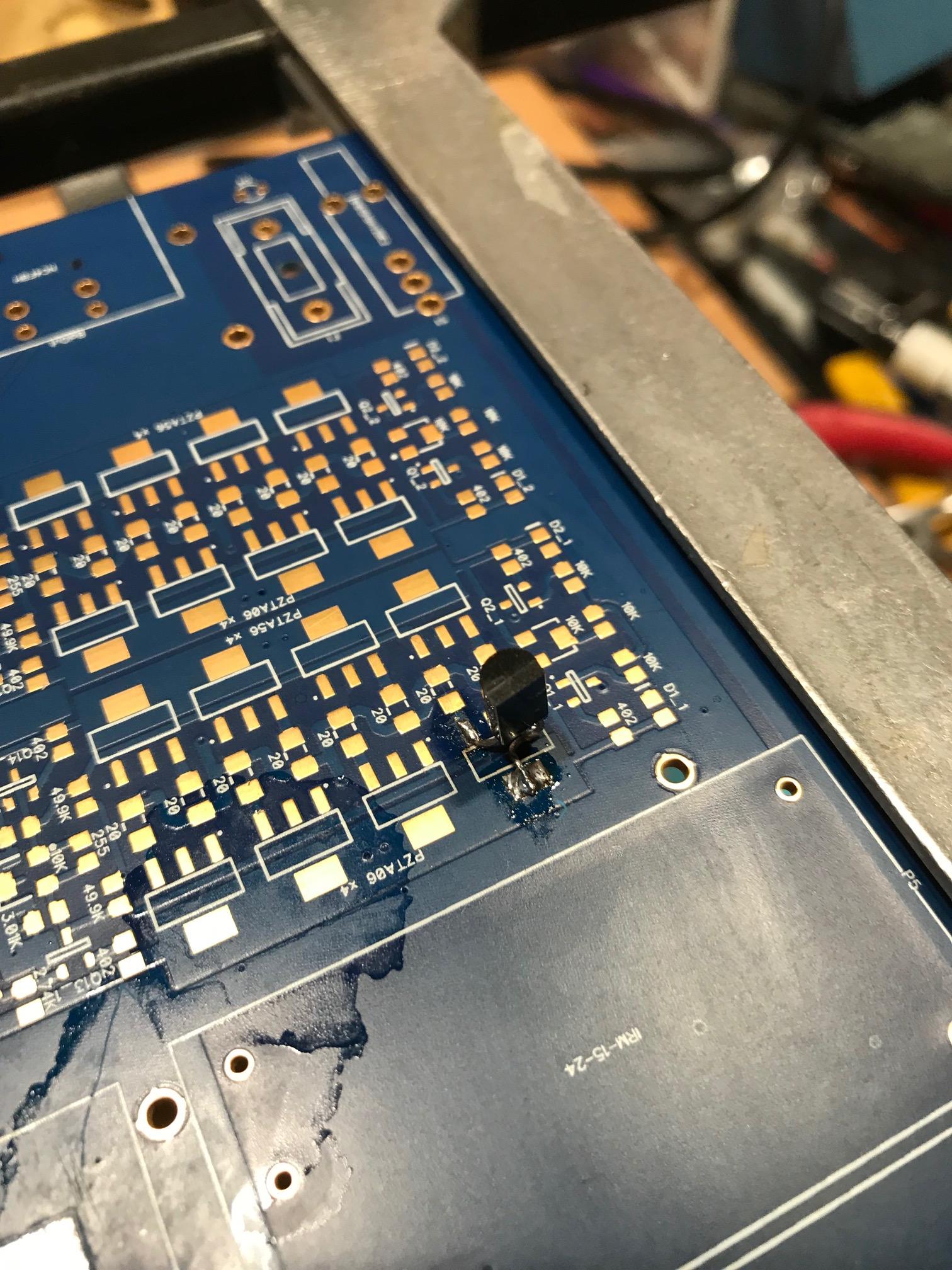

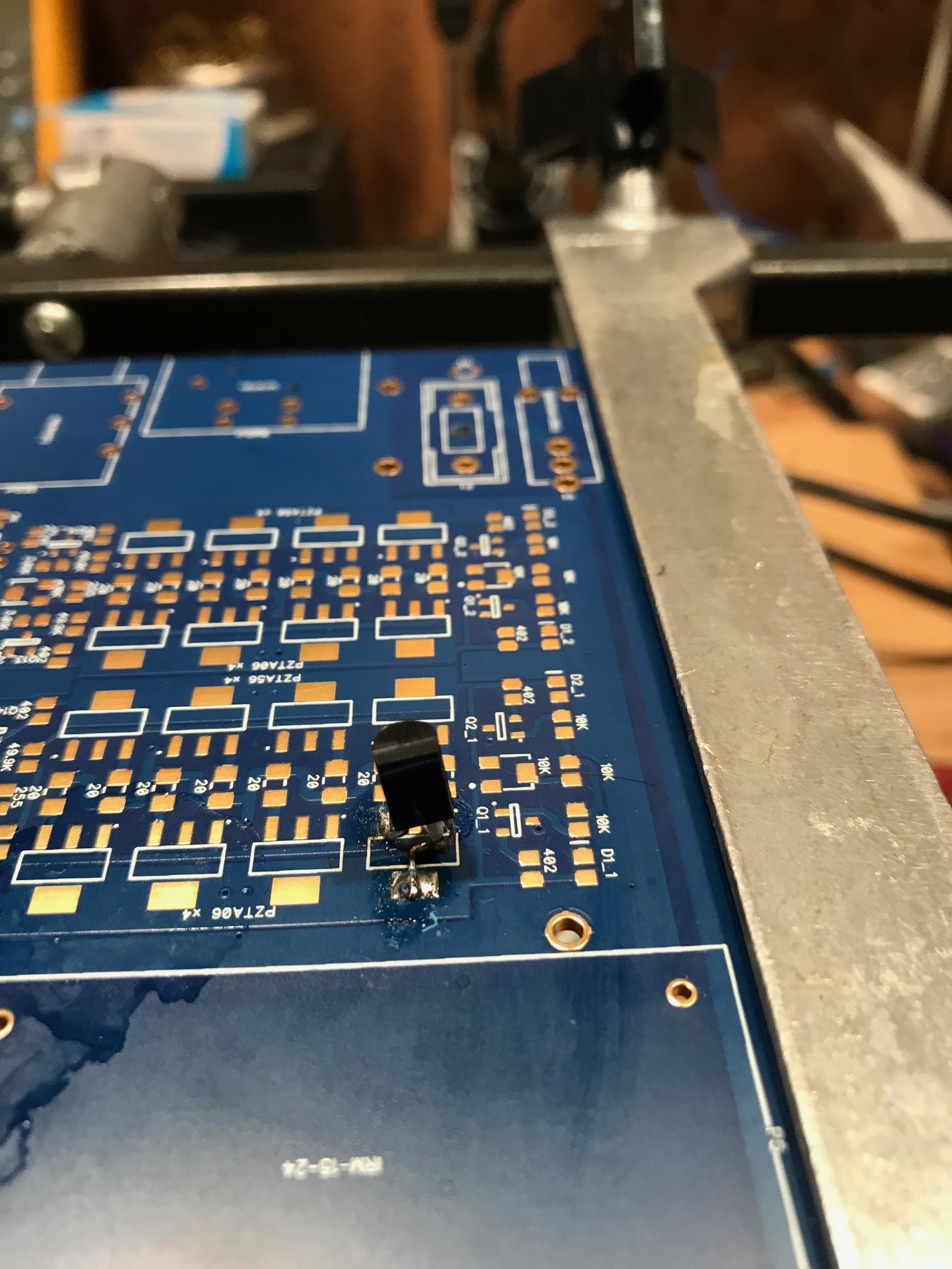

Another mini, and hopefully the last that I build (#5), this time for me. I accordingly did some things a bit differently...
Headers and shunts instead of the 0R resistors...
And as earlier threatened:
MPSW thru-hole output transistors. A bit painful to do, but not so bad once I got going. Temps seem lower; 71°C is the highest I have measured so far. IIRC the PZTAs were often in the 80°C range. After casing it, etc. I'll report back. I have PZTAs so can go back to those if warranted.
