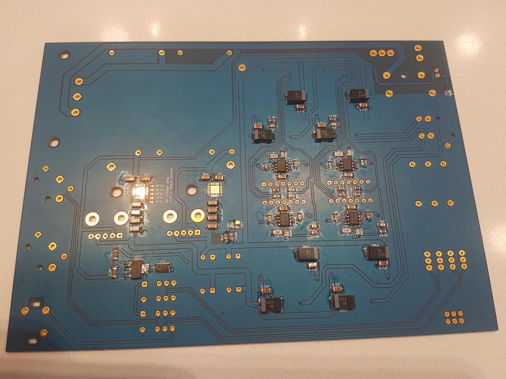

Underside of the dynalo mini done, just need to clean the flux residue when it's all done.
Those 0805 resistors are starting to be  the smaller I can solder without magnifying glasses.
I just noticed looking at the picture that the tantalum capacitors don't have the positive to the same side of the board. I must hsve confused this somehow and will take care of it in the morning.

I think IIRC that stripe (+?) o the tantalum goes towards the back of the board.
Also, I wouldn’t populate the 0 ohm jumpers until you have tested and adjusted the amp.
They should all point to the same side indeed, but I for some reason I can't understand I soldered them this way... ?
Regarding the 0ohm jumpers, I didn't understand I should only install them after testing the amp, I'll remove them tomorrow as well then.
