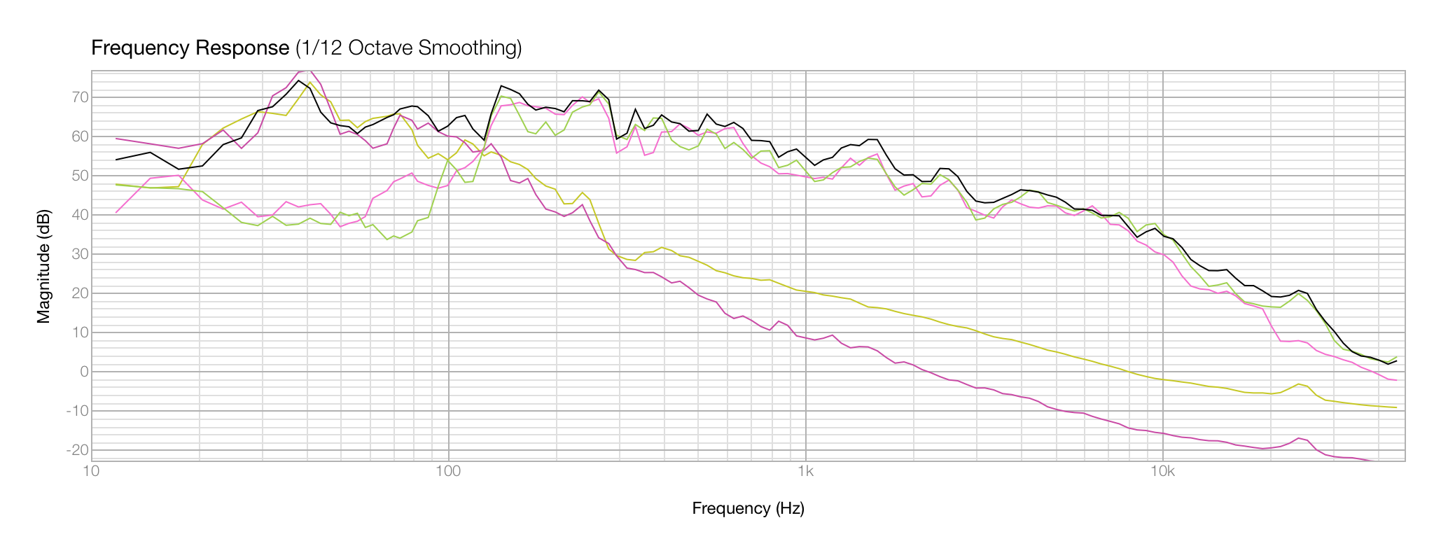

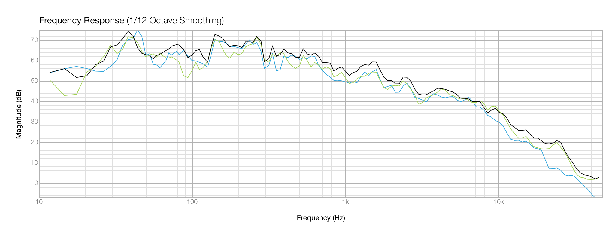

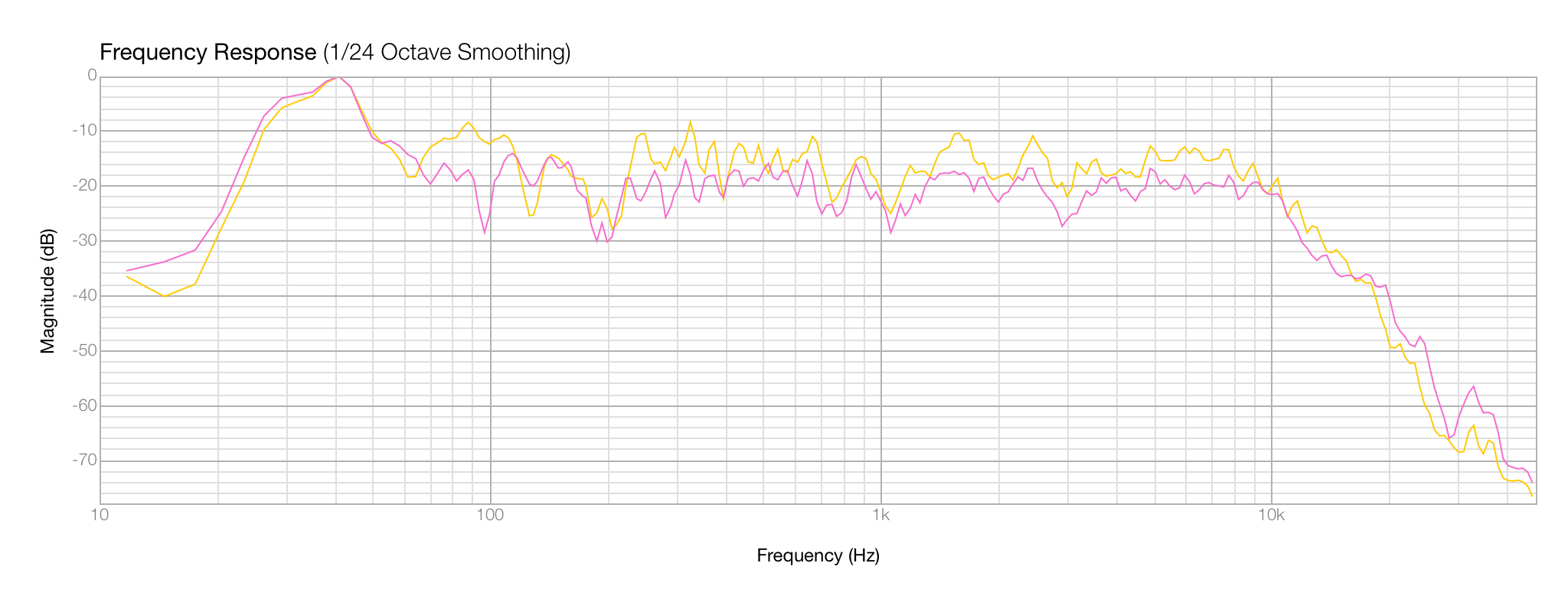

luvdunhill Posted November 12, 2016 Author Report Posted November 12, 2016 Looks like a perfect storm. General channel imbalance as well as something happening around 100 Hz. The orange color is the left channel. Now, that is with the full-rangers and extension subs, two measurements (one per channel). If I split it out into four measurements and then a single measurement with everything on in stereo (the black line), I get: In this case, the left channel colors are "green" and "orange". So, I guess my question is, can I attribute this to the room, or is there something else going on in the chain.... Quote
ironbut Posted November 12, 2016 Report Posted November 12, 2016 I'm guessing the big bump at 40-50hz is an interaction of your subs and room. That's so low that some drums and organ pedals live around there. The problem you're hearing is the big right channel suck and the left channel bump at 80-100 hz. Unfortunately, pretty common problem with your typical american room. I suggest installing some corner bass traps. Not the foam jobies (which are worthless IMHO) but some thick (4-6") 2x4' panels. I have some Real Traps in my studio and they really make a huge difference. Quote
Dusty Chalk Posted November 12, 2016 Report Posted November 12, 2016 I would revisit the subs. The full-range speaker response overlaps at the 100Hz region, but the difference between the two subs' responses are worse than those on the combined graph. I would also recommend playing around with the individual phase of the subs. If you make left sub "fight" the full-range driver in the crossover region, maybe it'll temper it? Wouldn't know if the damage is worth it without trying it, though. Finally, can you make a 2.1 system, and ditch left sub entirely? Quote

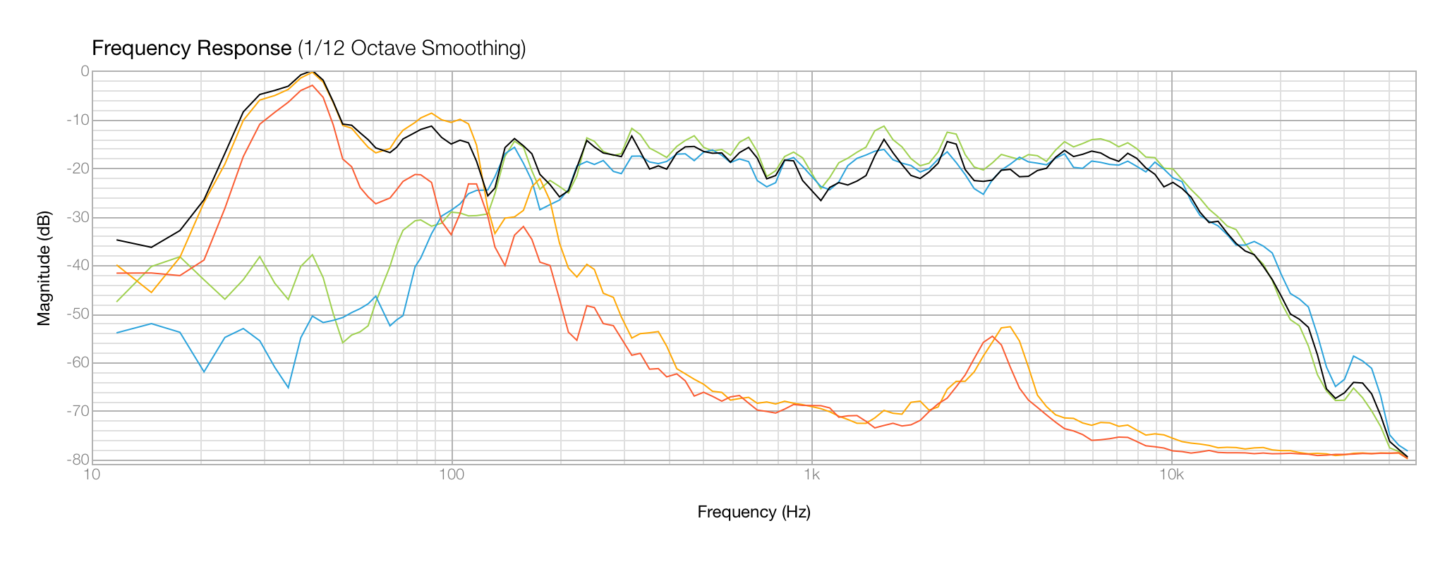

luvdunhill Posted November 13, 2016 Author Report Posted November 13, 2016 I can't really get rid of that 100Hz problem with crossover slopes or frequency. I have somewhat addressed the channel imbalance though? I applied the mic calibration file, which really ends up showing a lot of high frequency attenuation in the final graph. I'm surprised about that. I also setup the automatic correction. Here's green is the right channel: Splitting it out (again greens are right), with Half-Hanning windowing: Â Quote
