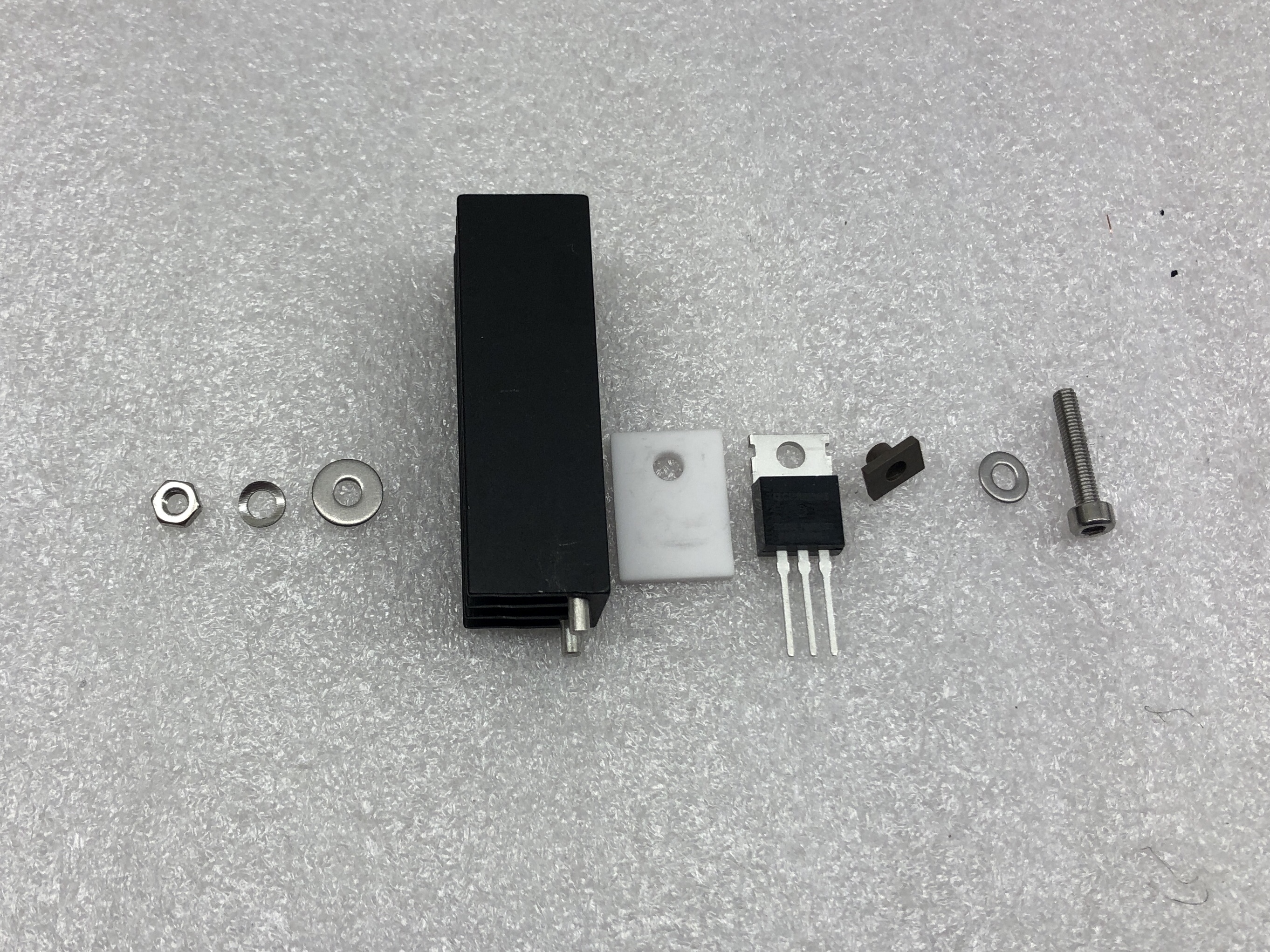

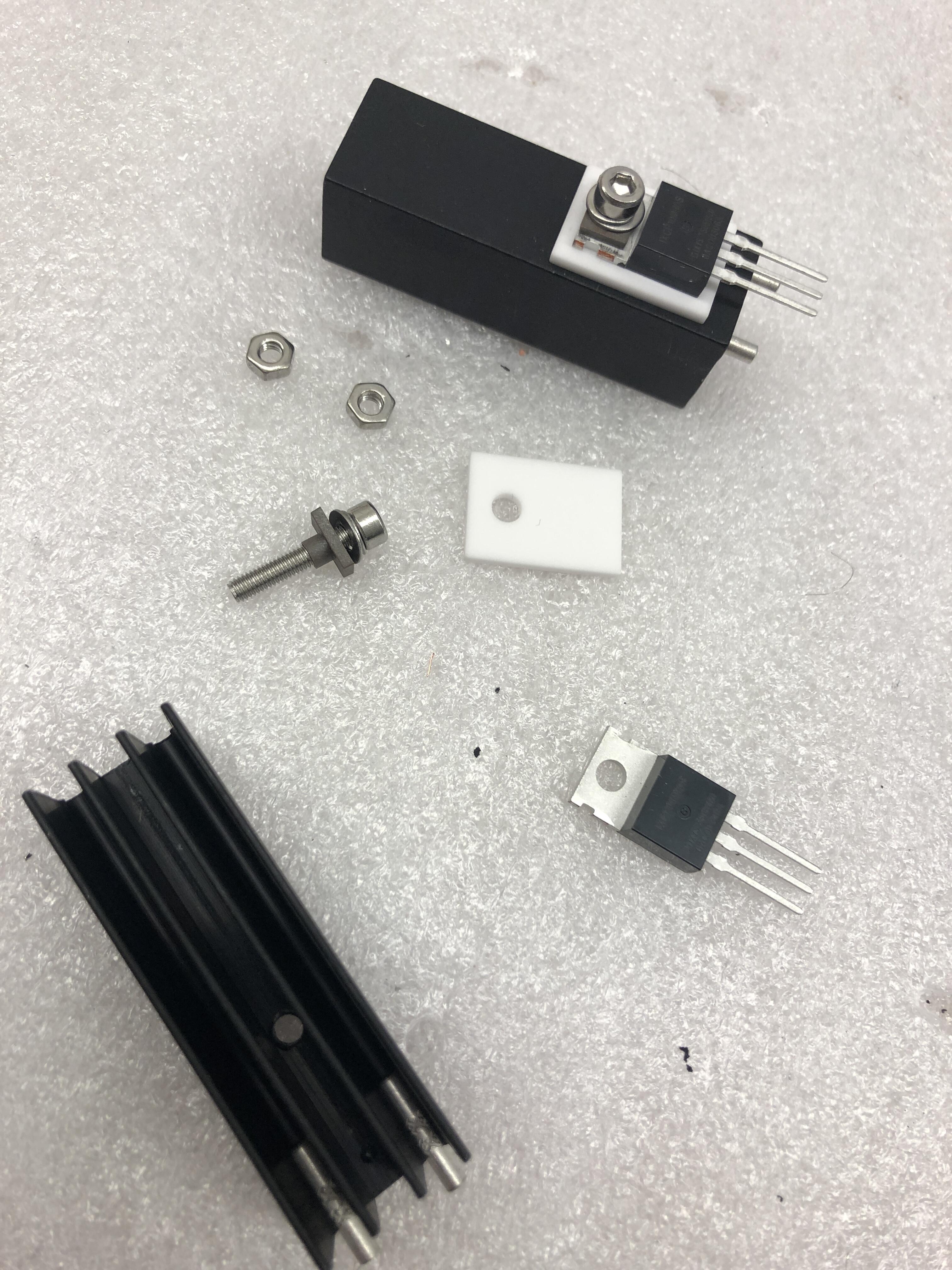

The tread on the Aavid 581202B02500G failed completely on me. Absolutely impossible to tighten the bolt properly and there is also no space for a nut from behind. Or are you guys using different sinks for TO-220?

If you noticed in the datasheet, these are threaded for a 6/32 Imperial screw, which will not fit thru the insulator that you are using. I think most people use a longer screw with a nut/washer on the back (long enough that it is outside of the fins). Or use a 6/32 nylon screw with no insulator, but I don't know if that is verified to be tight enough or not.
Exactly, thread wasn't 4-40 UNC nor M3 and anything else do not fit through the insulator. Will use a longer screw, didn't thought about that, thanks. I was thinking about milling out a small portion of the two inside fins to fit in the nut.
Edited by starcat
They do make another variant of that heatsink (2100G) which is not drilled/tapped, but I don't know if anyone stocks it. You could drill and tap that one for whatever reasonable fastener you wanted to use (4-40 or M3).
I recommend that you remove the metal washers.
Thanks, Jose.
 This looks like the final setup using stainless steel hardware and non conductive EK-TIM Ectotherm thermal compound on both sides of the Aavid isolator.

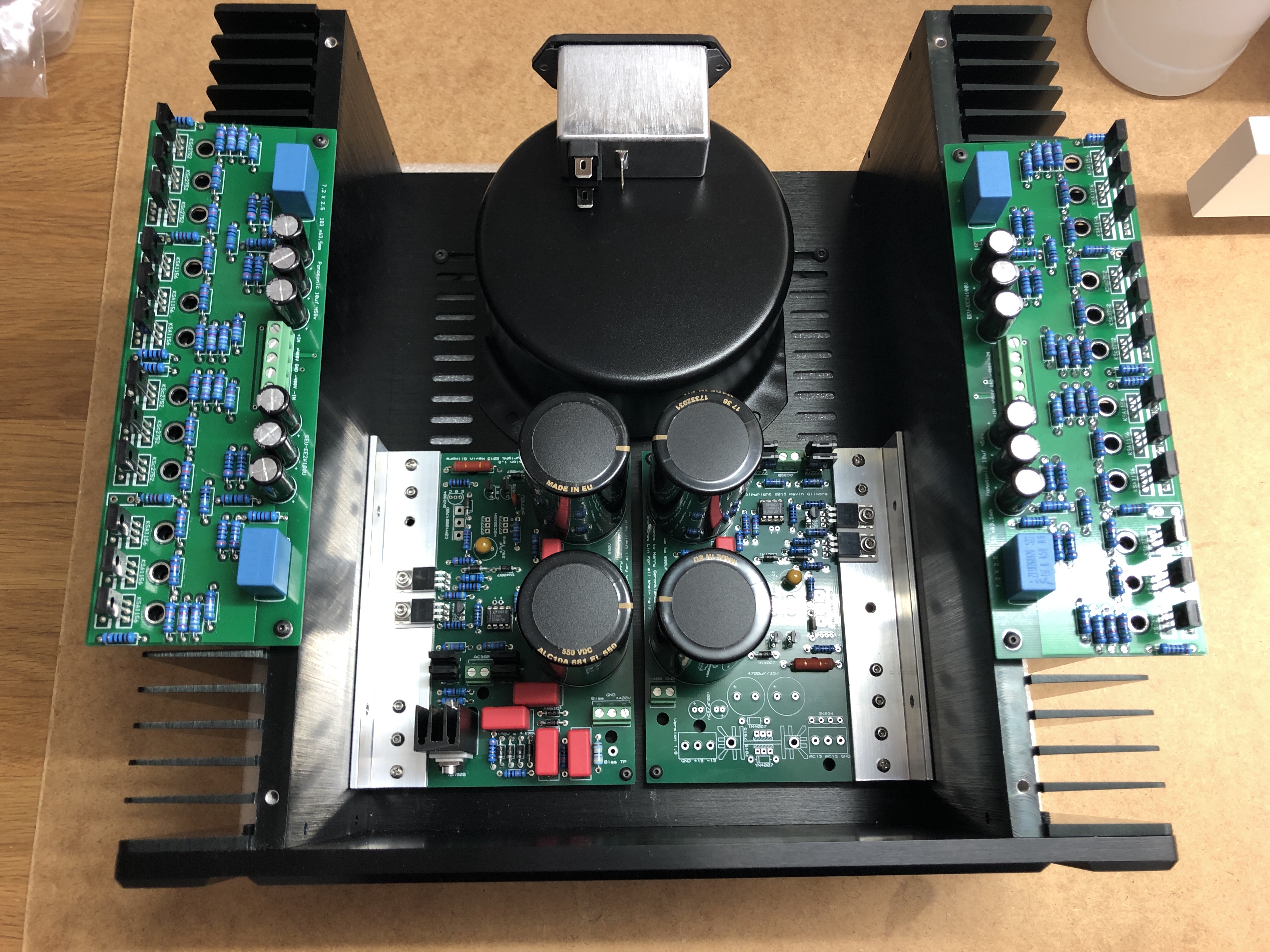

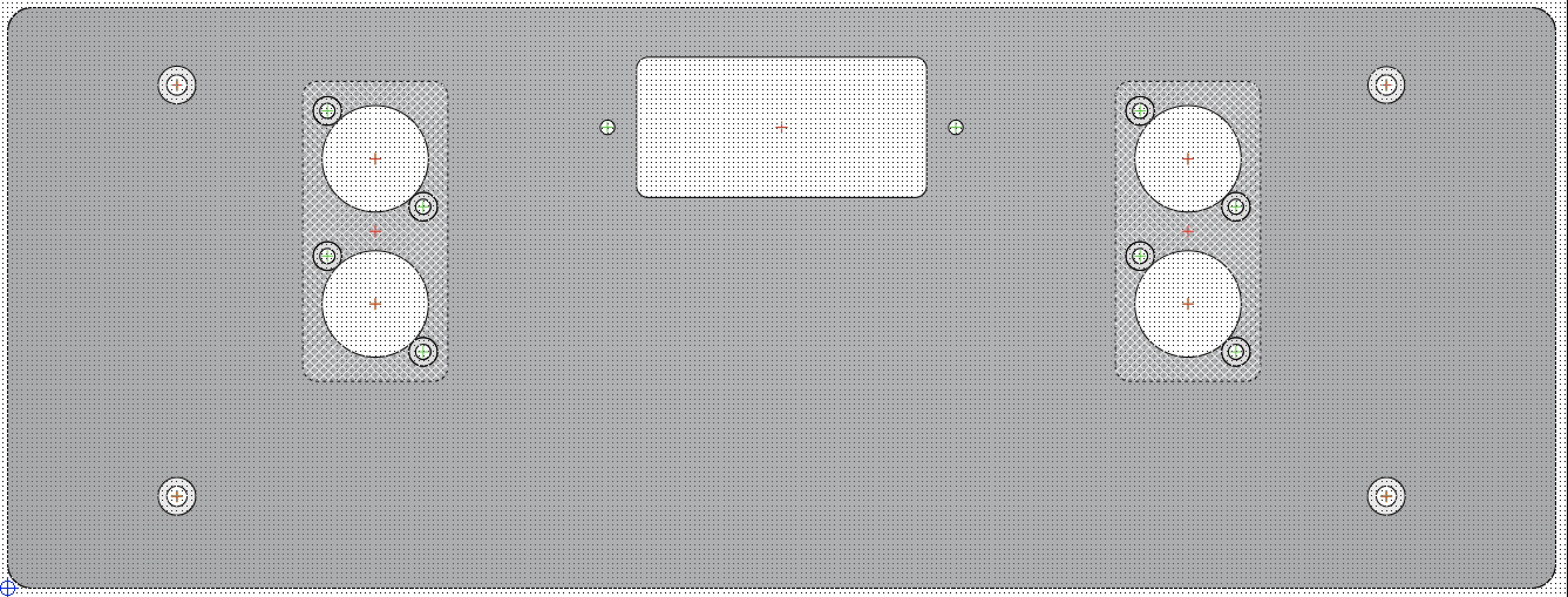

Laying down the modules for my CFAE. I decided to go with the GRHV instead of the BH Mini. Custom making the front and back panels. Back panel will have on the left/right symmetrically laid out and flush mounted the XLR ins/loop-outs and in the middle the IEC inlet. Fabricating the PCB boards for the XLR in/outs atm. Looking to use the CP4-2500 pot on a board as well together with two Stax teflon jacks on the front, symmetrically positioned left/right from the pot. Will use the 2.54mm Amphenol PV wire to board connectors between the XLR and volume pot PCBs as connectors are gold plated and directional, crimping a shielded Sommer Cable Cicada SO-D14, similar to the Canare L-2B2AT. Using 600V 300°C teflon wire for the HV. And... waiting for remaining components and transistors for the GRHV.
