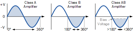

  • Class A: – The amplifiers single output transistor conducts for the full 360o of the cycle of the input waveform.
  • Class B: – The amplifiers two output transistors only conduct for one-half, that is, 180o of the input waveform.
  • Class AB: – The amplifiers two output transistors conduct somewhere between 180o and 360o of the input waveform. Clarification: AB which use a minimum of two transistors conduct 0o to 180o for the positive cycle and 180o to 360o for the negative cycle.

For Class A amplifier operation the switching transistors Q-point is located near to the center of the output characteristic load line of the transistor and within the linear region. This allows the transistor to conduct for the complete 360o so the output signal varies over the full cycle of the input signal. The main advantage of Class A is that the output signal will always be an exact reproduction of the input signal reducing distortion. However it suffers from poor efficiency, because to bias the transistor in the center of the load line there must always be a suitable DC quiescent current flowing through the switching transistor even if there is no input signal to amplify.
For Class B amplifier operation, two complimentary switching transistors are used with the Q-point (that is its biasing point) of each transistor located at its cut-off point.
This allows for one transistor to amplify the signal over one half of the input waveform, while the other transistor amplifies the other half. These two amplified halves are then combined together at the load to produce one full waveform cycle. This NPN-PNP complimentary pair is also known as a push-pull configuration.
Because of the cut-off biasing, the quiescent current is zero when there is no input signal, therefore no power is dissipated or wasted when the transistors are in the quiescent condition, increasing the overall efficiency of a Class B amplifier with respect to Class A. However, as the Class B amplifier is biased so that the output current flows through each transistor for only half of the input cycle, the output waveform is therefore not an exact replica of the input waveform since the output signal is distorted. This distortion occurs at every zero-crossing of the input signal producing what is generally called cross-over distortion as the two transistors switch “ON” between themselves.
This distortion problem can be easily overcome by locating the biasing point of the transistor slightly above cut-off. By biasing the transistor slightly above its cut-off point but much below the centre Q-point of the class A amplifier, we can create a Class AB amplifier circuit. Then the basic purpose of a Class AB amplifier is to preserve the basic Class B configuration while at the same time improving its linearity by biasing each switching transistor slightly above threshold.
