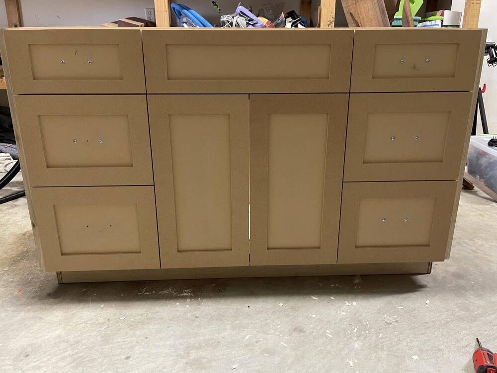

Pretty damned sweet. Your shut lines are perfection. Not an easy accomplishment.
Is it going in your house?
Going in one of the two smaller houses we bought recently.  I have another vanity all cut, just need to put it together. I think getting the faces on take up about half of the construction time.
Getting it all lined up is definitely a chore, I have a fully kitchen to do next, think I’m going to go with a larger reveal so being perfect isn’t so critical.
Dominos or pocket screws?

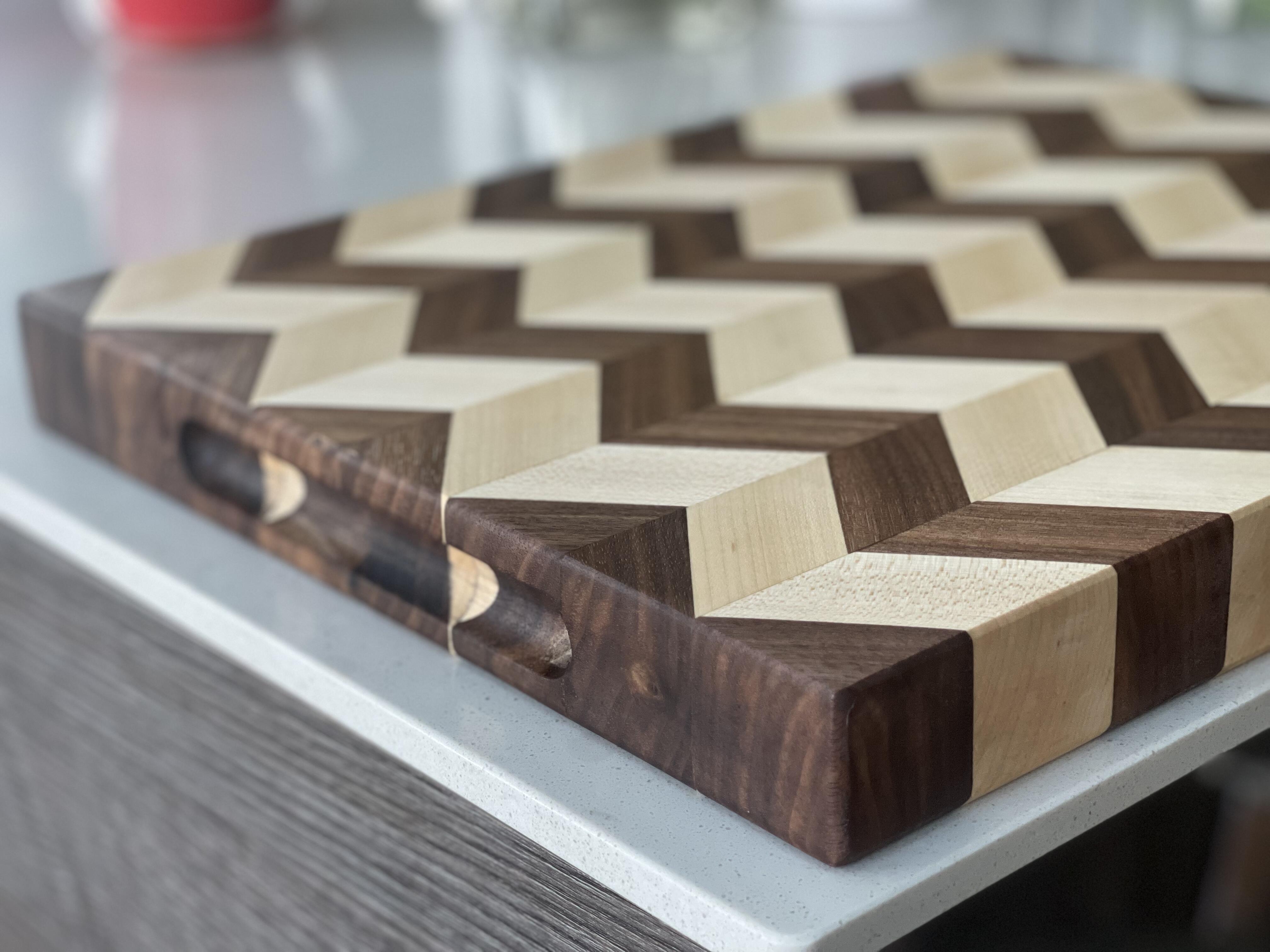

I decided to test the drum sander I finally got set up in the garage and all the new sanders by building an edge grain cutting board for the kitchen today.
Only 30 more hours of sanding and some finishing left

Pocket screws for the face frame. Dominos don’t really make sense and would be more work. The rest was dados, glue, and brad nails.
Board is looking great!
Very nice. My work is way too sloppy to get clean lines so I have to cheat with adjustable Blum hinges.
The magic ping pong table does the dados?  I need a mini one of those, but I think I need a jointer more at this point.

The cutting board looks great. I'm probably telling you something you already know, but a cross-cut blade with way more teeth will give you smoother cuts with the sled. I don't always switch but it is an improvement.
Yep. Too lazy to switch but I do have the Forrest cross cut on there now to finish the edges a bit.  So much tear out that I am hoping to clear out with a quick trim.
Maybe I need another Sawstop so I can keep one loaded for cross cut and one for ripping.
I also use the Blum hinges, impossible To get it perfect without some tweaks. Really wish the Blum slides were in stock, the cheap knockoffs make it much harder to do.
The ping pong cuts everything minus the face frame rails and stiles. Kind of wish I had an edge bander now 😂

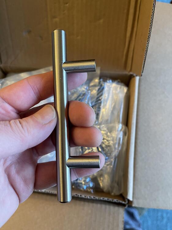

Picked up these Amazon Basics Euro handles for the cabinets. The quality is surprisingly good. Solid stainless with quality look and feel. Best part was they were $1.15. Which is probably bad since I’m just supporting the Bezos and China.
  • Author
I've used much of the Amazon Basics hardware lately, including doorknobs and deadbolts. I've been really happy with the quality. They are a bargain price, but even more important, they just work well. On the other hand, I've had nothing but problems with the uber expensive Emtek shit that the posers love to buy and namedrop. Baldwin is my fave, but these Amazon Basics are damned good for the $.

Good to know the rest is the line is also good.

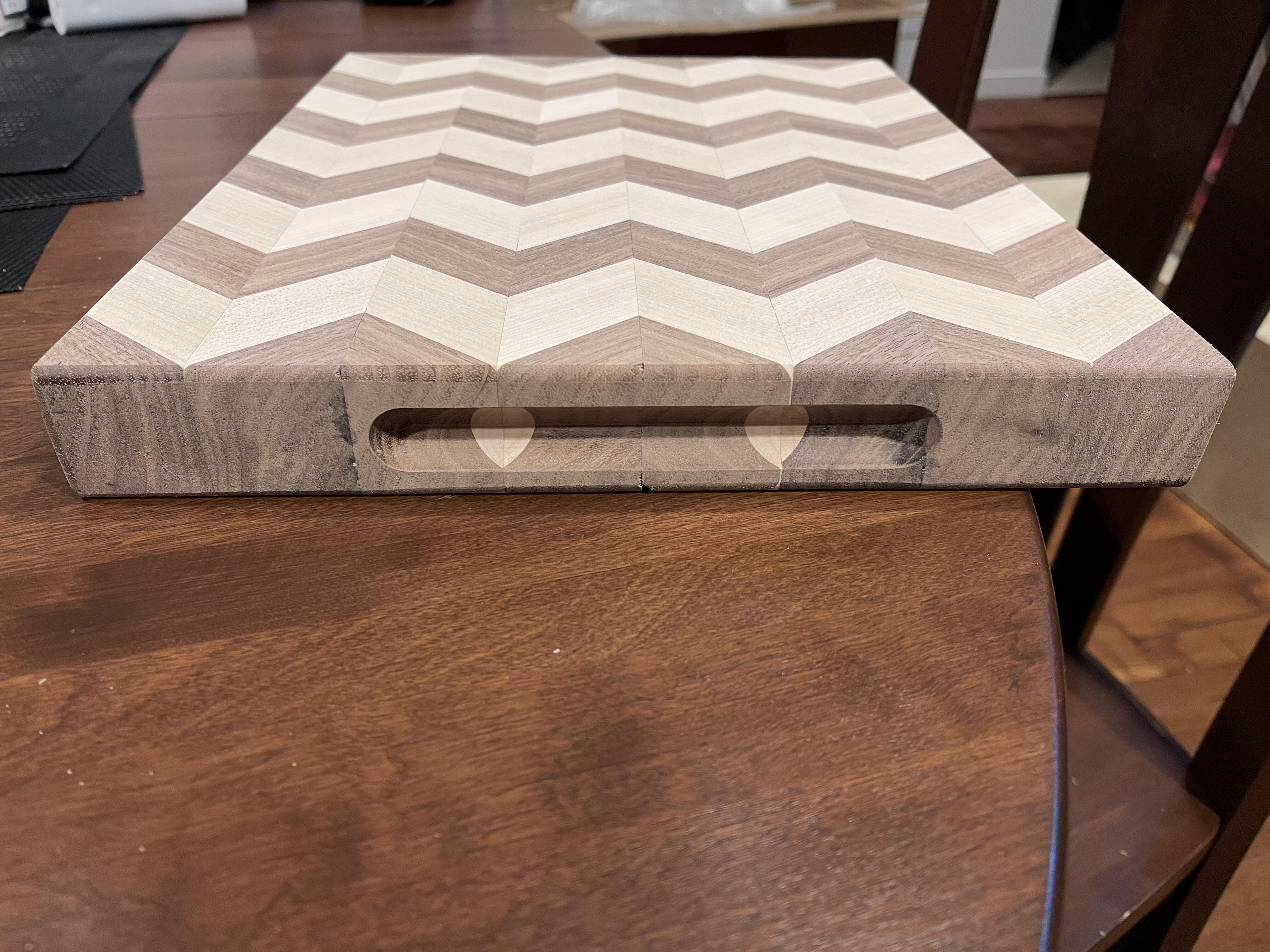

Put some Odie’s Oil on the 3D board so it is about as finished as it is going to get.

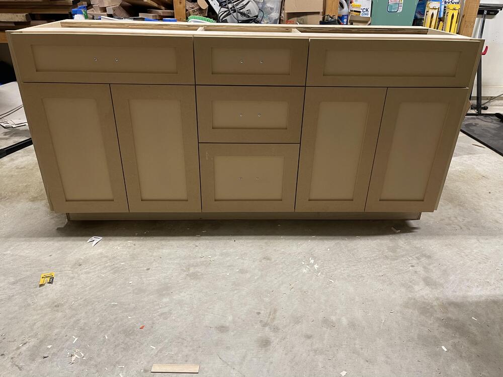

Second vanity complete. Definitely going with a larger reveal for the kitchen I’m going to do next.

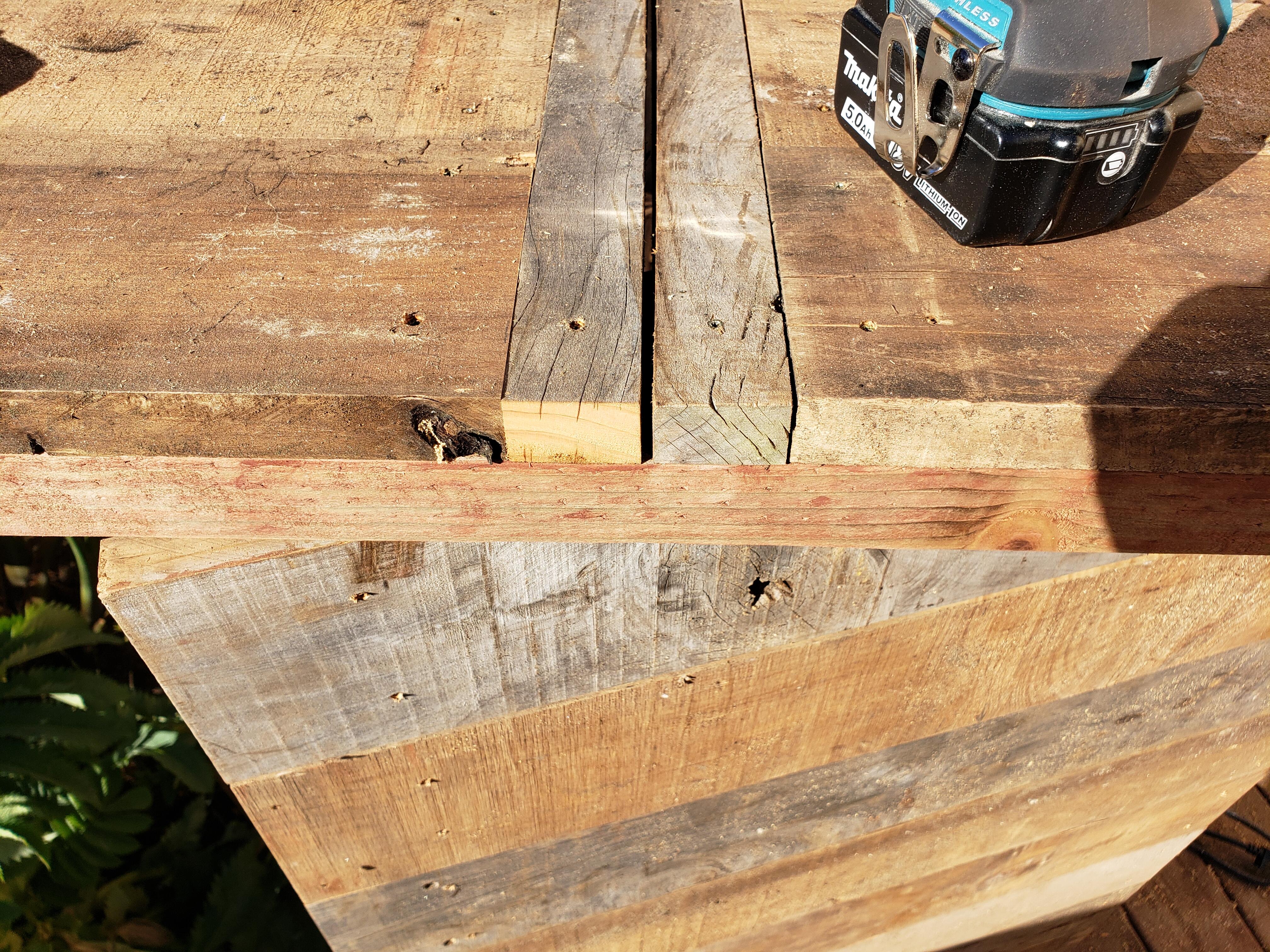

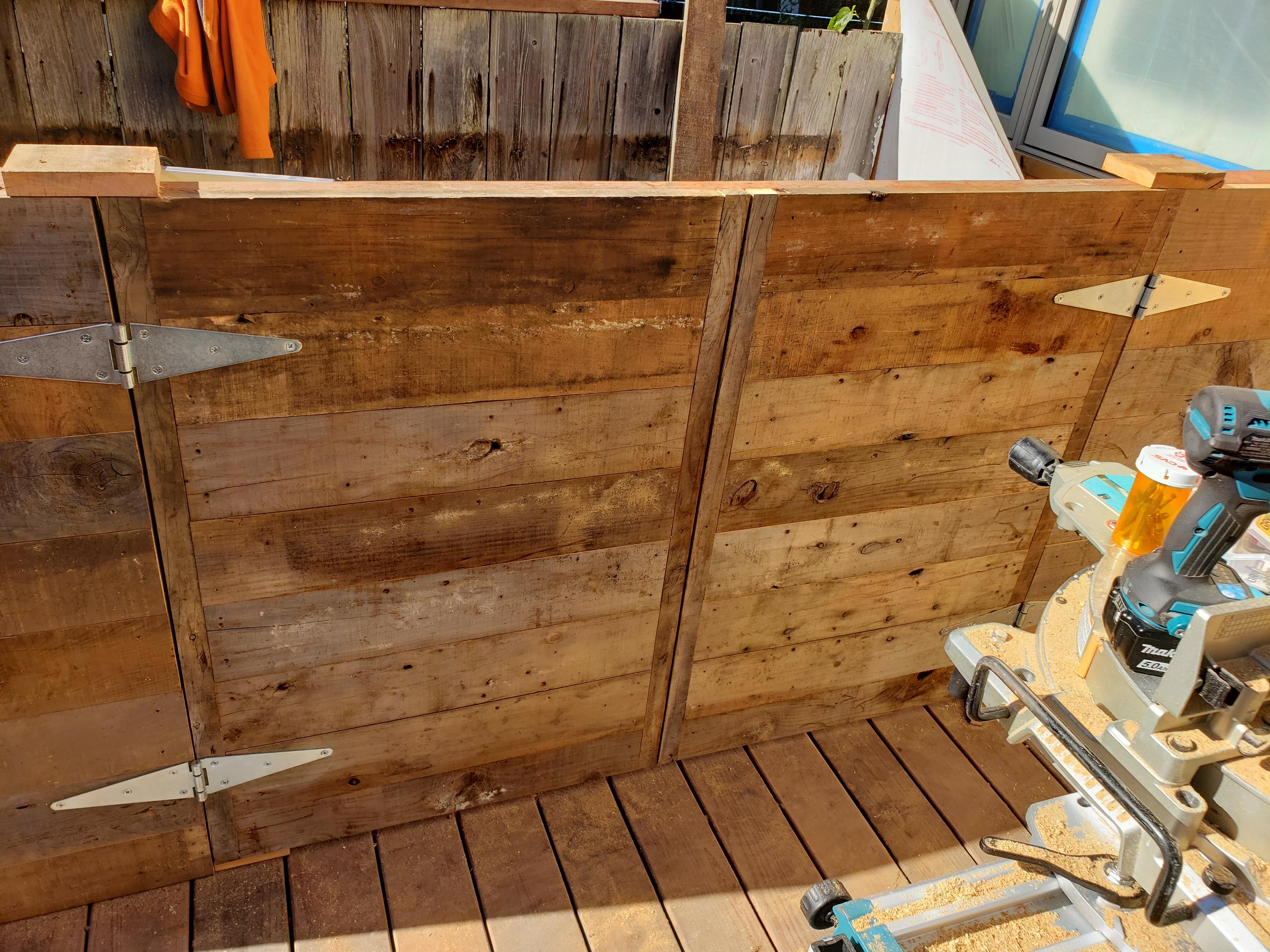

Thought I'd share a little tip since I'm building and installing double gates on a trash can container.
So I'm building a large bin to hold trash and recycling containers, as well as loose cardboard. This is for a bookstore we're building for a repeat client.
I always get annoyed when two gates don't line up perfectly. And installing two gates and getting them to line up can be a pita, especially if your working alone. So some years back I developed a better way to do this.

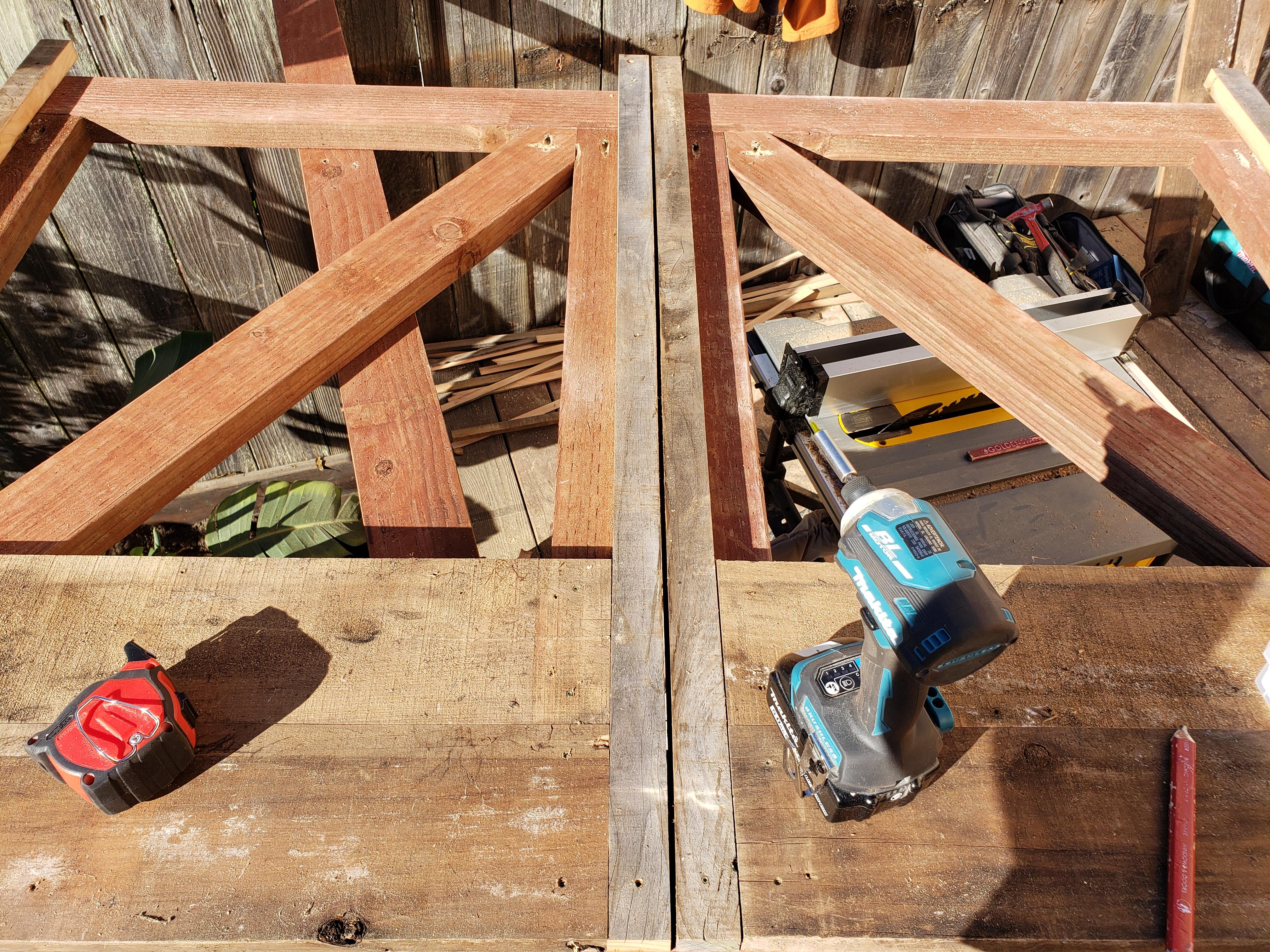

First I build the bin, then take the measurements for the opening where the two gates will live. Then I build the two gates as one unit. I make the top frame and bottom frame full length. I put in my rail supports, and leave a strong 1/8" between the middle rails.
I've already started cladding the gate frame with reclaimed lumber, but you can see the small gap in between I'm referring to.

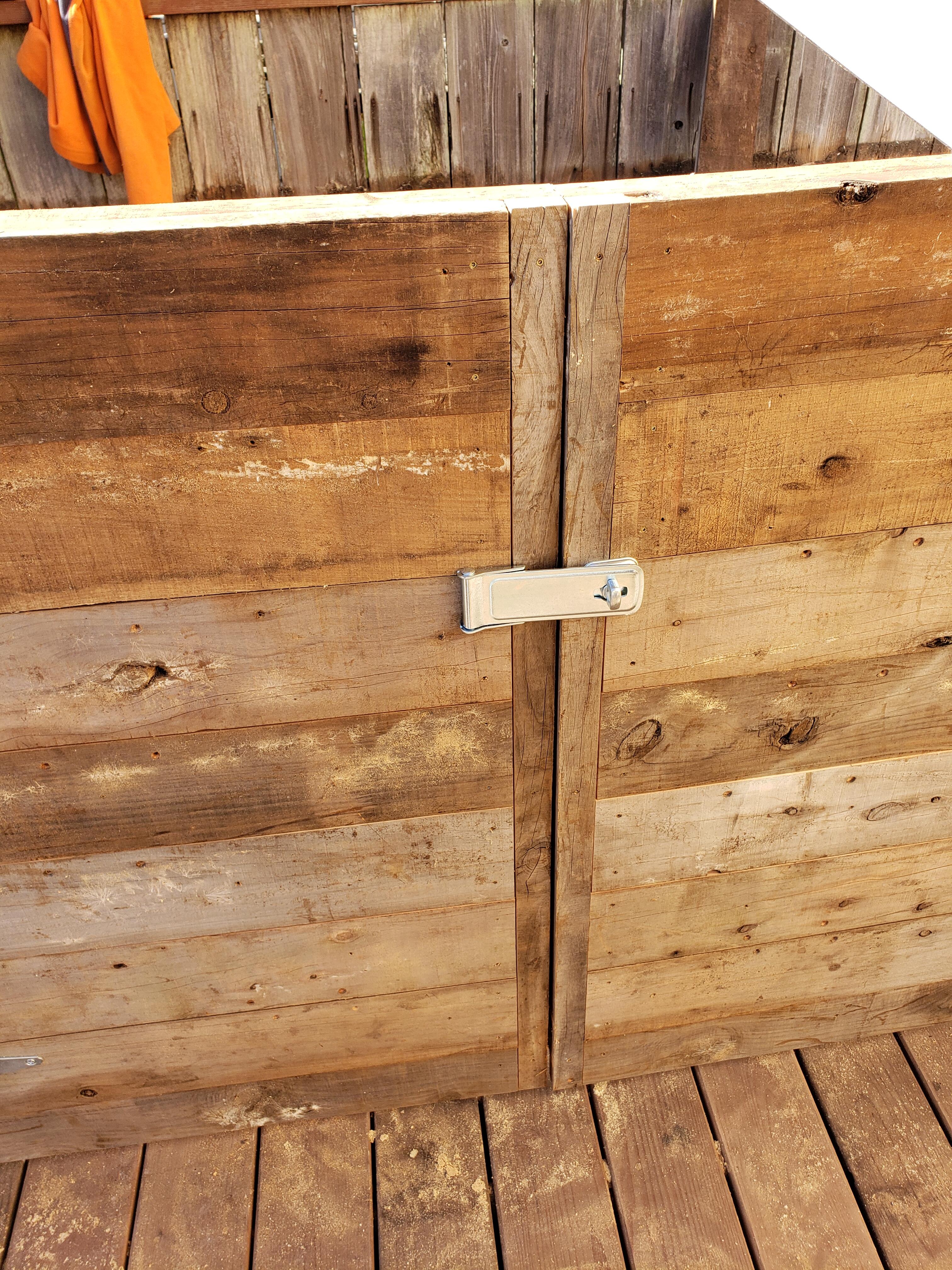

After cladding the gates, I then set the gate assembly in place using shims at the bottom to ensure each side is level with the top of the bin walls.
  • Author
Then I align the front, apply the hinges, and use a sawzall to cut the top and bottom 2x4s right in that tiny 1/8" gap. That way everything stays aligned perfectly once you cut the two sections apart.
It took me a few years to figure this out, so I thought I'd pass it along.
As soon as I learn how to use a saw I will be all over that.
How are you attaching the the two sides of the gate where the 1/8" gate is?

I attach the gate as a unit, with two hinges on each side. Then I  cut the top 2x4 and bottom 2x4 of the gate frame, right in the middle, where I have left the 1/8" space.
