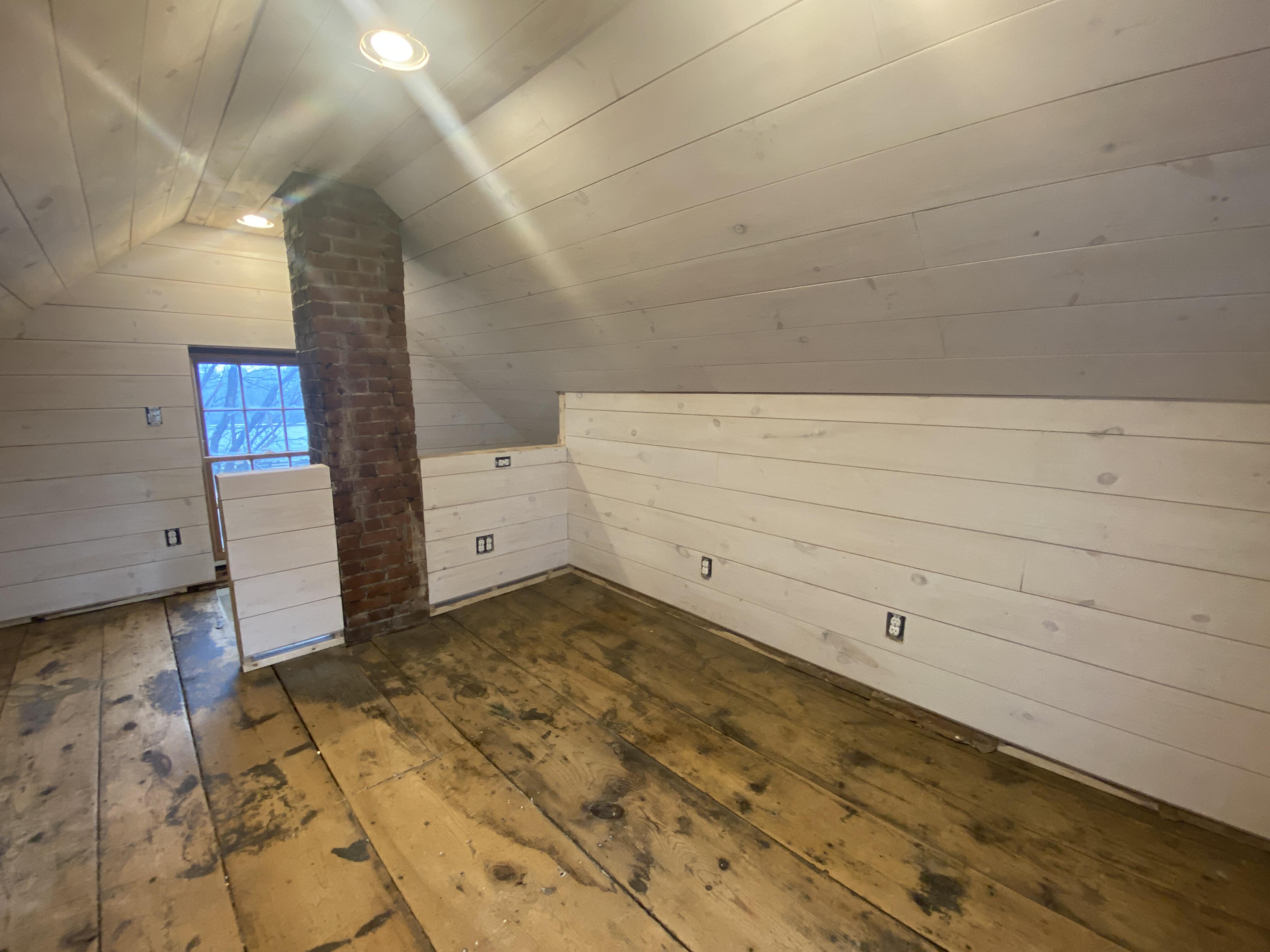

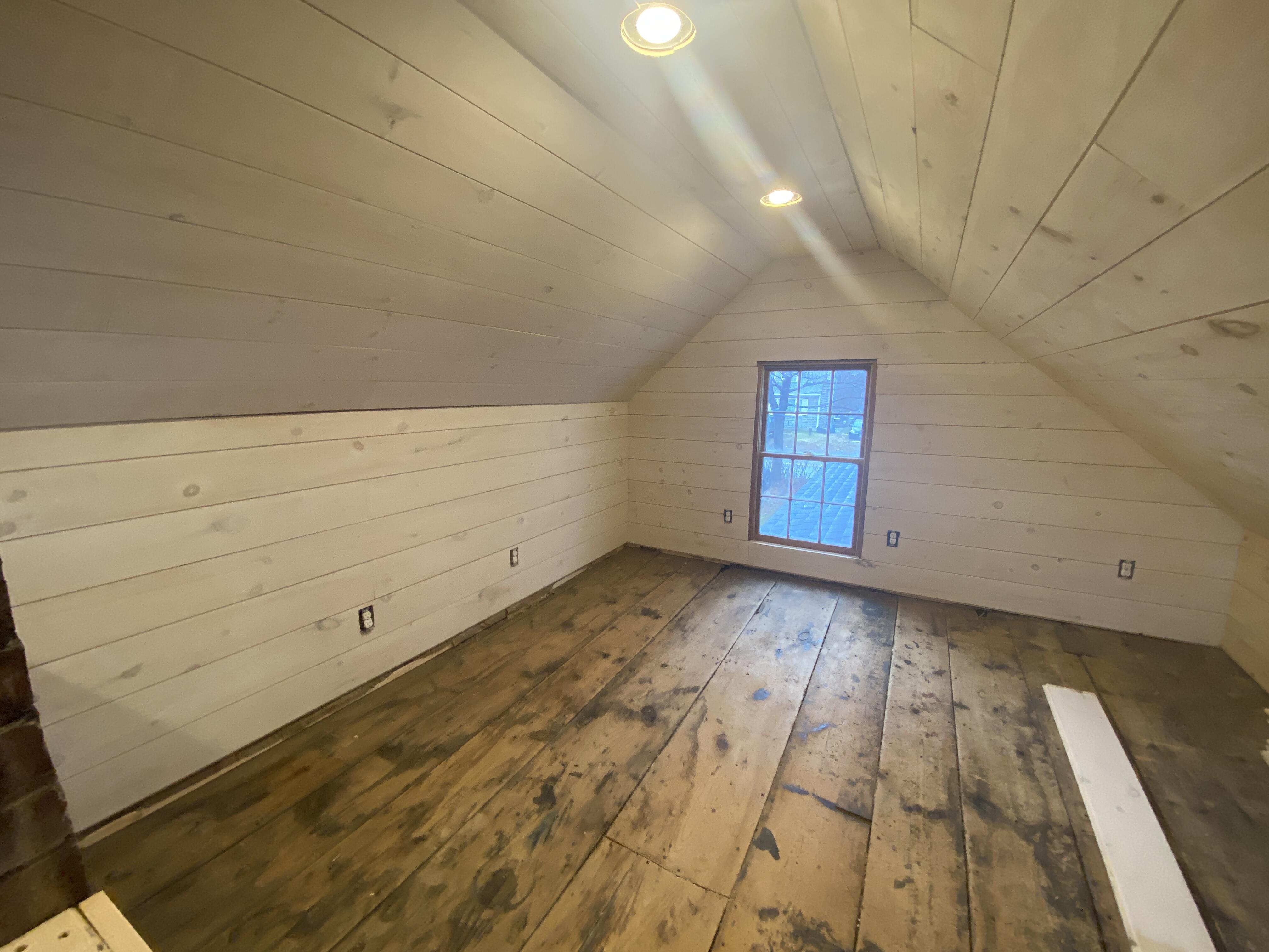

I'm receiving a lot of conflicting recommendations on what to do with my walls when I search the intrawebs, and figured I'd ask here.
So, I whitewashed the pine paneling in my new office.  I used a 1:1 of water and flat latex paint, applied with a brush and wiped down after 10-12 minutes.  I'm really happy with the finish.
Now, some folks say you have to seal whitewashed paneling because the watered down paint doesn't provide the same protection, while others only recommend it for whitewashed shelving and furniture that will see more wear and tear.
Any experience/recommendations/thoughts/opinions?  I'm only going to spot-sand the floor and just seal in the worn patina.  The desk is going to be walnut butcherblock.  Trim is going to be painted white.  I'm OK with the extra effort if it's needed, but it's a lot of work to seal the walls/ceiling if it's not necessary.
I'm no paint expert, but I don't see any point to sealing those walls or the ceiling. Unless you are going to practice wall walking I don't think it will get a lot of wear and tear, and whitewash is supposed to be a little rustic too. Touching up as necessary down the road also seems easier than sealing all the surfaces. It would take some coats to seal that thirsty pine.
  • Author
If it were a kitchen or bathroom, where one might need to whipe down the walls now and then, I'd agree with a clear sealer. In your case it would be an unnecessary expense and labor. The watered down paint will hold up just fine. I speak from experience.
Great job BTW!
And I agree that it would be a sin to remove that beautiful patina from the floor.
  • Author
BTW, I developed a great technique for whitewashed pine paneling, when I had to do an entire house. I bought 20 gallons of water based polyurethane (big house), then had the paint store tint it White and thoroughly mix it. A couple of samples and we got the amount of White tint just right. Then I used a Graco airless sprayer to apply. No whiping down needed, and no streaks. Sealed the walls great too.
I would not put any modern finish over those floors. In your effort to preserve them, all you would be doing is putting off ruining them a few years.
Also, I'll disagree with Steve's technique. For rustic looking white washing, do it how it would have been done when a rustic white wash would have been applied.
https://milkpaint.com/

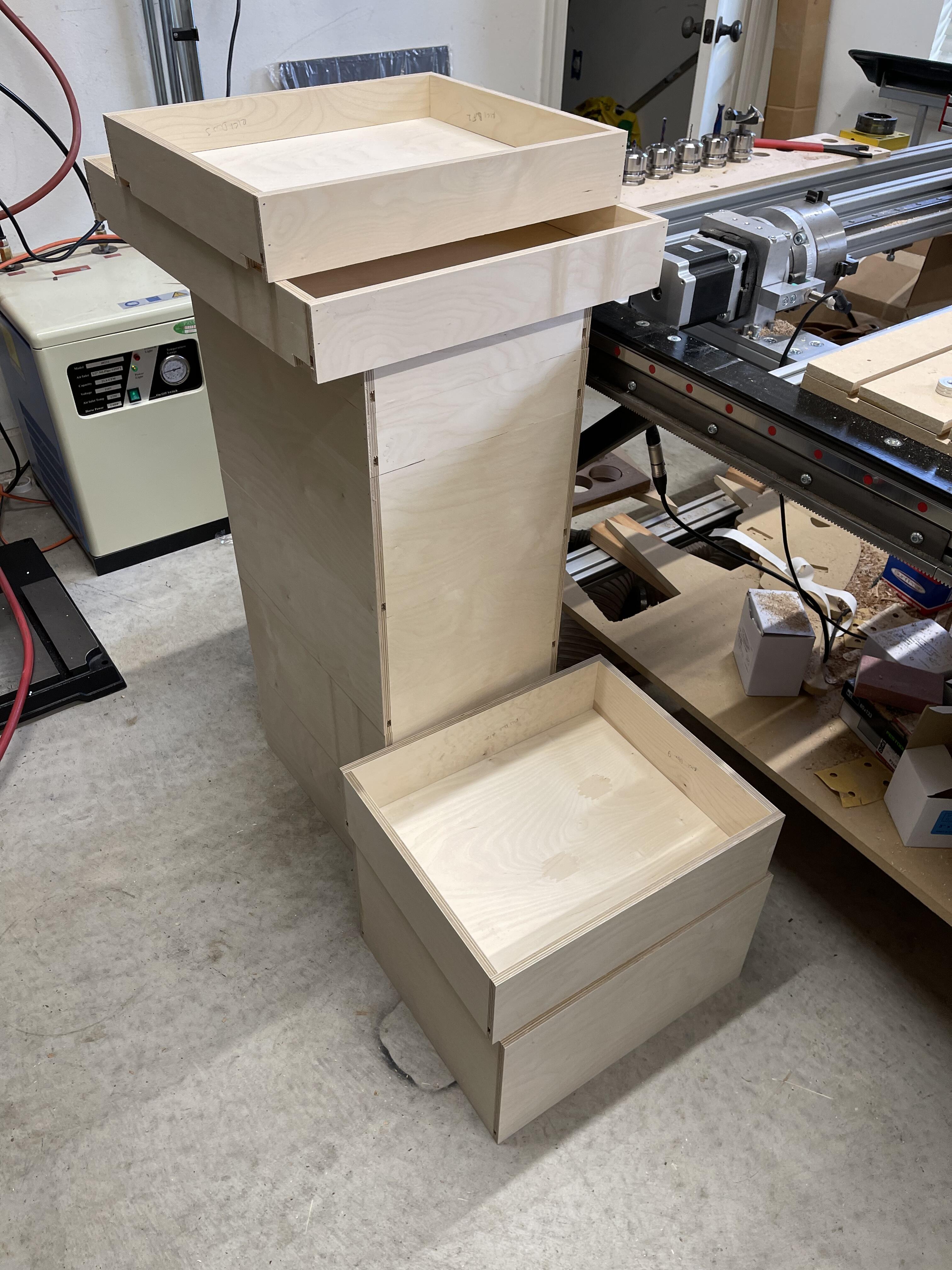

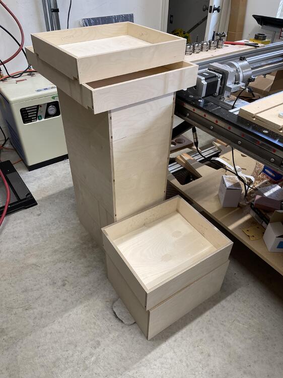

Slowly getting going on the cabinets, have the drawer boxes built. Not having to figure out any dimensions for them was really nice. Design the cabinet and have the machine cut the parts to size. Whatever that size may be.

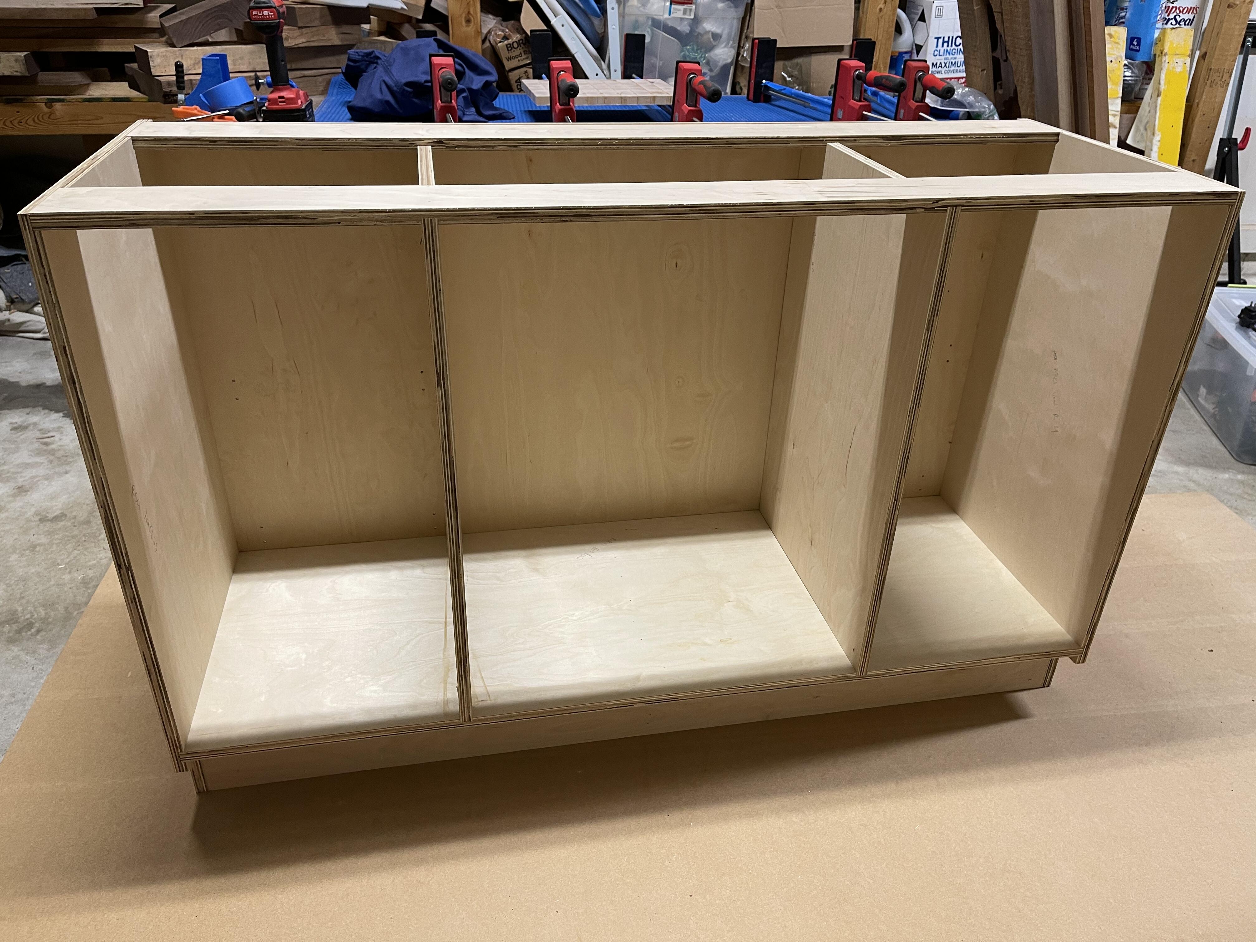

Ping ponged the carcasses, and put together the first one. Started to make the HDF doors and found that the latest  version of my cabinet software causes problems with cutting the doors properly. Nothing like having a $1800 year piece of software that ruins sheets of wood.
