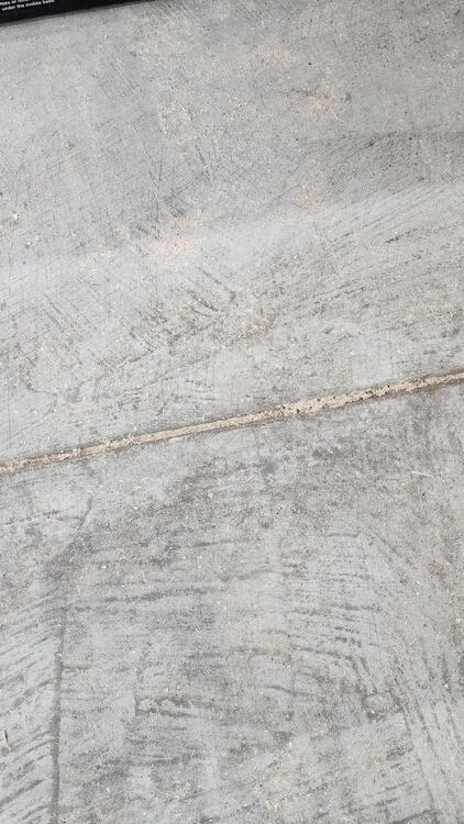

swt61 Posted September 13 Author Report Posted September 13 (edited) But in all fairness this could have been much worse. A totally freak accident. I was running stock through the saw when all of a sudden the toe of my shoe got caught up in the expansion joint of the concrete floor and caused me to trip forward, pushing my thumb straight into the blade. I probably couldn't cause that to happen again if I tried. But $100 or whatever a cartridge costs is totally worth it. I've been here before. No Dr. visit today, just a Band-Aid. It's a little deeper than it looks, and it bled a lot before cleaning it up, but I'm very happy to have a thumb. Edited September 13 by swt61 3 1

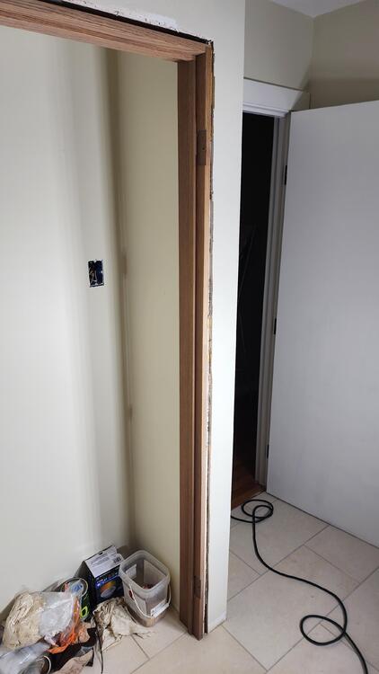

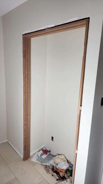

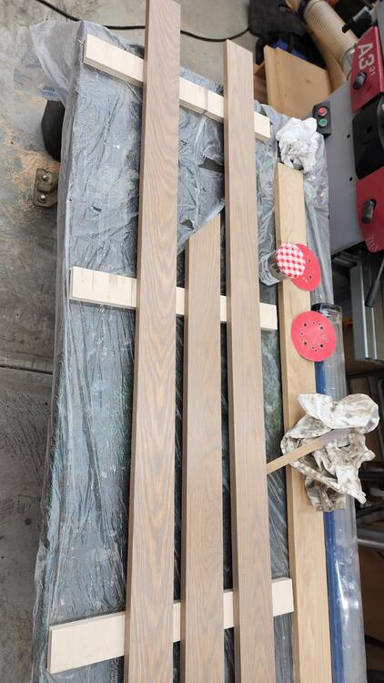

swt61 Posted September 13 Author Report Posted September 13 Door trim for the bathroom closet doors Al and I built for his Sister in Law's bathroom remodel. I made and installed the jambs last weekend because the ladies were in a hurry. I hid my screws behind the doorstop, then glued the door stops in last thing. Got everything plumb, level ans shimmed perfectly. I like to shim directly behind the hinges as well as wherever needed. Then they told me the contractor removed my jambs to install inner closet White Oak panels and shelves. I had argued that before, but they said to install jambs first. I should have held my ground, knowing the timing of these things. I'm headed that way to inspect. Hoping like he'll that the got everything plumb, level and correct. And seriously hoping they didn't leave nail holes showing in my jambs! I worked hard to avoid that. I'll also need to cut down the doors Al and I worked hard on and measured just right, because the contractor didn't listen to me and built the RO out. So, measure jambs, repair jambs if needed, measure for hinge placement, cut down finished doors, rout hinge recesses in doors, refinish door sides and mount doors. I'm not mounting doors this weekend, and not until every final thing is finished on this remodel. If the doors got nicked by a worker, I'd probably do a stint in prison! I hate redoing things I took time to get exactly right! A week or two without closet doors won't kill anyone. Nobody knows more about closets than I do! 🙂 The newly finished trim will darken to the same smokey Brown overnight.

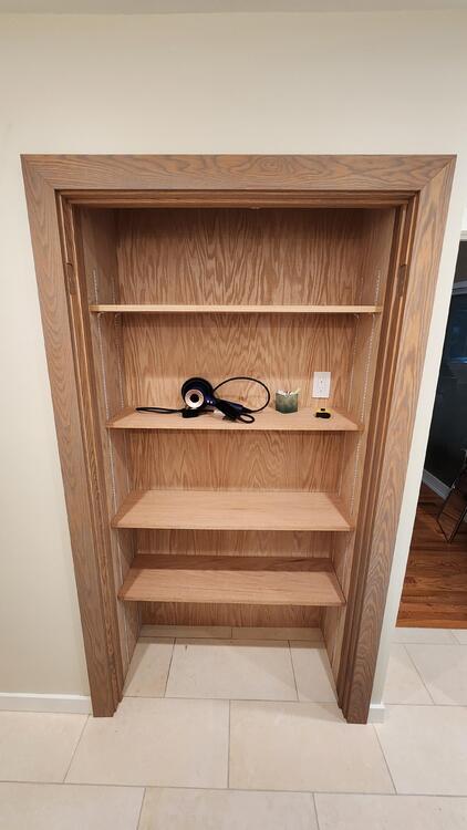

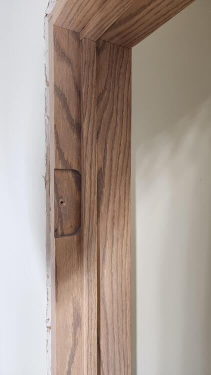

swt61 Posted September 13 Author Report Posted September 13 Good news. The Contractor removed and reinstalled my jambs pretty well. He managed to remove the door stops without marring them. Then again hid the fasteners behind them. The only issues are small ones. The top jamb has a small dip in the center and the right jamb also has a small dip in the center. I can easily pry those jambs out a bit and shim those dips out. The other small mistake is the left jamb. It's attached a bit proud of the sheet rock. Maybe a strong 1/16". Again, I can easily shim the left jamb from the wall, and use caulk to fill the small void. Overall I'm pleased with what could have been a shitty job, out of plumb and full of nail holes. Kudos to the Contractor. He'll live to remodel again. The floor at the opening is 1/4" out of level in that 40". That's kind of a lot, but entirely not their fault, and not that noticeable. I'll cut the doors angled 1/4" to follow the floor, which you'll never really notice and will give me a consistent 1/4" gap at the bottom of the doors. 1

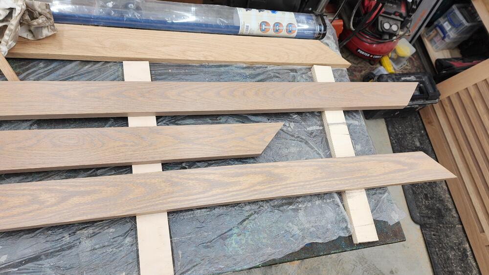

swt61 Posted September 14 Author Report Posted September 14 Casing installed. Next weekend will be the doors. 7

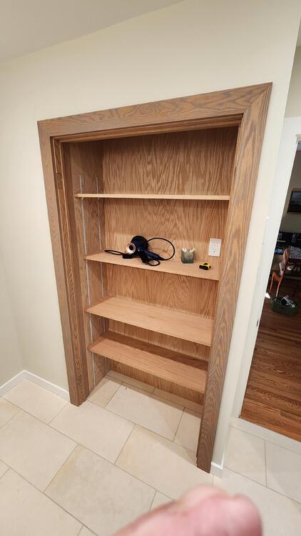

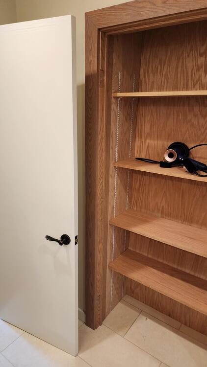

swt61 Posted September 14 Author Report Posted September 14 The interior panels and shelves are of Red Oak, the bastard step child of White Oak. I guess the contractor was trying to save money? I'm assuming they'll want it finished in the same smokey Rubio Oyster wax oil finish? I think it'll be pretty close once it's done. Right now it's a glaring obscenity IMO. 2
swt61 Posted September 14 Author Report Posted September 14 Oh, and disregard the customized "nose picker" finger tip in pic #1. It's my only imperfection, so I like to show it off so you know that I'm still human. 2 3

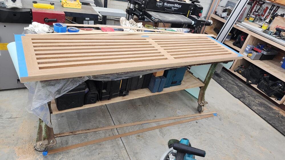

swt61 Posted September 20 Author Report Posted September 20 I had to cut all four edges of both doors, because the contractor didn't listen and built out the doors jambs. I got a little nervous when I pulled out the track saw and discovered a thin curf blade on it. I learned that thin curf blades on a track saw cutting hardwood can be a disaster. The thinner blade will actually bend into the track, destroying your project and your track. I've been buying specific Makita track saw blades, but no time to order one now. So instead I just went very slowly, watching the edge of the blade the whole time. Made four beautiful cuts. One door down, one to go. Then it's hinge recessing time. 5
swt61 Posted September 20 Author Report Posted September 20 (edited) Another tidbit... Finish the bottom and top of the doors too. Wether it be paint or stain and sealer. You'll never see them once installed, but it keeps the doors from warping in the future. Whatever you do to one side/edge of any wooden object, you want to do to all sides/edges. We knew that the length of these doors would have to be cut for final install, but didn't know that measurement yet. So now that I'm doing the final cuts, all surfaces will get the hardwax finish. Both doors cut, milled for hinges, sanded and refinished. Tomorrow will be installation. And then I'm done until dresser and door hardware arrive. Hopefully my measurements are correct. Edited September 21 by swt61 3
swt61 Posted September 20 Author Report Posted September 20 (edited) I didn't really show it, but running the doors through the table saw would have been a PITA. It's too cumbersome and would have left scratches in the already finished flat sections. So instead I opted for the track saw. One thing that I love about the track saw is that you just measure where you want your cuts, set the track right on those lines. No adding inches or subtracting inches. Set your track right to the cut line and that's it. 3 of the tool review shows that I watch have tested all brands of track saws. The Makita topped all except two. Those two are the Festool and the Mafel. Those are about three times the cost of the Makita. On two of those three reviews, the Makita tied with the Festool. The Mafel edged both out just by a hair. But I do love this Makita. So well thought out, and easy to micro adjust. One of my best investments. And if you're working alone it's the only way to go. Add in your wealthier buddies Festool dust extractor and even the cleanup is easy. That doesn't mean that the shop is clean. It's a disaster. That's next weekends project, but it saves you breathing in a ton of sawdust! More pics tomorrow. Edited September 20 by swt61 4

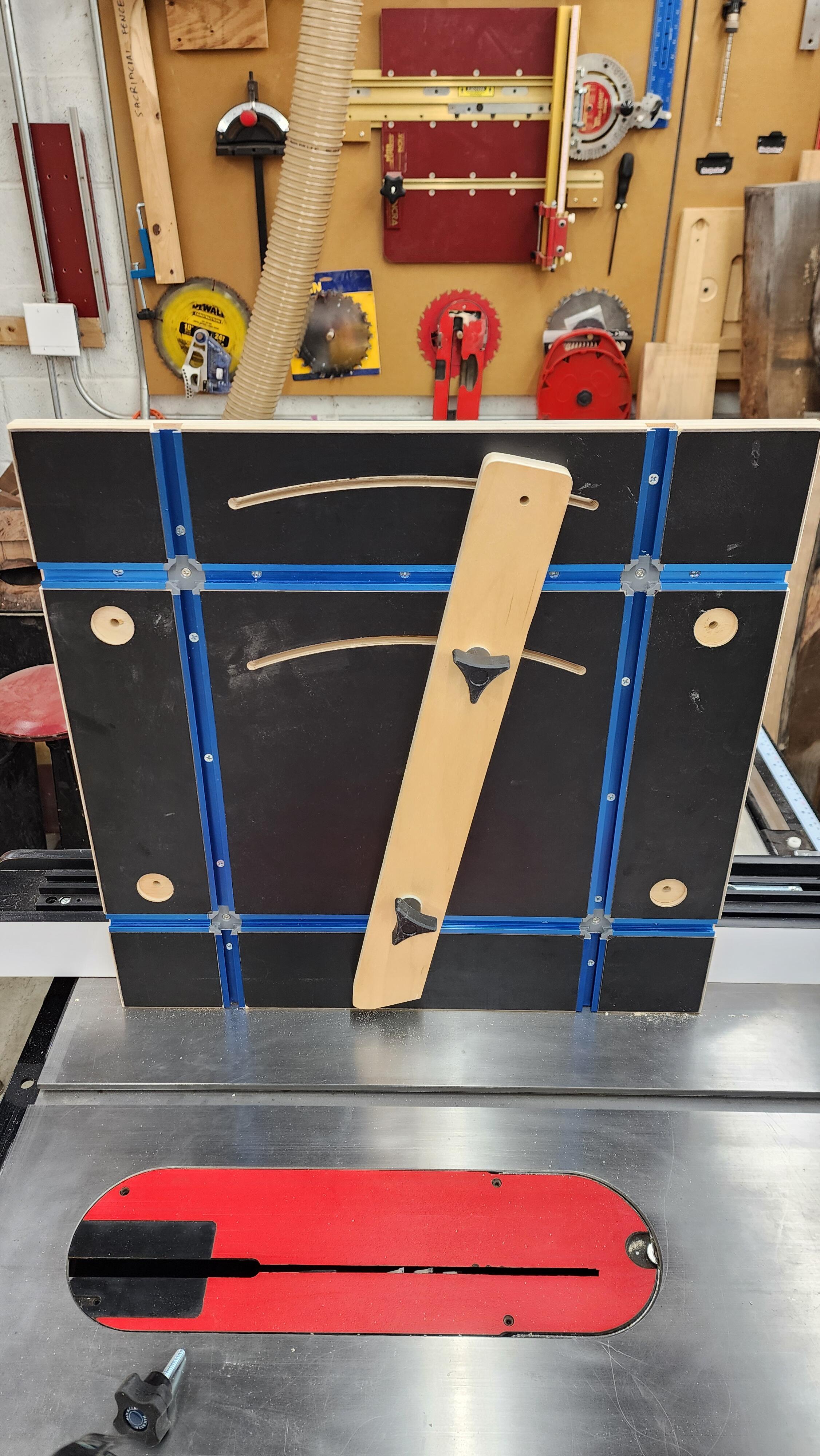

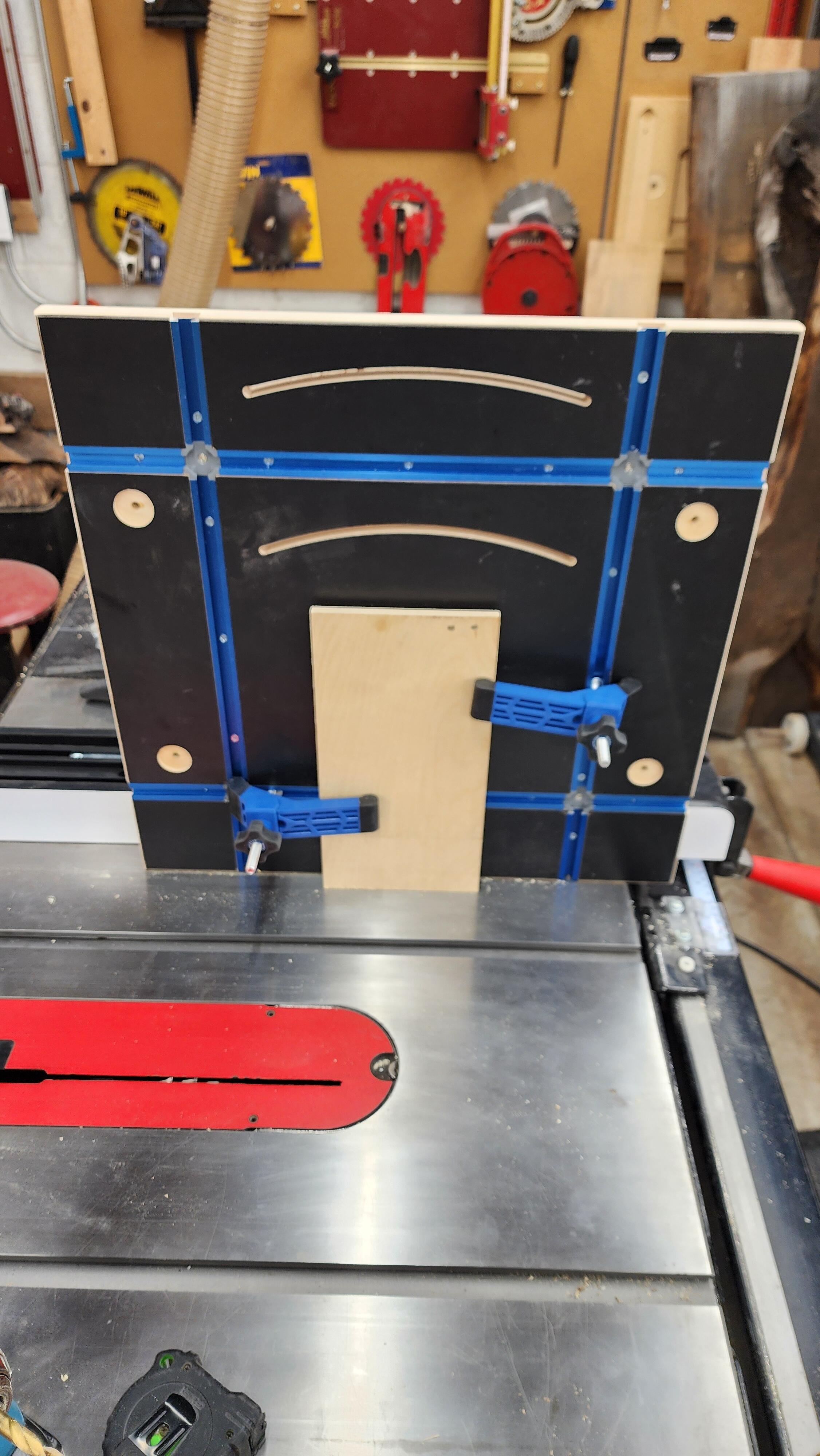

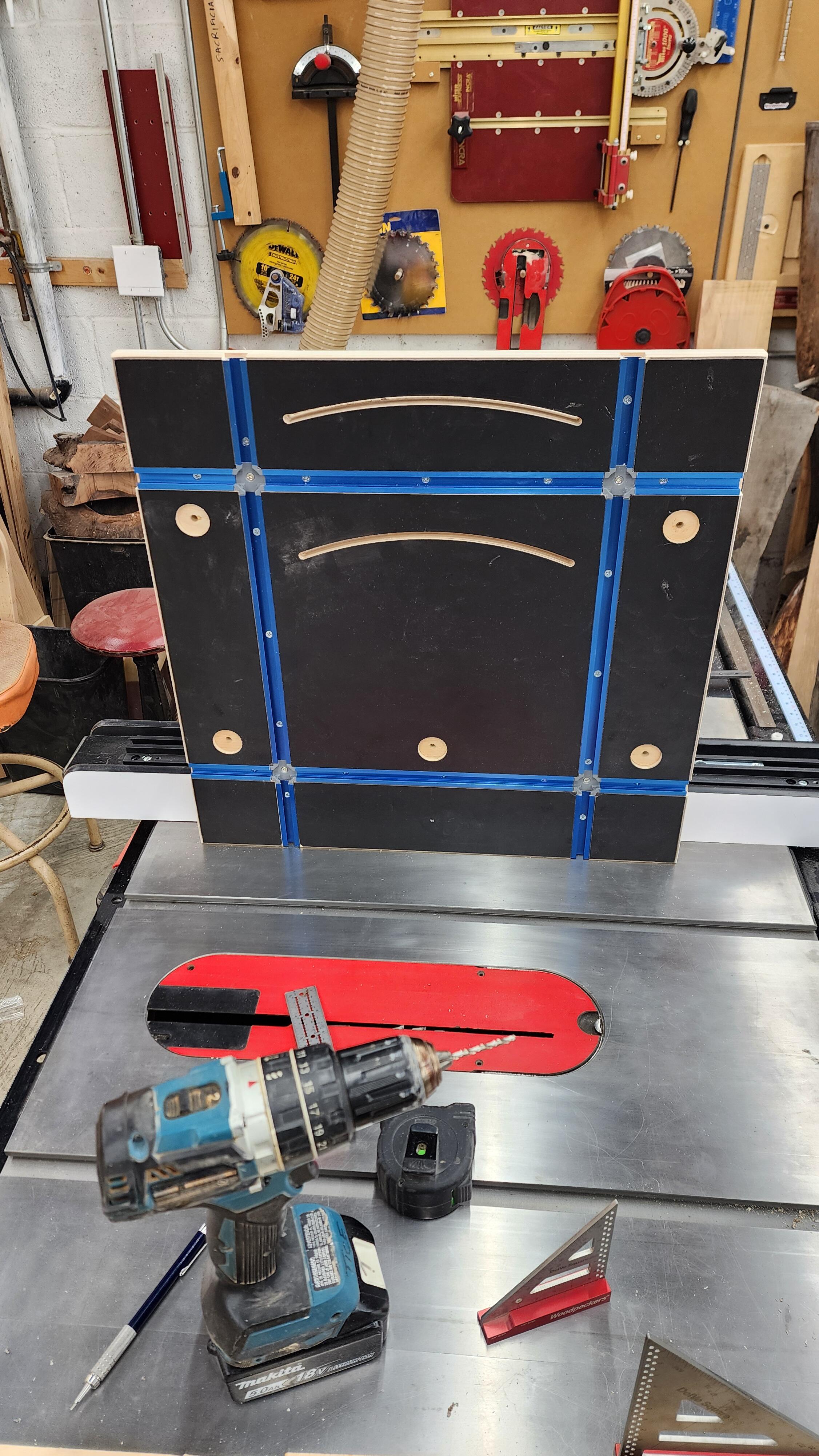

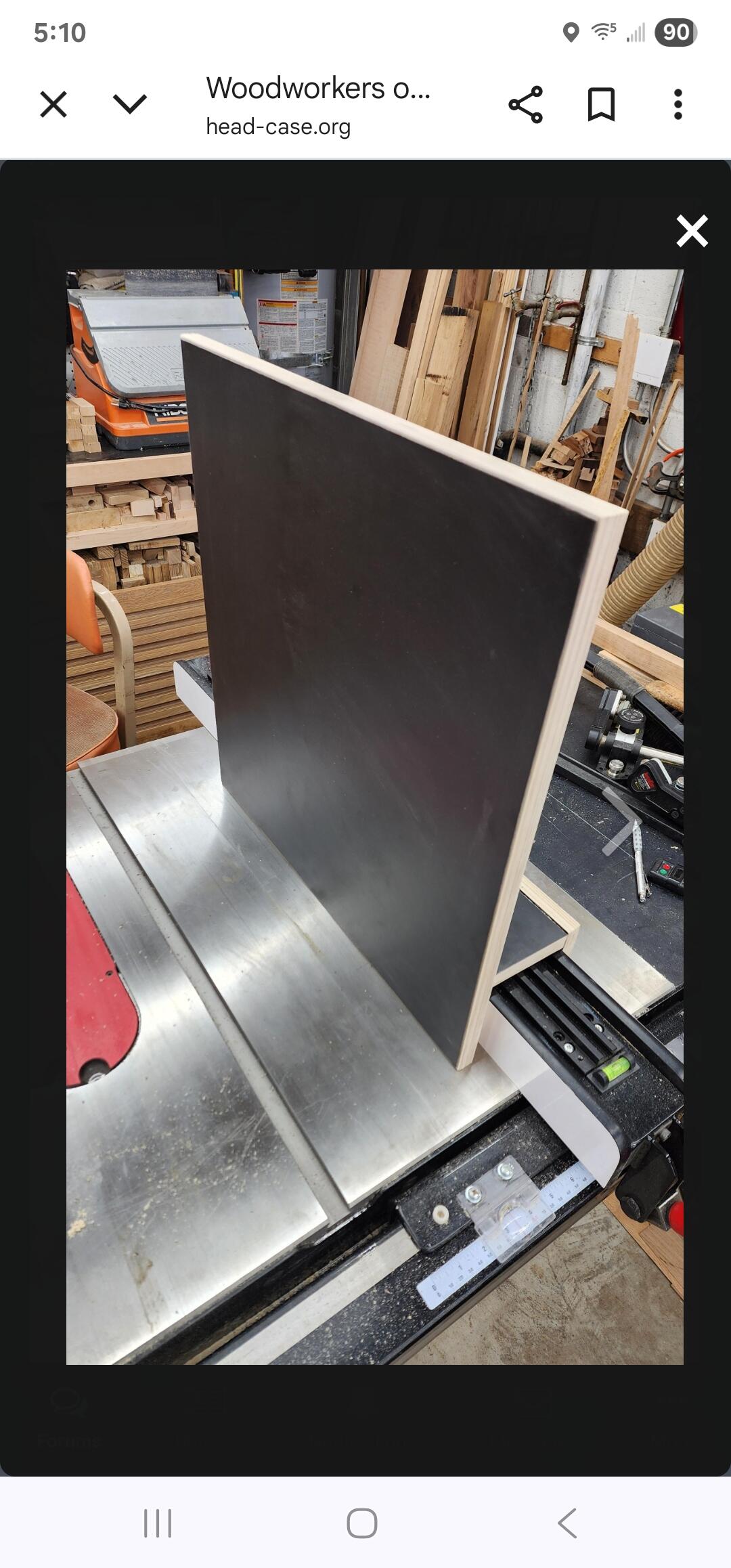

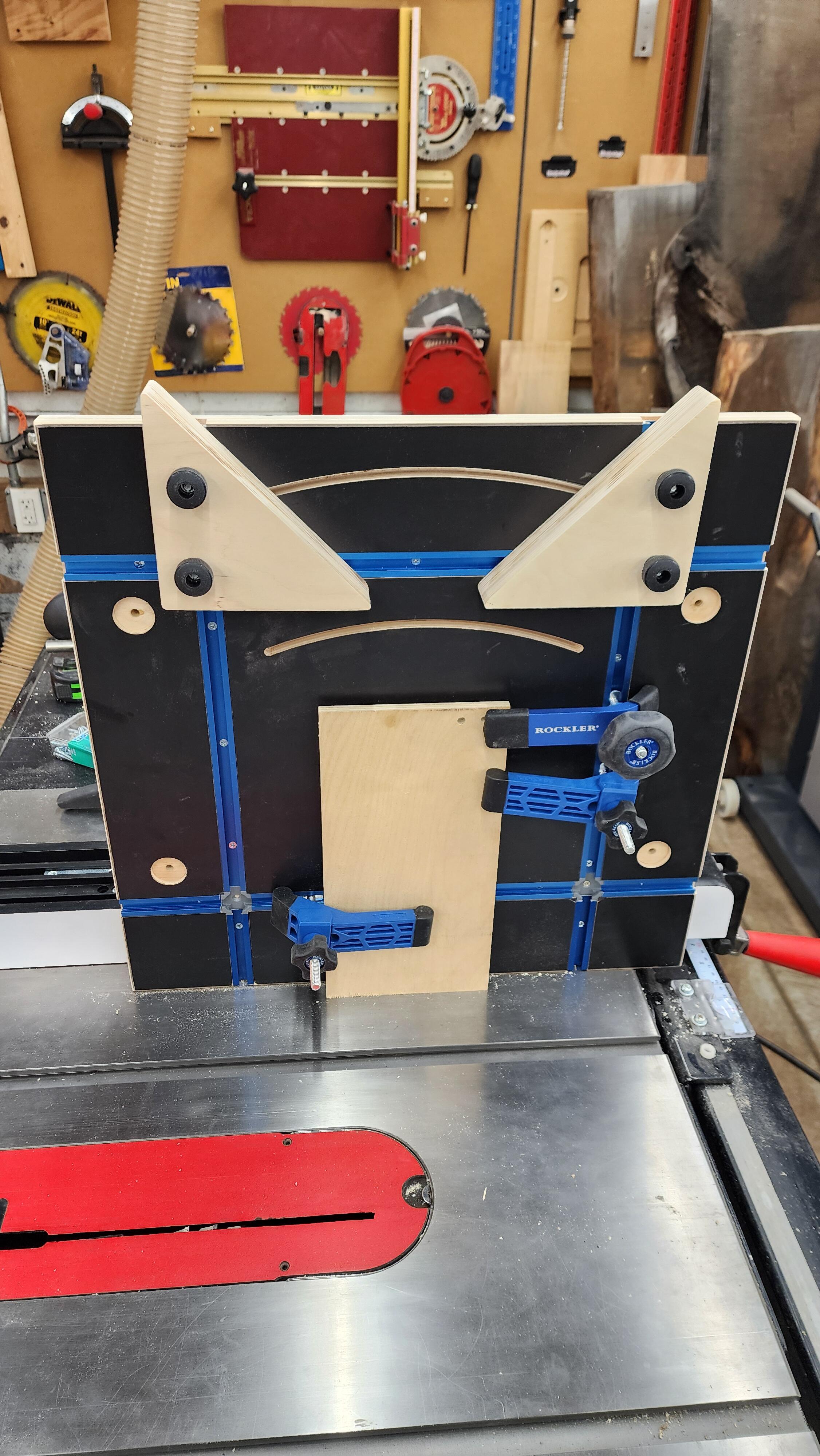

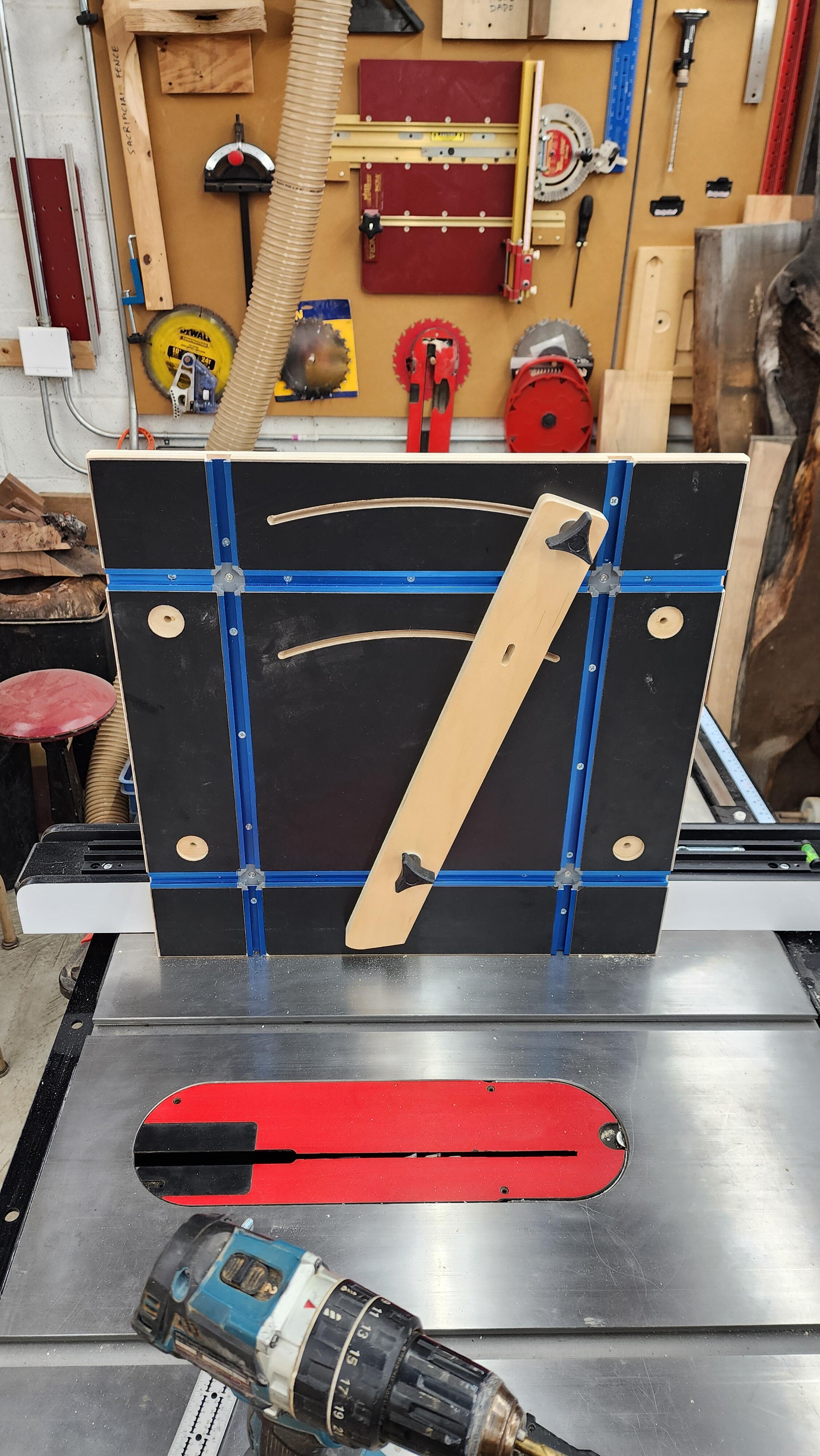

swt61 Posted October 20 Author Report Posted October 20 (edited) Today Al and I pretty much finished up the table saw jig that I started a while back. This is basically where I left off... Today we mortised for the tracks, made the arched dados for the tenoning portion of the jig and fitted the L fence and splining accessories that Al made on Friday. Edited October 20 by swt61 5
swt61 Posted October 20 Author Report Posted October 20 There are numerous things this jig can do. It allows for different clamping options, it makes raised panel door blanks much safer and easier. It has a splining attachment for reinforcing metered corners. It is also a tenoning jig, and the L fence attachment is pretty amazing. Lots of options in one jig. We need to order some specific T bolts and knobs still, but will do that shortly. L fence not shown, as we needed longer bolts to attach. 1
Voltron Posted October 21 Report Posted October 21 I'm not sure anyone cares, but here are even more pictures of the jig demonstrating the various uses. Tenon, mortise, bridle joint, etc. Splining miter joints L-fence for ripping straight edges or long miters And a gratuitous shot of Steve on Grindr 6
