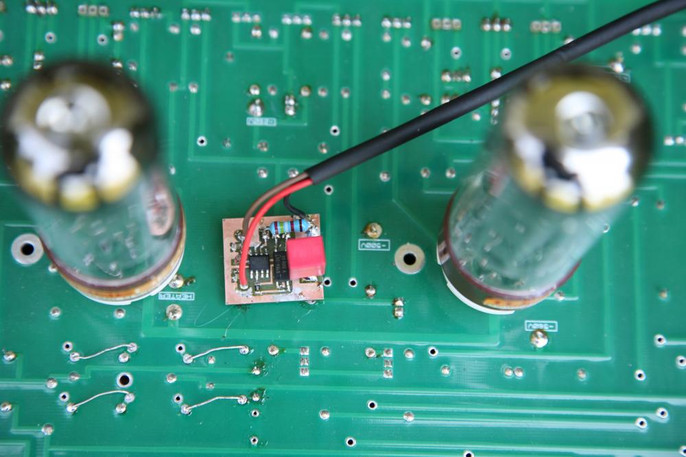

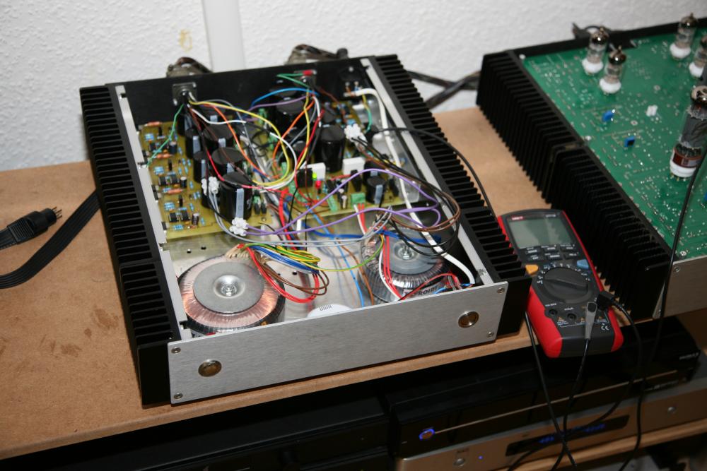

JoaMat Posted May 10, 2016 Report Posted May 10, 2016 Here is an original T2 with Kevin’s optocoupler servo. Servo is on a small board, replaces one of the 2SC3675 in Darlington pair. Works well…. so far. 3

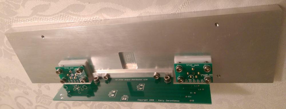

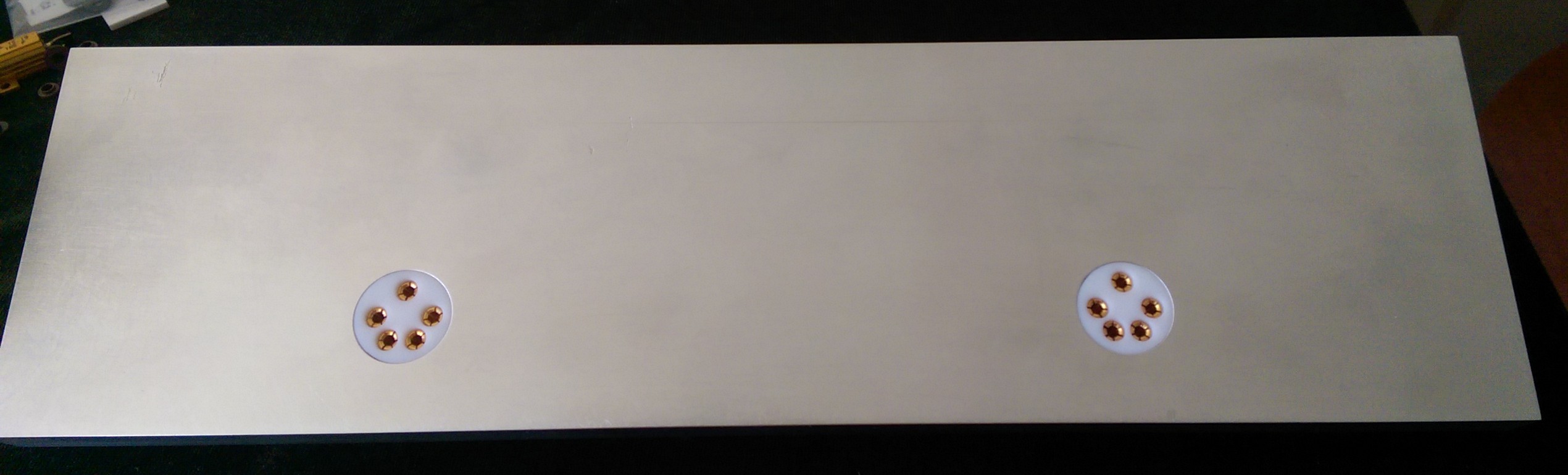

Kerry Posted May 18, 2016 Report Posted May 18, 2016 (edited) Working on the face plate for the T2. I made the jacks and the boards and milled the face plate out of .5" stock. It's blind mounted from inside the chassis. I'm just about ready to wire this up. EDIT: I also need to add the hole for the POT. I've got a bit more milling to do on the face. Edited May 18, 2016 by Kerry 9
johnwmclean Posted May 18, 2016 Report Posted May 18, 2016 I’m always amazed by our much fine detail must go into work like this. Beautiful Kerry!
GeorgeP Posted May 18, 2016 Report Posted May 18, 2016 Kerry, is that pot cut out for an Alpha or one of the small TKDs? I thought you were going with a board mounted pot earlier, but may be misremembering.
Kerry Posted May 18, 2016 Report Posted May 18, 2016 (edited) 9 hours ago, johnwmclean said: I’m always amazed by our much fine detail must go into work like this. Beautiful Kerry! Thanks John. I've always been impressed by your build as well. 18 minutes ago, GeorgeP said: Kerry, is that pot cut out for an Alpha or one of the small TKDs? I thought you were going with a board mounted pot earlier, but may be misremembering. No, it's for a digital encoder so I can use the new version of the digital attenuator. I have couple of different style encoders that this pocket will accommodate. The attenuator will mount over the board where the POT mounts are. I'll probably make up a board to make this easier. Edited May 18, 2016 by Kerry

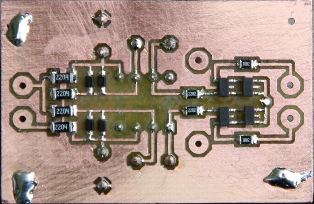

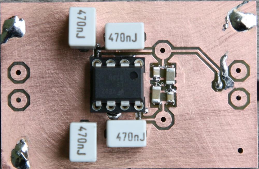

JoaMat Posted May 18, 2016 Report Posted May 18, 2016 14 hours ago, Kerry said: Working on the face plate for the T2. I made the jacks and the boards and milled the face plate out of .5" stock. It's blind mounted from inside the chassis. I'm just about ready to wire this up. EDIT: I also need to add the hole for the POT. I've got a bit more milling to do on the face. I agree with John. Amazing front plate you have done, Kerry. Today I built a T2 servo on a small board. It’s now doing service on an original DYI T2 and seems to work OK. If it really works the layout will be implemented in a new version of DIY T2. Also give me opportunity to learn milling PCBs on a small CNC machine – indeed a funny toy. Did a small mistake - can you find error in below pictures? 3
JoaMat Posted May 18, 2016 Report Posted May 18, 2016 Yep, that’s right. Tried to be smart. Set the cut depth to shallow at first. Ordered the machine to clean up a small area…. and at the same time it cut the trace near that pad. Learning by doing... 2
headinclouds Posted May 20, 2016 Report Posted May 20, 2016 That's good work Joamat. A fine example to us. and Kerry great stuff, are you doing that on your own milling machine? One of the "rules" I adopted from the outset was no screws should show on the front panel. It is a costly process and requires heavy material but looks good.
Kerry Posted May 21, 2016 Report Posted May 21, 2016 Yes. I used my mill for this. My version 2 mill is fairly solid and as long as watch the speeds and feeds, I can mill 1/2" plate no problem. 1

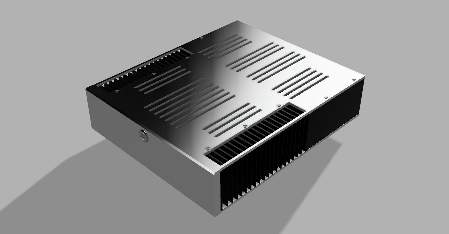

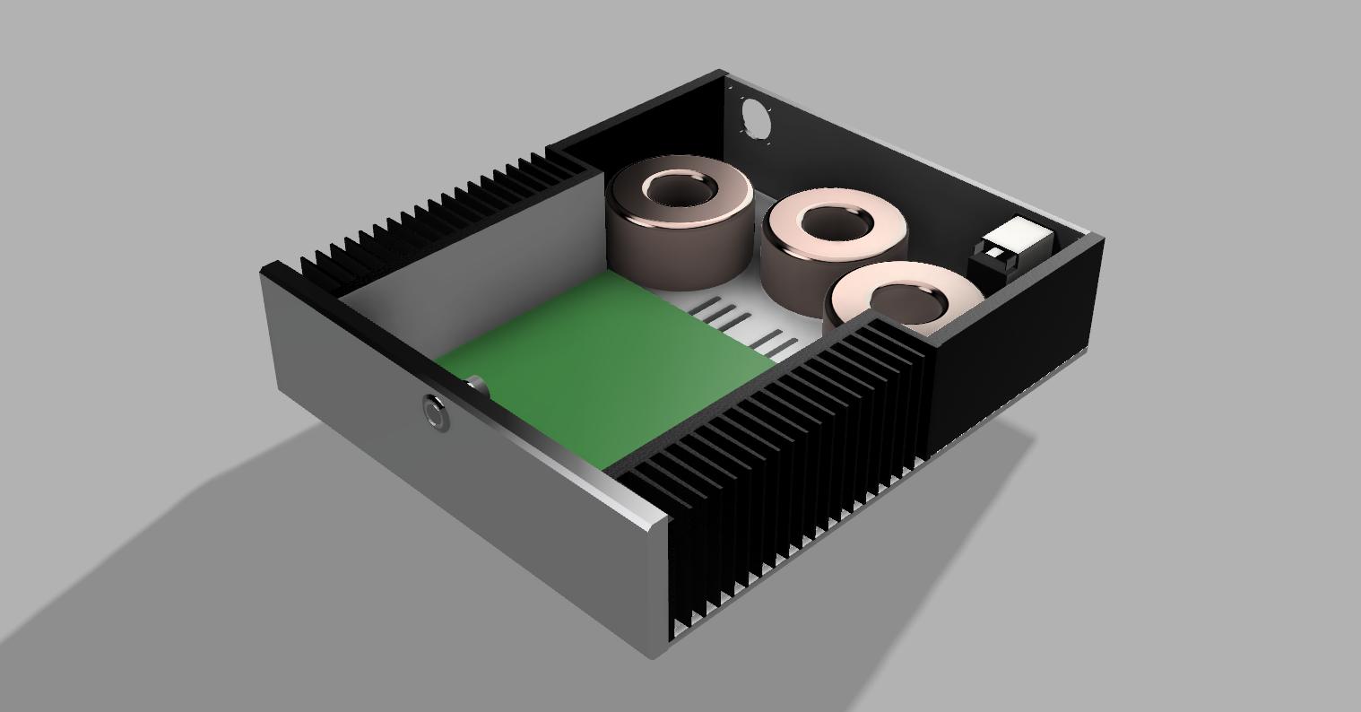

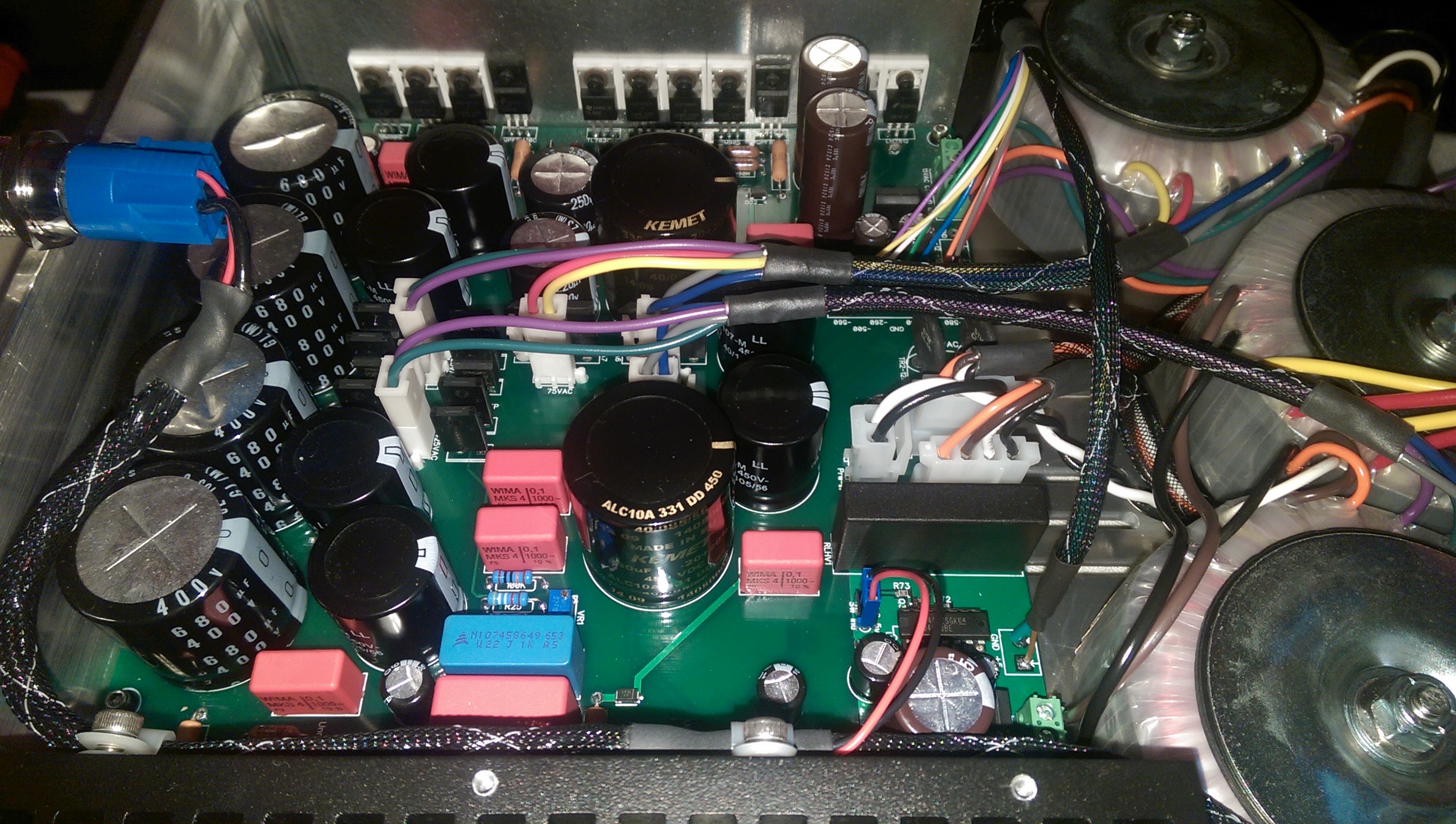

Kerry Posted May 24, 2016 Report Posted May 24, 2016 Working on casing the power supply now. The first two images are renders from Fusion 360 (love this program for CAD/CAM)... I got the transformers from Richard at SumR. I added a winding to the LV transformer for the +5V I use for the control circuit/relay as well as the Arduino and digital relay. I also removed a winding on one of the HV transformers since it's not used and adjusted some voltages. Just finished testing them in the new setup and so far so good. I've still got to test everything under load before reconnecting to the amp. The face plate is a temporary while I mill the final one. 8

luvdunhill Posted May 25, 2016 Report Posted May 25, 2016 Kerry, for all that awesomeness, I still can't get behind: transformers in the rear (which stacks under the input stage and near PSU output connectors) and mounting transistors that way (versus angle bracket). Just my $0.02 though, beautiful work and what an amazing assent as a DIYer
spritzer Posted May 25, 2016 Author Report Posted May 25, 2016 He could put a steel plate in the lid of the PSU, that should take care of the transformers.

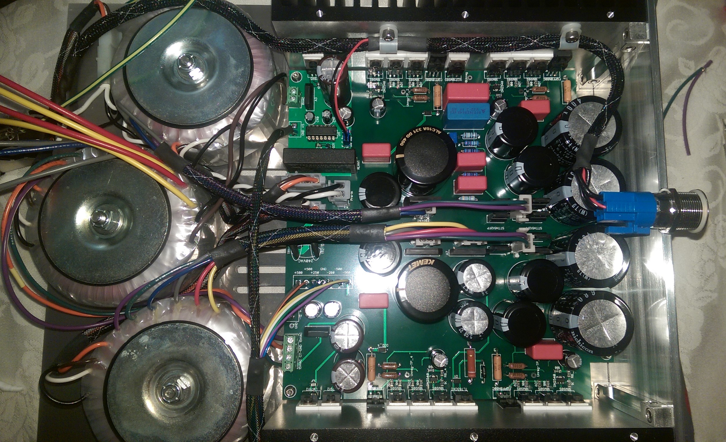

JoaMat Posted May 25, 2016 Report Posted May 25, 2016 (edited) 5 hours ago, luvdunhill said: Kerry, for all that awesomeness, I still can't get behind: transformers in the rear (which stacks under the input stage and near PSU output connectors) and mounting transistors that way (versus angle bracket). Just my $0.02 though, beautiful work and what an amazing assent as a DIYer Transformers in the front (other reason than above though). You like the wiring? Size is huge. Angel brackets adds to much thermal resistance and add space. Edited May 25, 2016 by JoaMat
Kerry Posted May 25, 2016 Report Posted May 25, 2016 (edited) Thanks for the comments above I do appreciate it since I'm always looking to do better. I was thinking of putting the transformers in the front, but I couldn't fit the power inlet and output comfortably with the board layout. I can think about this as a future revision. Currently, I've got about a 4" gap between the top of the transformers and bottom of the inputs when the units are stacked, which helps a bit. I've also got about 2" between the transformer and output and I will shield the output cable leading to the output. Transformers are shielded too. Additionally, I added shielding (tied to chassis/earth on the PS side) between the AC in the umbilical and the DC outputs. I can look into mu metal / steal as well. This seems like a great solution. What about a steel mesh (just thinking of air flow)? What's the specific concern on the transistor mounts? I know there are more screws if I want to remove the board, but I did like the idea of saving space and also that there was one less component between the transistor and the sinks. I considered mounting the transistors to a 3/16" flat plate and mounting the plate to the sinks, but it just felt like a lot of extra machining and I didn't have a clear goal for it in mind. EDIT: One other thought/question. I was going to solder the transformer leads for the filaments directly to the output jack. If I need to replace that transformer for any reason I could simply cut the leads and splice the new transformer in. I don't love this, but it's not that much work in the grand scheme of things just in case the LV transformer blew out in the future. Are there any good suggestions for in-line connectors? For the output filaments, they'd need to be able to handle the -500V to chassis/input filament isolation. This feels like a bit of over-engineering, but this whole build is about that :) Edited May 25, 2016 by Kerry 1
