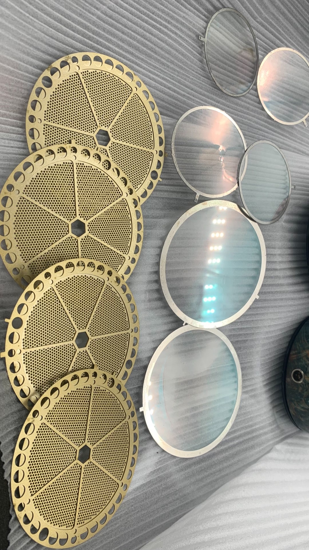

Yesterday at 07:58 AM1 day ES Labs are cooking something good. 😃https://www.instagram.com/p/DbBxCZOTJCE/?igsh=MXBuZDUyejU0c3pzeQ==
Yesterday at 10:06 AM1 day I'm looking forward to those as I'm slowly working on my own version just for me, i.e. fixing how they sound. :) I got these recently:https://poloyoaudio.store/products/hongshu-eh1It is my third one of these as they design has been maturing over the years. I'm waiting on a replacement set as mine had some noise issues in one driver so I'll do a proper write up as they arrive but I do like them a lot. The earpads are crap but there is a lot of potential there.
