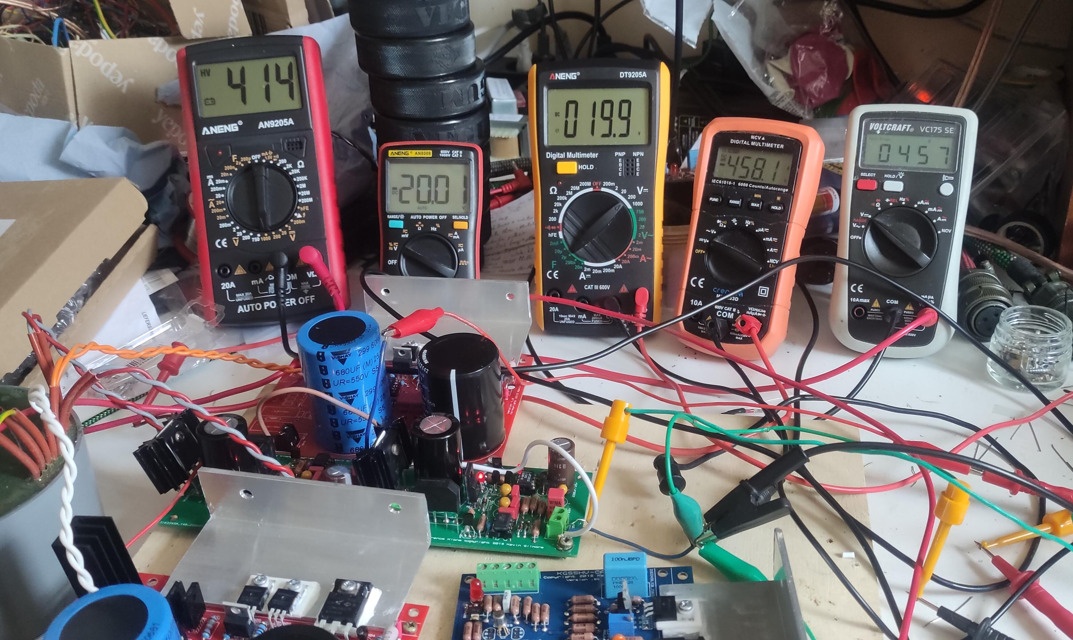

Hello Friends, a nice family shot with no load, no current limitation. Have to figure out why the bias doesn't kick in at 580V, otherwise quite happy.
That was fast! Thanks a lot. -
