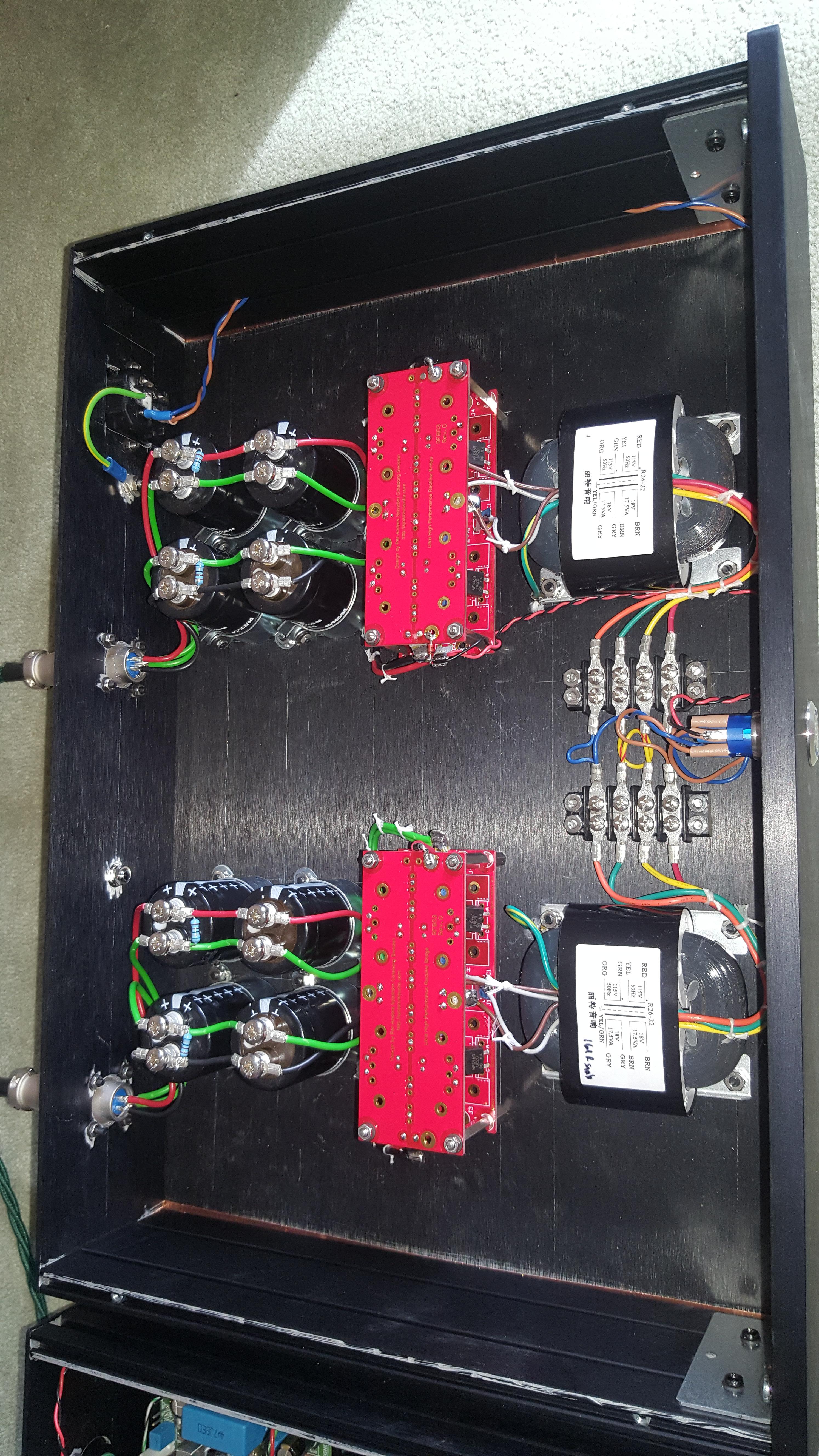

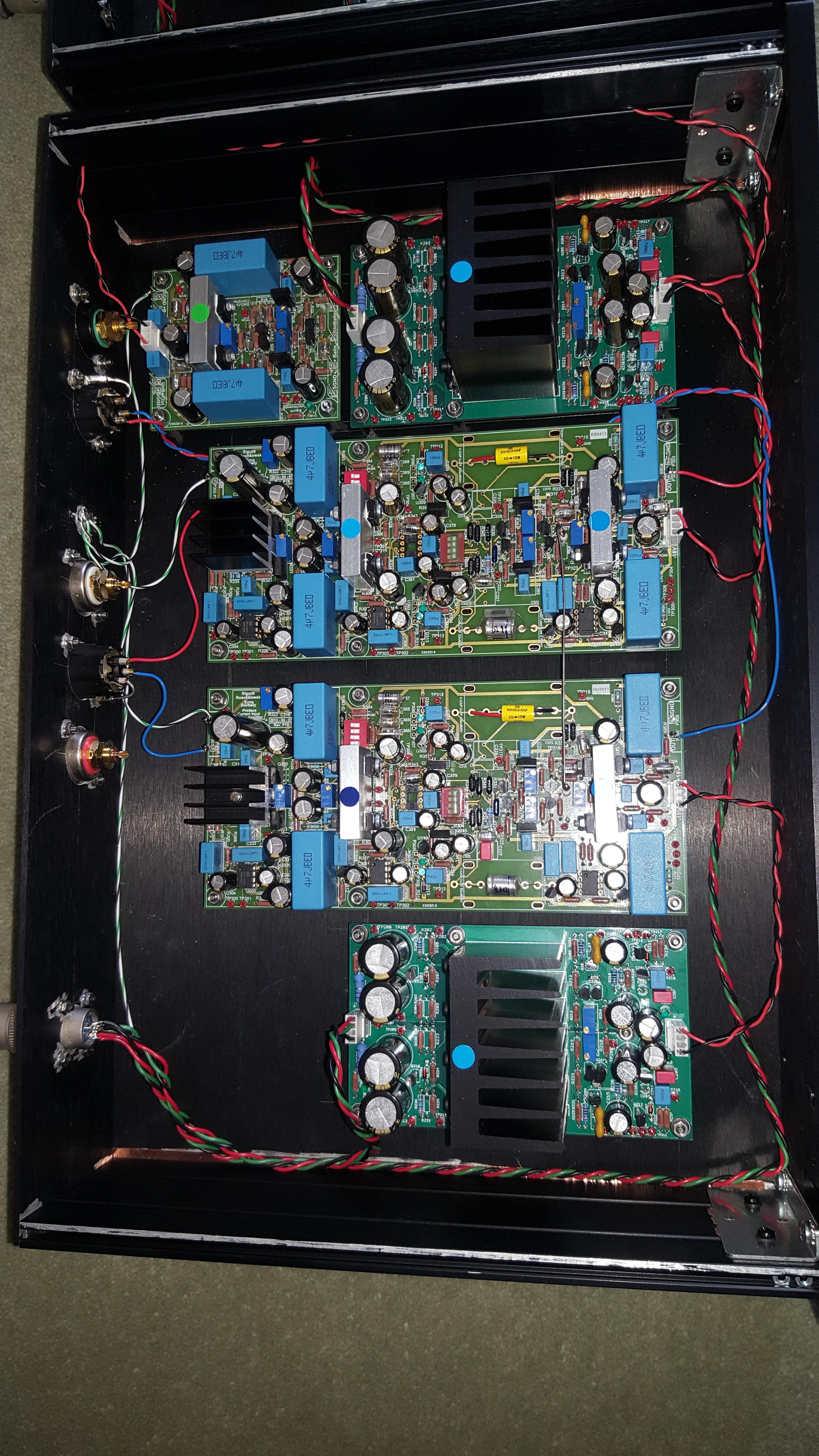

Looks really good! Minor point on the XLR wiring. You've got pins 1 chained together and then via a wire to chassis. And yes - pin 1 absolutely has to go to chassis, but by the shortest possible route - a separate thick wire from each pin 1 to a ground solder tag at the nearest XLR screw. With the arrangement you have, any RF intercepted by the balanced cable screens goes into a tuned radiative loop (from the dimensions, several hundred MHz) and spray it inside the chassis. And conversely any radiative interference from those class D power amps gets coupled onto the XLR cable screens.
