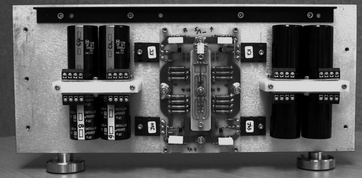

Don't know how else to organize this ATM... Some items: Marc suggested using DC Link? capacitors in the floating supplies- I'm not 100% sure about each of the appropriate pieces that compose the entire amplifier, but the first image that formed in my mind the F5X enclosure described here. Transformers on the bottom, amplifier + output psu on the sides, standard psu on the back/over the transformers. Seems like something to leverage here would be the way EUVL chose to mount the capacitors...maybe another set of daughter boards? Allows more options for aspect ratio, and you're not subjecting these honking capacitors to as much gravity- I will try to be productive and see how the actual measurements stack up. One bonus of using "standard" enclosures is that we also have access to riser panels which seem to be made with the larger cases in mind, There is also the possiblity of standardizing the I/O, faceplates, board mounting holes blah blah blah

Hope you guys don't mind, but I'm taking the liberty to collect some info, links etc. here. 900V floating supplies 350V/us the cole slew (couldn't resist) seems to be happening in bits and pieces in multiple threads on multiple forums and there are some implementation issues which seem to be worth discussing...namely fitting all of this somewhat daunting amplifier into one case. I guess at some point Kevin decided to split the input and output stages- output board output schematic The output stage features the floating supply floating supply fboard floating supply schematic the input/driver board As of today the aim is to fit this all in a single modushop 5U chassis, the floating supplies make it prohibitive to split the build across multiple boxes. Transformer Specs: Supposedly trivial to get an EL34 version of this working but SiC version will be first Just wanted to hopefully direct discussion here instead of dragging it across the kgsshv/GB/headfi threads. I'll update this when I get around to fishing around for the appropriate information. Thanks to Kevin for making the design process somewhat transparent ---------------------------------------------------------------------- Figured I'd put this here too, since Kerry speaks for all of us:
