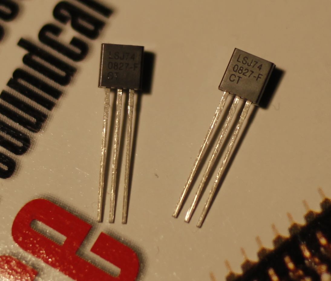

  4. Linear Integrated Systems - Press Release http://www.linearsystems.com/datasheets/LSK389.pdf If you'd like me to try one, I could send one out your way.

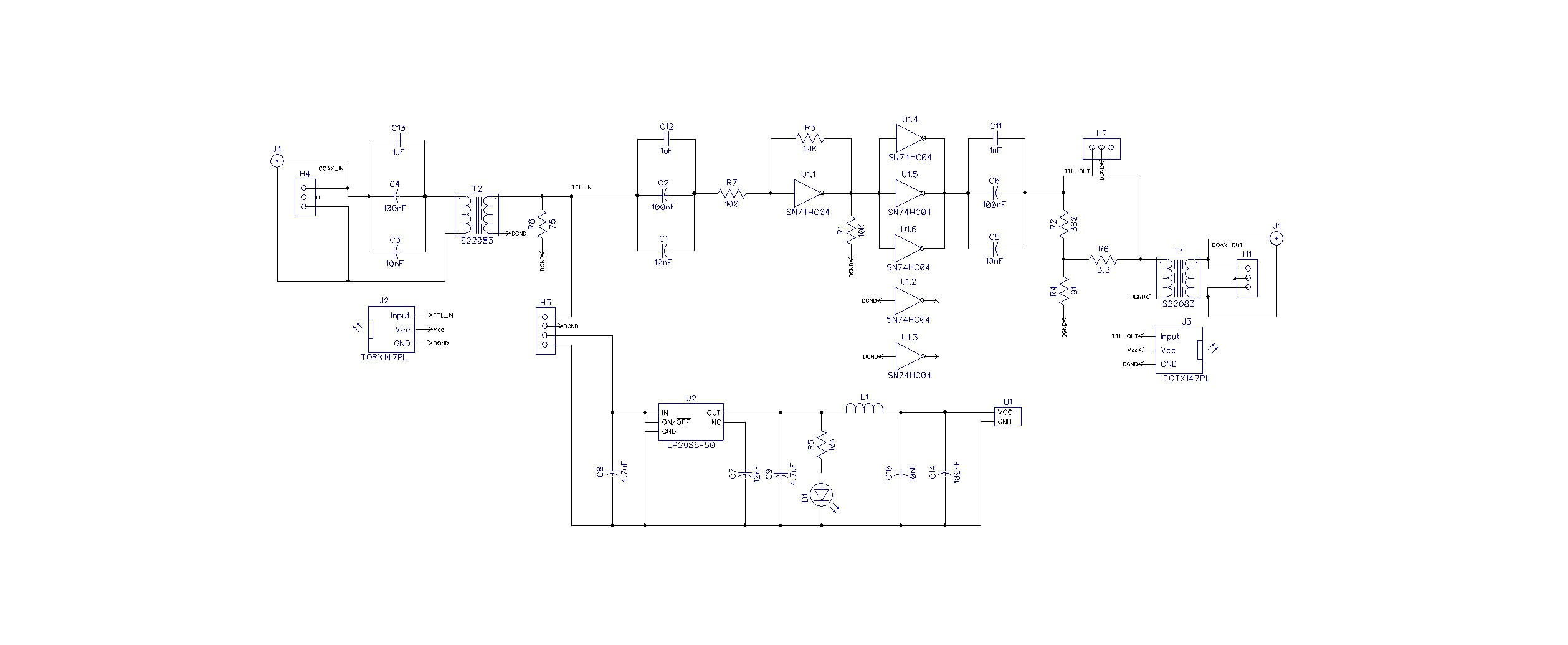

  18. well, I'm already expanded my scope to have both a TTL to coax, and coax to TTL circuits, as well as level shifting. It would be easy enough to also add a toslink connector option. I'm not sure the level shifting is really necessary, so I'm still a bit confused on that point. However, I'll probably add it anyways. I'm also thinking of paralleling more inverters together, perhaps three. I'll post the circuit tomorrow and see if perhaps that will get me a bit more feedback

  21. I'd like to add that for the moment, I'm only interested in 3.3V TTL and might include a level shifter on the PCB, but it's not priority at all really... I'd use a mosfet or something simple.

  23. I need help putting together a simple TTL converter circuit to raise three DSD / SPDIF3 signals up to TTL level. I'm tapping the lines off a TI DSD1608. Here's what I have so far. Specifically, I was looking at a single TI SN74HCU04D for all three signals. Any recommendations on the cap here? I was thinking all surface mount here, but whatever the consensus is for the caps, I'm fine with. I'm thinking of adding a regulator as well nearby, like a National LP2985 5V regulator, or similar. Currently, these SPDIF3 lines won't leave the single box player, but perhaps down the line I'd route them to an external box via BNC cables. Either way, I'm assuming a single buffer is okay? Any other topologies that would work well?
