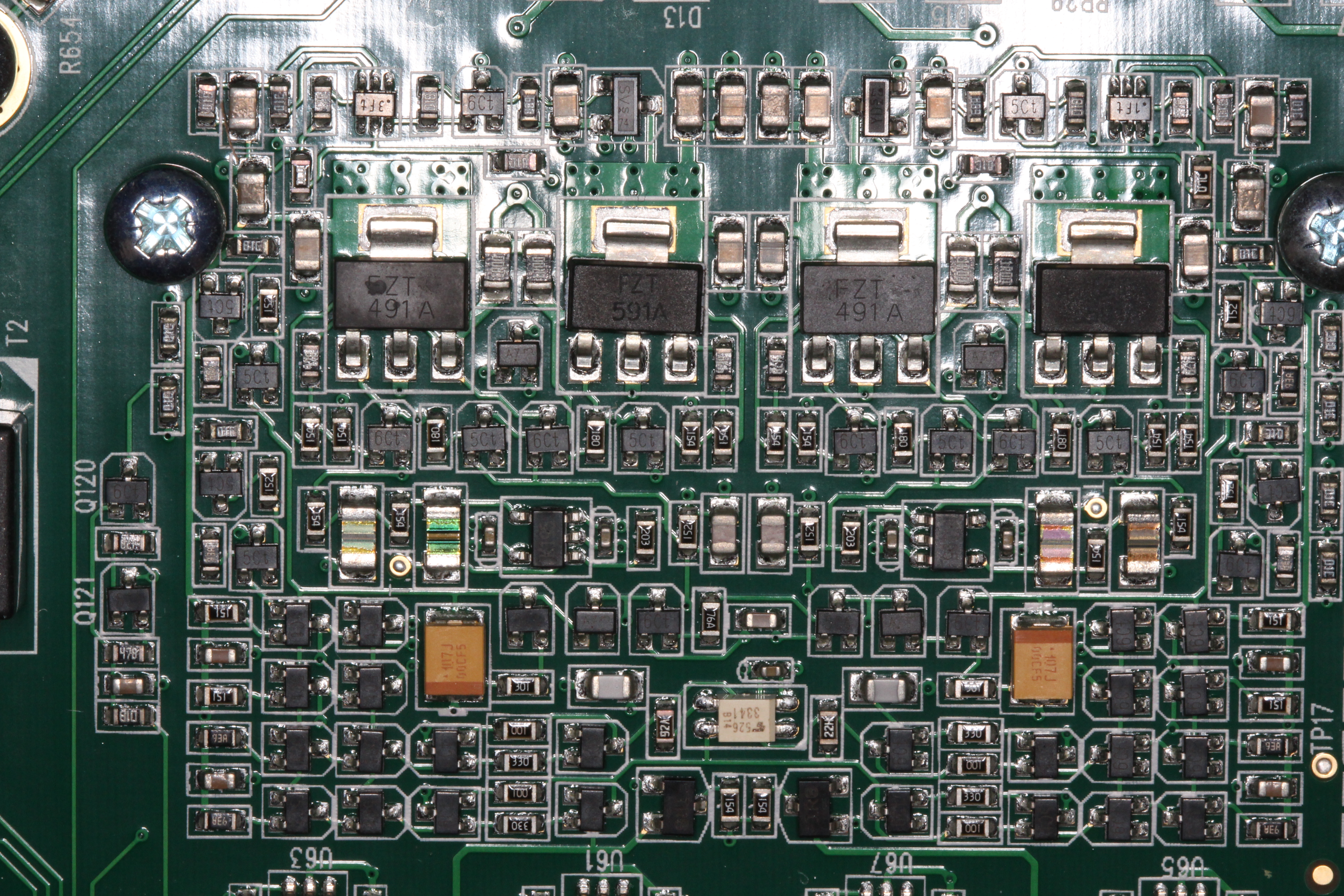

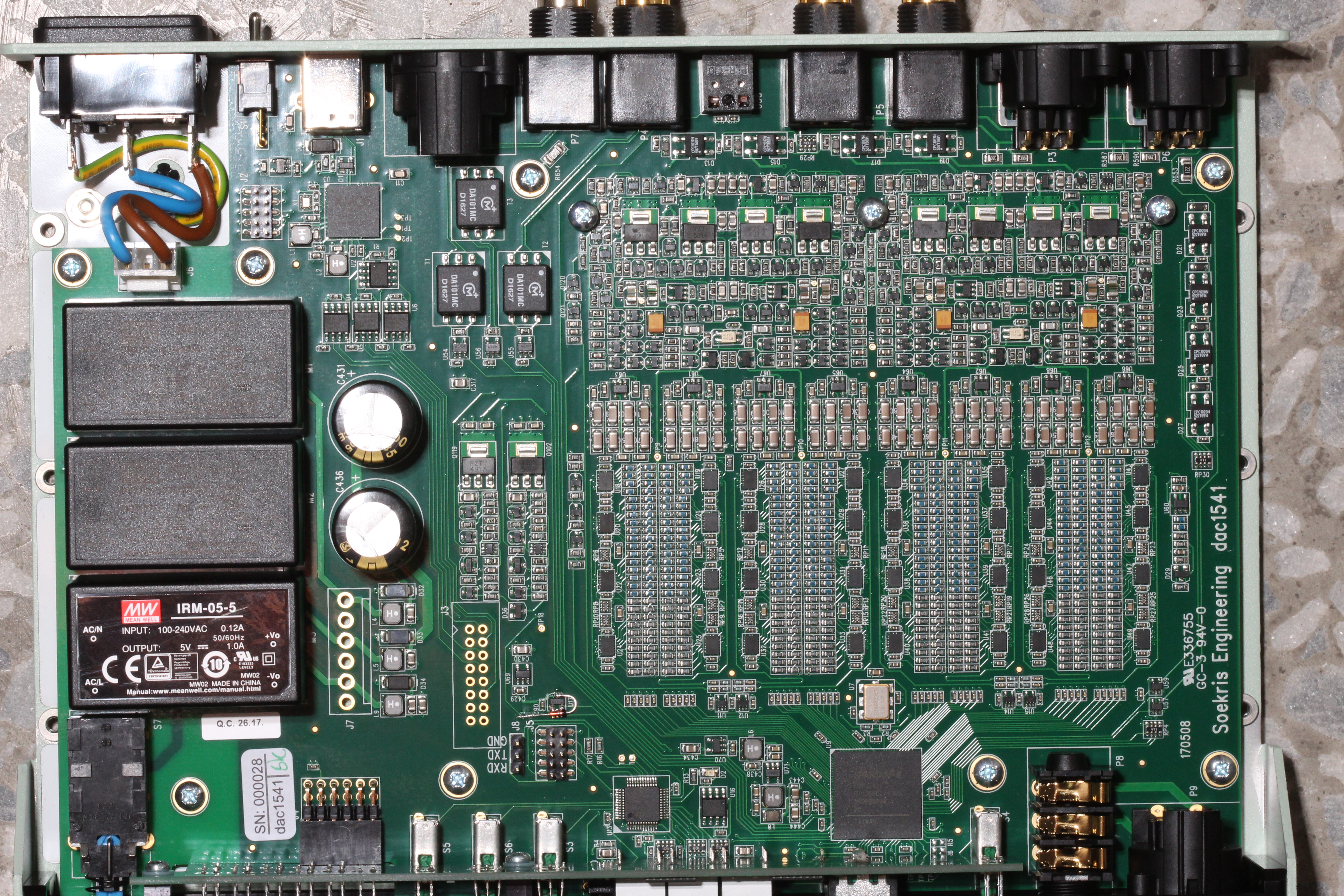

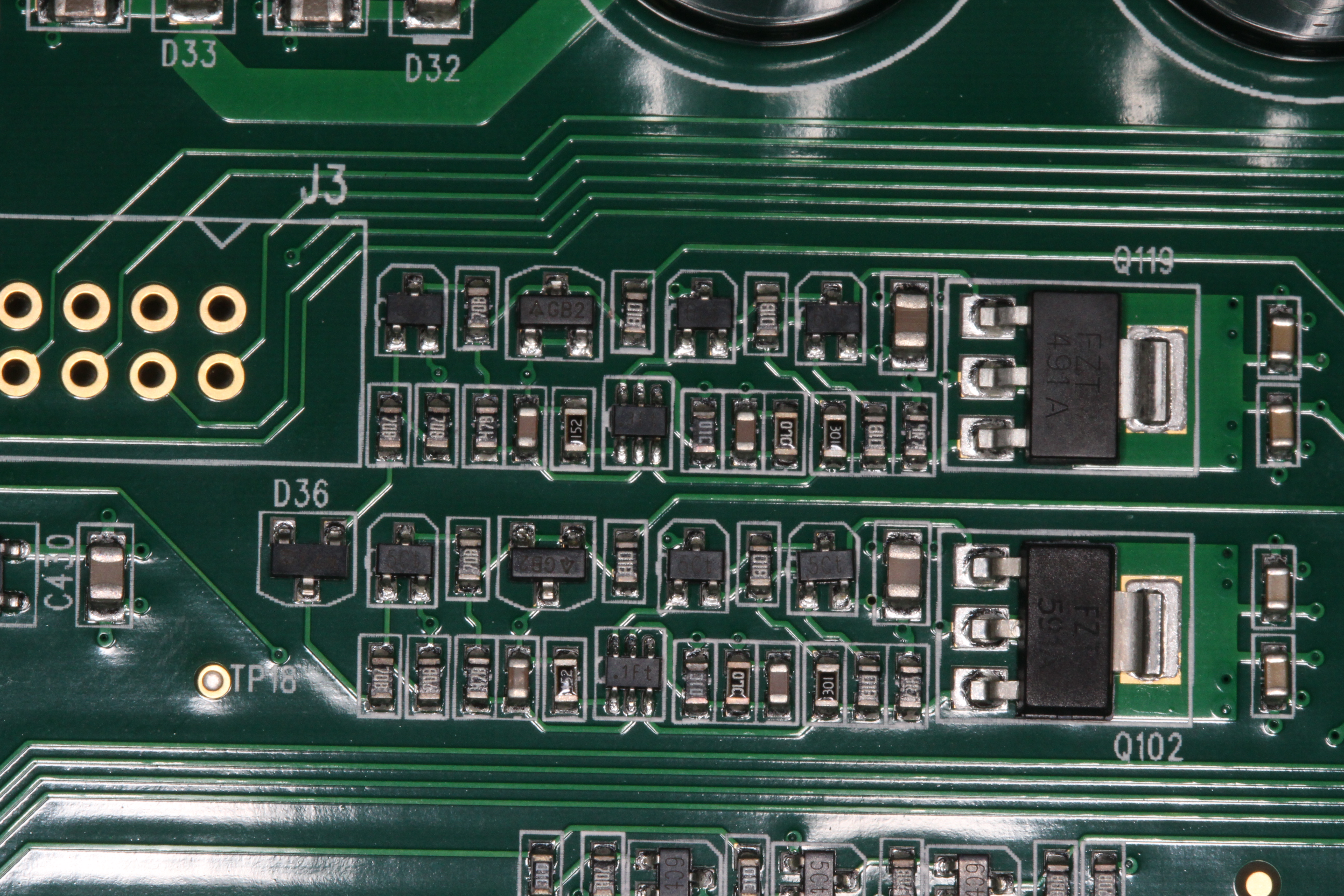

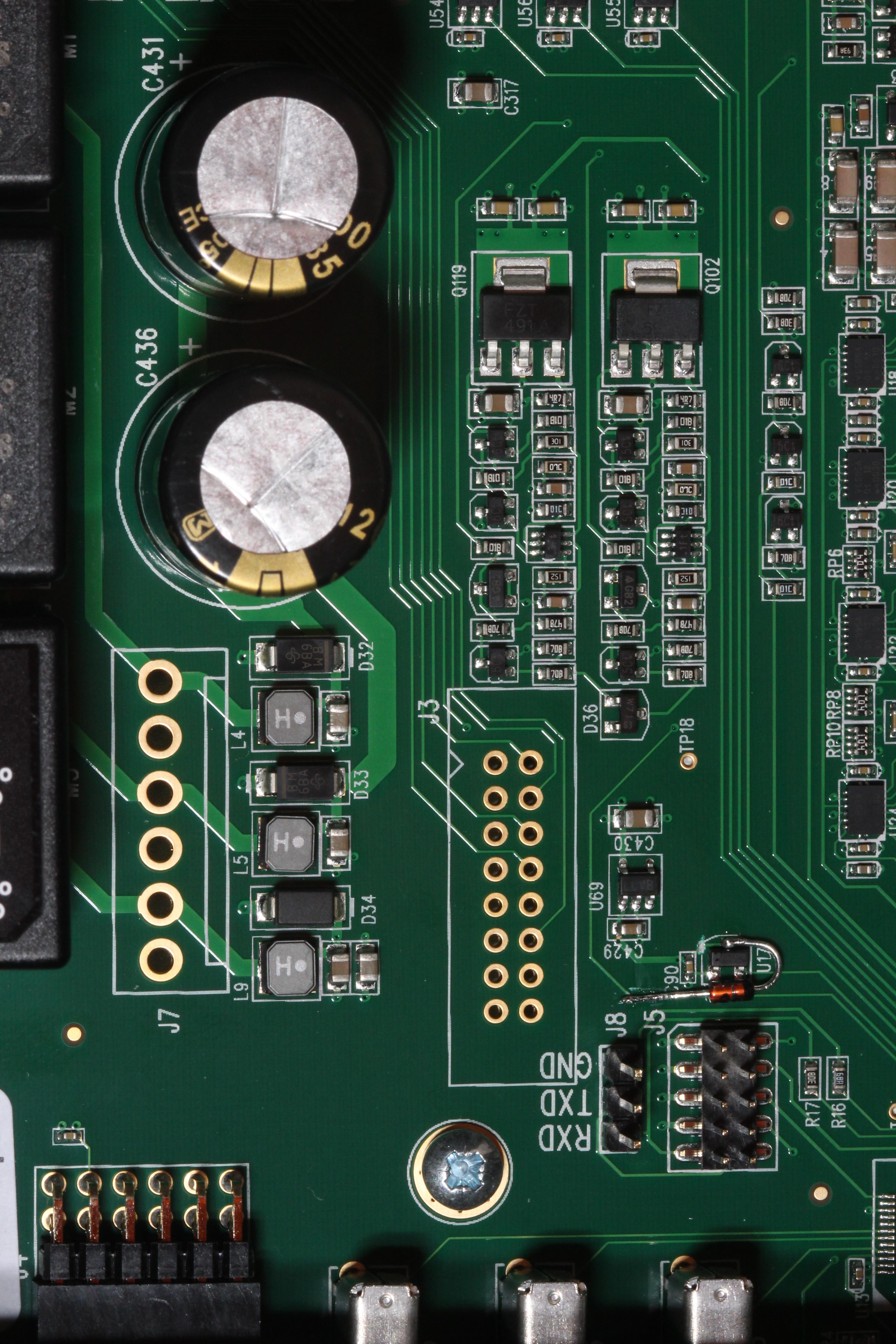

joehpj Posted August 2, 2017 Report Posted August 2, 2017 I tried to take every detail. I still have some photos if someone need more details. Overall sound is good. This dac runs warm. Quiet curious about the buffer design. comments plz @kevin gilmore 4

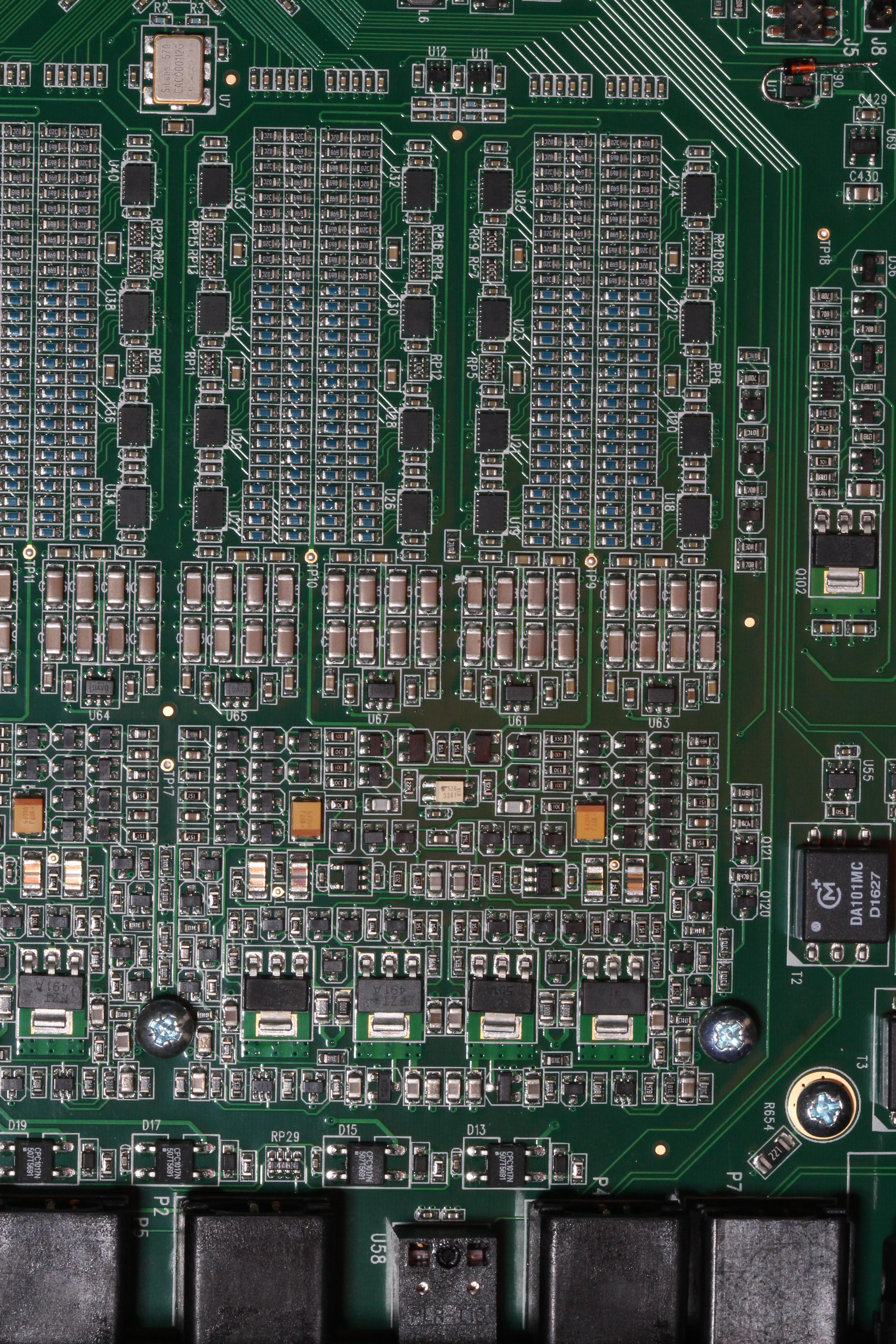

kevin gilmore Posted August 2, 2017 Report Posted August 2, 2017 output buffer may be a diamond follower, hard to tell. rest of it after the dac certainly looks like stacked current mirrors. certainly a complicated design similar to what you see inside integrated circuits. obviously assembled with high resolution pick and place machines. much better built than a lot of stuff I have been seeing these days. Now a year or 2 to make the software perfect and the thing will be gold. no sanded off parts either like the denafrips, so they are proud of their work. Only one board error with that hand soldered diode. nice stuff and an indication of whats coming. 4

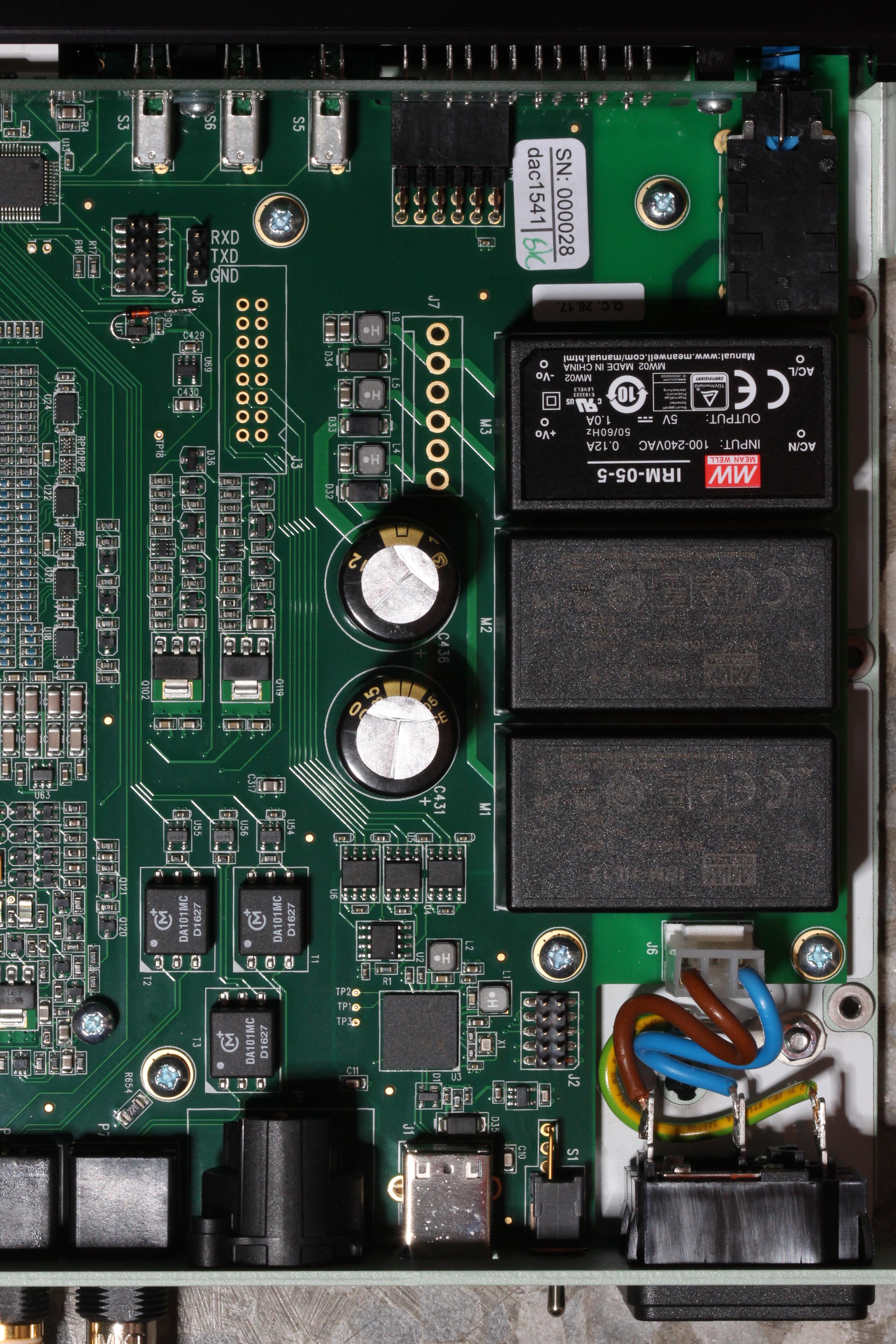

joehpj Posted August 2, 2017 Author Report Posted August 2, 2017 This is not mine so I have to send it to the owner. I just got the chance of a brief listening. This DAC was really good for those have no skill/time to DIY. Compared with single 1021 w/ uber buffer fed into balanced CFA, uber has better sound stage and dynamics. 1541 has some more detail and sounded airy. The front panel is a convenient feature so changing digital filter and xfeed are much easier than DIY ones. The chassis however, was solid but compromised on finishing. It looked cheap. For a DAC now 1290 Euro, and made in Denmark, I can't expect it having a much better look though. The main issues here IMO, are 1) the performance of buck+LDO. I personally prefer some traditional way like transformer+ultra low noise linear PS. 2) the performance of the output buffer. It has only +-12V ps. But should be plenty for the output. It has different PS for digital and analog rail. The 1021 DIY module drive 5V digital parts form analog rail. Which was somehow compromised, too. So people have to choose form better buffer like Kevin's diamond buffer and some real ultra low noise LDO or isolated PS for digital/analog. PS. the OP based balanced buffer on 1021 is utterly shit. Use raw output and some better buffers. 1

kevin gilmore Posted August 2, 2017 Report Posted August 2, 2017 so all of that (the last pic) is that just the headphone amp, or is it also used as the output buffer for the xlr/rca way goofy if its just for the headphone. and I really don't like digital volume control.

joehpj Posted August 3, 2017 Author Report Posted August 3, 2017 6 hours ago, kevin gilmore said: so all of that (the last pic) is that just the headphone amp, or is it also used as the output buffer for the xlr/rca way goofy if its just for the headphone. and I really don't like digital volume control. Both. I didn't see any extra amp for headphone jack. See pic 3. The rear output and headphone jack was controlled with relays by the switch on the front panel. One will automatically mute when the other is on. It will be really sloppy for amp but I don't think people buying this kind of DA will not have their own amps. Yes digital volume control. I assume it was done by FPGA. I didn't take the picture of the 48 lead QFP so I don't know if that was the volume control. It could be bypassed so not really an issue (if it's really done by FPGA).
