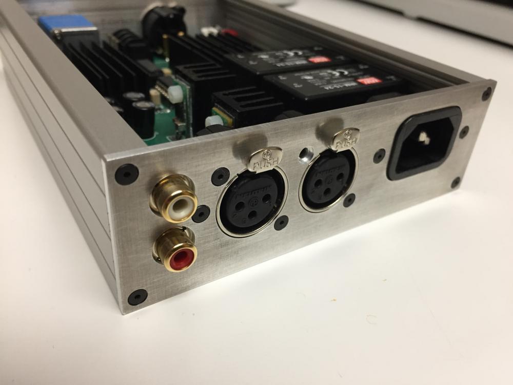

Not sure it's a good idea to countersink such thin panels (IIRC 0.09"?). I assume the panels have to be that thickness to fit the jacks?
  • Author
The corners are already counter-sunk and it seems to work fine. Measured thickness is about 2.5mm or 0.1".
The panel is a lot more flexible in the middle than the corners, and the jacks are the only thing holding the PCB in place, which is pretty heavy with heatsinks. Just something to consider.
Kerry countersunk his:
johnwmclean countersunk all but the Neutrik jack holes. I'm ok with only the corners countersunk, or whatever. John's panels were 2.5mm thick.
Not sure on Kerry's but they look about that as well.
Kerry's panel looks about twice as thick, see the one counterbored hole he didn't put the bolt in. Kerry, did you put a slot in on the other side for the PCB to fit through, or something?
John's design looks good, too.

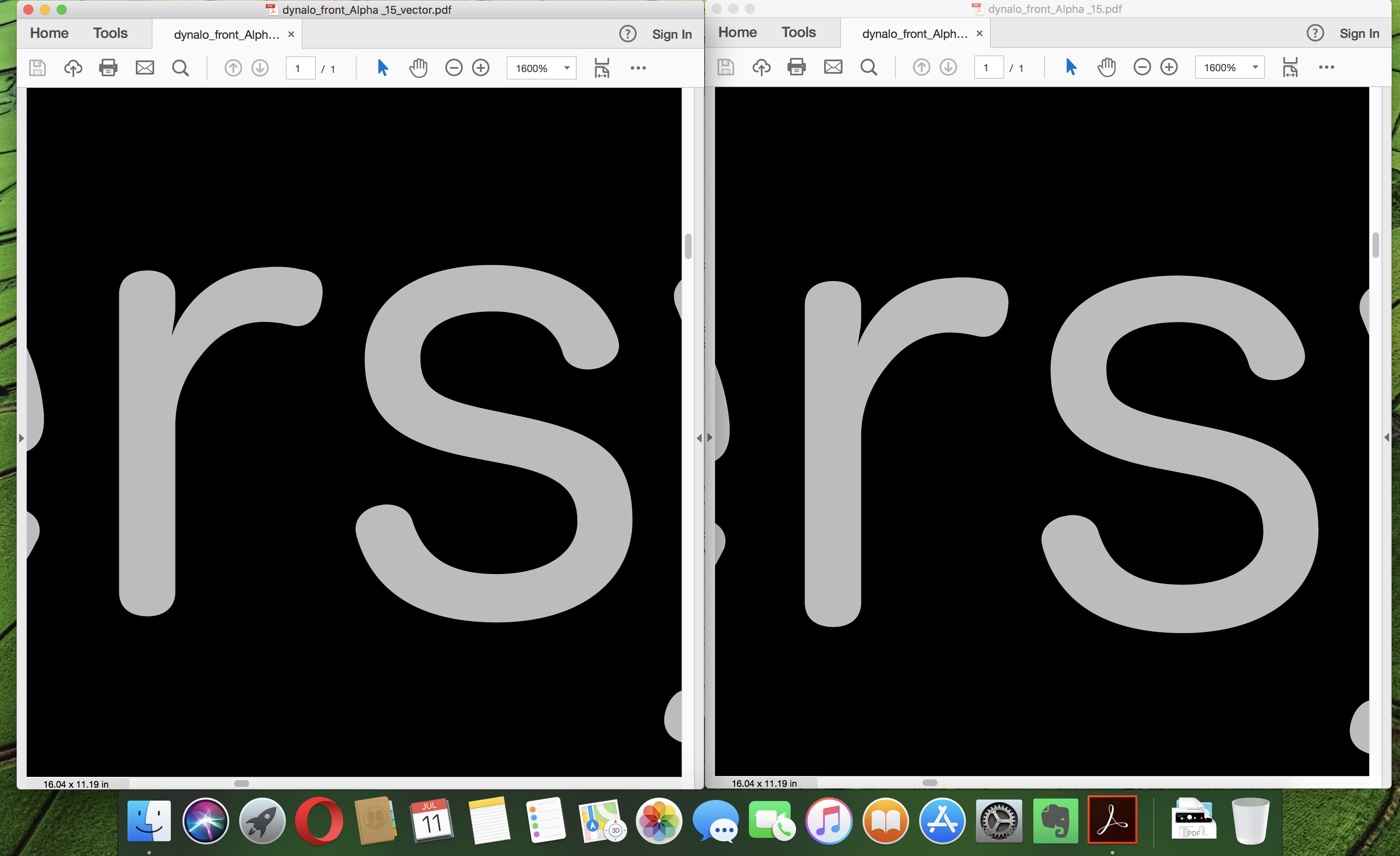

First post has been edited to include PDFs with vectorized versions of the fonts. When I applied the vectorization it seems to reduce the size, however when I zoomed in and did a side by side comparison they looked identical. Can anybody give the files a quick look to let me know of any issues? Then I'll send them ASAP.
The line weight looks a bit smaller to me.
  • Author
It does seem to have that appearance. However when I do a side by side comparison with identical zoom, I see no differences. Even taking a partial screenshot of one and adding transparency to see what the difference is results in a perfect overlap.
1094461012_ScreenShot2018-07-11at12_00_38AM.thumb.png.6c59f9bd074b2103a2cee666633f2f3b.png
Edited by cspirou
I had both zoomed in and tried to have them at the same sizing. I’m ok with the vectored font rendering; just liked the original better.
