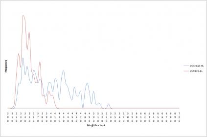

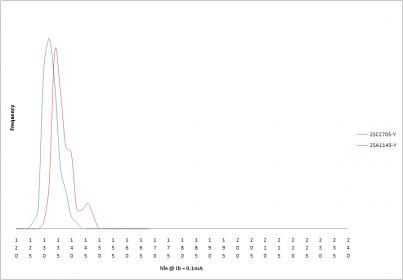

The guy at the Toshiba plant must have been slacking on the 2SC2240s :)
sorry the graphics are small... just squint, it's all decently legible.
That is one serious collection of goodies..
Someone has been busy... :o
  • Author
what, matching hfe for every transistor to the same value on all four boards isn't unreasonable, is it?
