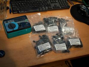

spritzer Posted September 6, 2011 Author Report Posted September 6, 2011 Here is a picture of my lot, 600 pieces all fake.

justin Posted September 6, 2011 Report Posted September 6, 2011 Double post... can you post an up close photo of some of the parts that test bad?
kevin gilmore Posted September 6, 2011 Report Posted September 6, 2011 (edited) here you go http://gilmore.chem....du/dsc_2289.jpg http://gilmore.chem.northwestern.edu/dsc_2290.jpg by the way, the lead free is a fucking lie too. Edited September 6, 2011 by kevin gilmore
justin Posted September 6, 2011 Report Posted September 6, 2011 http://gilmore.chem.northwestern.edu/dsc_2290.jpg thats the exact same kind of label thats on the bags of 2SC3675 that i got from the same source. bar codes appear to be different. if the whole thing was faked i'd guess they would just be copying and pasting the same bar codes.
