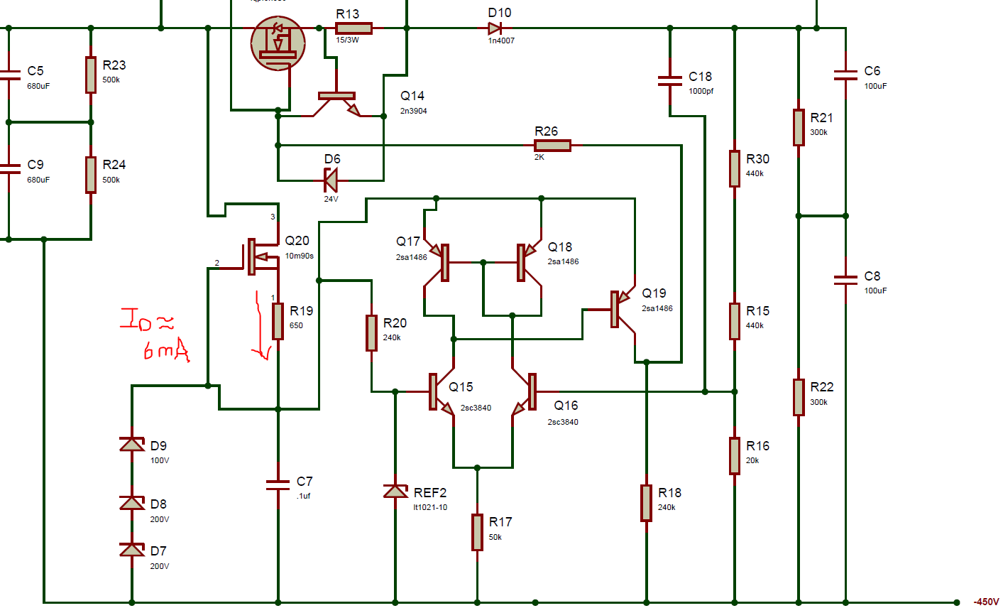

jokerman777 Posted February 25, 2023 Report Posted February 25, 2023 Thanks for the advice! My mouser updates tell me that (which is probably not new info): STN9360 a batch of production is done and is on the way to warehouse now so I guess they will be back in stock soonish. 10M90S says production in process so despite long wait time probably will come back. KSC5026M it says "Production Issues Reported - Delivery Unknown" which doesn't look good 😅 I wonder if I can do 2SC3840 instead? it's in the PSU and for no reason and understanding I thought I need to either use 2SC3840/2SA1486 or KSC5026M/KSA1156 in complimentary pairs... but since 2SC3840/KSA1156 is what I can get realistically... btw I think I'm going to use STP8NK80ZFP instead of the obsolete FQPF8N80C, at a glance the specs looks very similar other than a different Id rating and speed.
jamesmking Posted February 25, 2023 Report Posted February 25, 2023 (edited) 54 minutes ago, jokerman777 said: Thanks for the advice! My mouser updates tell me that (which is probably not new info): STN9360 a batch of production is done and is on the way to warehouse now so I guess they will be back in stock soonish. 10M90S says production in process so despite long wait time probably will come back. KSC5026M it says "Production Issues Reported - Delivery Unknown" which doesn't look good 😅 I wonder if I can do 2SC3840 instead? it's in the PSU and for no reason and understanding I thought I need to either use 2SC3840/2SA1486 or KSC5026M/KSA1156 in complimentary pairs... but since 2SC3840/KSA1156 is what I can get realistically... btw I think I'm going to use STP8NK80ZFP instead of the obsolete FQPF8N80C, at a glance the specs looks very similar other than a different Id rating and speed. FQPF8N80C is still available from radio spares: https://uk.rs-online.com/web/p/mosfets/1454316 and https://uk.rs-online.com/web/p/mosfets/6715326 and https://uk.rs-online.com/web/p/mosfets/6715326P KSC5027 might be an alternative to KSC5026 in the longer term - different package TO-220, higher current and wattage BUT different pinout Edited February 25, 2023 by jamesmking 1
bbest Posted March 4, 2023 Report Posted March 4, 2023 (edited) On 2/24/2023 at 2:21 PM, MLA said: I've sucessfully used stn0214 as replacement for ksc5026M as per JoaMat's recommendation in several other builds. Don't know the heat dissipation requirement for the position where they are used in KGSSHV, but someone more knowledgeable than me might chime in here. Not so far ago it was expected in JUL-23 on mouser, but now shift to 19-Aug-24. So only stn0214. Quote btw I think I'm going to use STP8NK80ZFP instead of the obsolete FQPF8N80C, at a glance the specs looks very similar other than a different Id rating and speed. here said https://www.mouser.com/PCN/onsemi_Generic_PD24419ZB.pdf it could be replaced on FQP8N80C, but mouser also suggested STP8NK80ZFP Edited March 5, 2023 by bbest
jokerman777 Posted March 4, 2023 Report Posted March 4, 2023 Thanks, looking at the datasheet I think the KSC5027 jamesmking suggested might be a better fit and pretty legit replacement for KSC5026M? the specs looks like they are the same thing other than the 5027 can handle more dissipation (I only know how to read numbers so I can be dead wrong). TO-220 should fit into the TO-126 footprint, base and emitter pin are swapped so just need to flip it when soldering it in? I'm also curious what makes the 10M90S special to be a current regulator IC? The datasheet label the pins as G/A/K (gate, anode, cathode?), is it basically a MOSFET?
simmconn Posted March 4, 2023 Report Posted March 4, 2023 You can use just about any NPN transistor with sufficient BV(CEO) and BV(CBO) rating and not too much Cob (usually means not a high current part). If the Cob is too small on the replacement part, you may want to increase the value of the compensation cap (5pf). For the 10M90S, rumor says (in its SPICE model notes) it has an internal OPAMP so it would be more complex than just a depletion mode MOSFET. In fact the actual part performs even better than the SPICE model which only has a depletion mode MOSFET and a body diode. I guess that makes the G/A/K notion more appropriate and the manufacturer can continue to charge $4 a pop.😉 You can use IXTP01N100D to replace the 10M90S in most places if you can't wait to get the amp up and running. Some resistor values need to be tuned to get to the current the circuit was originally designed for. 1 1
jokerman777 Posted March 5, 2023 Report Posted March 5, 2023 21 hours ago, simmconn said: You can use just about any NPN transistor with sufficient BV(CEO) and BV(CBO) rating and not too much Cob (usually means not a high current part). If the Cob is too small on the replacement part, you may want to increase the value of the compensation cap (5pf). For the 10M90S, rumor says (in its SPICE model notes) it has an internal OPAMP so it would be more complex than just a depletion mode MOSFET. In fact the actual part performs even better than the SPICE model which only has a depletion mode MOSFET and a body diode. I guess that makes the G/A/K notion more appropriate and the manufacturer can continue to charge $4 a pop.😉 You can use IXTP01N100D to replace the 10M90S in most places if you can't wait to get the amp up and running. Some resistor values need to be tuned to get to the current the circuit was originally designed for. Very helpful info, thanks Simmconn! I was searching for high voltage depletion mode MOSFET and IXTP01N100D indeed came to the map. I kinda do want to get the amp running before the of expected shipping date of those transistors which takes months. Been sitting on a pair of X9000s that I can't listen to without an amp for a good while now. I don't know if I'm doing this correctly I took a rough guess of the current running thru the 10m90s based on its datasheet. And seems to use IXTP01N100D for replacement I should find the Vgs that gives the same Id and then get the Rk value from Vgs/Id? Tho the figure in the datasheet doesn't have the resolution for this application 😵
simmconn Posted March 5, 2023 Report Posted March 5, 2023 You can put together a test circuit using a trimmer pot and dial in the target current with say, 50V across the CCS and get the resistor value, something like the post here. It's okay if the actual current is a couple of mA higher than designed. It will turn to heat on the Zener diodes and won't burn a hole on your board. 1
