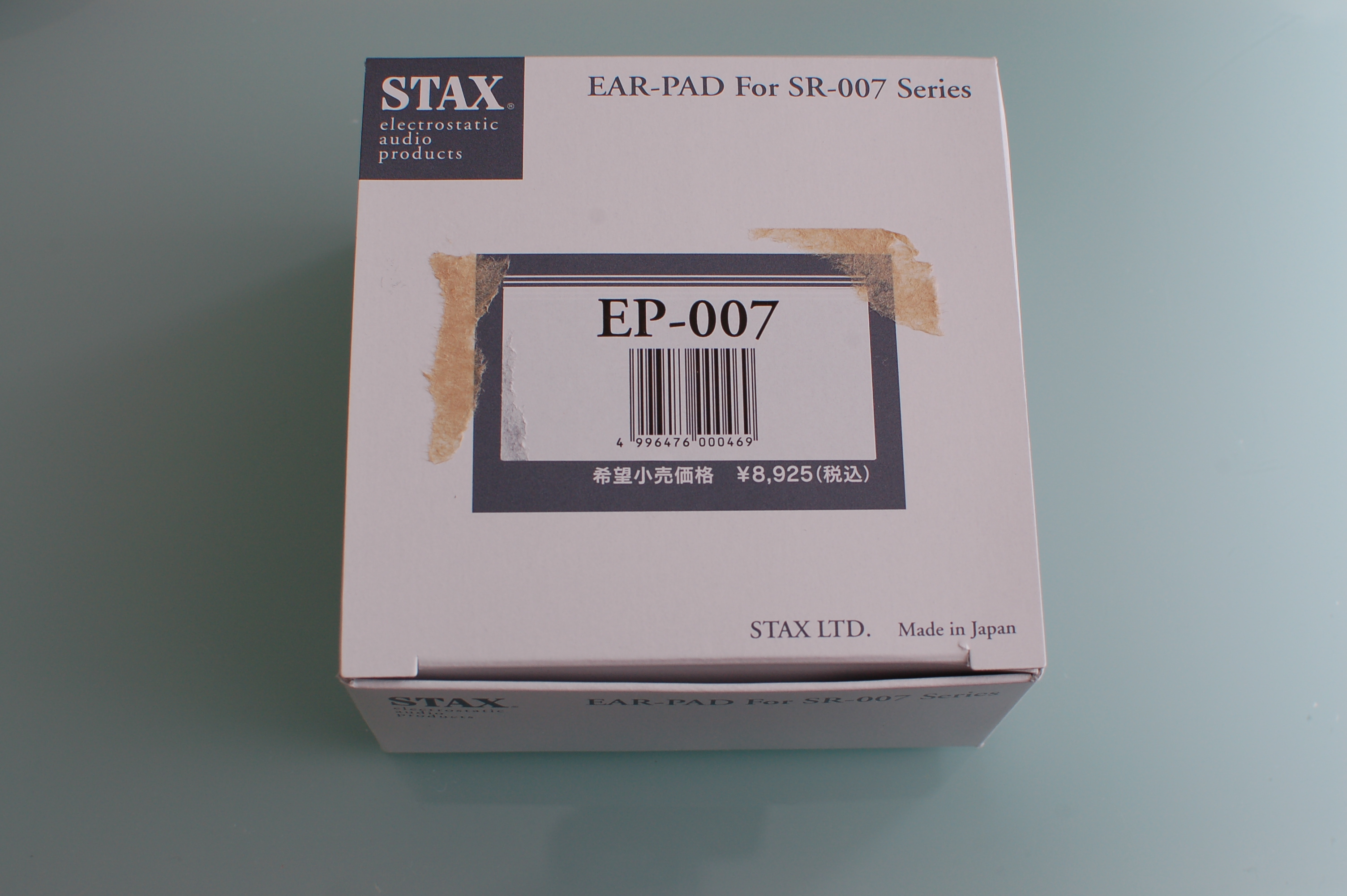

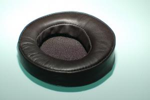

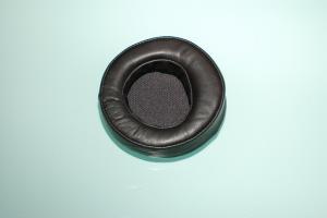

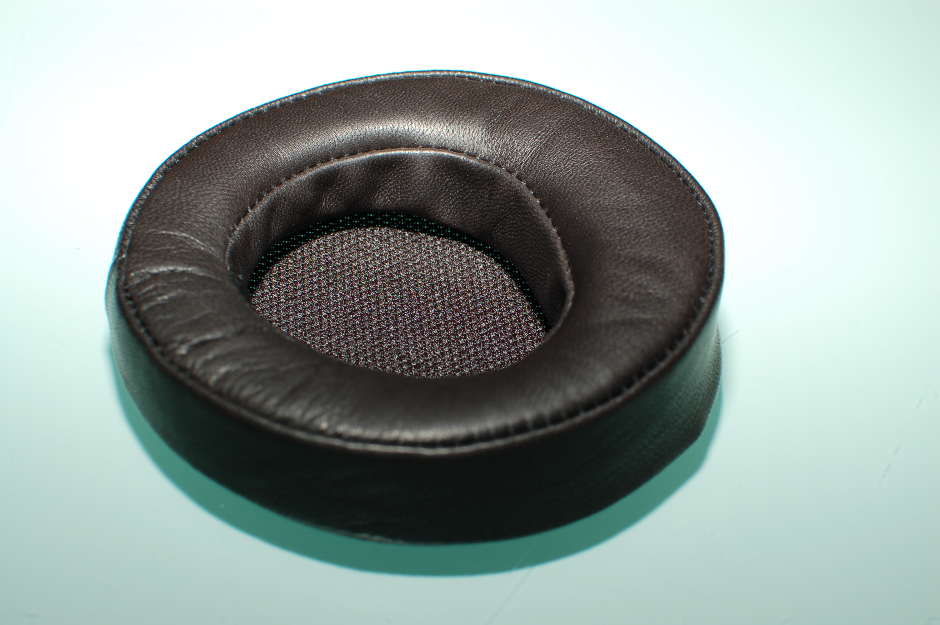

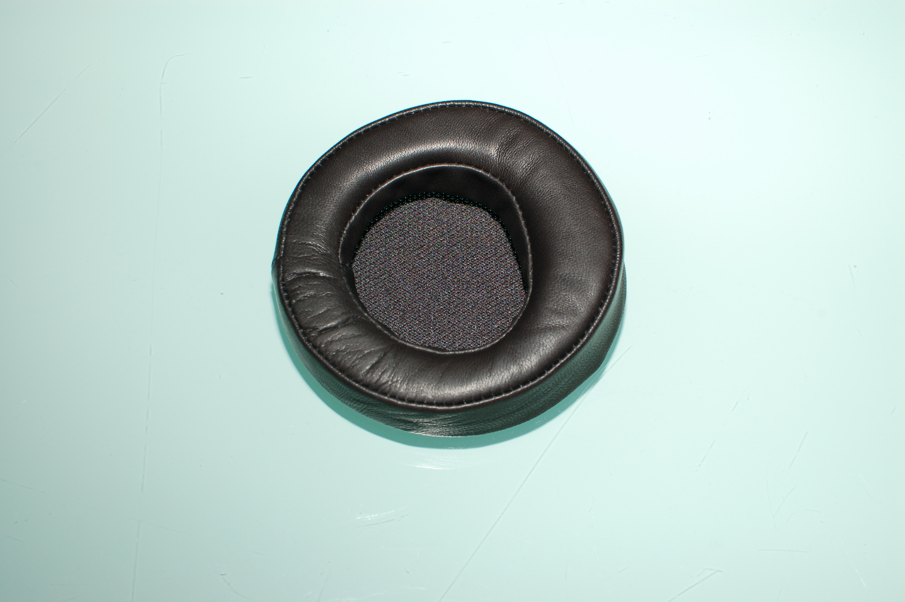

I received the purported O2 mk2 pads from the ebay seller the other day. Just want to post some pics to be sure they are legit O2 mk2 pads. I dunno--I expected them to be more "poofy." But they seem sufficiently leathery in the pics. Are there any tell-tale signs one way or the other? Is it possible to get O2 mk1 black pads? AM I GOING INSANE?!

do they have the "double layer" on the reverse side, to accommodate both the mk1 and mk2? If you look at the installation guide, printed on the inside flap of the box you should see what I mean.
The replacement O2 pads look much thinner when its not streched by the spring mechanism and actually on the headphone.

Those pads look genuine to me and you could maybe get black Mk1 pads from some of the distributors. Try Germany and the UK...
