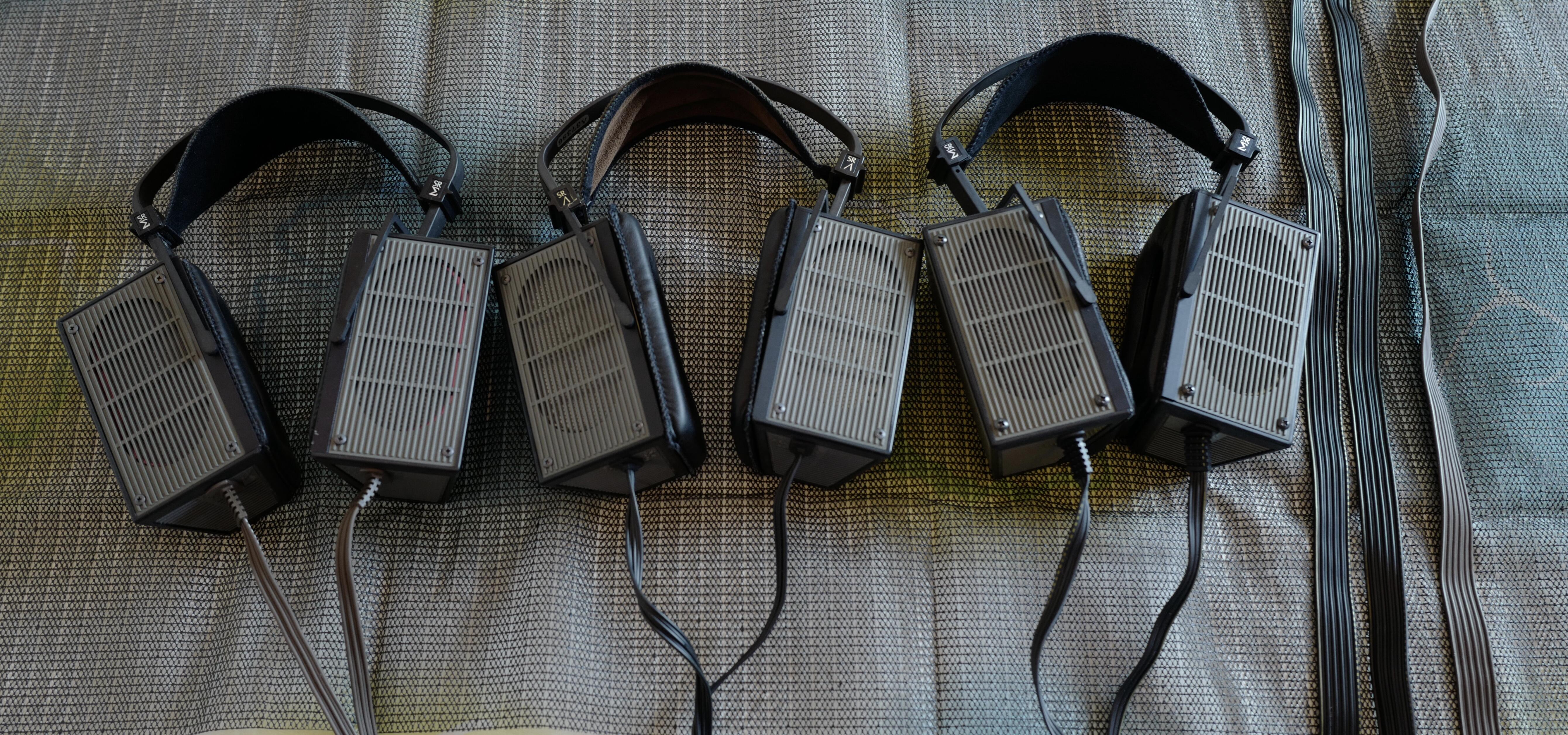

phixphi 1 Posted March 12, 2020 Report Share Posted March 12, 2020 On 2/15/2020 at 8:01 AM, bwck2000 said: Left to right: 404, L700 and 507 Sigma The one with 404 driver is more laid back and has more colouring while the 507 one has the best transparancy . But the L700 sigma is the best with a very full bodied mid bass and excellent 3D- imaging and soundstage I have never heard of in any other headphones. Love all three of them A-ha! So it is possible to fit newer drivers than 404 into Sigmas? I was recently redoing my Sigmas and was told 404 is the last driver that fits. Quote Link to post Share on other sites
spritzer 2,536 Posted March 13, 2020 Report Share Posted March 13, 2020 It is possible but you really have to take them out of the small housing and glue them together. This is due to the internal angle of the Sigma housing and how close the drivers sit to that side. Now doing this is very tricky but can be done. Quote Link to post Share on other sites
bwck2000 87 Posted March 13, 2020 Report Share Posted March 13, 2020 Exactly, Can't do this without a dust free environment. For a simple upgrade on the original sigma 404 driver is good enough. The manipulation needed and the risk is manageable for a skillful DIYer. Quote Link to post Share on other sites

Mach3 35 Posted April 8, 2020 Report Share Posted April 8, 2020 (edited) On 2/15/2020 at 6:01 PM, bwck2000 said: Left to right: 404, L700 and 507 Sigma The one with 404 driver is more laid back and has more colouring while the 507 one has the best transparancy . But the L700 sigma is the best with a very full bodied mid bass and excellent 3D- imaging and soundstage I have never heard of in any other headphones. Love all three of them Holy smoke batman that one expensive DIY line up. How does the L700 Sigma compare to the stock L700 in term of overall sound? Edited April 8, 2020 by Mach3 1 Quote Link to post Share on other sites
bwck2000 87 Posted April 8, 2020 Report Share Posted April 8, 2020 (edited) 3 hours ago, Mach3 said: Holy smoke batman that one expensive DIY line up. How does the L700 Sigma compare to the stock L700 in term of overall sound? Two completely different creature, cant compare as if between two lambda models. The most obvious difference would be the soundstage. Its like a Jazz cafe VS a cathedral. The L700 sigma still holds lambda-level detail and transparency, unlike the original sigma. But the detail and the high frequency on the l700 sigma are just not as apparent as the L700. Edited April 8, 2020 by bwck2000 2 Quote Link to post Share on other sites
